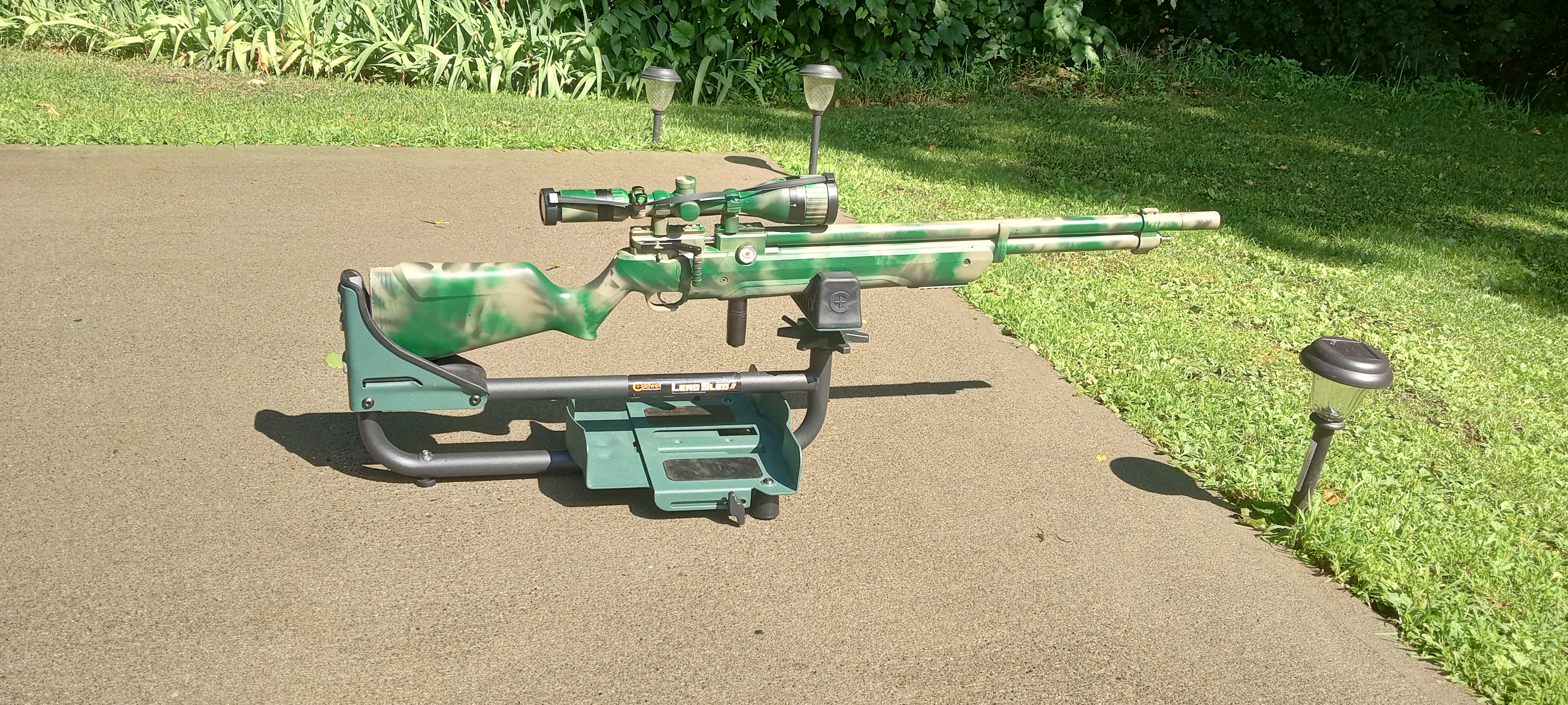

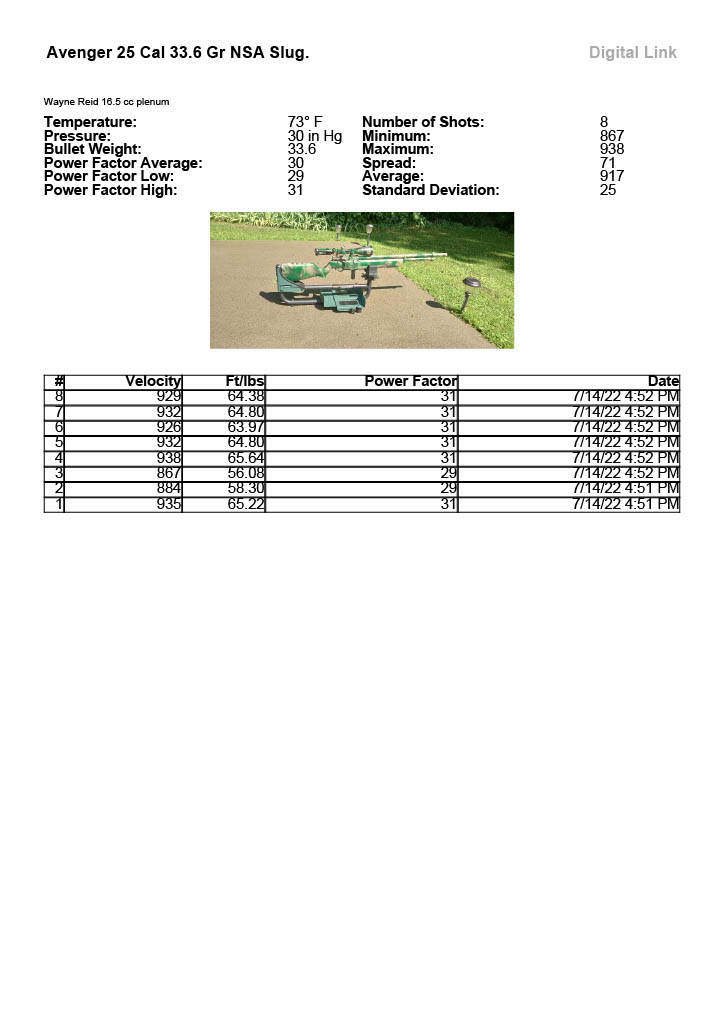

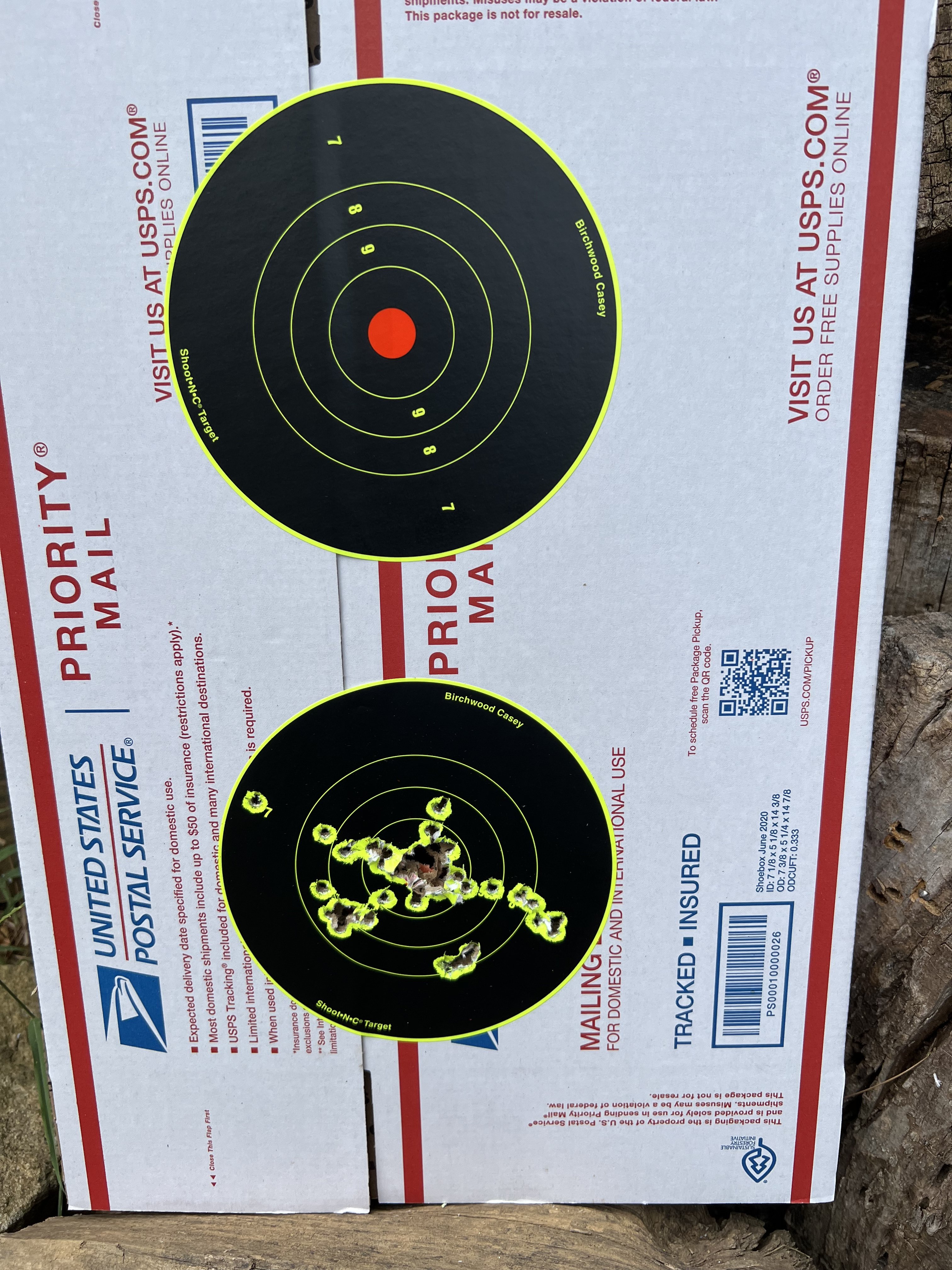

I love my 25 cal Avenger. i shoot woodchuck and coyotes. squirrels and rabbits.
Mine is 25cal also and your specs look very good. Certainly the critters can’t argue with your results. My concerns begin when printing on targets at 75 to 100yds from the bench with various pellets and slugs,and only then do the irregularities show themselves. Presently after much testing and mods I am thinking that the hammer spring might be the culpret and maybe aftermarket springs or double springs could lead to target accuracy of sub moa thats repeatable.
