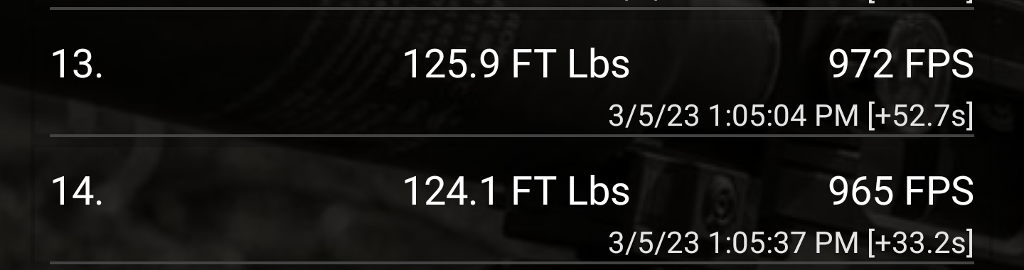

Avenger .25 ... 110 FPE !?
Pushing up the power..

Whats your shot count on the avenger did you get a bottle on yours? sounds like it aint even an avenger no more the amout a stuff u did to it.
It's been a couple months since I even shot it but I think I was getting around 20 full power shots at this level. Basically the only thing that is still "Avenger" is the action block assembly but I have modded that too.
With some mods you can reach 100 fpe or more
Correct. If you're willing and able most airguns are capable of insane power. My off the production line 100fpe on a good day .35 Bighorn is now doing 250fpe. Barrel, porting, valve, bottle, pressure. A lot of work to make a $600 gun do what others can but so rewarding when you do.
