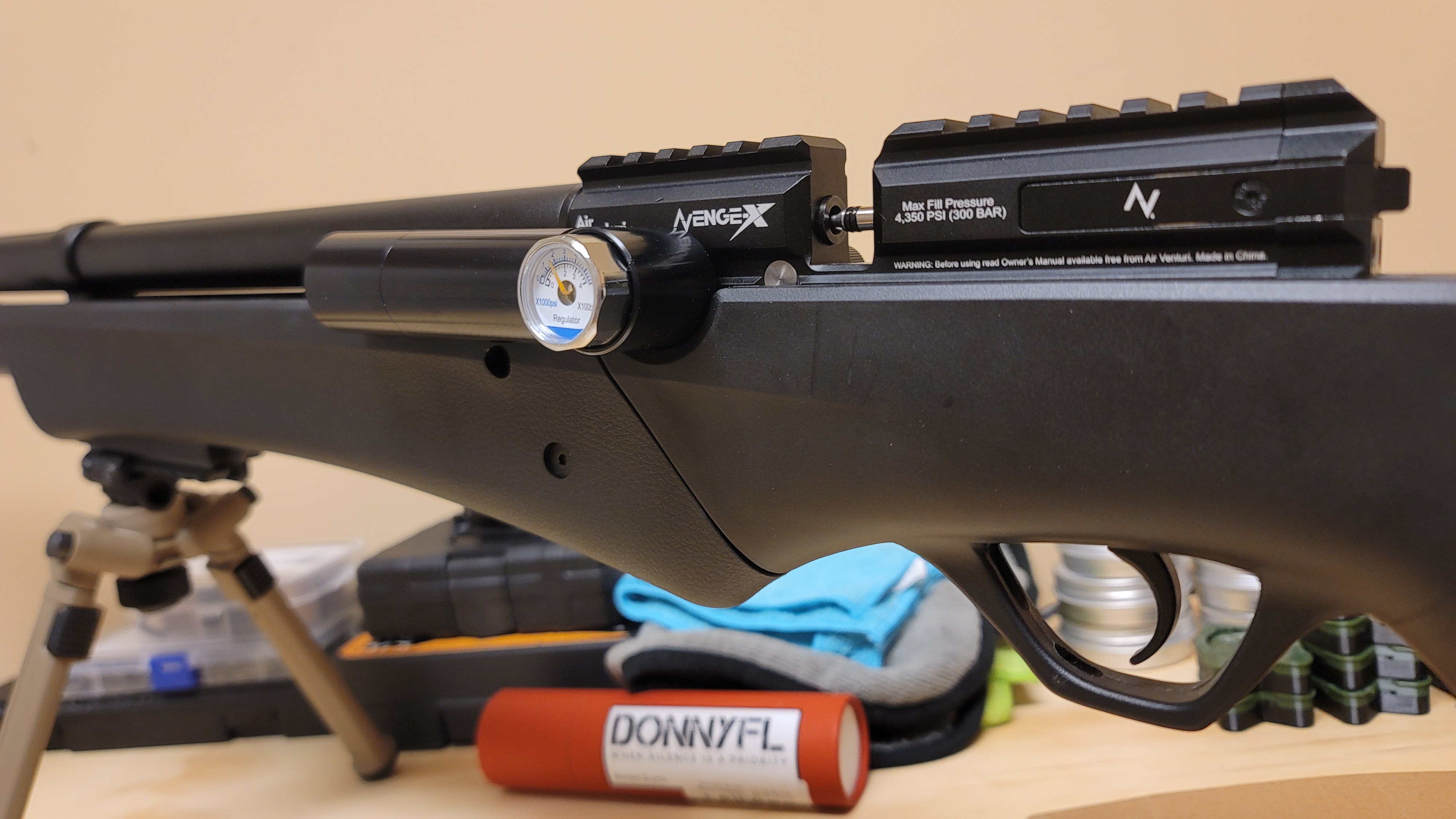

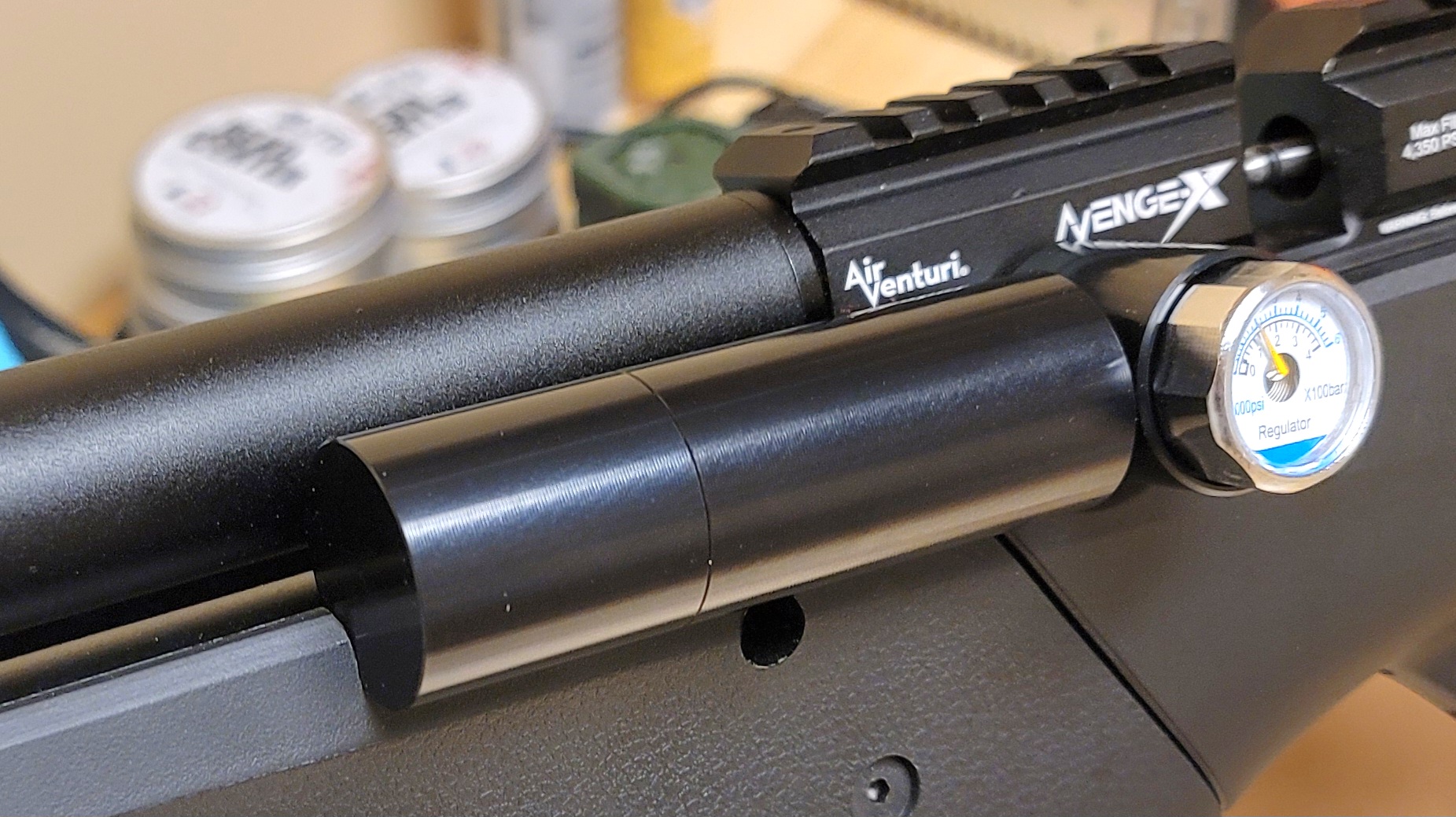

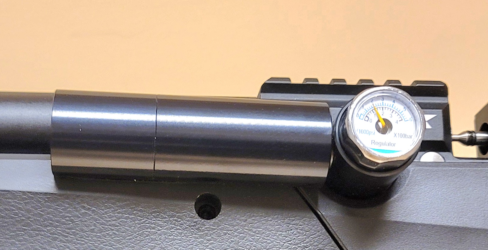

Managed to mount it on mine . Had to do a bit of cutting, used a dremel with an oversized cutoff disk. Took my time, about an hour, and it turned out well cosmetically. Kit comes with 4 round shims to adjust the adapter standoff relevant to its threads so it clocked correctly for the plenum. Only needed 3 for that and used the remaining 0.01" shim on the regulator gauge so it's clocked correctly.
