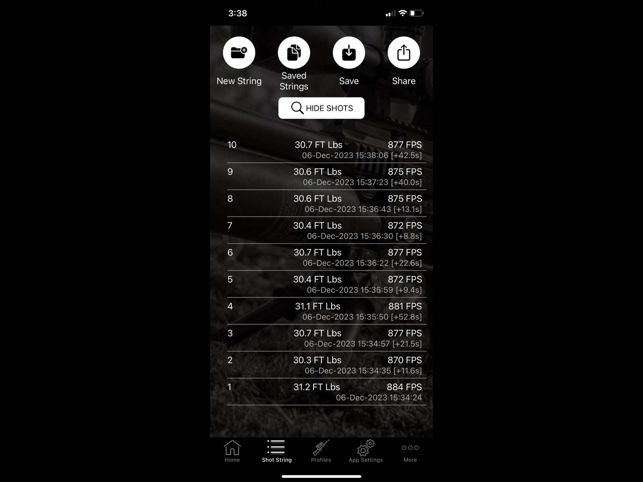

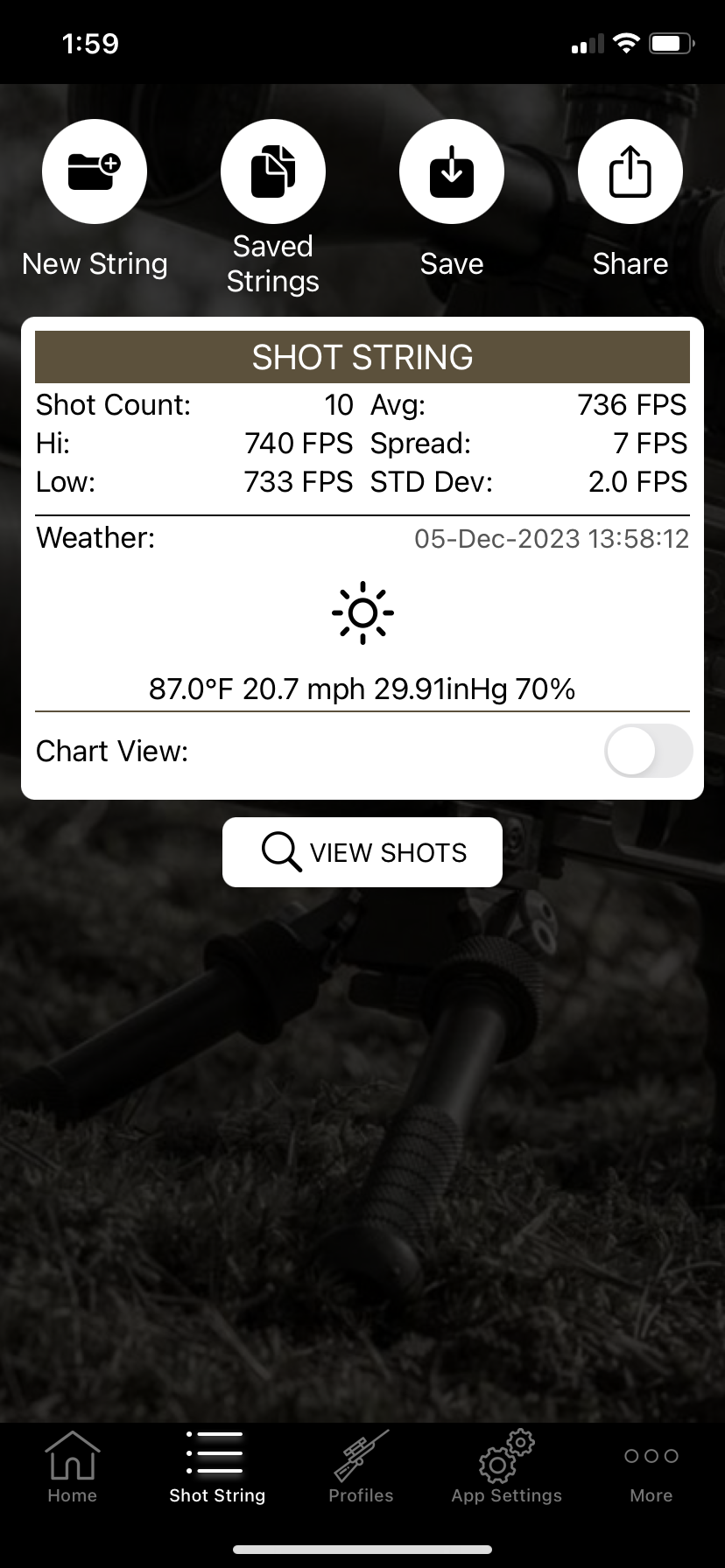

I performed this test already with my new Avenge-X .22 cal with the TP set to high tuned to shot the JSB 18 grains pellets between 870 and 880 fps (I don’t shot with slugs). Then with this same tune without touching anything else set his TP to low and shot a string of 10 rounds with the lighter crosman premier 14 grains pellets and this were the results. If you’re curious about the weather still been in the mid 80 degrees at this time of the year, I live in the Caribbean PR not in the states.
I pulled some (actually quite a few) patches through the barrel with a Patchworm. It was dirtier than I expected. The manufacturer must’ve put some anti-corrosion stuff in there!
I put it over the chrony and it was shooting the 18g pellets a bit hotter than I like at about 920 fps. Not sure if the difference in velocity (from the 10 for 10 test) has to do with different elevation/atmospheric pressure or a clean barrel, but it was shooting 885 fps in Ohio.
I reduced the hammer as much as it would go. *it has a stop pin or something so you can’t accidentally back it out too far. Which is now giving me about 900 fps.

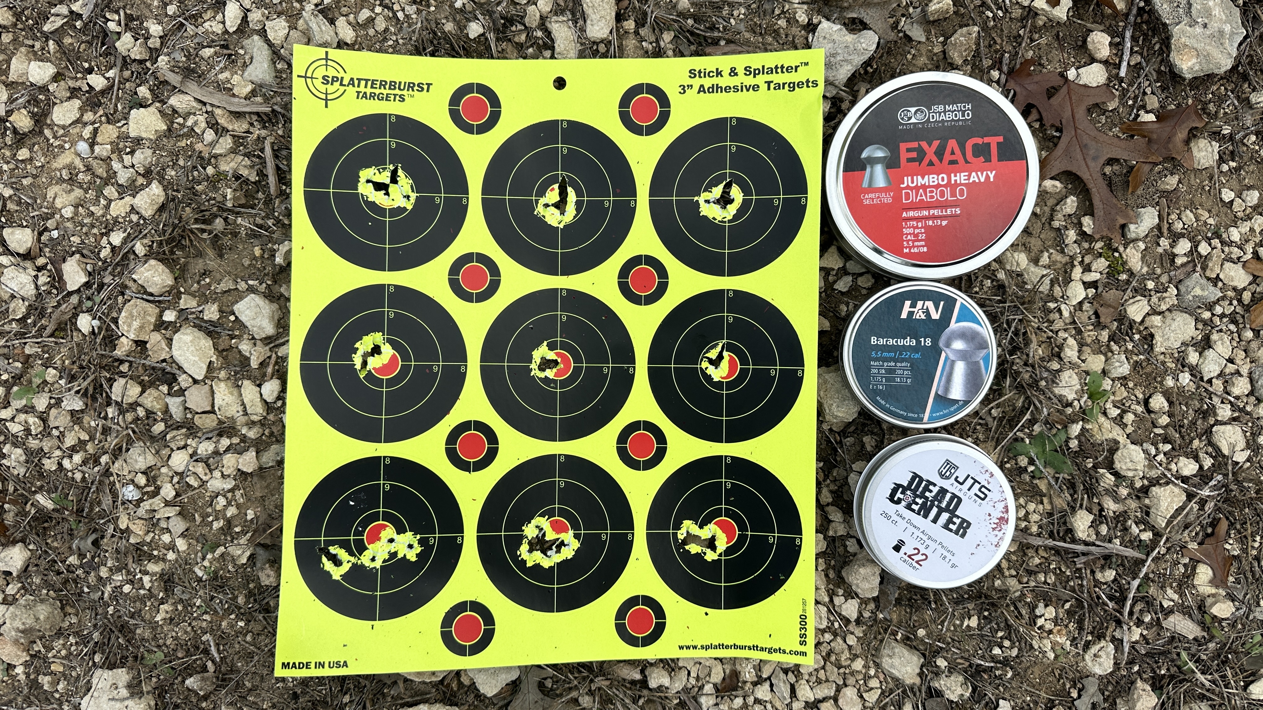

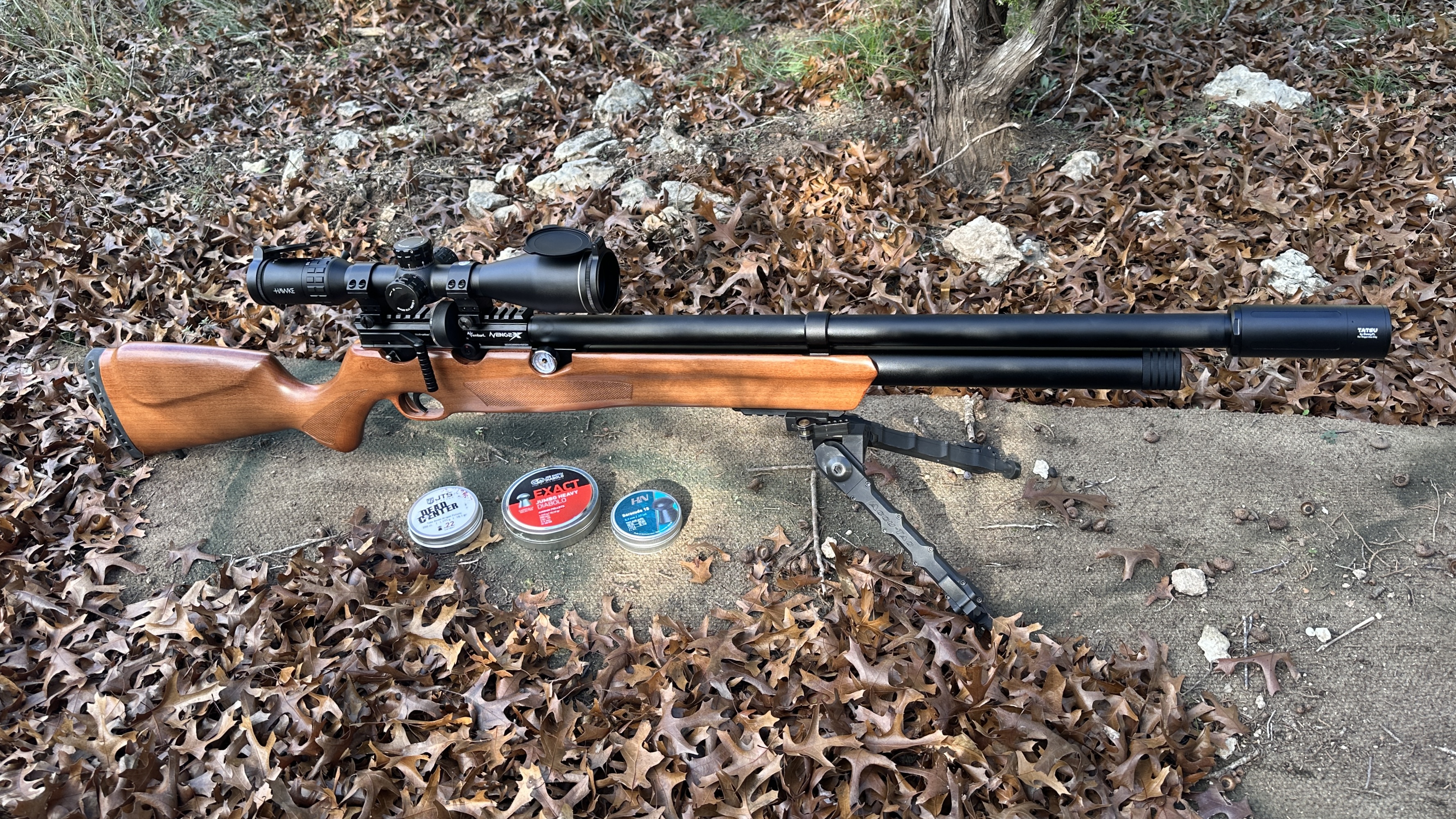

So I took the Avenge-X out back and sighted it in at 50y.
I tested 3 different brands of 18g pellets, and apparently this barrel like the H&N 18’s best.

No I did not. The only pellet I've ever got to shoot accurately above 900 fps is the .22 25g JSB MRD's.
The H&N 18's at 900 fps shot very well for me at 50y.
*The JTS Dead Center pellets were a very tight fit in this barrel.
