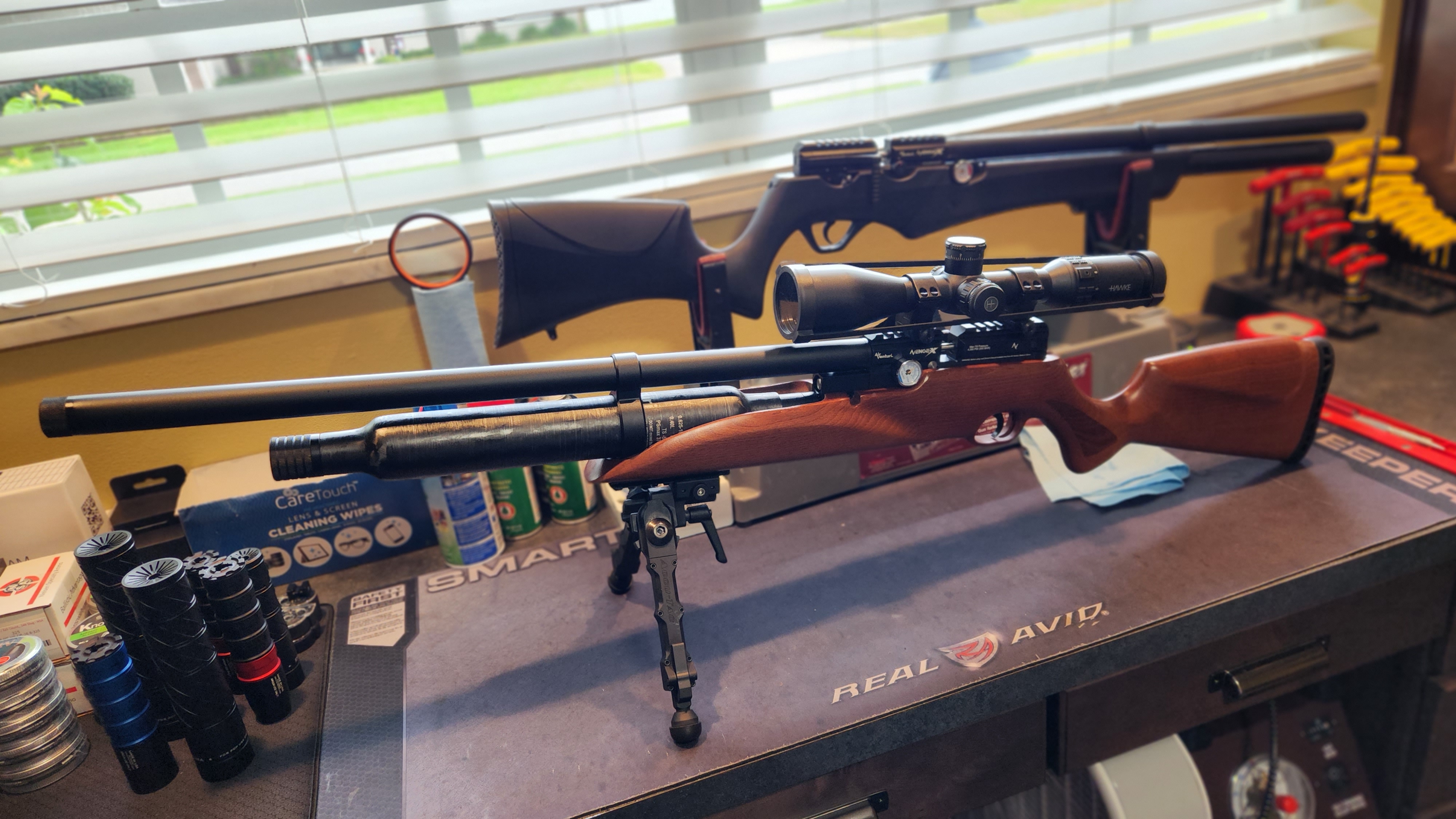

First impressions after a week with it are that I'm kinda surprised how much more I like it than my Avenger. It's so much more refined, solidly built, and nicer to handle & tune. In person, it looks & feels waaaay more expensive than an Avenger. It actually feels & behaves expensive as opposed to cheap if that makes sense? And the shot cycle, OMG have they refined that. Tunes out really nice & clean. Barrel band, bedding, receiver, tube, shroud, stock, cocking, tuning gear, all of it....waaay more solid than the Avenger, and is solid. Can not say that enough. Feels like a $1,000 gun to me all day long. The mags still feel like Benjamin Maximus cheapies though. The new tall one is cool. But I can't fit it under the scope. Cocking is solid but a bit dry feeling. Trigger feels dry too but is good.
Haven't messed with the caliber or bottle change yet but it looks super easy to do.
The new Donny is honestly amazing. It's a big step up in quality & feel over his previous stuff that we're all used to... and that stuff was really nice. On the X, the Yokozuna is shockingly quiet, truly. Like puff and thats it. Even my wife was like, oh wow, that gun is crazy quiet. And that was at 45 fpe, lol. I'll go on record and say its the quietest moderator I've ever sampled. I haven't been wearing hearing protection to tune and normally I do. The new twist lock feels ultra high quality and is rock solid.

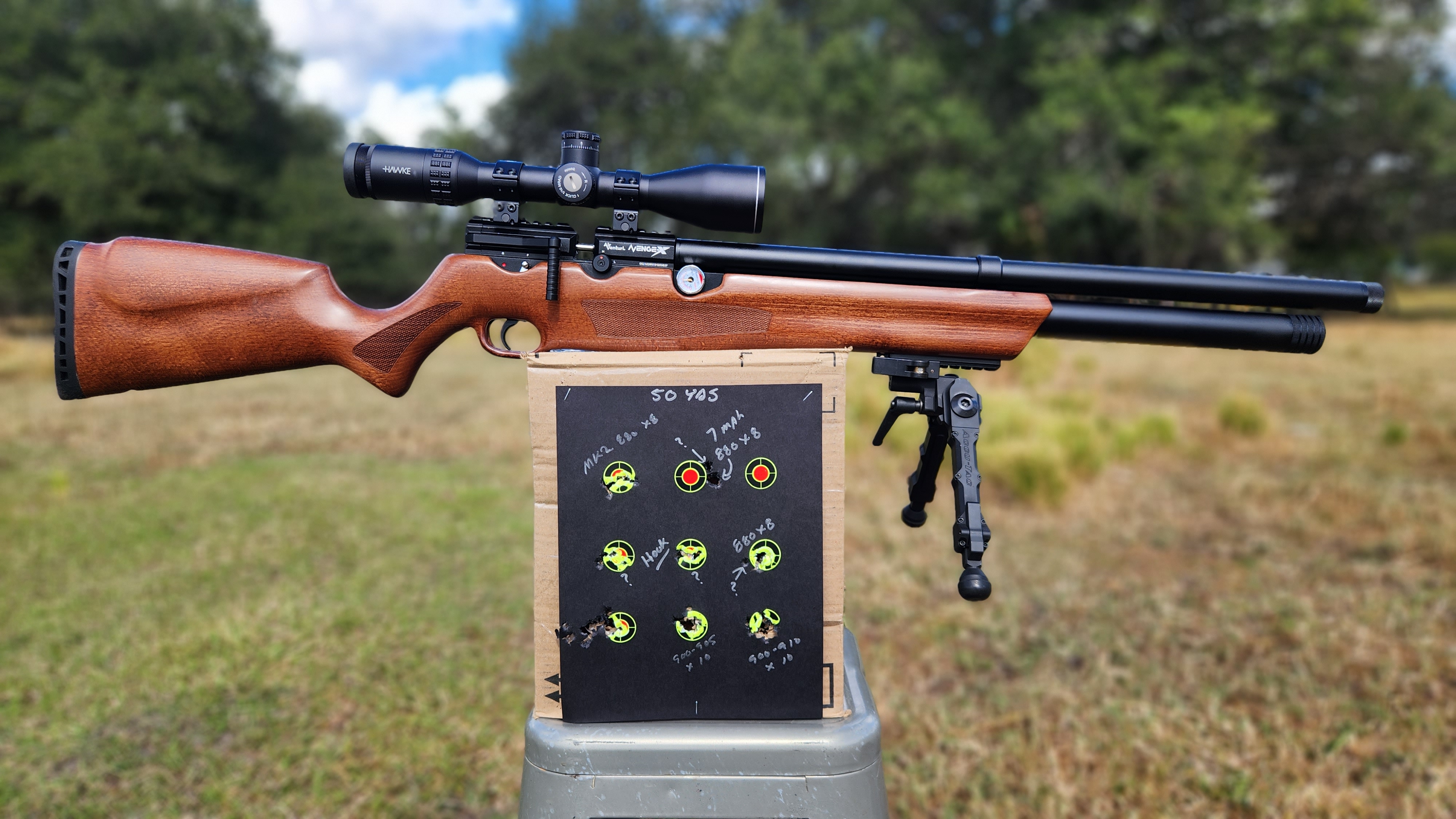

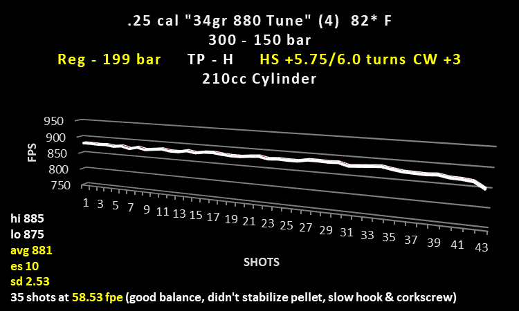

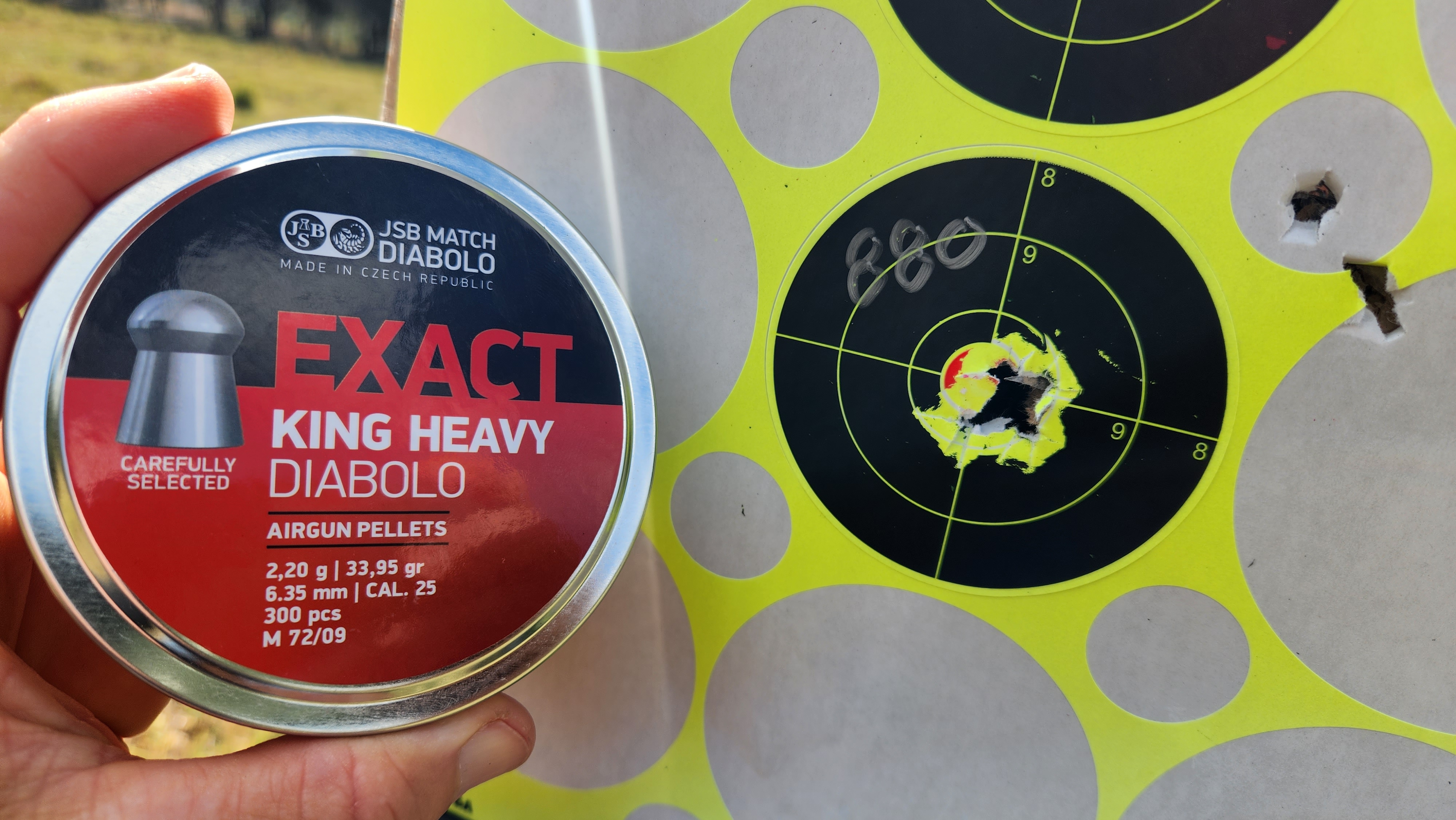

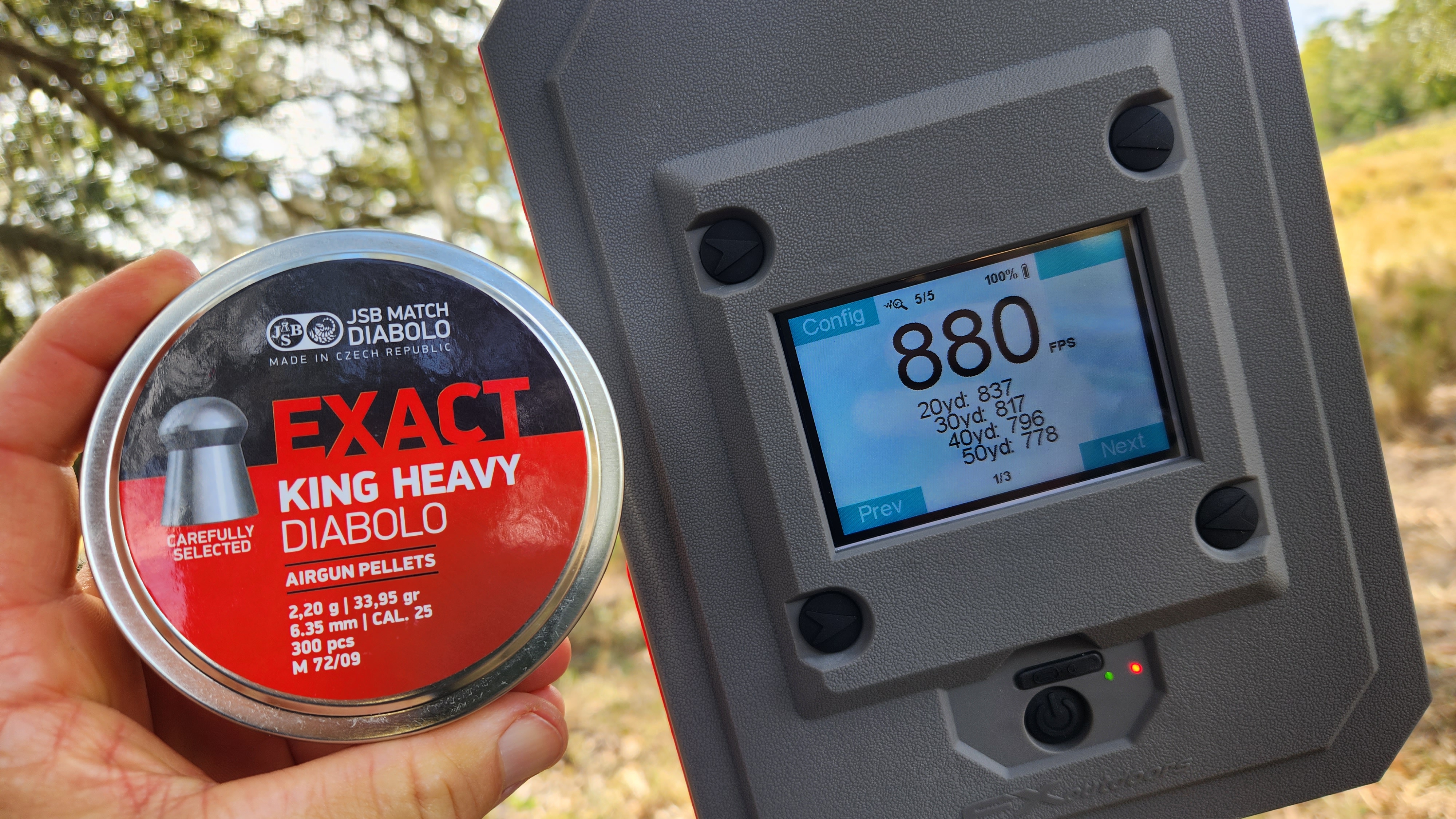

I started at 880 fps. While the 8-shot 50 yard mag-dump below looked pretty okay, in reality it wasn't. Through the scope, I could see the pellets curve balling their way there... and winds were only 3-5 mph.
8 shots at 50 yards, 880 fps, 34gr, 3-5 winds, unstable in flight.
Here's the 880 tune with the 34's... take note of the 199 bar reg (210 is Max) and we'll come back to this later.
FX's True Ballistic Chronograph displays the information from muzzle to target.
Recalling that this barrel stabilized the 25.4s wonderfully at 900-905, I threw together a quick field tune to push more speed and played around at 50 some more. At 905 ish, hook went away with the 34s too and accuracy got better. I had pretty bad winds throughout this card. They started off at 3-5 and worked their way up to 10-15 mph towards the bottom of the card. Even still, the non-mk2 34s shot well at 905.
Avenge X revealing its wants at 50 yards.

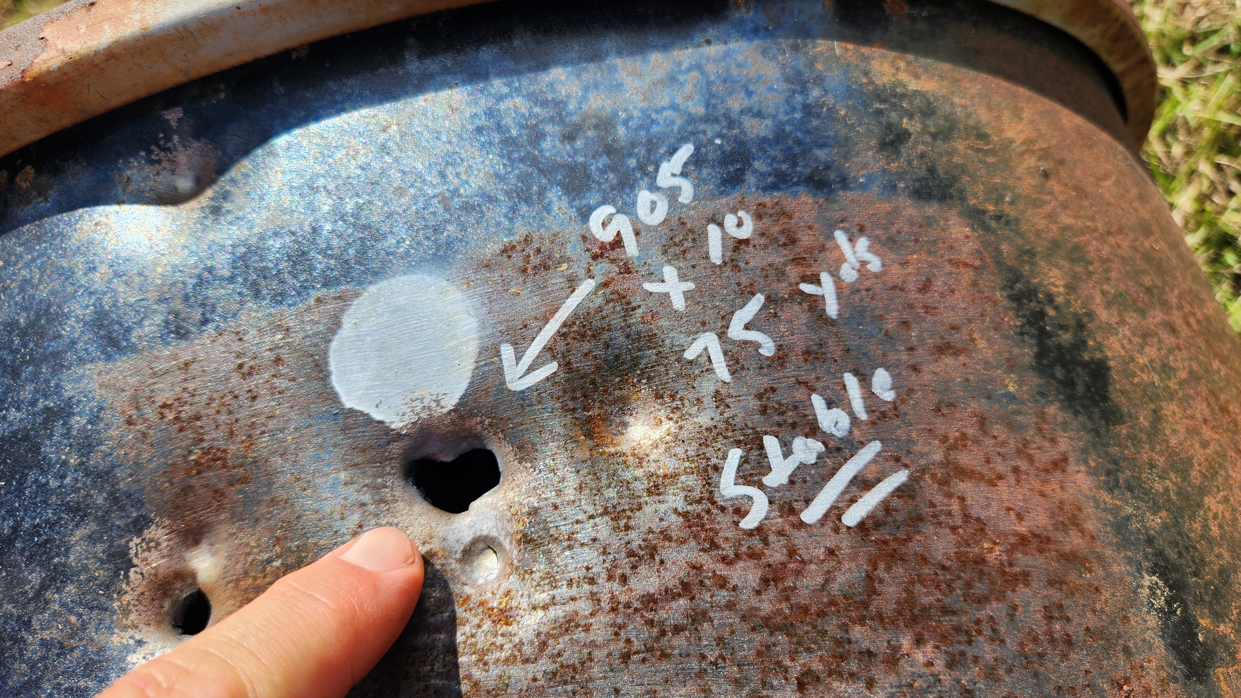

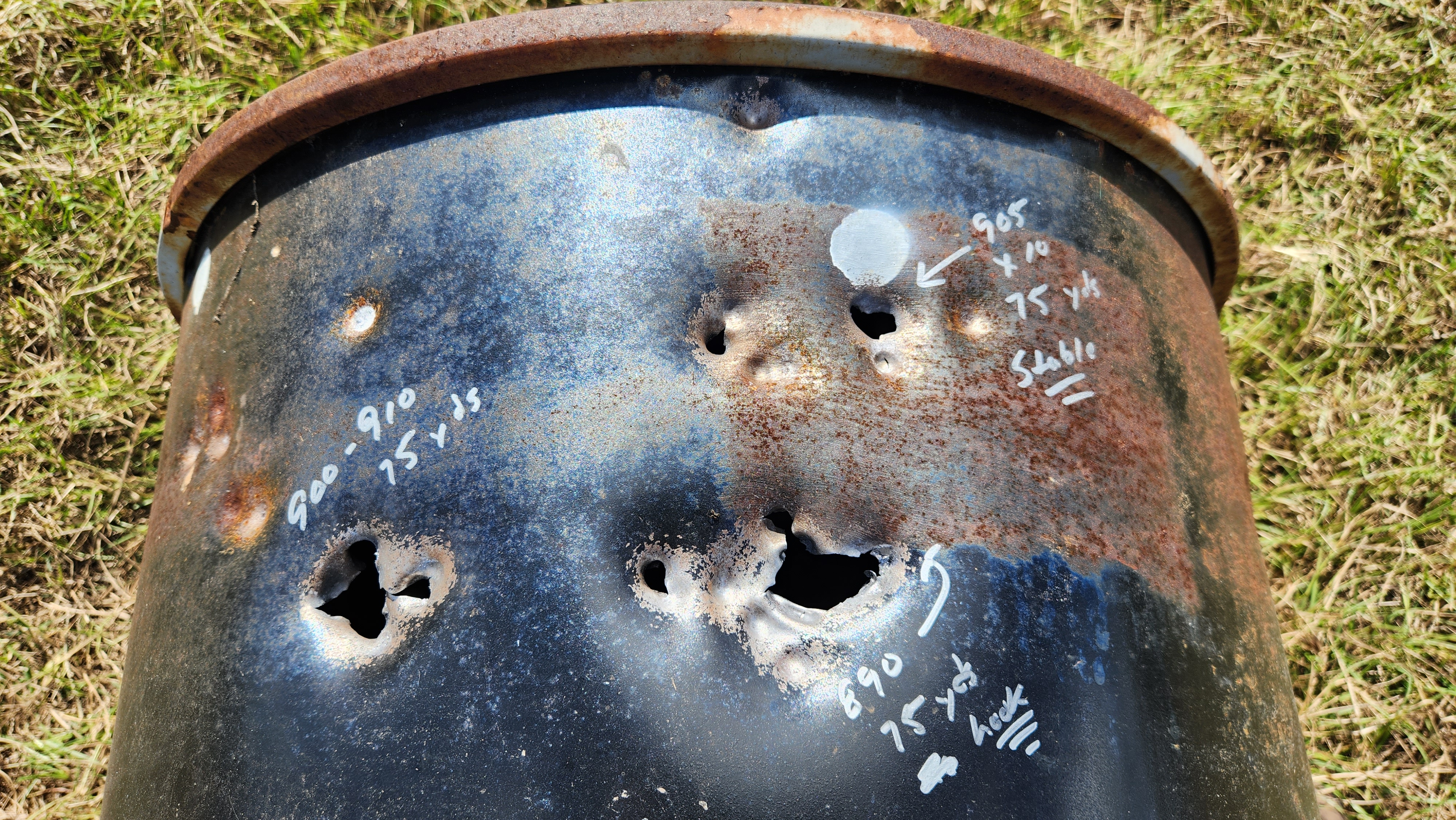

Just to be sure about that 905, I moved out to 75 yards and focused up. I wanted to see if I could do better. I often like to use a black steel oil drum for this because it helps me see exactly what the pellet is doing in flight.
Really happy with 905 fps and the 34s out of the Avenge X. AT 75 yards, they all flew straight, and I dropped 9/10 into this little hole.
Me happy 🙂.

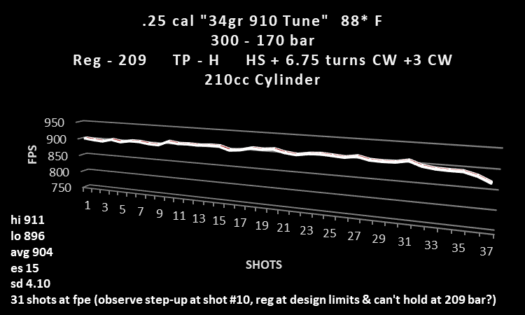

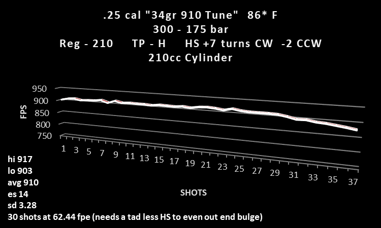

I went home and began to build out a tune around 905 with the 33.95gr JSBs. But I struggled. The reg wasn't wanting to hold 210 bar as I needed it to. Take note of the small "mound" between shot 19 and 27. This was my first warning that I was pushing the limits of the regulator.
Here was my second warning that the reg was at its limits. Notice how shot 1-10 the reg held pressure steady for me? Then, began to ride higher after that? I had no other symptoms like creep or anything like that, but I did notice reset time begin to vary. All symptoms that I cooked the reg, lol. This gun has good enough guts to run 8/2 ES & SD when all is well with your tune and pellets.

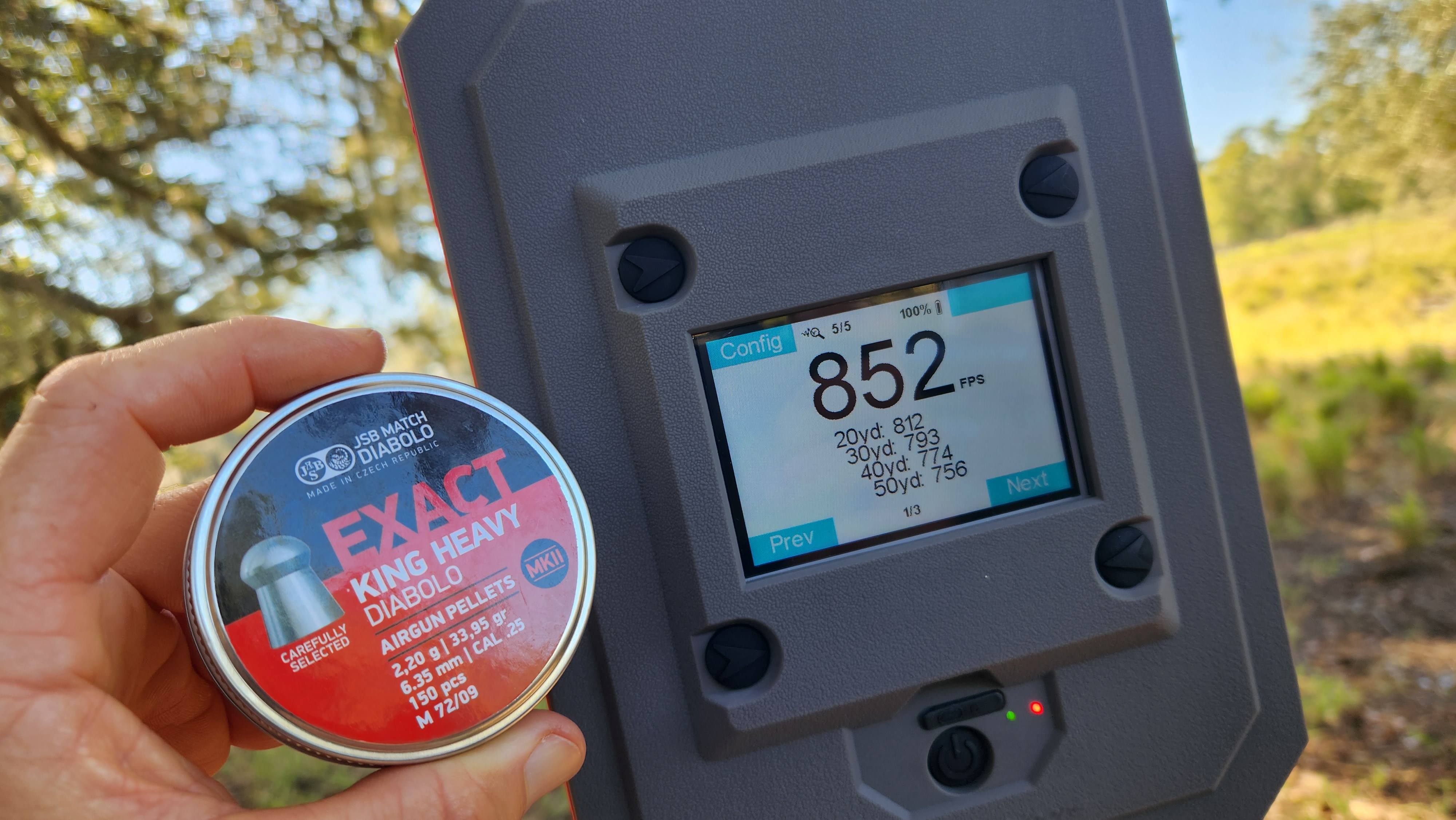

With a fresh reg installed, a clean "850 tune" for the 34s came easy.
33.95gr "850 tune" on a fresh reg.

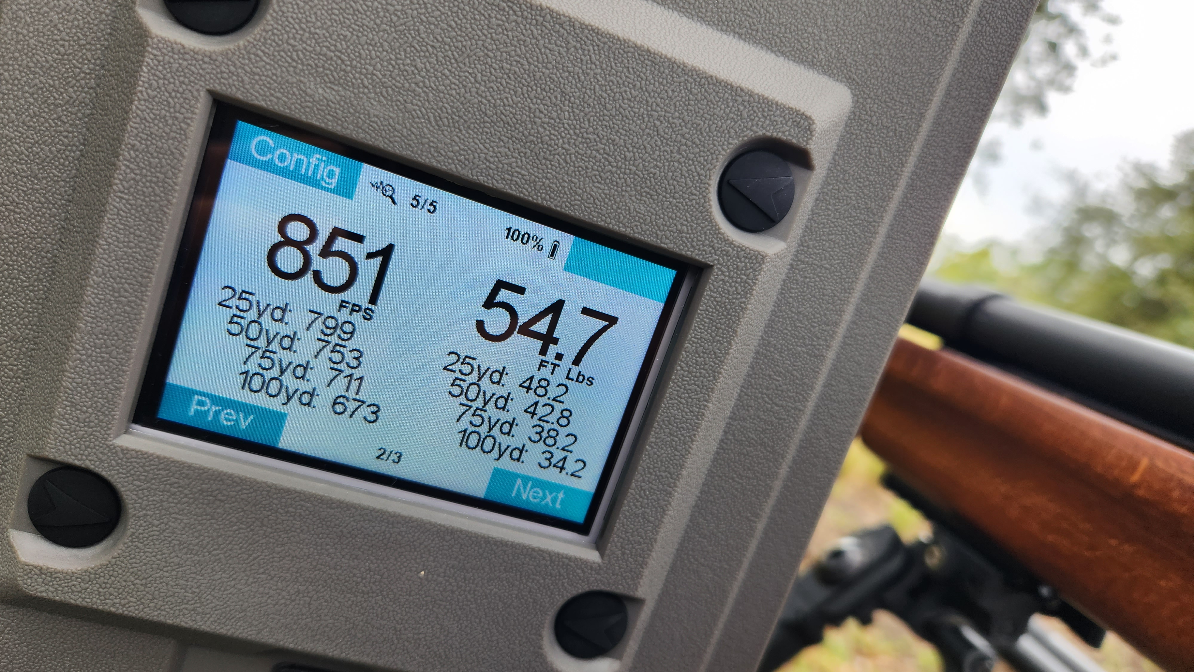

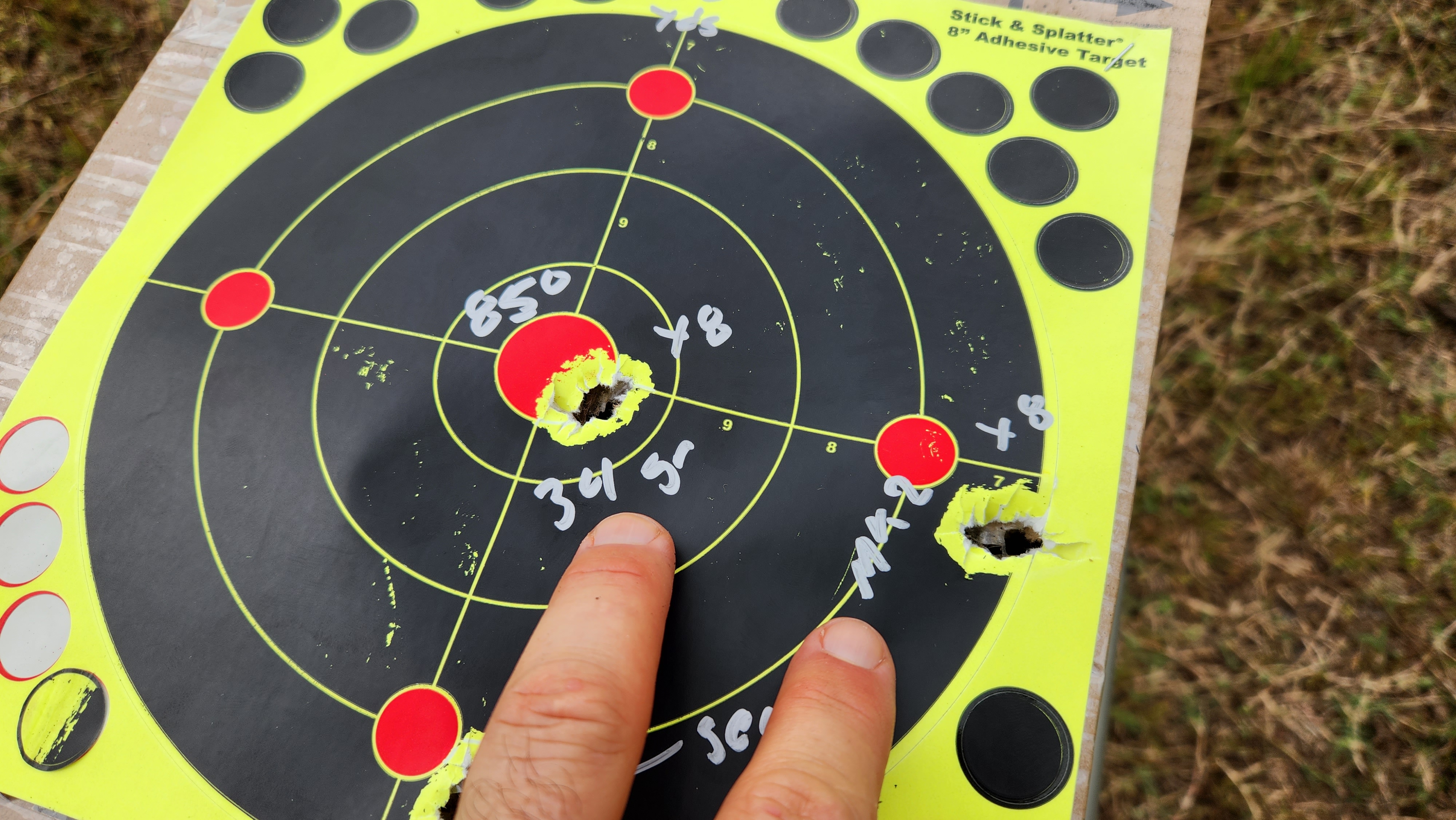

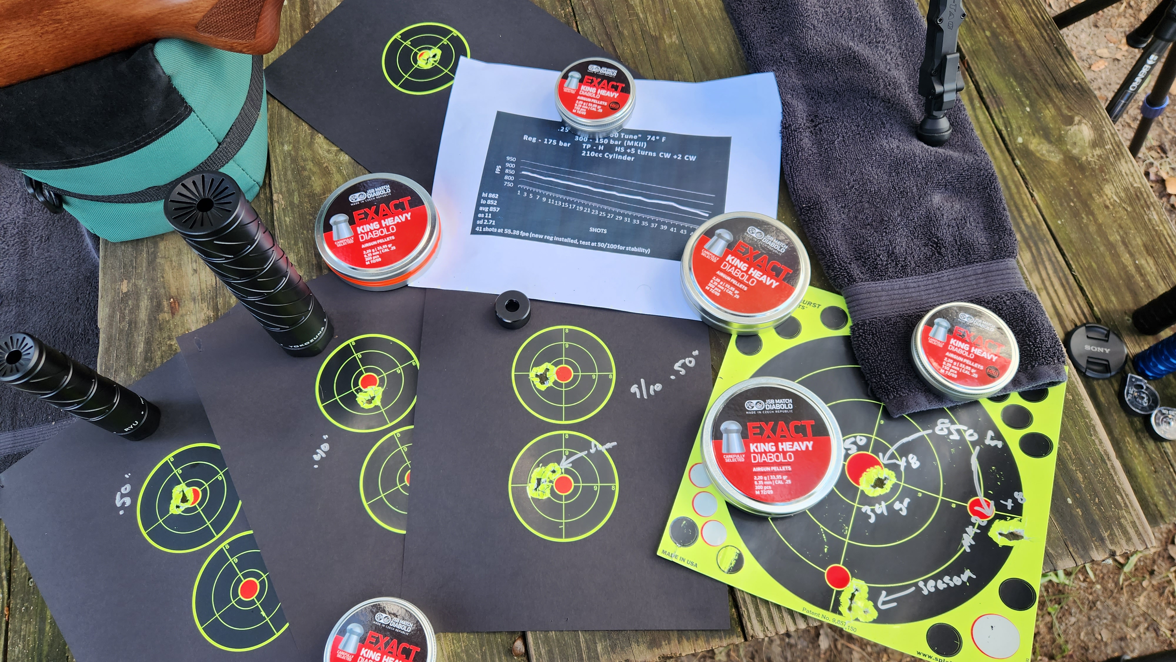

And oh my, did it perform! It ran so well that I found myself waiting on a cloudy/windy day so that I could scope-cam some video for y'all all the way out to 120 yards, lol. The below is 16 shots at 50 yards with both the mk2 and non mk2... in a 5-10 wind.
The 850 data to 50 yds.

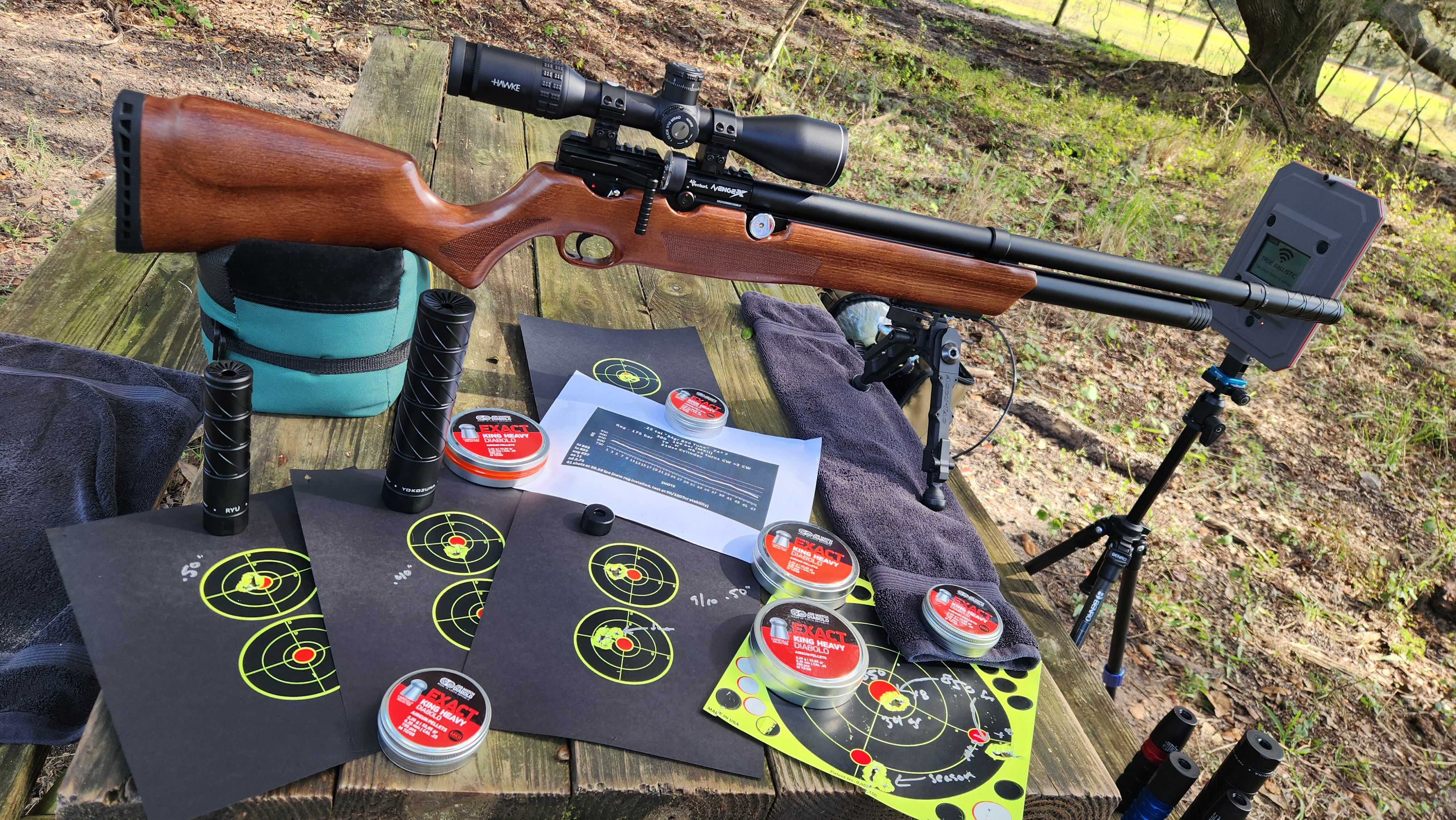

Me in the zone with the cameras rollin'... and testing the 850 tune out with moderators too.
50 yards results in a nutshell, once I turned the cameras on for the upcoming tuning guide video... in nasty 10-15 mph winds too. Encouraging.
Great tune/setup for 50 yards with the 34gr at 850 fps... and as it later turned out, 120 yards too.

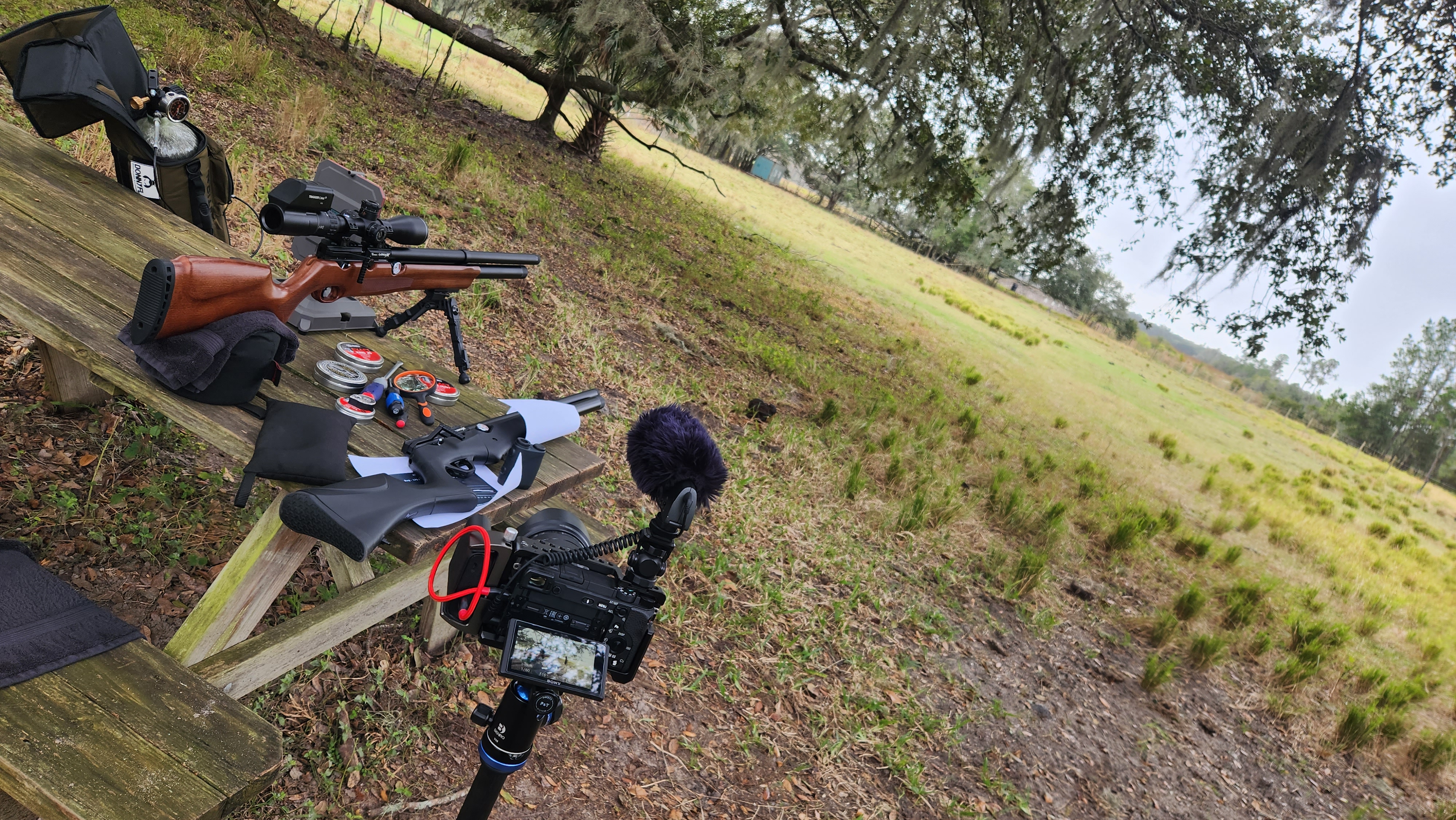

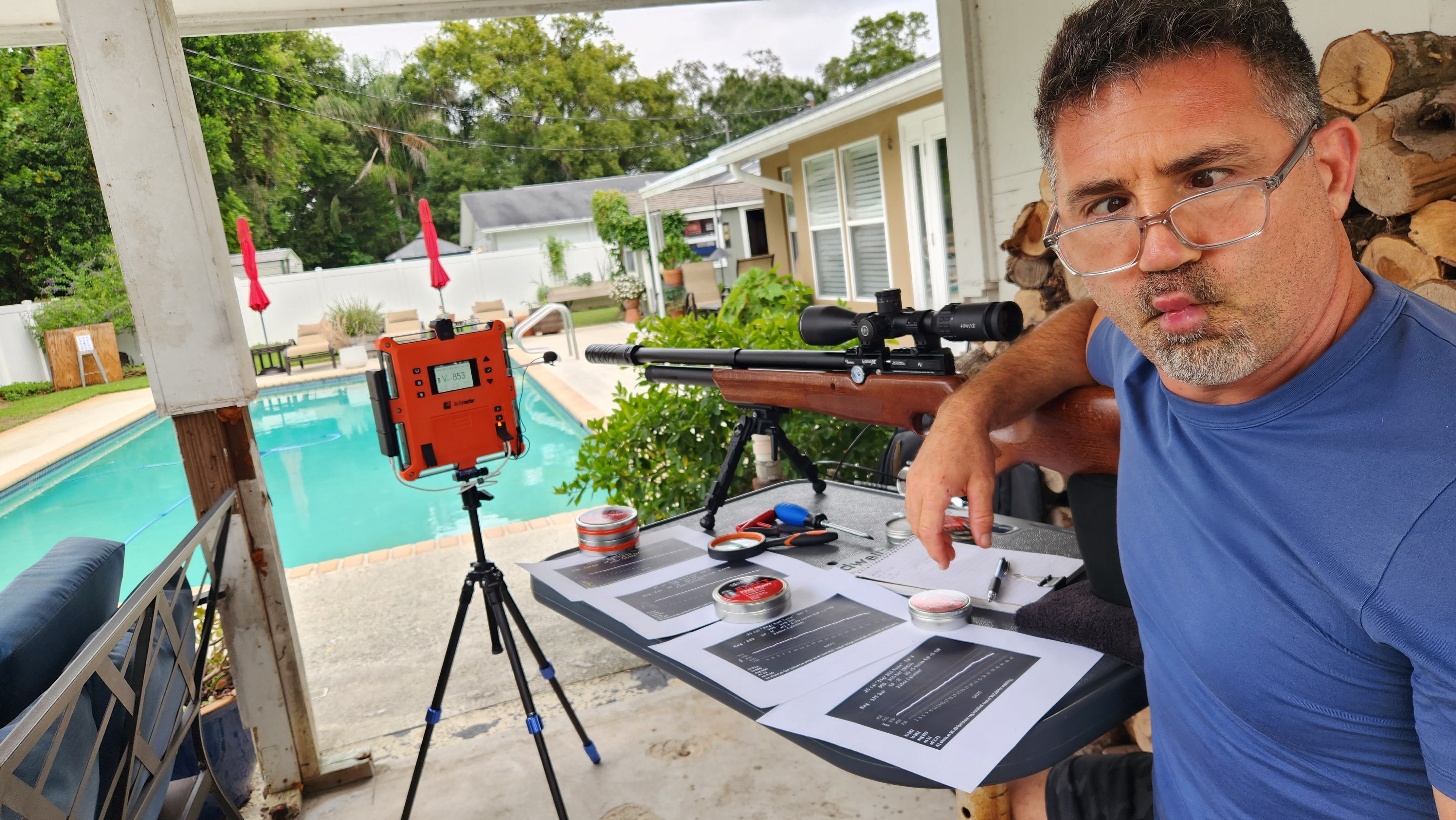

A nice cloudy/rainy/windy day to take out both guns (25.4gr gun and 34gr gun) and capture some 120 yard scope cam for the upcoming AEAC tuning guide video. 25.39gr gun shown.
Plenty of raindrops & wind... perfect for 120 yard video. 34gr gun hiding out under a wind-blown shot chart.

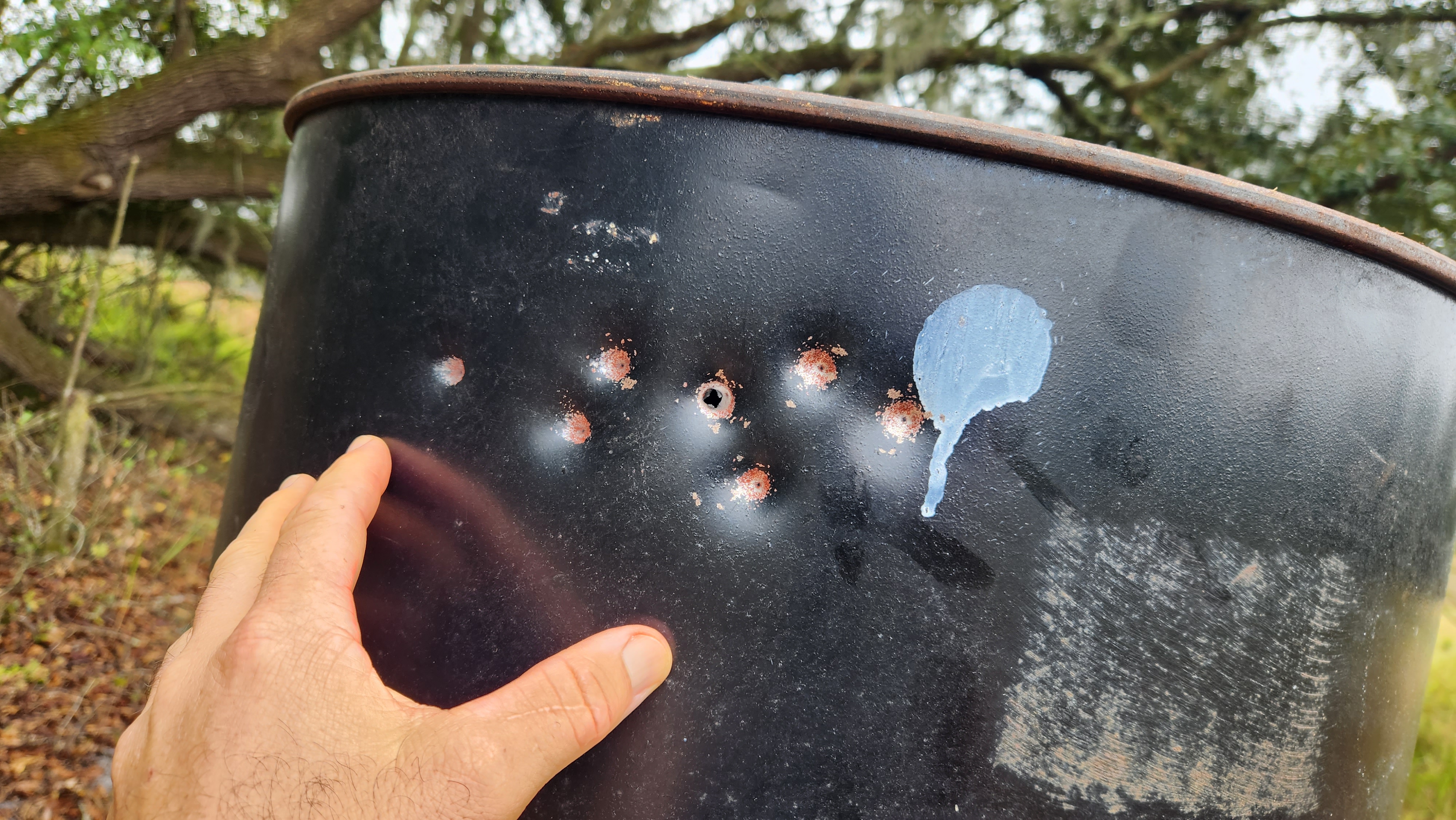

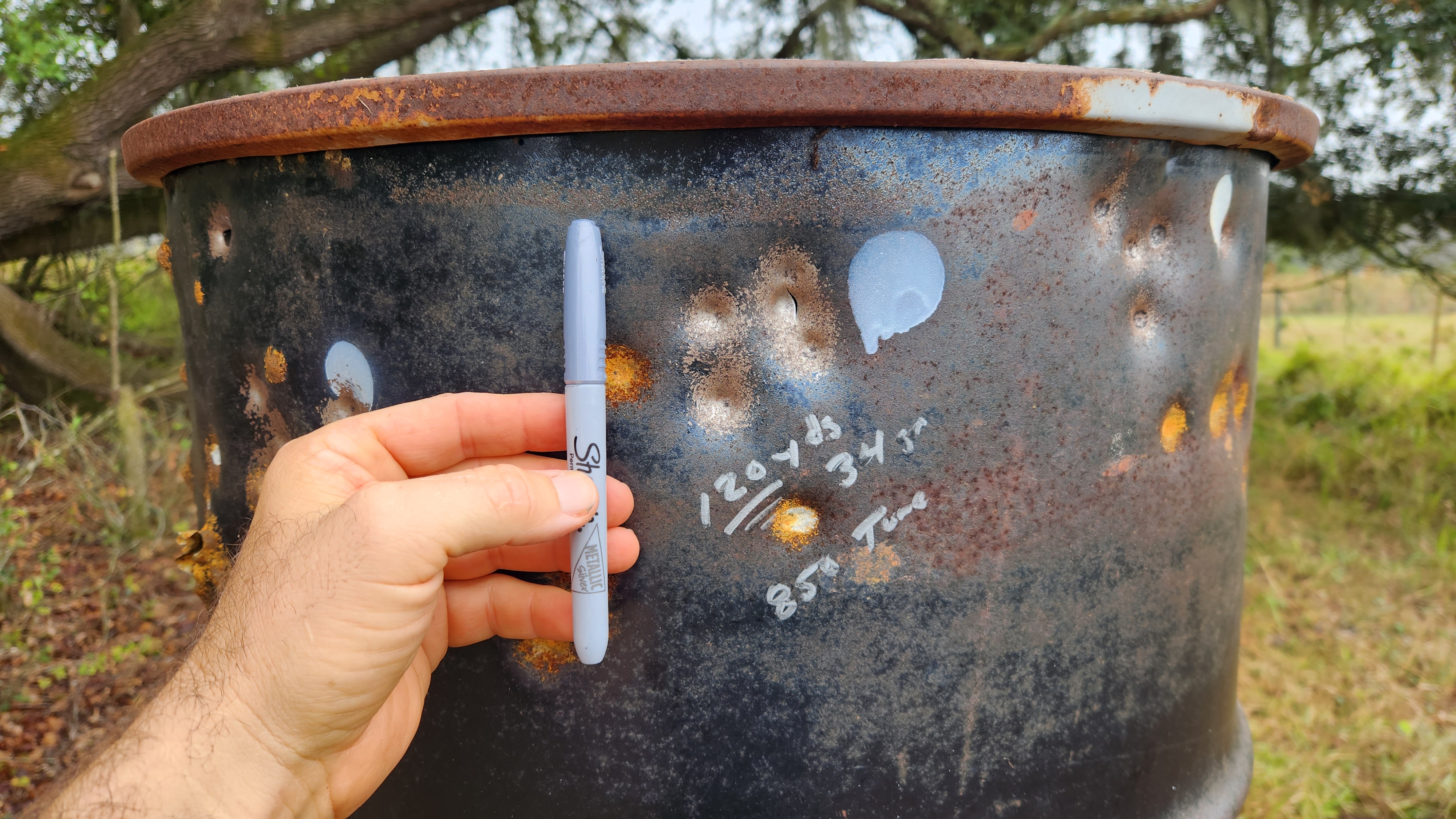

Black oil drum set up at 120 yards... 34gr gun up first.
5 shots at 120 yards with the 34gr running at 850 fps in a heavy cross wind.

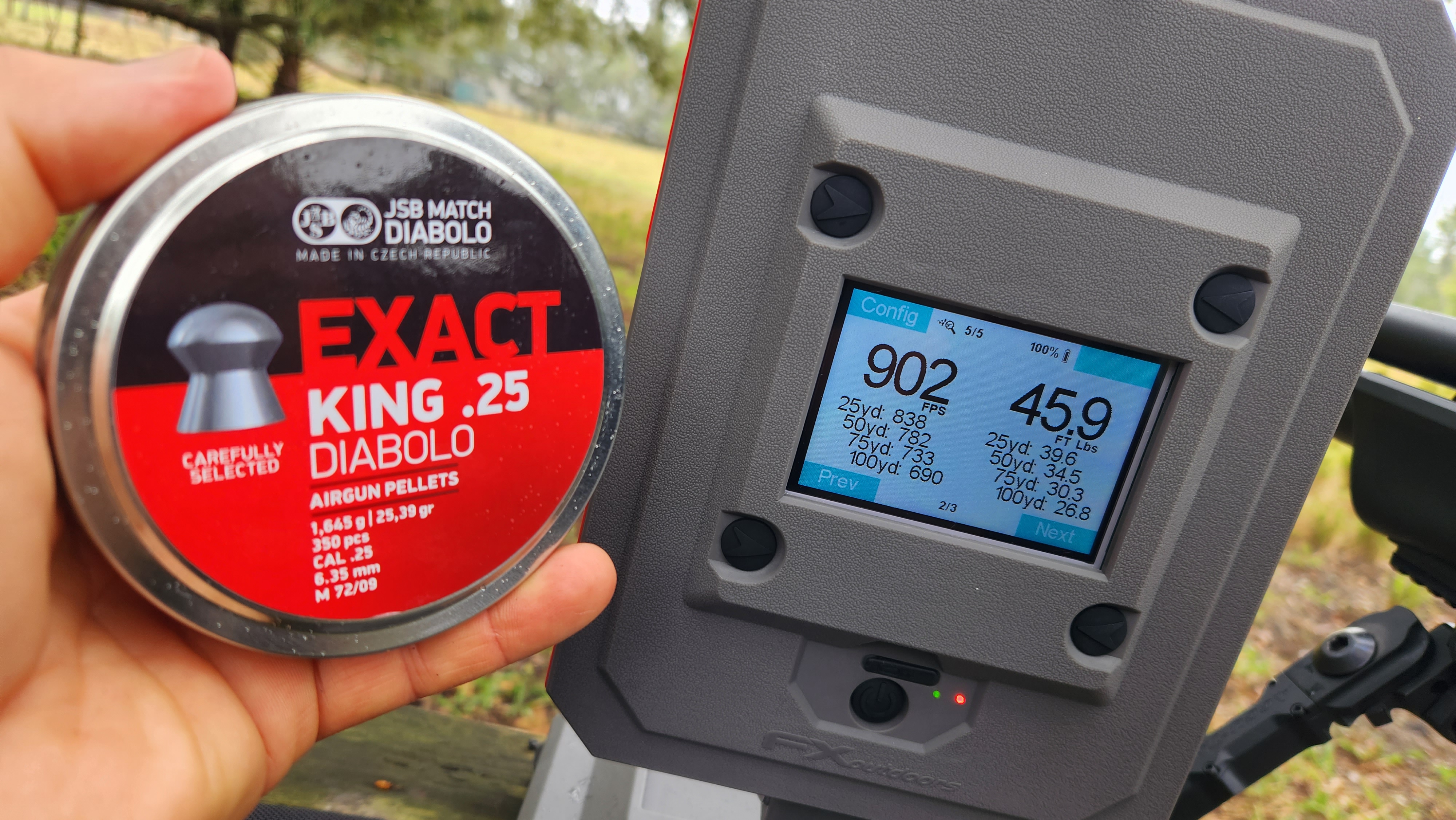

Trying the same exercise with the 25.39gr in a 16 mph wind gust and moving at 900 fps.
The 25gr here-to-there data.

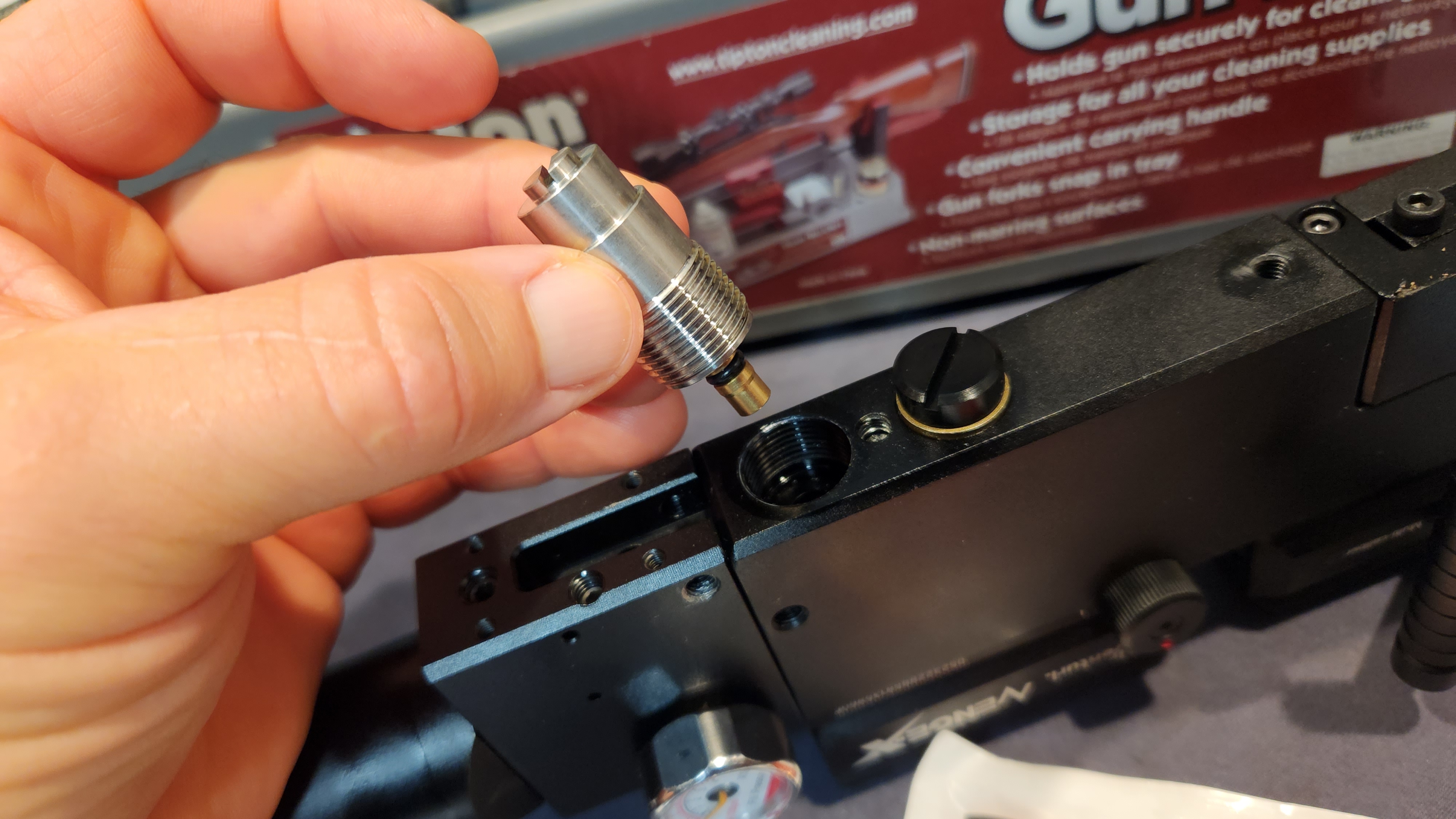

Reconfigured for the next chapter, "Slugs." 400cc bottle replaces 210cc cylinder. Learning begins tomorrow.
This takes like 5 minutes max by the way :).
