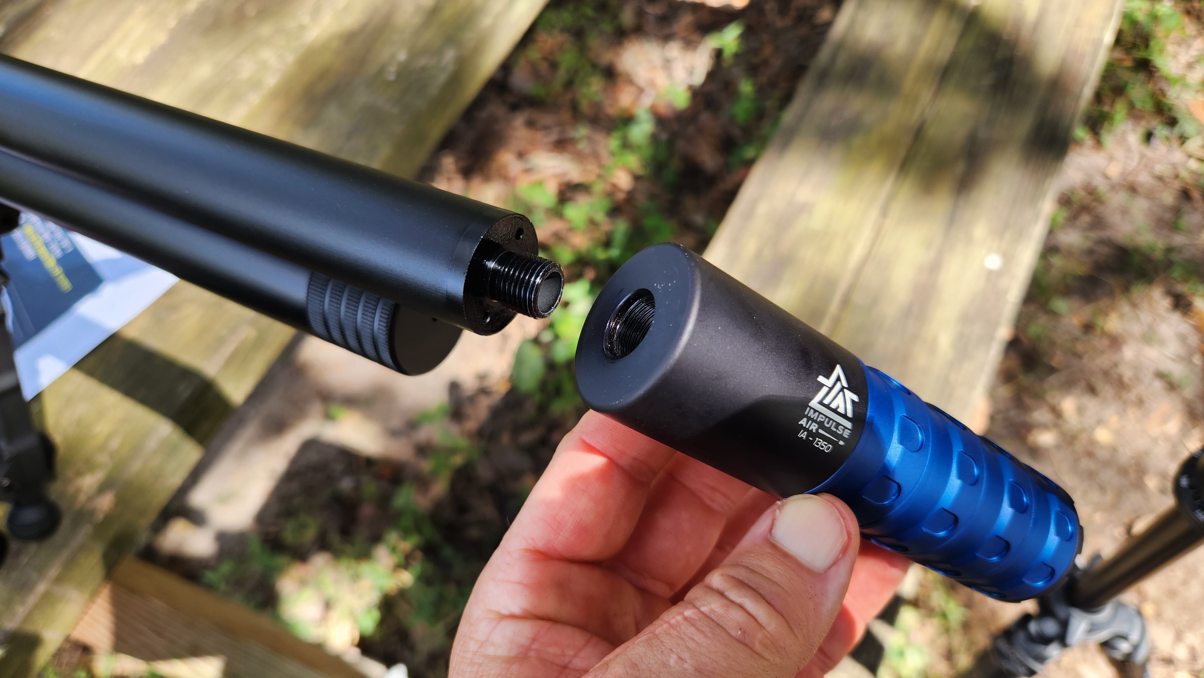

This moderator from "Impulse Air" also shined at 50 in wicked winds
Impulse Air moderator with the 910 tune at 50 yards - yum

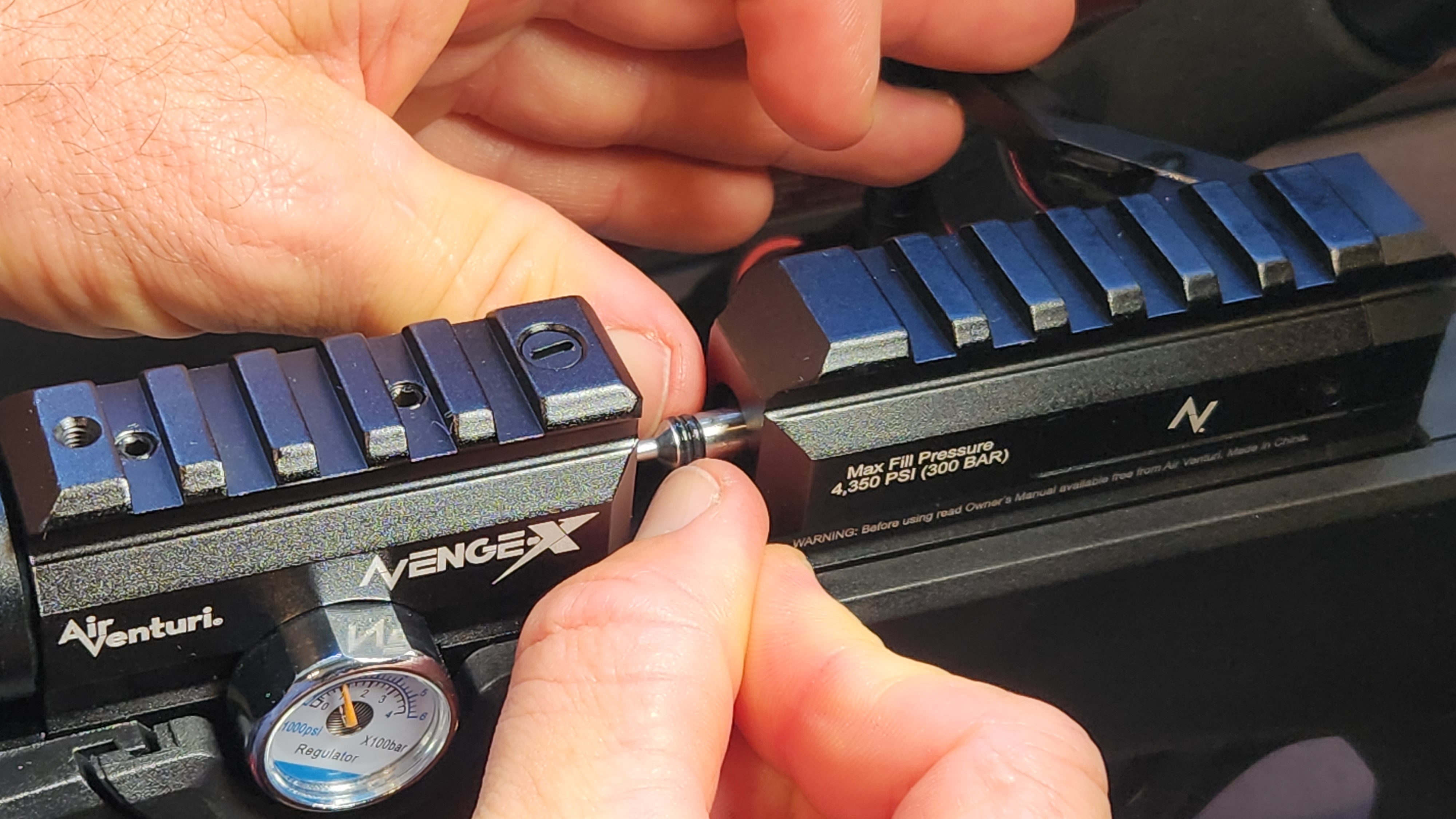

easy on/off for the Avenge X

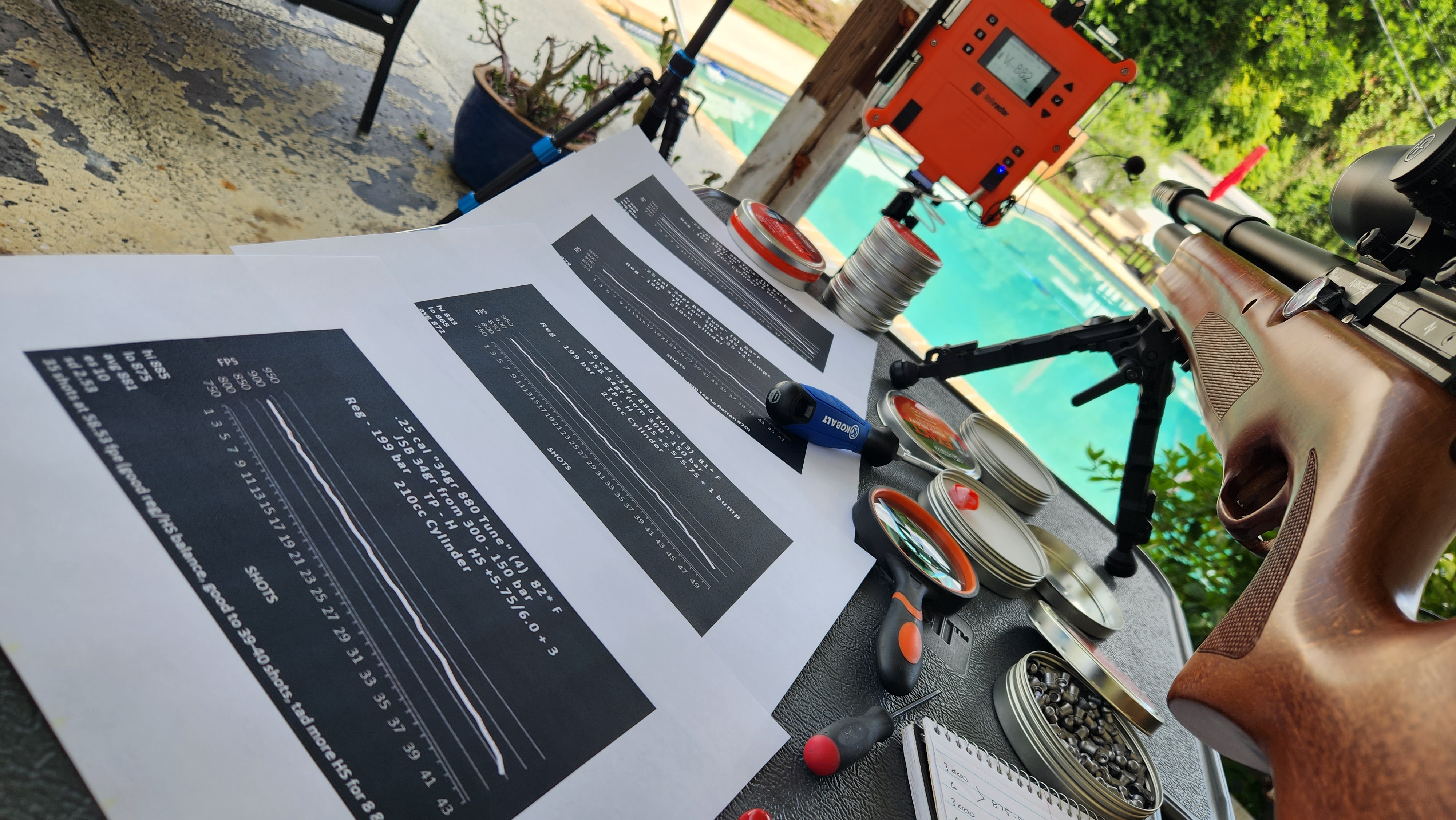

100 casual shots at 25 yards tuning

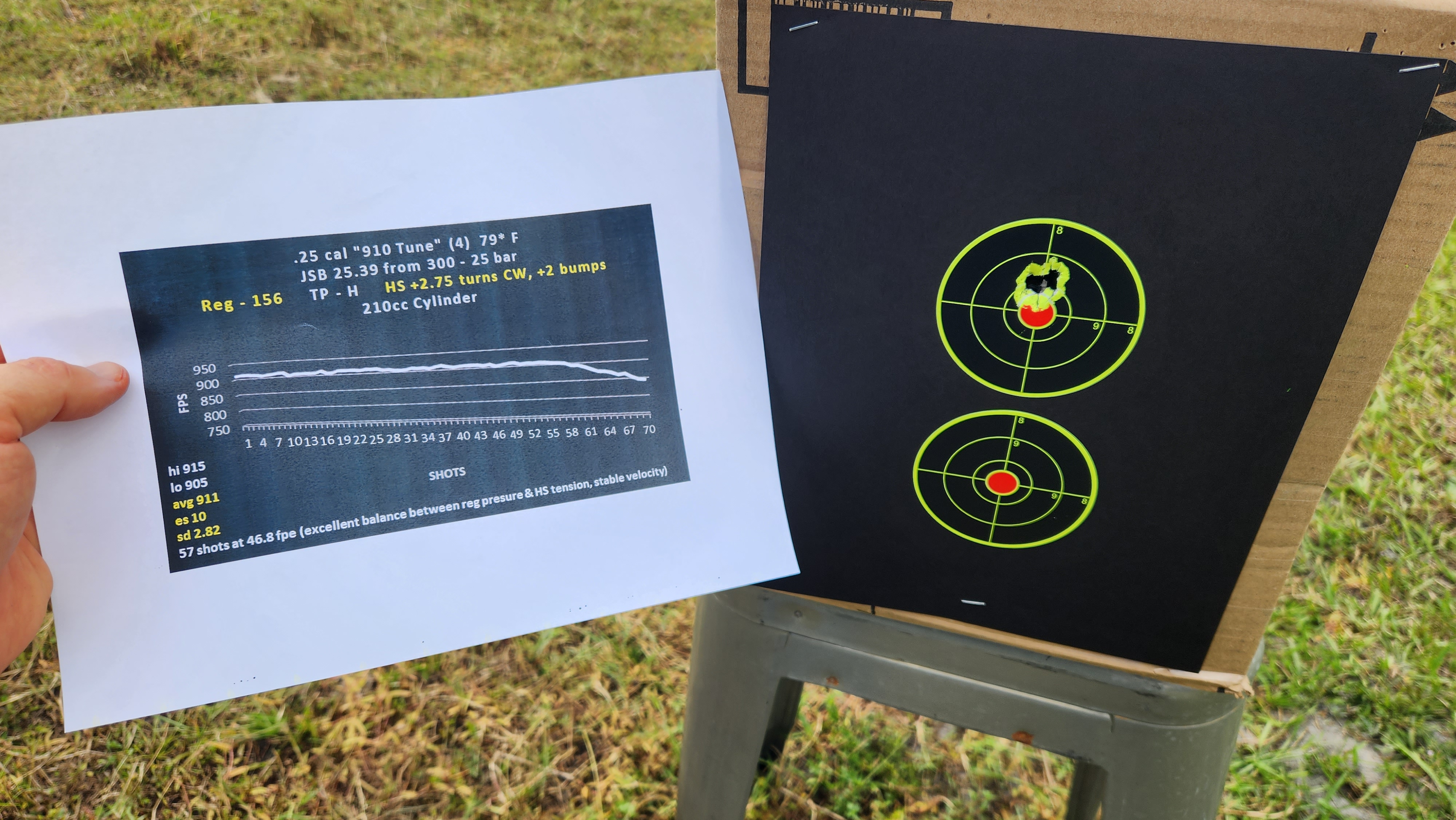

910 tune at 50 yds, light wind, morning warmup, off camera

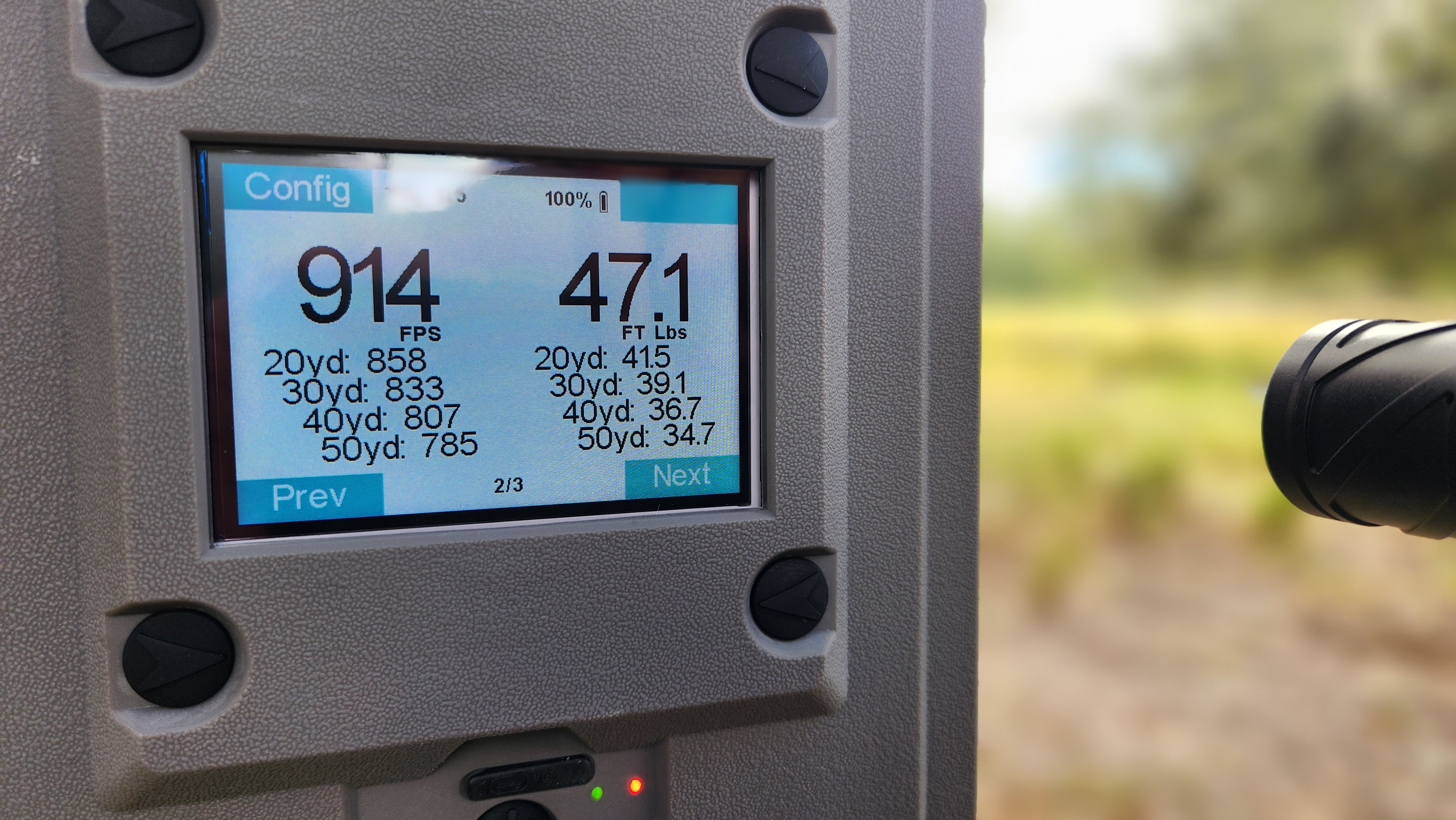

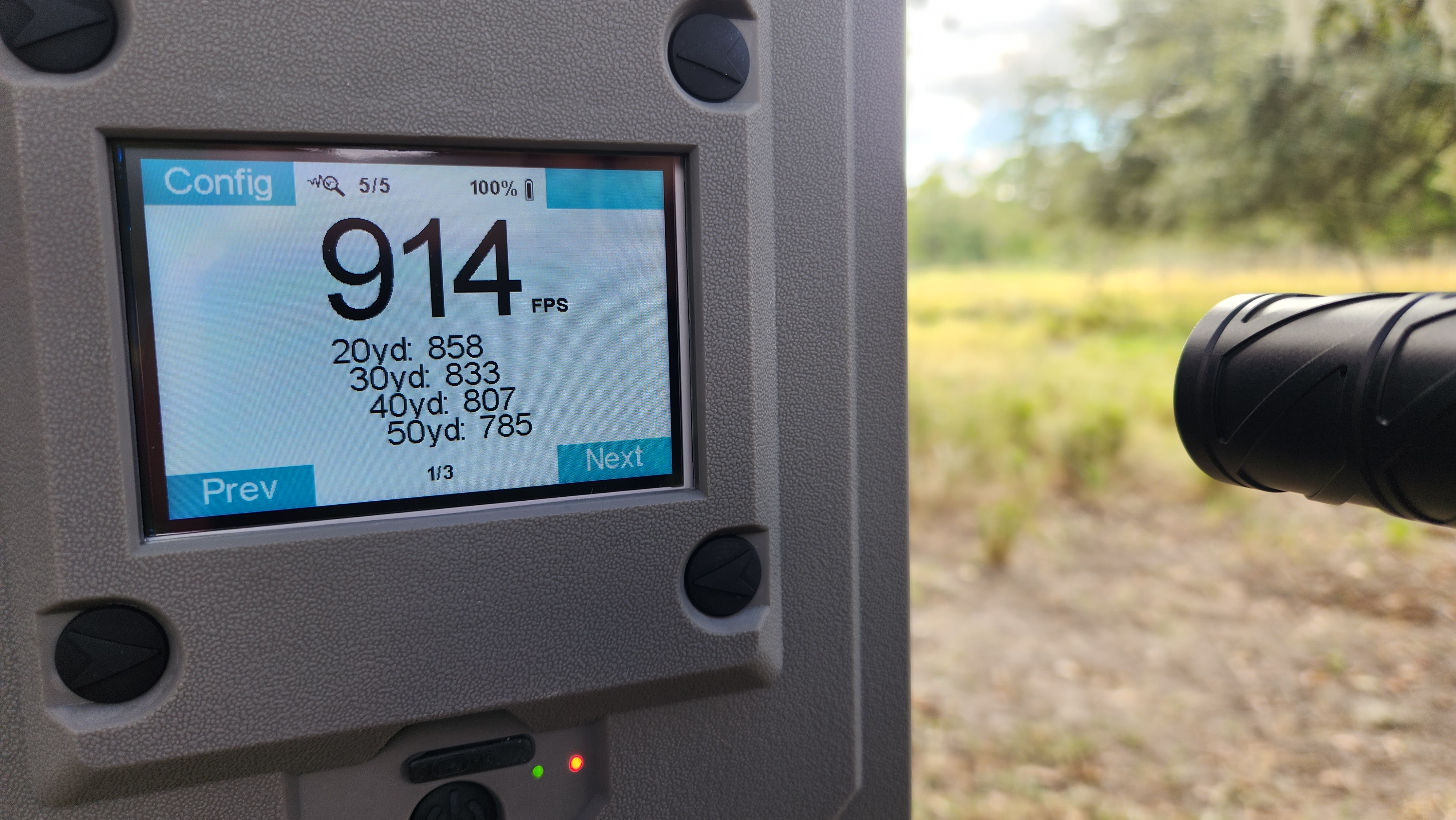

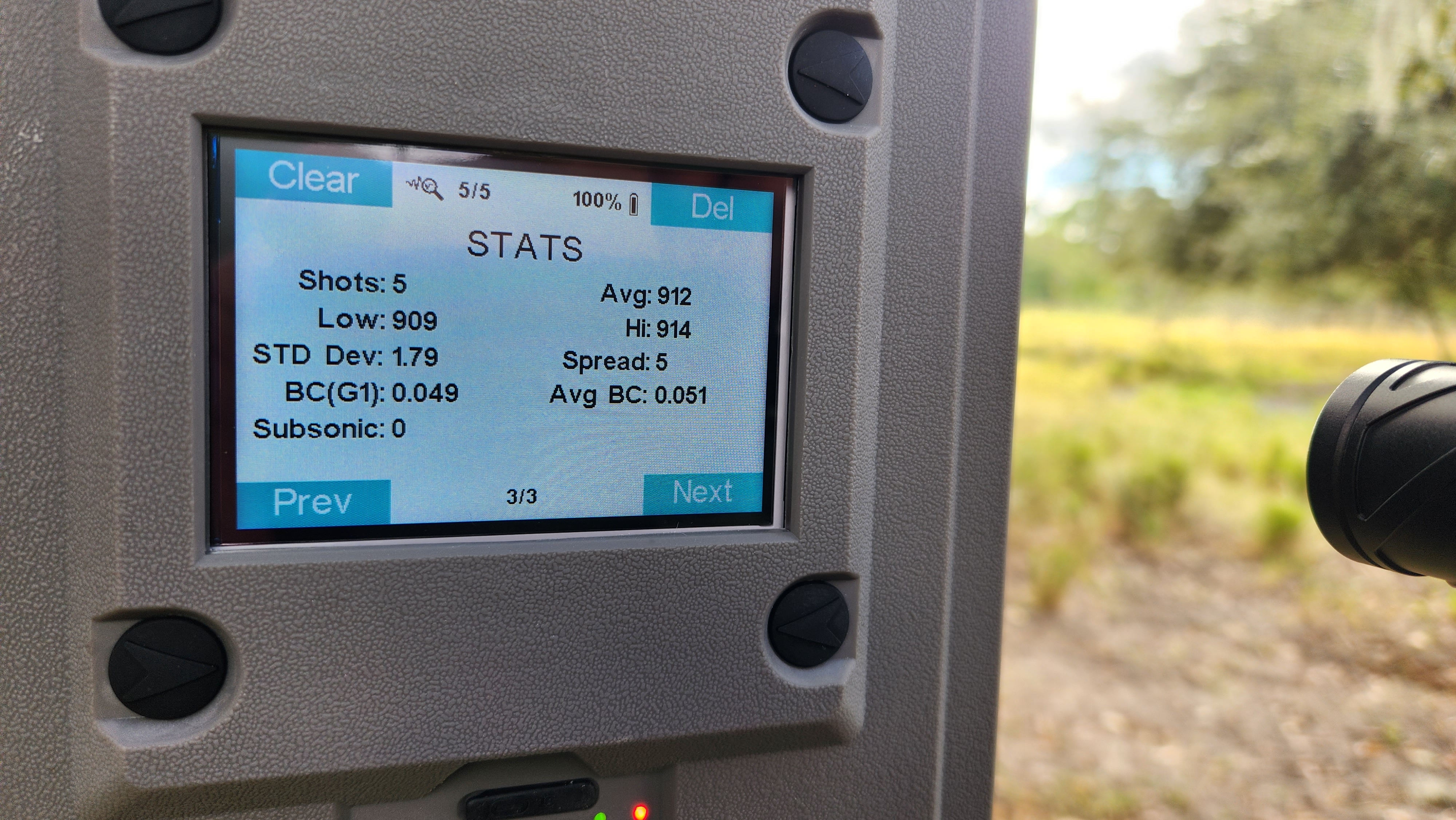

FX True Ballistic Chronograph telling us what's going on from muzzle to target
speed vs power from muzzle to target

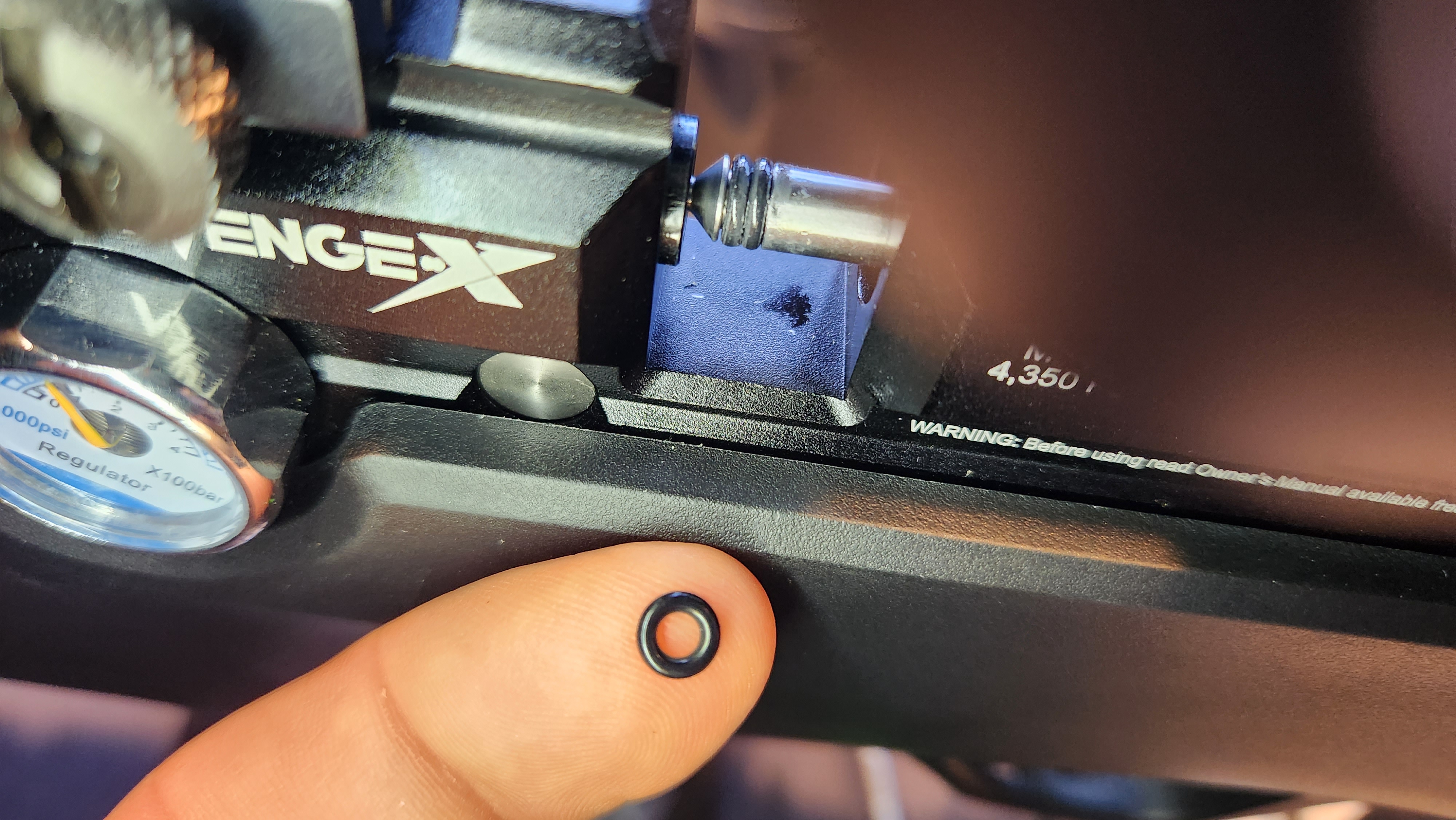

910 got that 25.4 shooting pretty slippery... notice the 5 ES and 1.8 SD?? ... gun was shooting this all day after a new set of bolt probe o-rings
worn down o-rings after 3,000 shots of test & tune still worked good but new ones brought the ES & SD of the 910 tune to 6 and 1.8
new o-rings installed, thank you for keeping me going Tyler P.

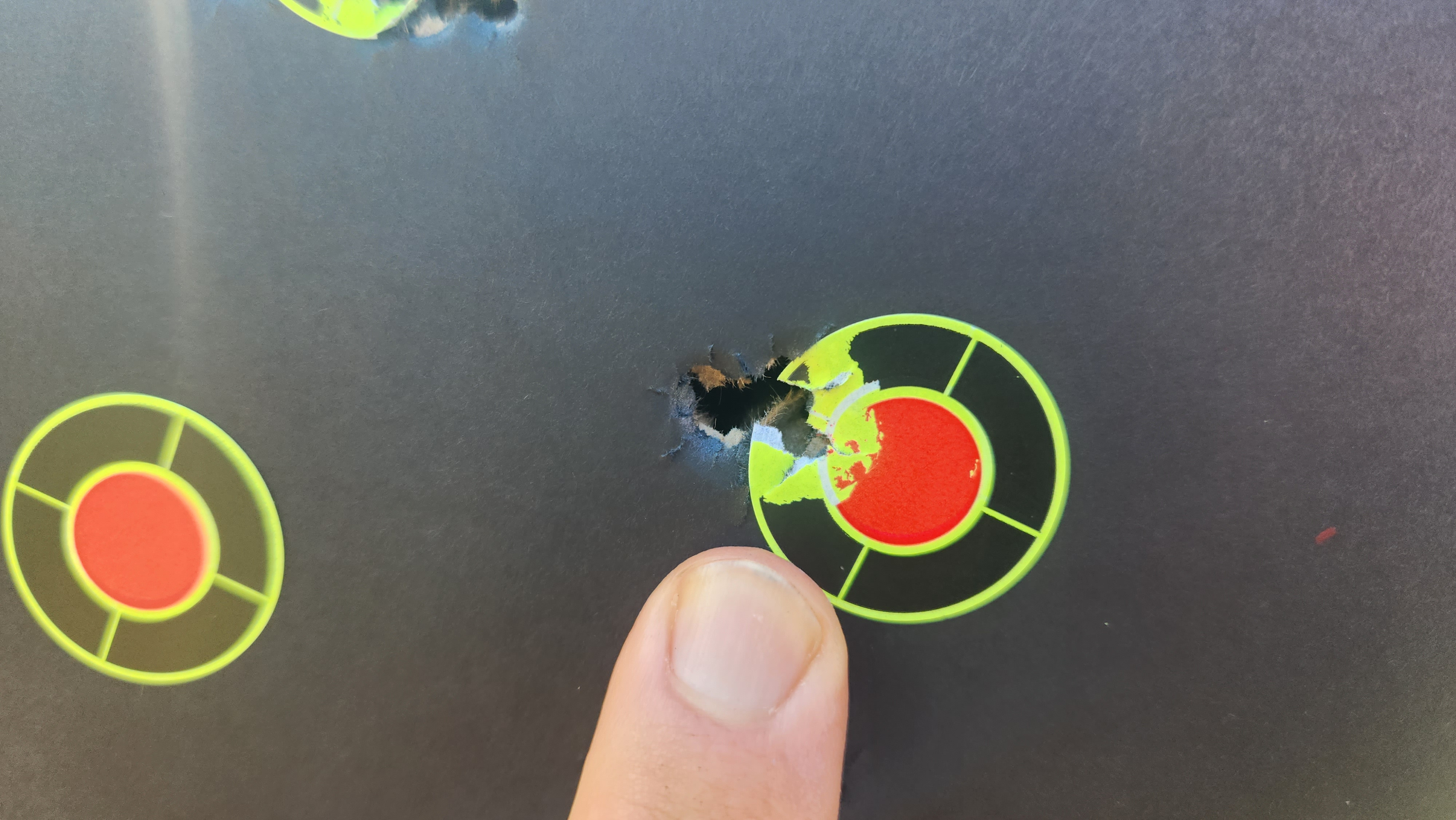

what the Avenge X .25 cal can do at 50 with the JSB 25.4gr... groups are with & without an aftermarket moderator
yesterday was a good day proofing a lotta work out before the cameras
I'm calling the 25.4 "DIALED" 🙂

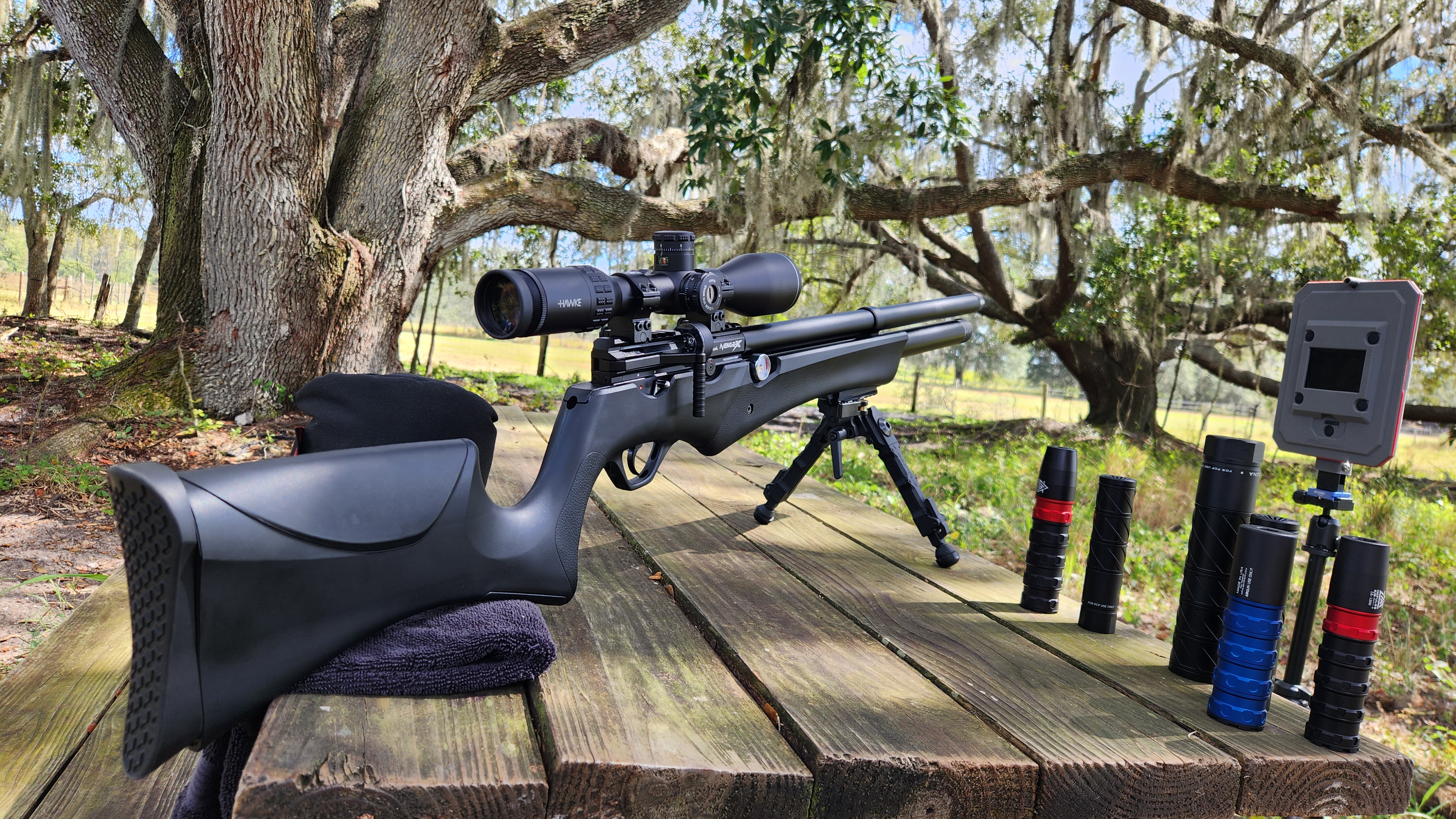

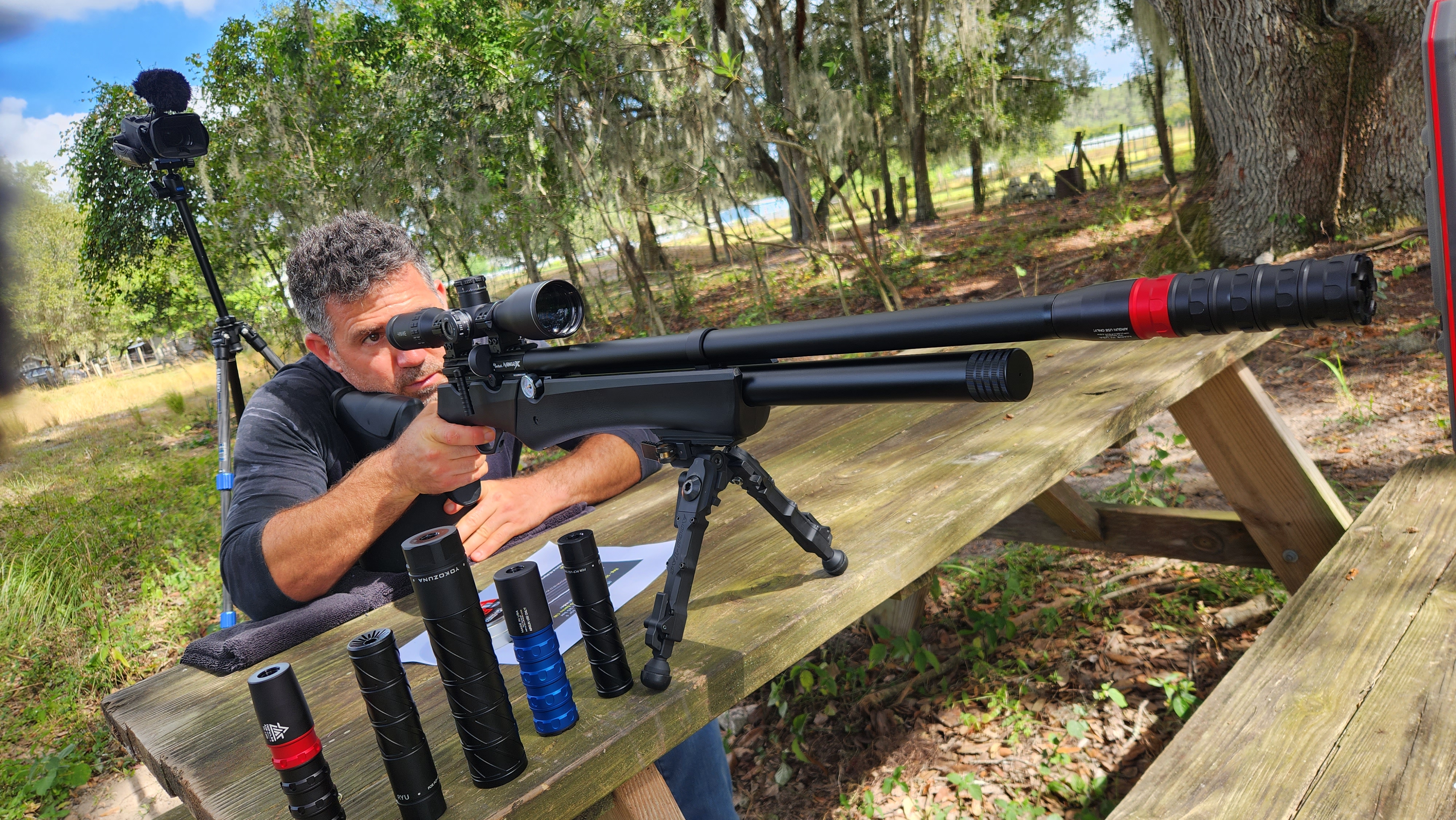

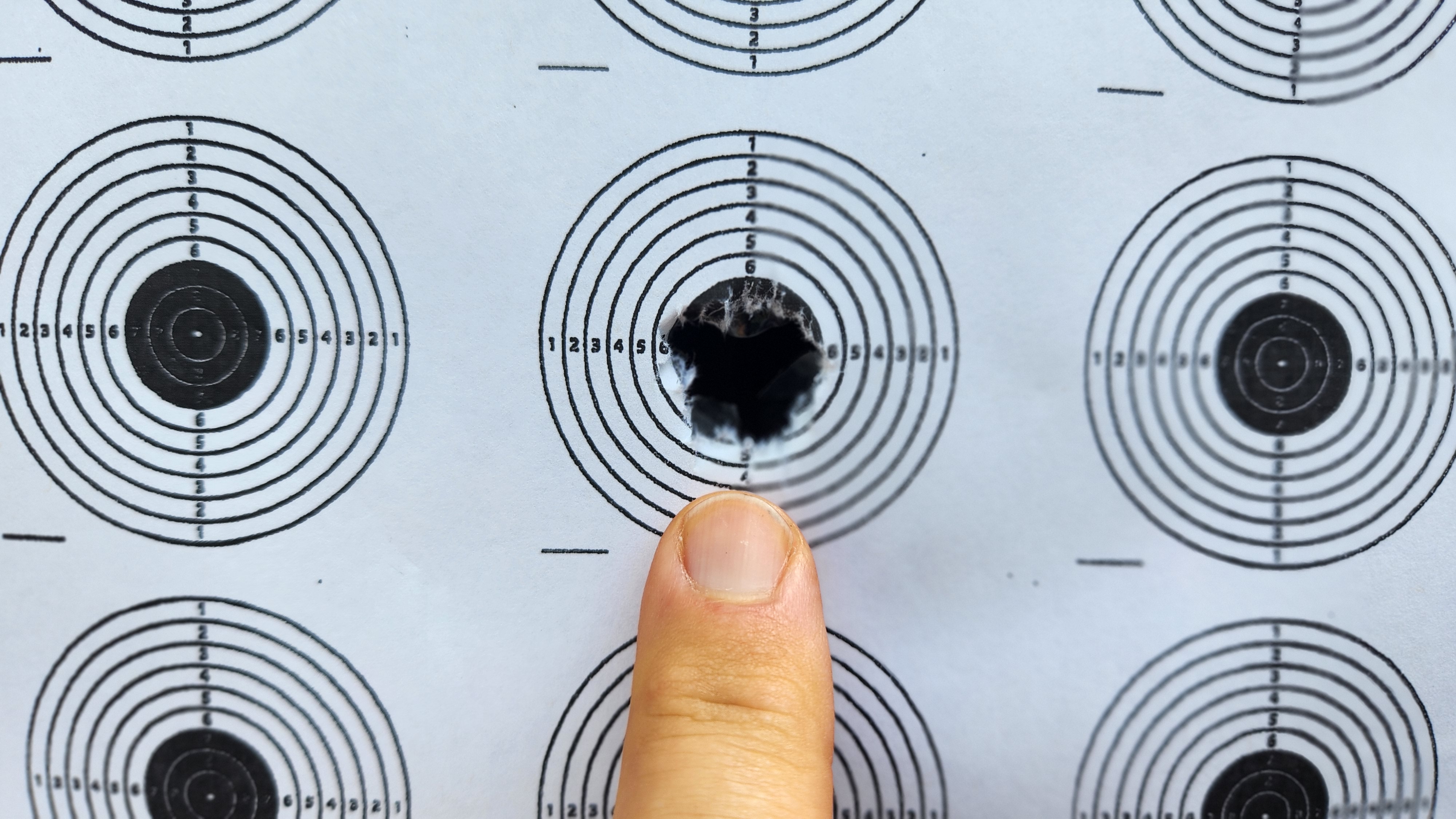

what the Avenge X .25 cal can do at 50, in the wind, with the JSB 25.4gr... groups are with & without an aftermarket moderator

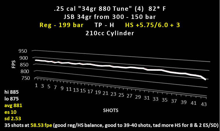

cant wait for the 34 gr test/tune. So do you think amongst all the impulse gave the best results?
Here's my 34gr tune starting place. Tomorrow, I'll be heading out into the country to field validate & refine it.
I filmed both the new DonnyFL's and the Impulse Airs all drilling holes at 50 yards so I couldn't say yet which it likes best. The gun runs good without them too. For certain the added weight out there is welcome though cuz of flip. All really settled the gun down nicely on the bench. The X is also startlingly quiet unmoderated... even at 50 fpe.
Steve
