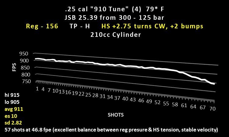

All I can say is WOW! that shot string of 67 is impressive. So...I'm intrigued by the "HS in balance with reg pressure". I don't think I've ever heard of that, but I'm impressed by what it does. So how does a person go about figuring and putting HS and Reg in balance? And thanks sooo much for the reviews. I'm gonna have to look at these.

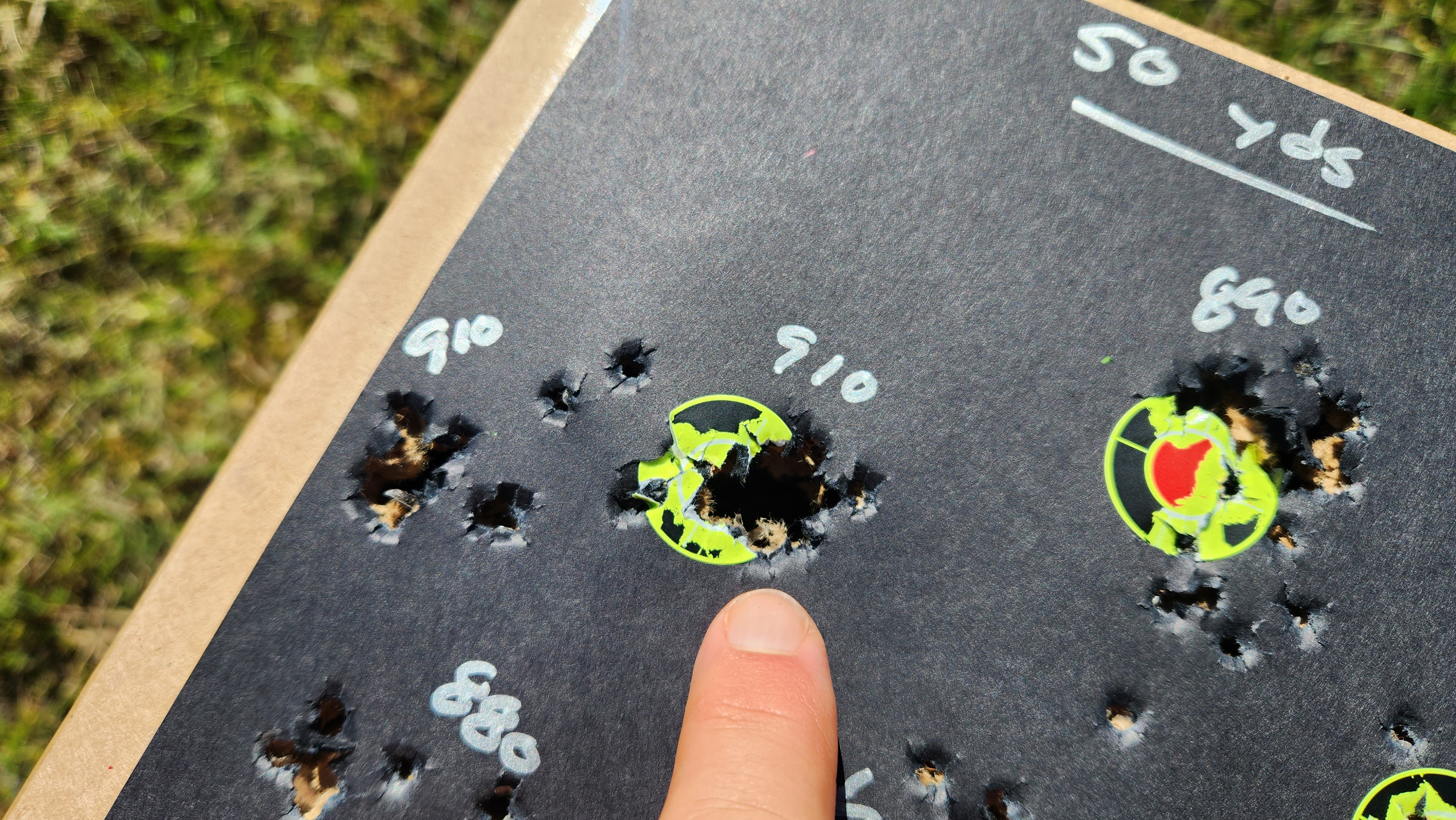

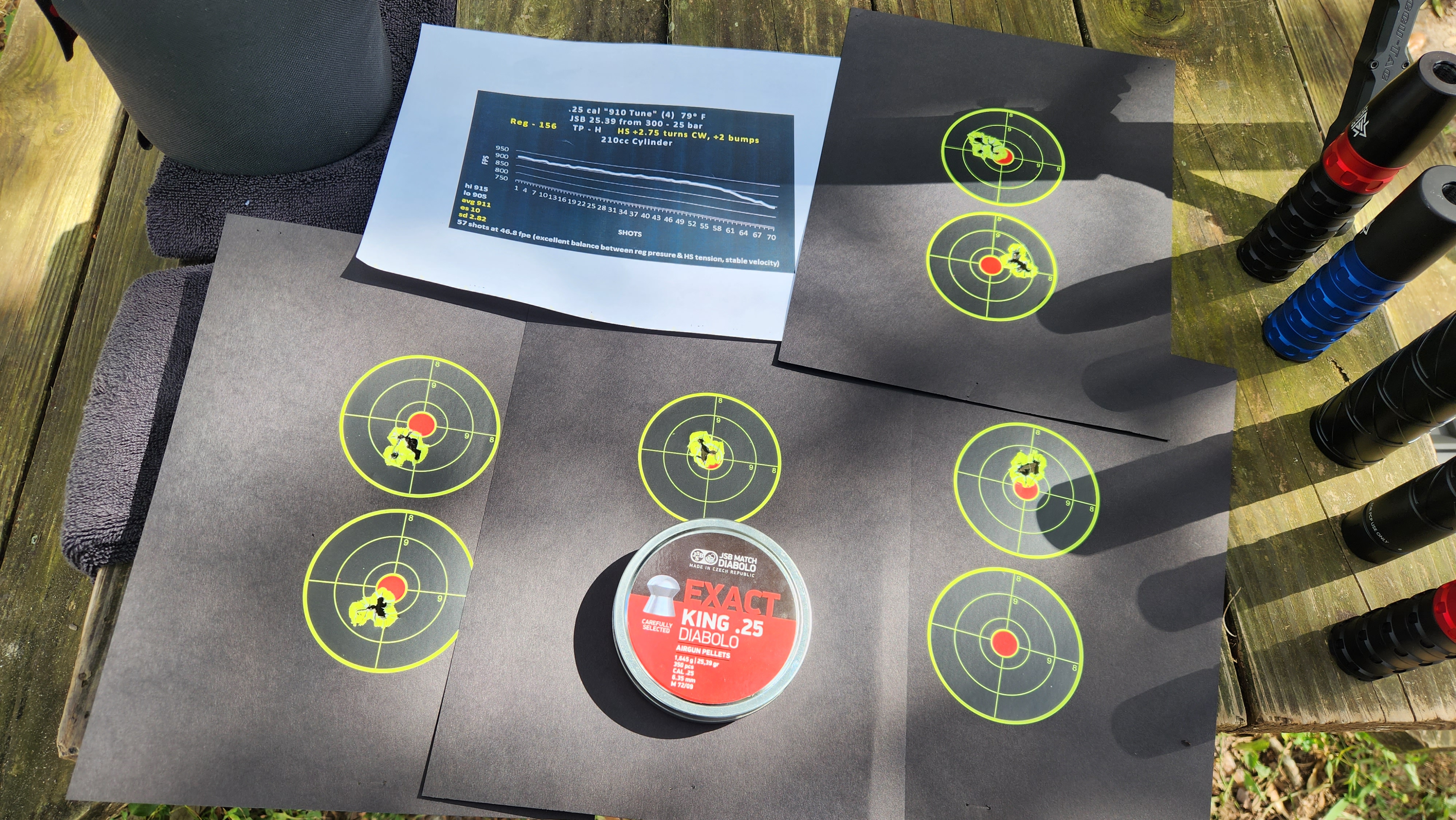

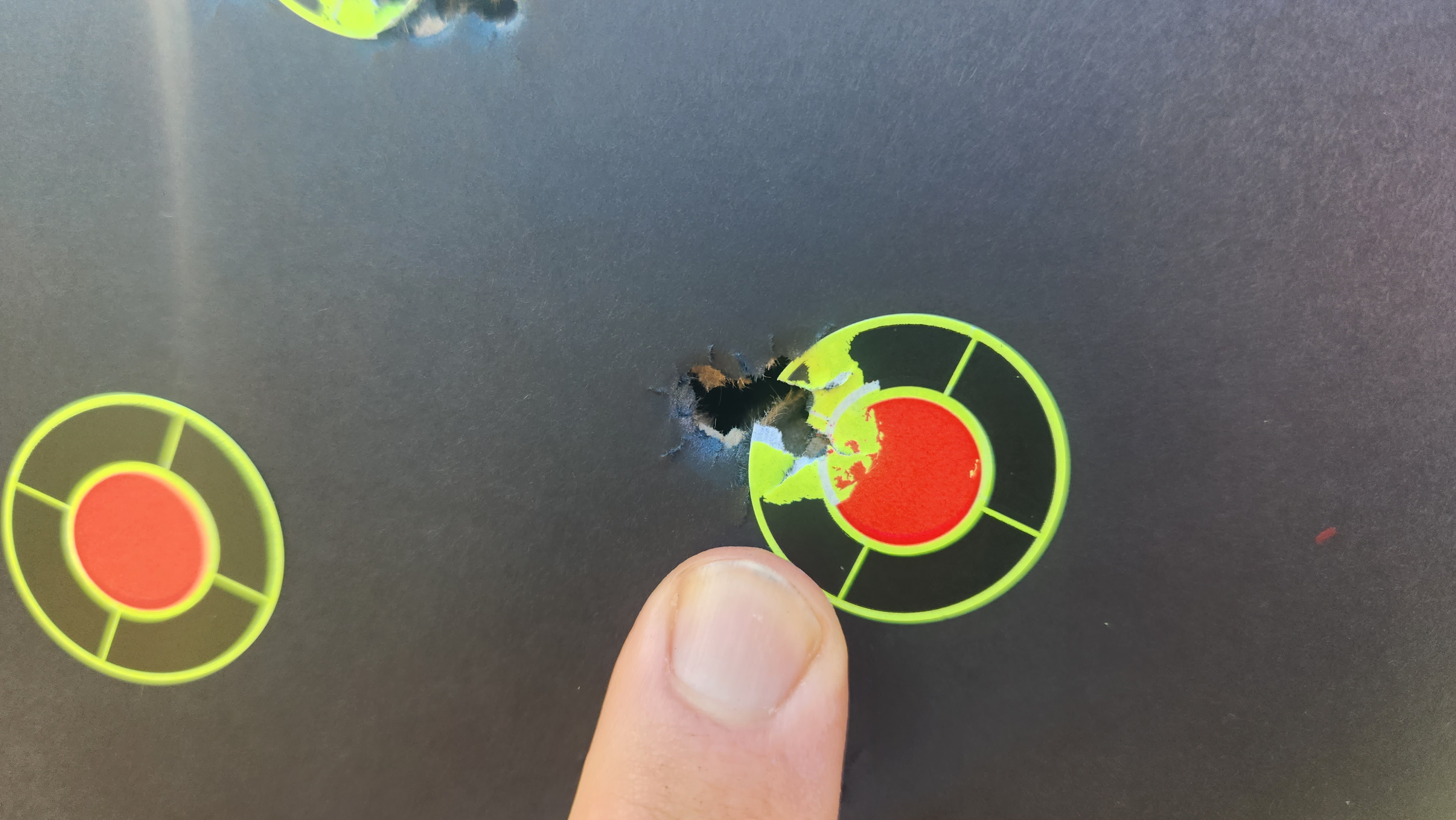

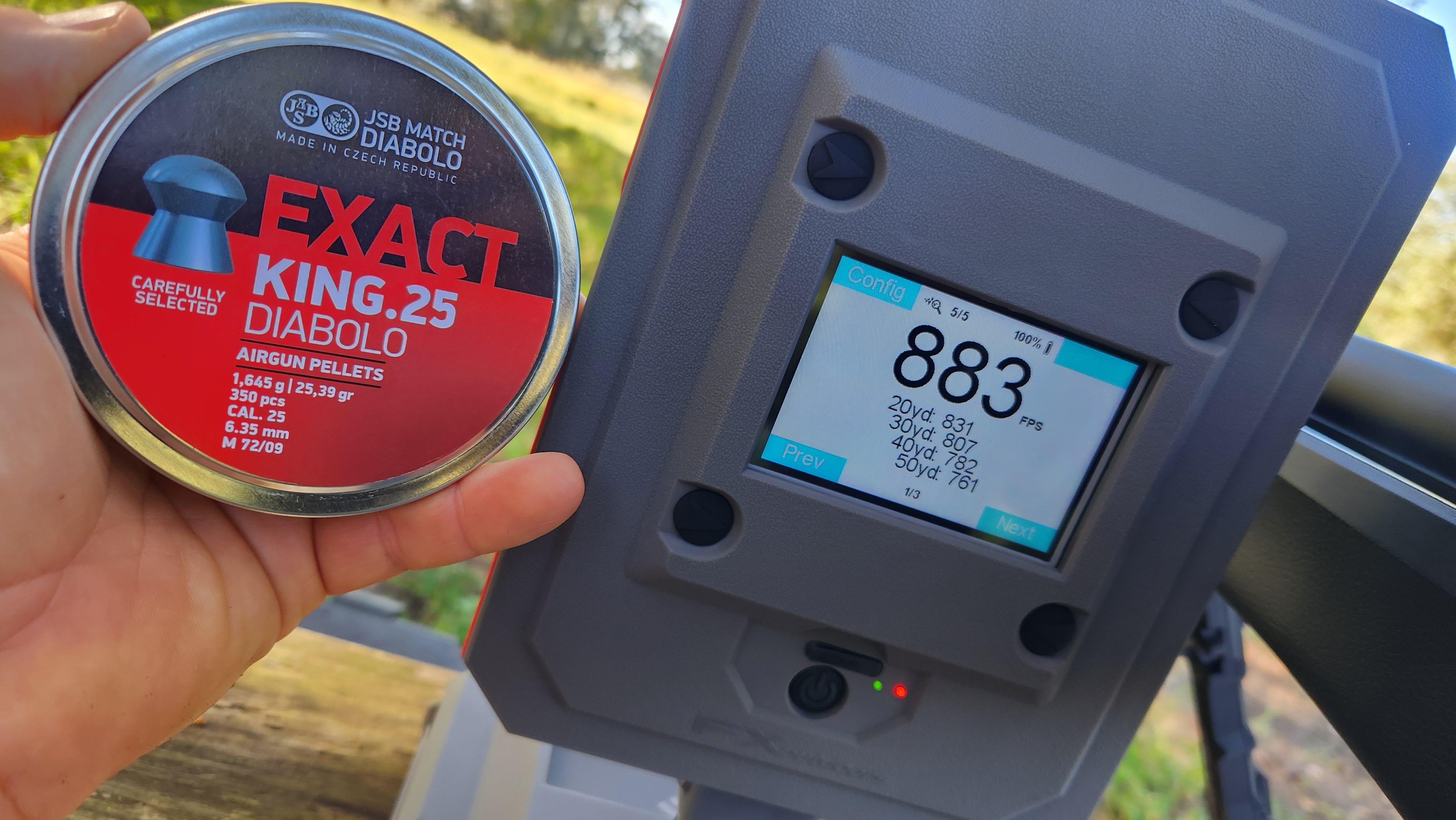

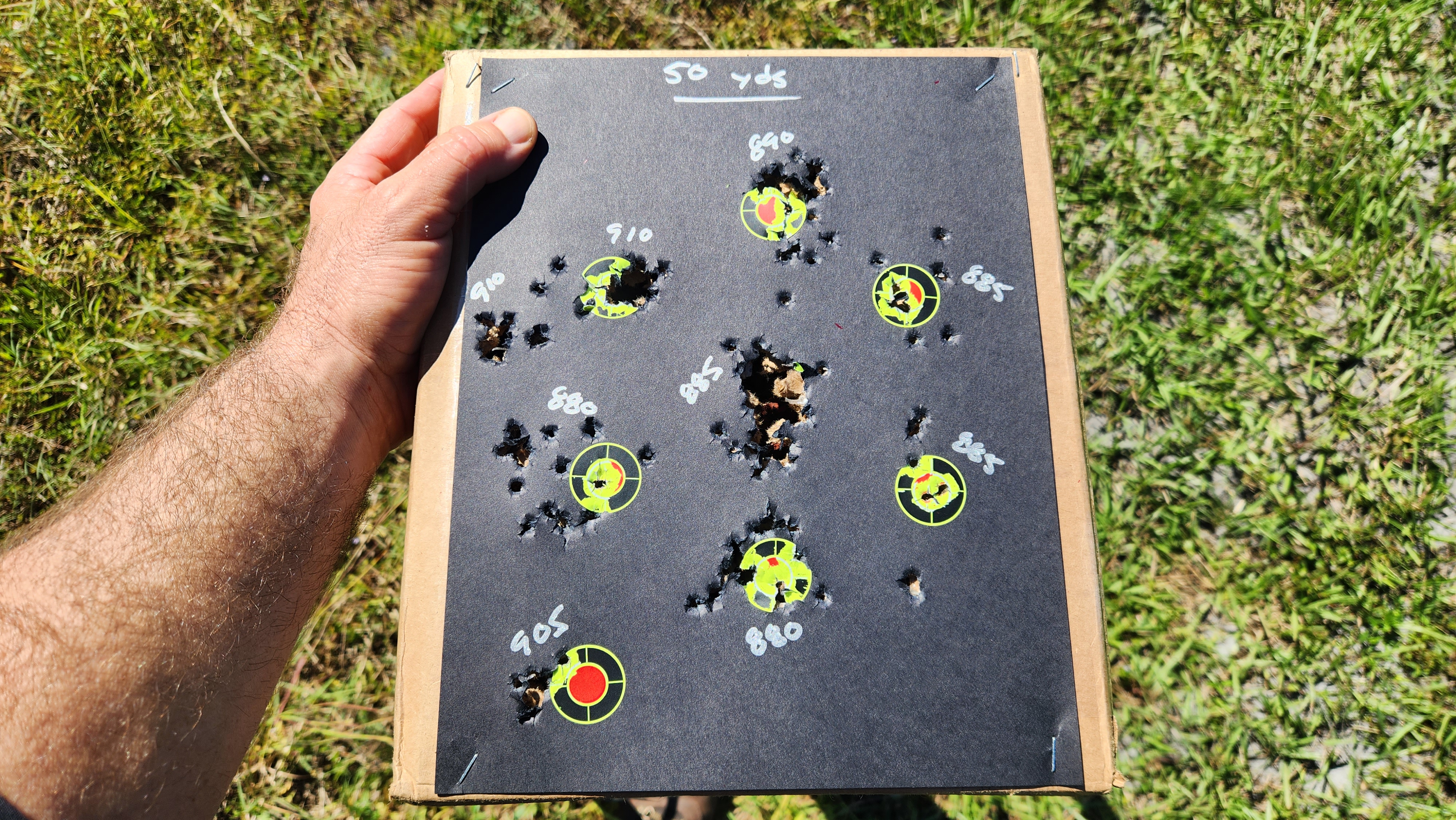

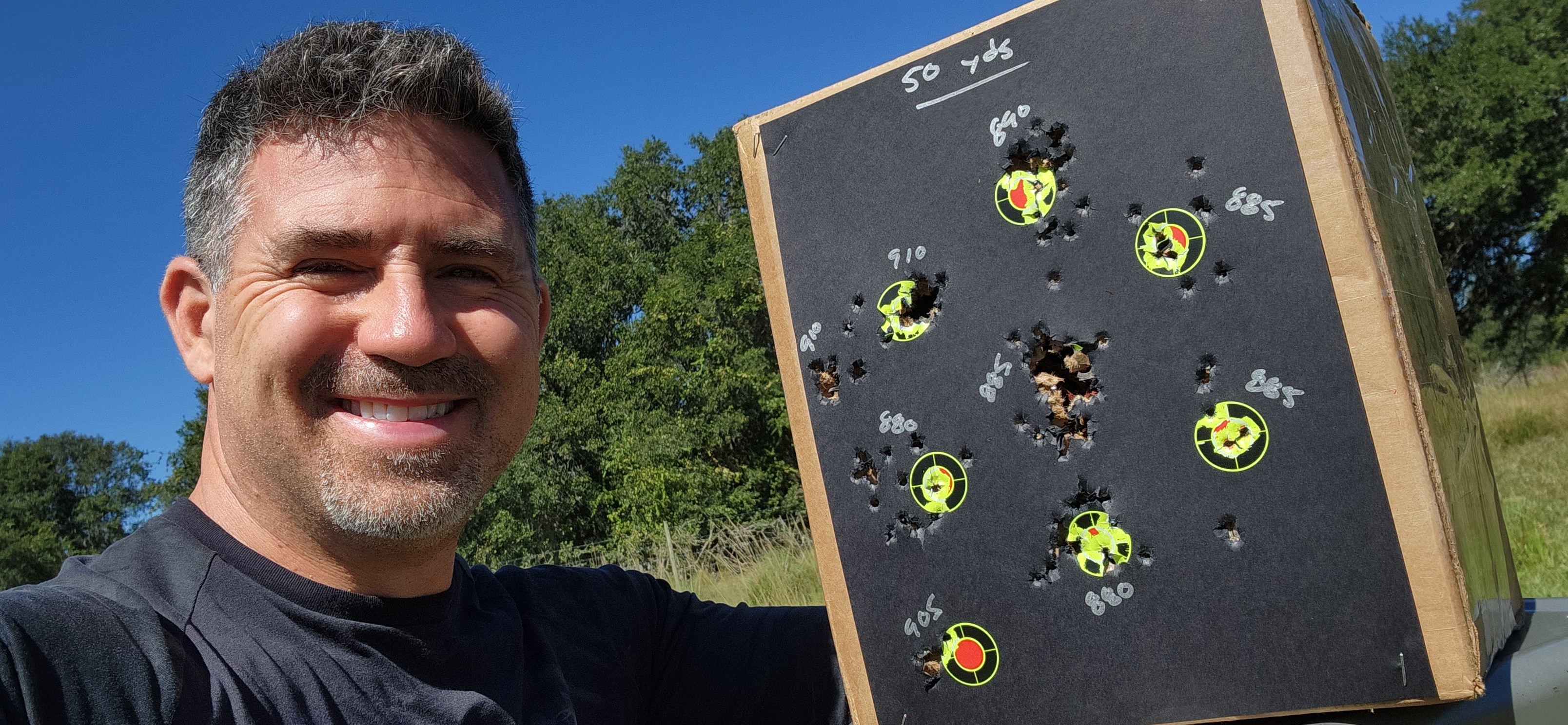

My beautiful "885 Tune" for the JSB 25.39gr variants turned out to be a total dud out of Air Venturi's 1:24 barrel. It was corkscrew & wobble city all the way to 50 yards, and while the pellets were still landing in about a 1" group, they were kickin' & screamin' all the way there. It wasn't pretty and any breeze further aggravated things. The takeaway? Don't assume the right velocity and build a tune around that, go out and search for a stable speed in a strong wind at 50 yards plus, THEN build a tune around THAT velocity. So that's what I set out to do.
First Tune = total dud for pellet stability
885 Tune at 50 yards in no wind - lots of wobble & corkscrew - no predictability for doping

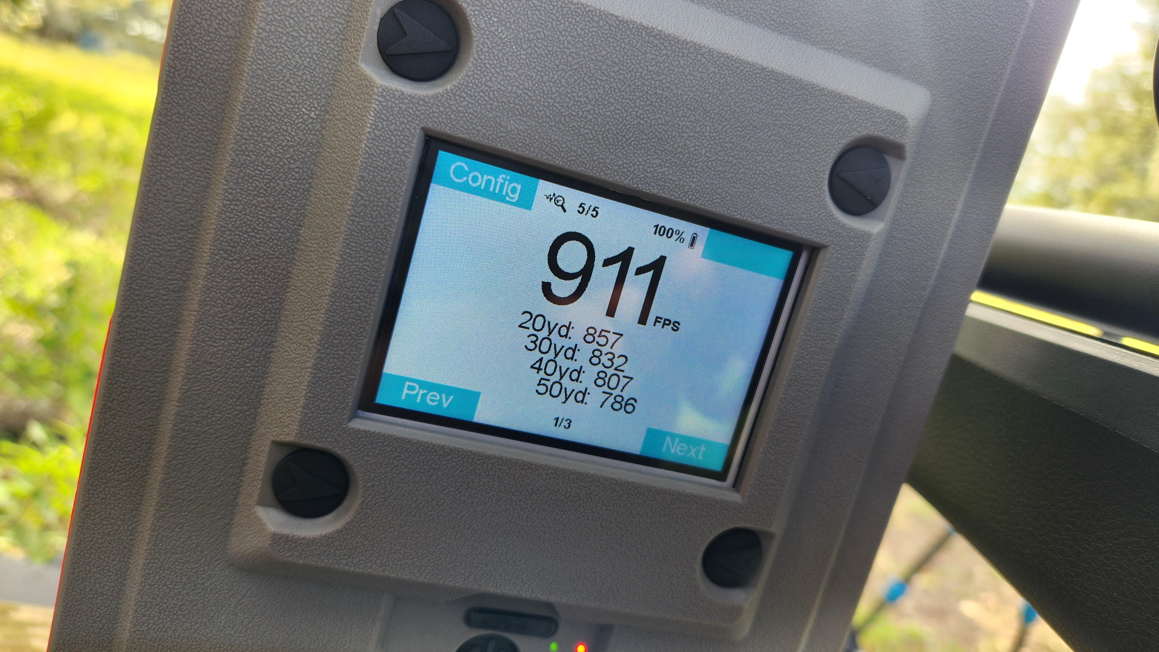

Velocities on the way to 50
Me pretending to be happy with the result.

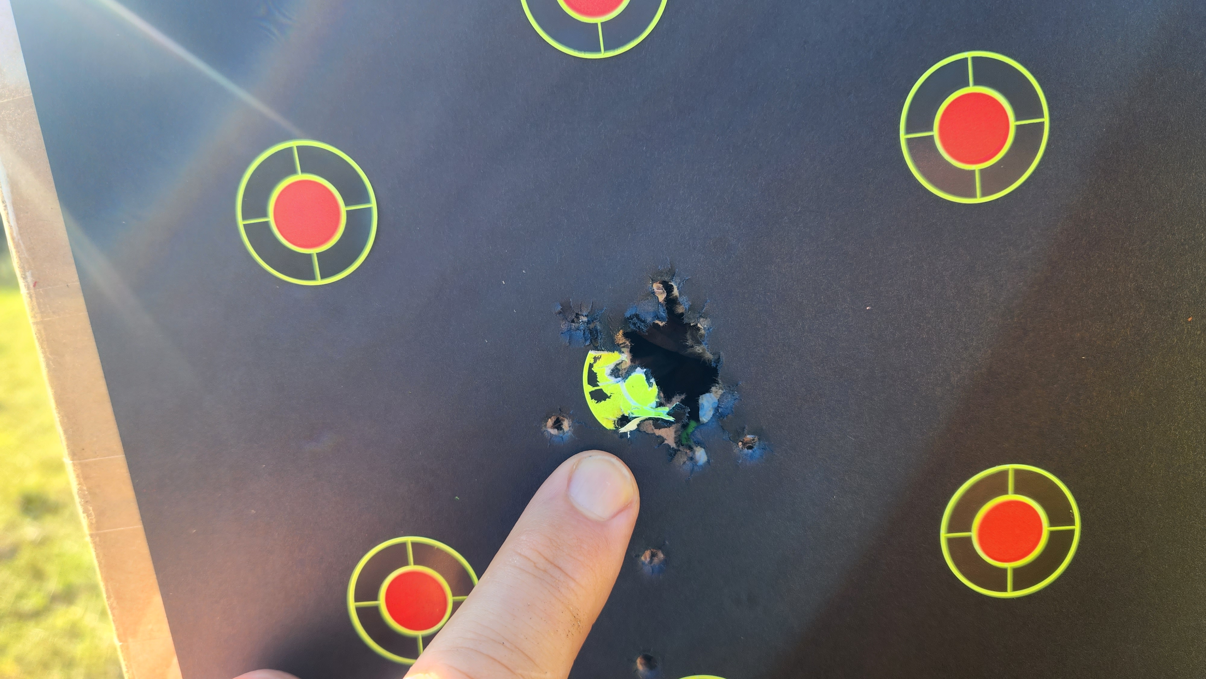

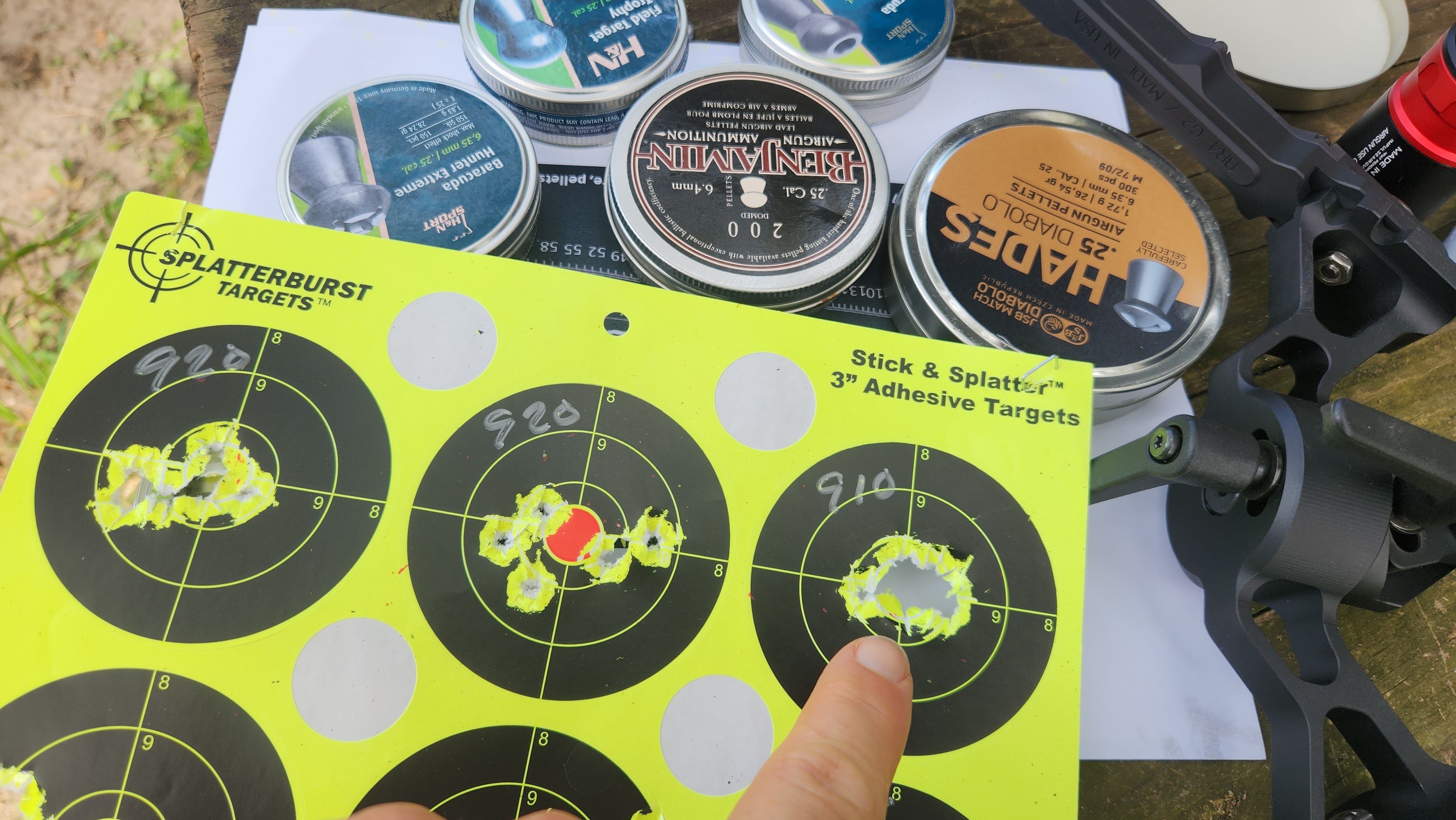

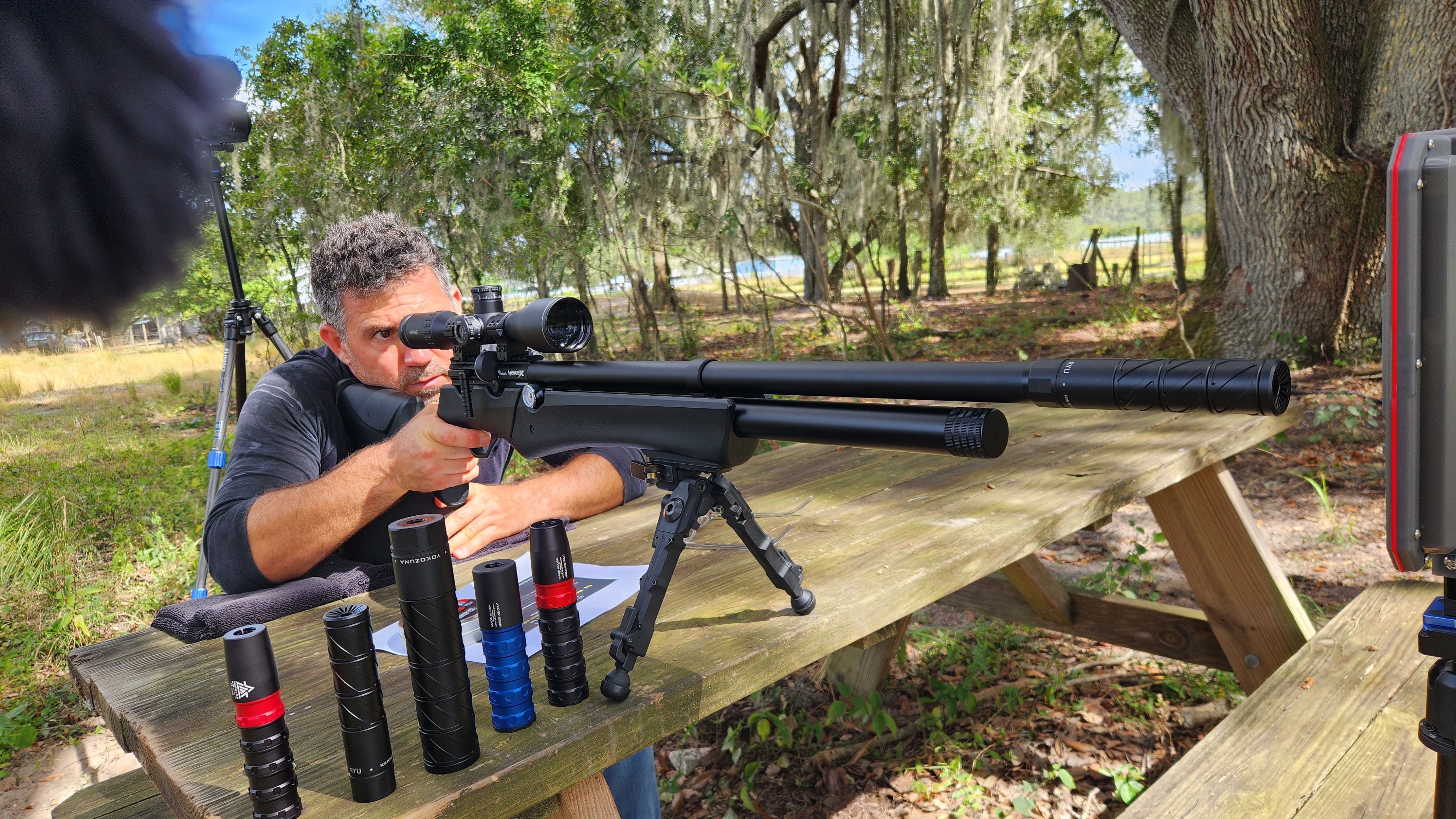

After realizing the situation, I waited for the winds to come up, then began building out field tunes at incremental velocities. Once I zeroed in on the speed that flew pellets perfectly straight with no wobble or corkscrew, I verified first with 10-15 shot groups, then later with 20-shot groups. I did all of this work at 50 yards and in a 5-10 mph, left-to-right cross wind. It took the day.
Tight pattern clearly forming around the speeds of 905-910 fps.
910 looking good
me feeling better now... figuring things out

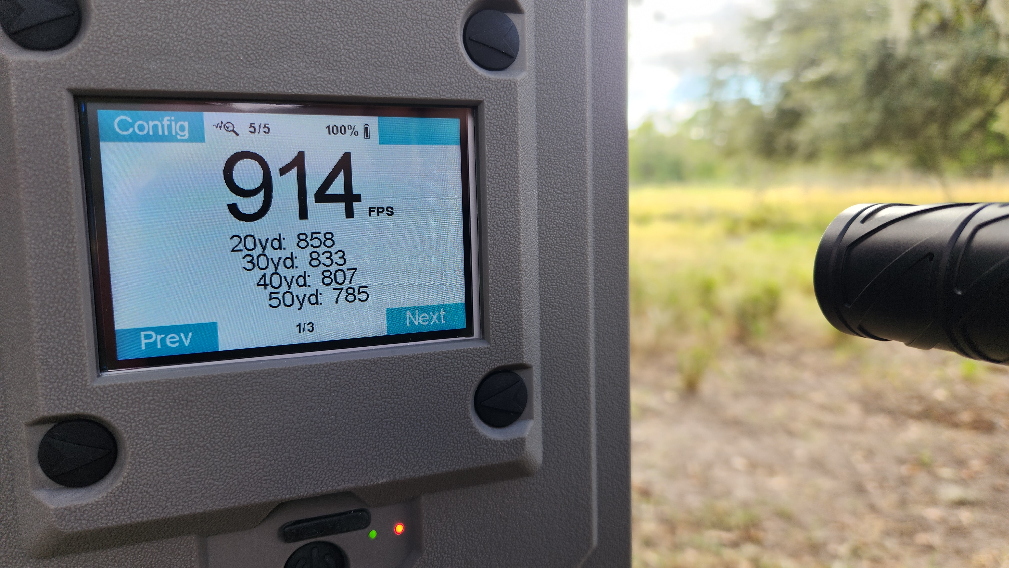

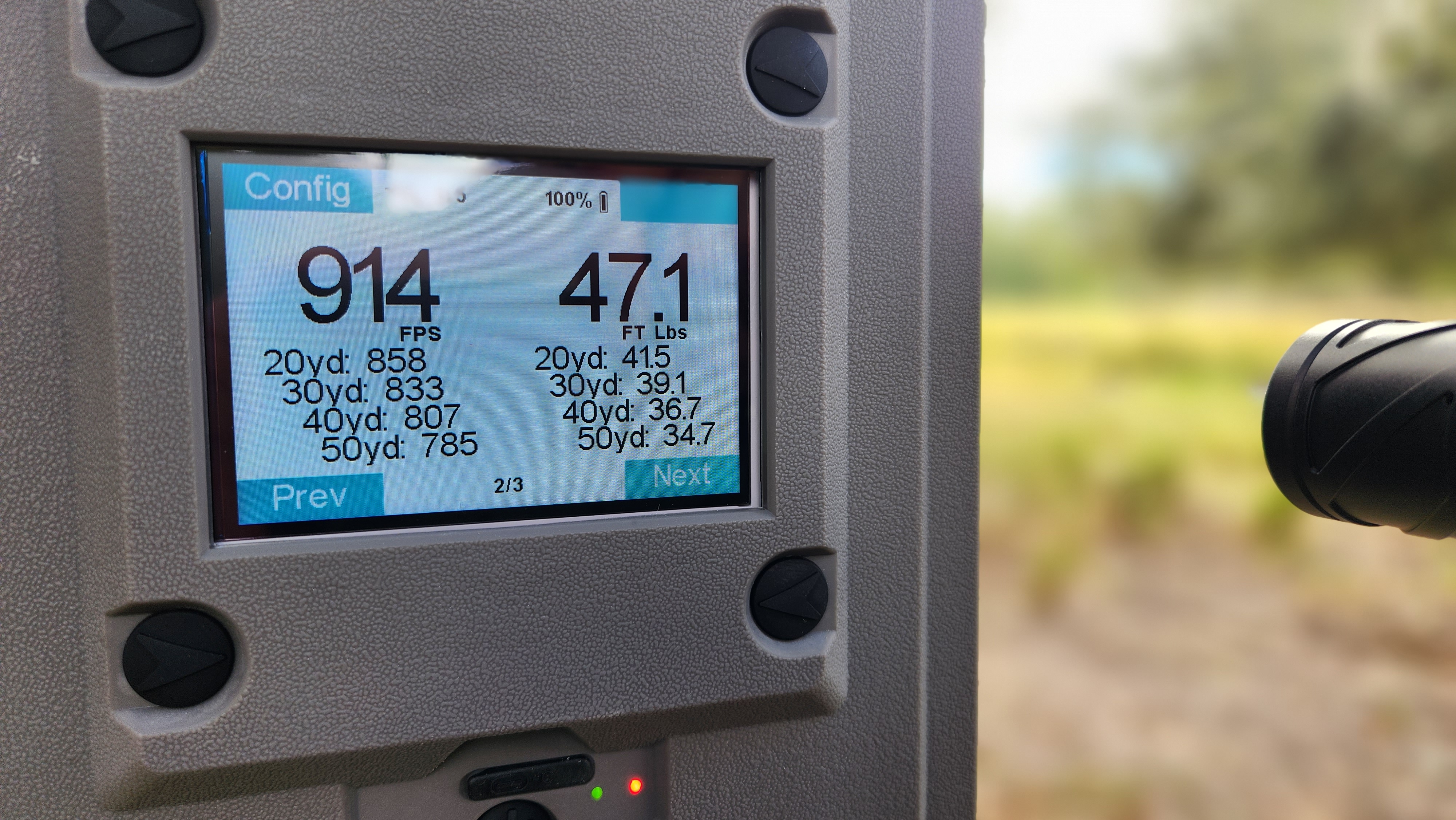

FX's new True Ballistic Chronograph relaying the data

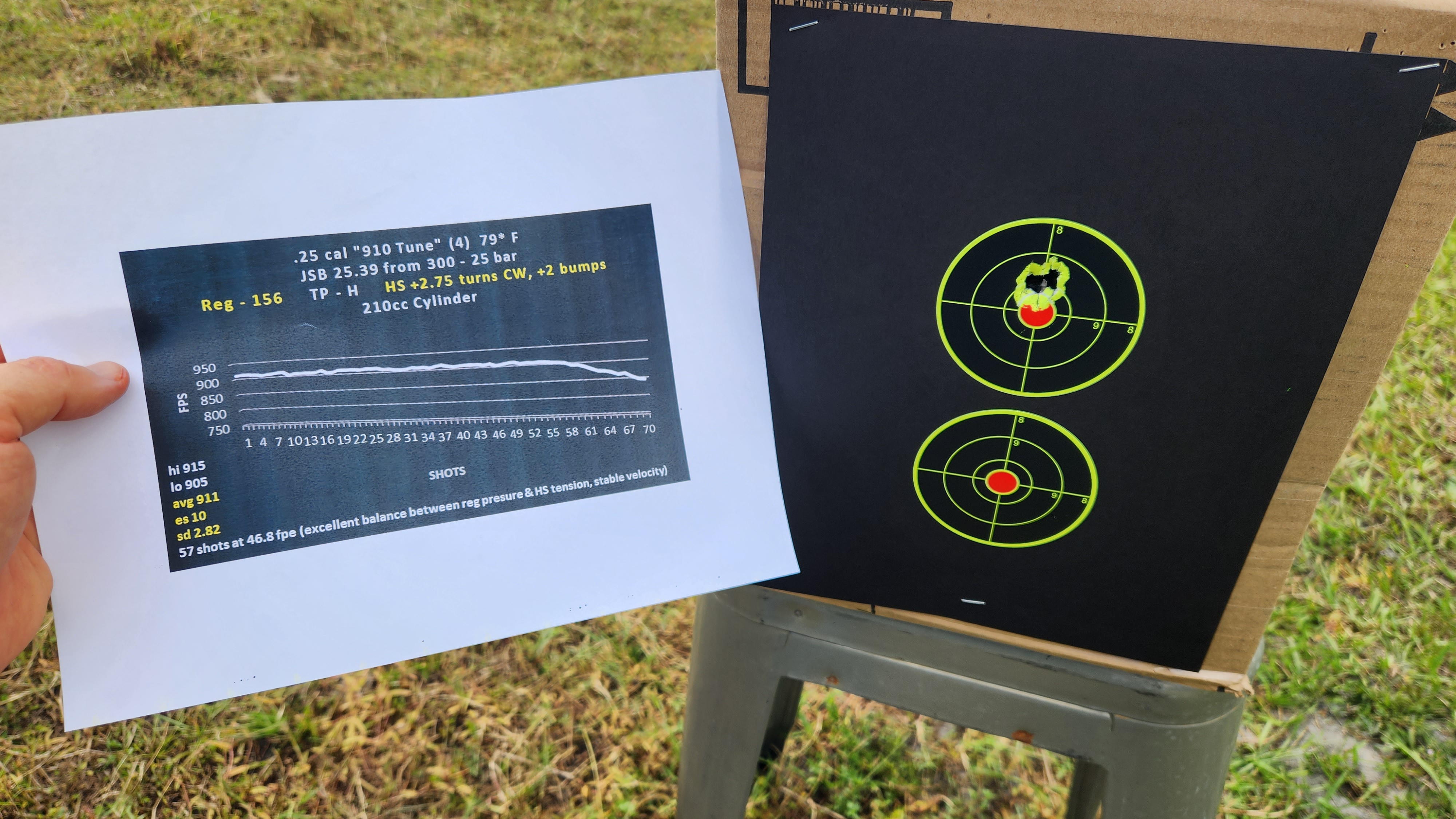

On to 20 shot groups at 910 fps and higher
20-shot groups at 50 yards in a strong cross wind, telling me I had arrived at the right velocity with 910

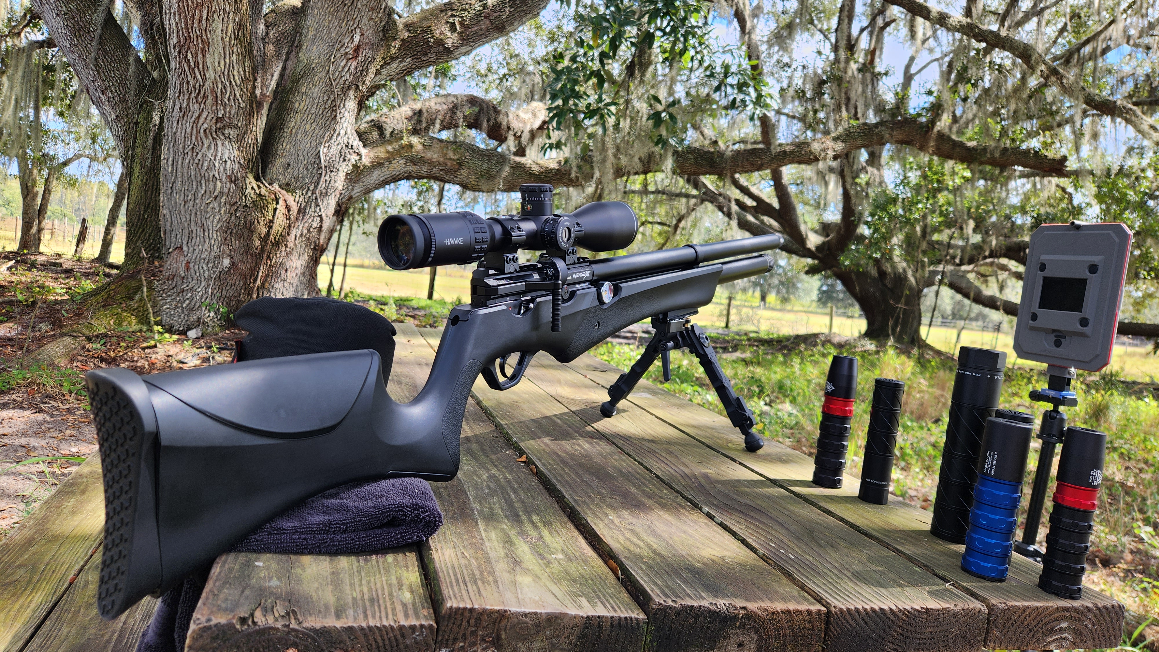

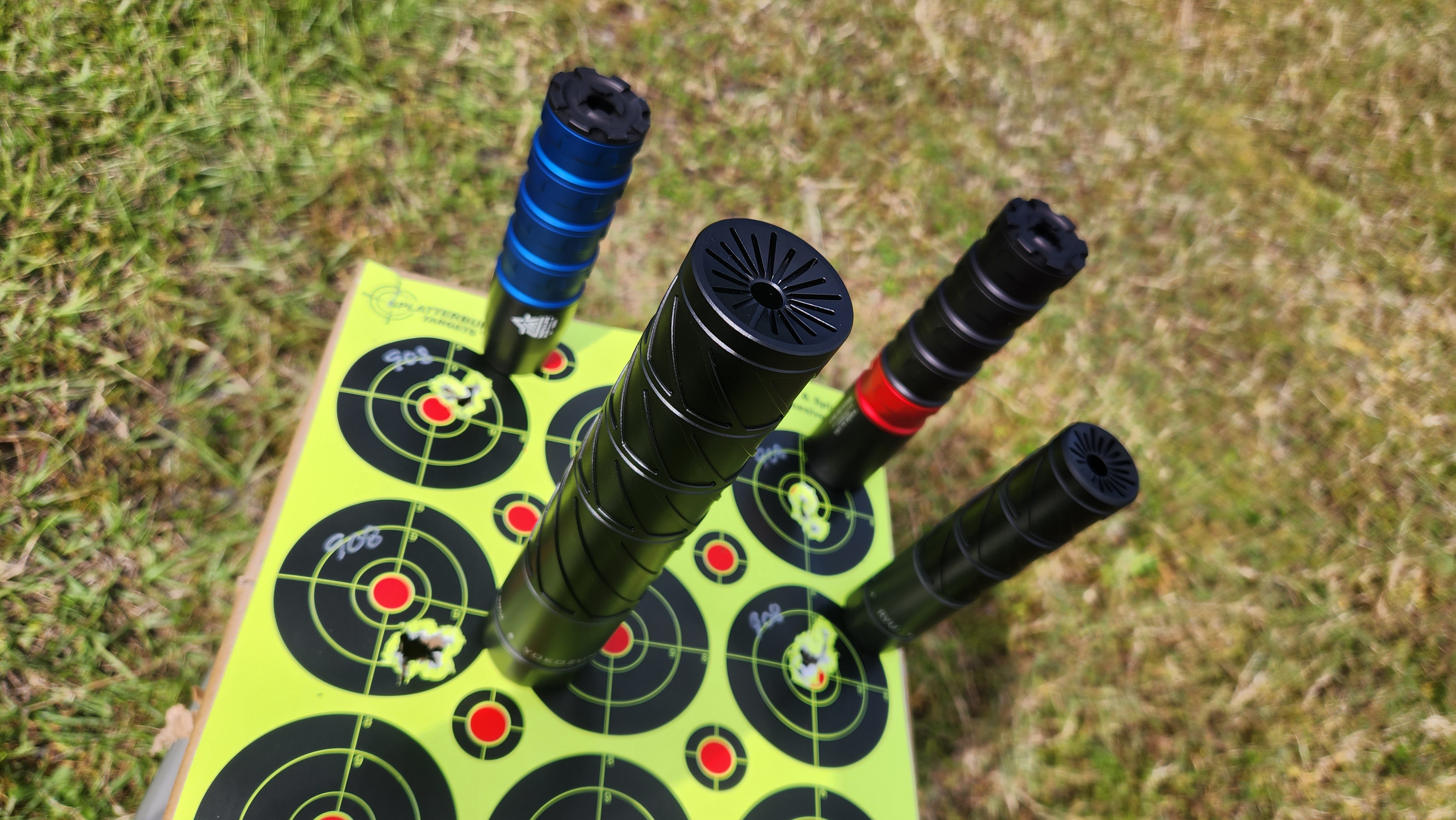

After that, some casual moderator testing at 910 fps and 50 yds to see if it would throw the results... it didn't

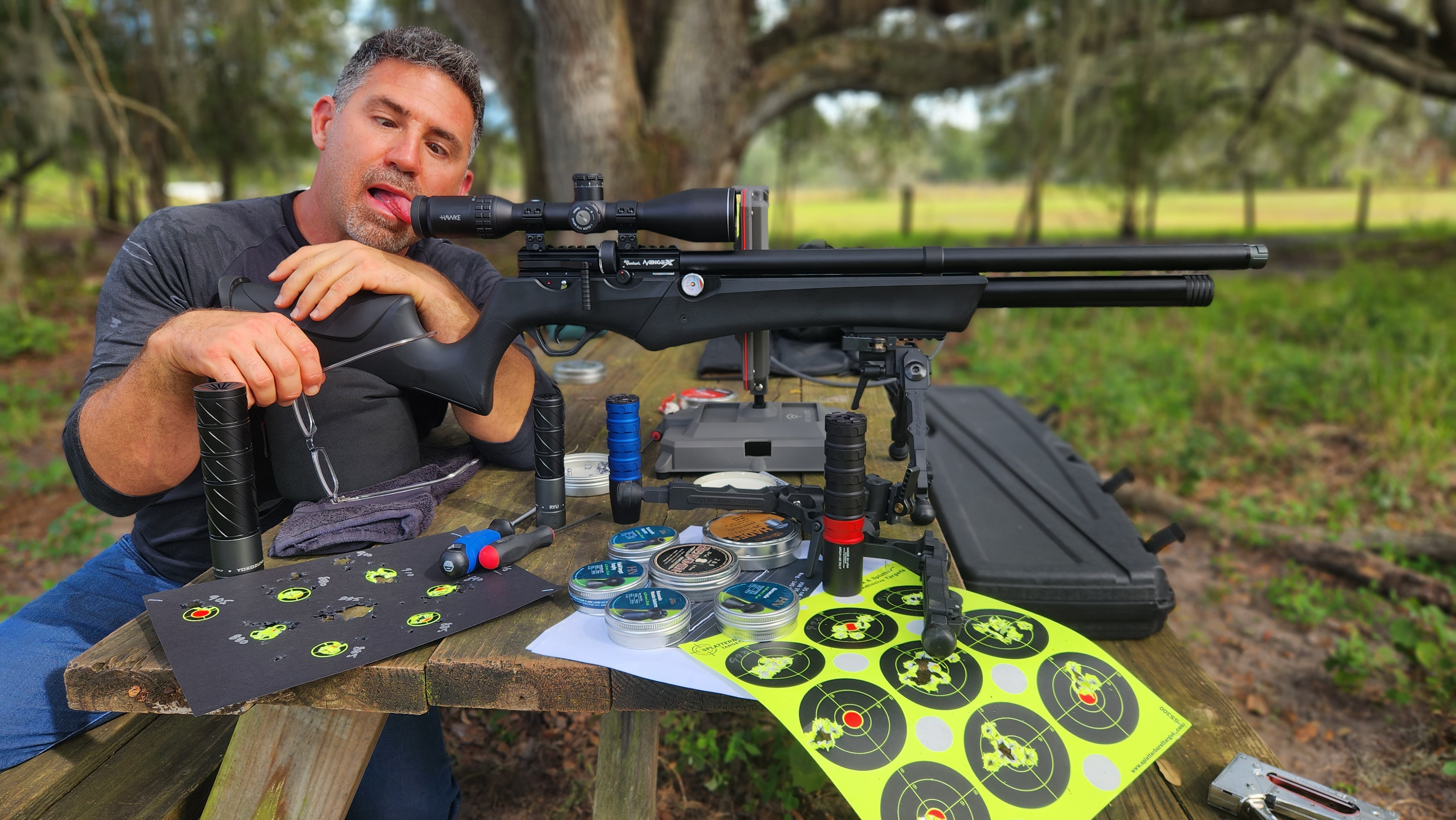

Back at home the next day, homing on a 910 tune... still unhappy with the SD in these pics
my process

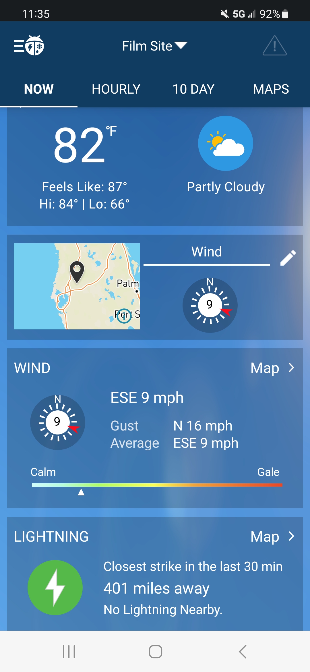

The end result... now lets go test it at 50 yards in 9-16 mph winds :)
My wind conditions yesterday

more moderator testing of the 910 tune with the cameras rolling this time
Donny's new "Ryu" further wind-proofing my 910 tune

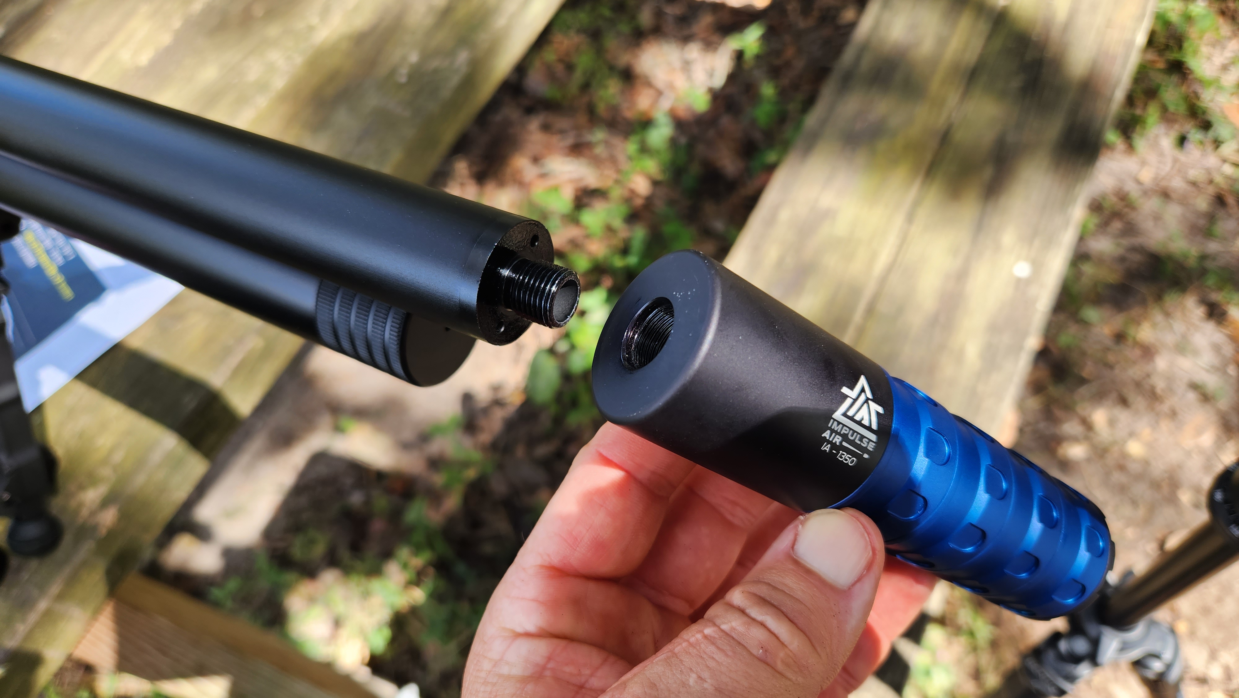

This moderator from "Impulse Air" also shined at 50 in wicked winds
Impulse Air moderator with the 910 tune at 50 yards - yum
easy on/off for the Avenge X

FX True Ballistic Chronograph telling us what's going on from muzzle to target
speed vs power from muzzle to target

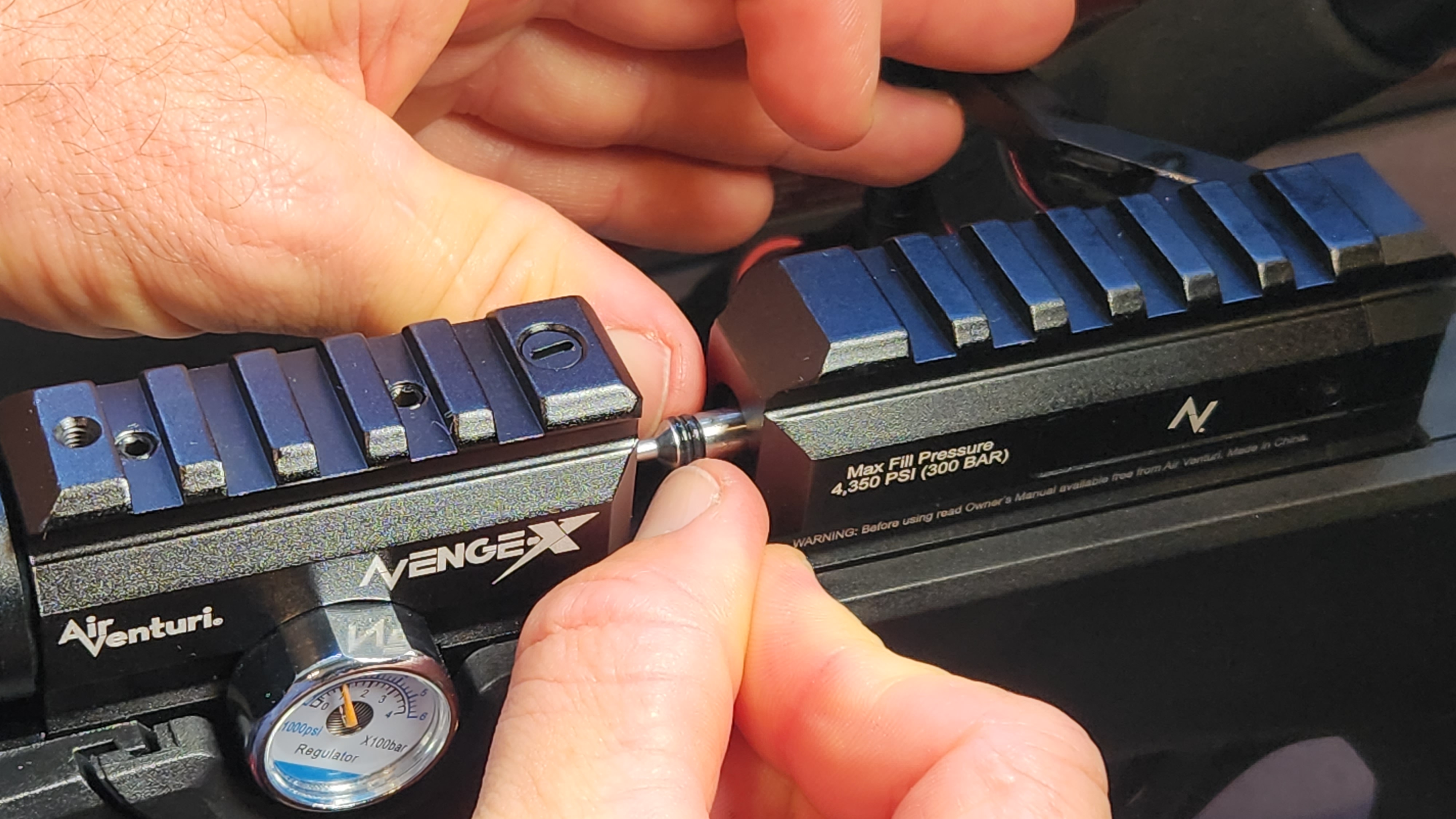

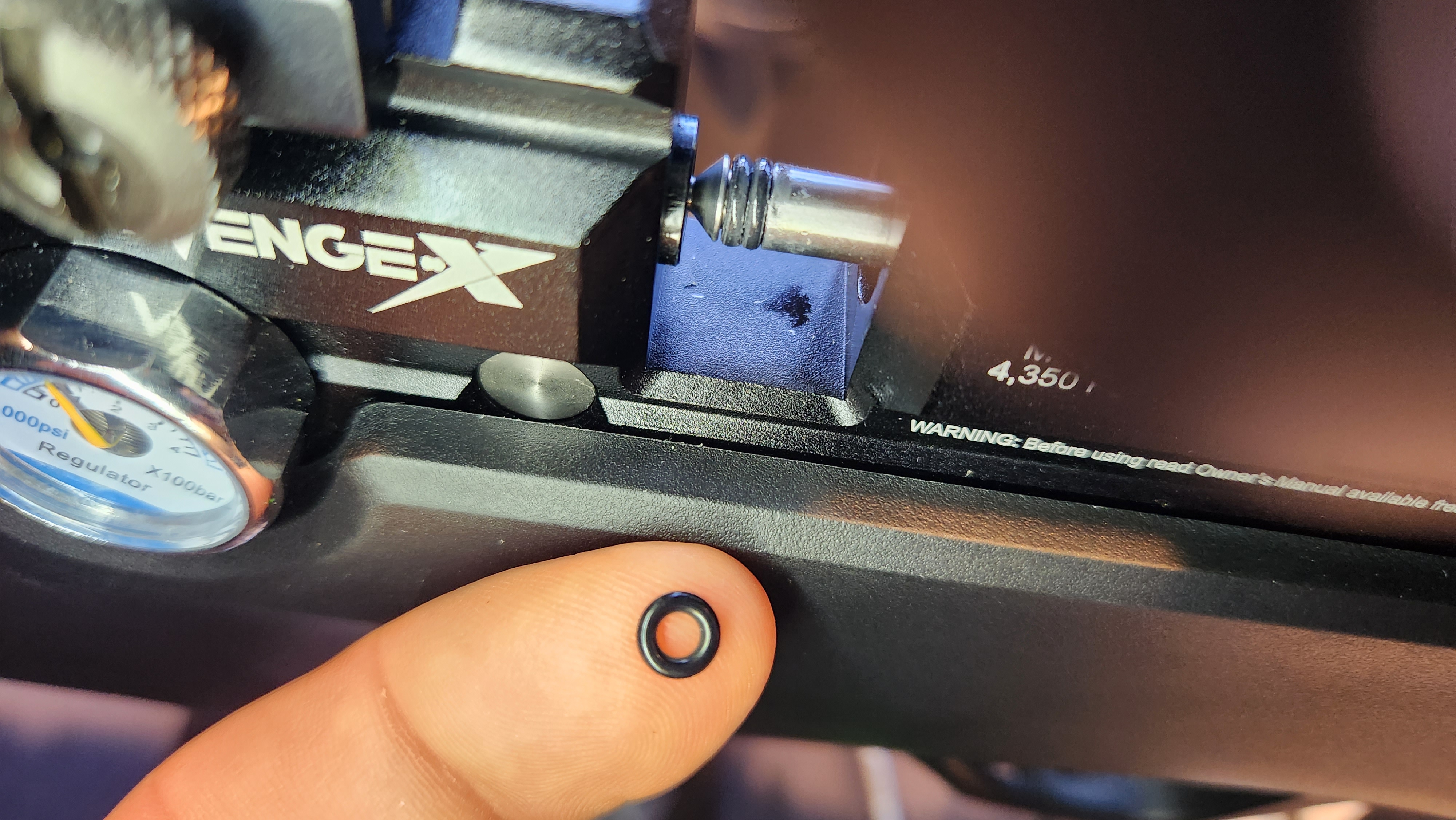

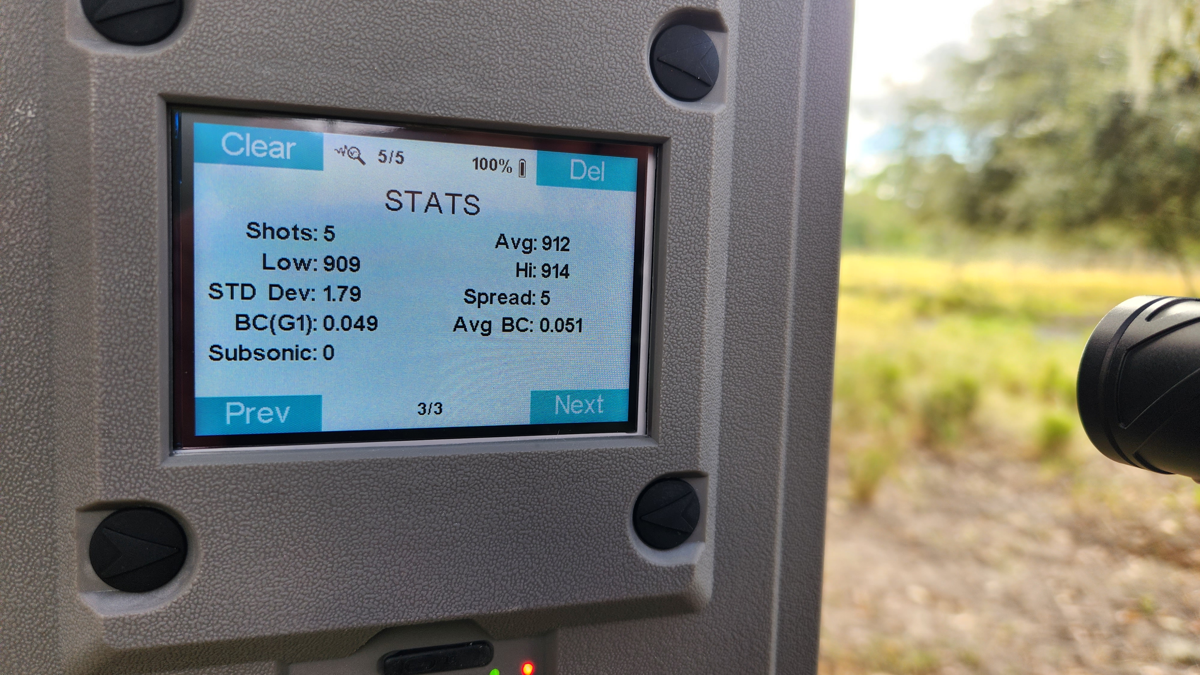

910 got that 25.4 shooting pretty slippery... notice the 5 ES and 1.8 SD?? ... gun was shooting this all day after a new set of bolt probe o-rings
worn down o-rings after 3,000 shots of test & tune still worked good but new ones brought the ES & SD of the 910 tune to 6 and 1.8
new o-rings installed, thank you for keeping me going Tyler P.
