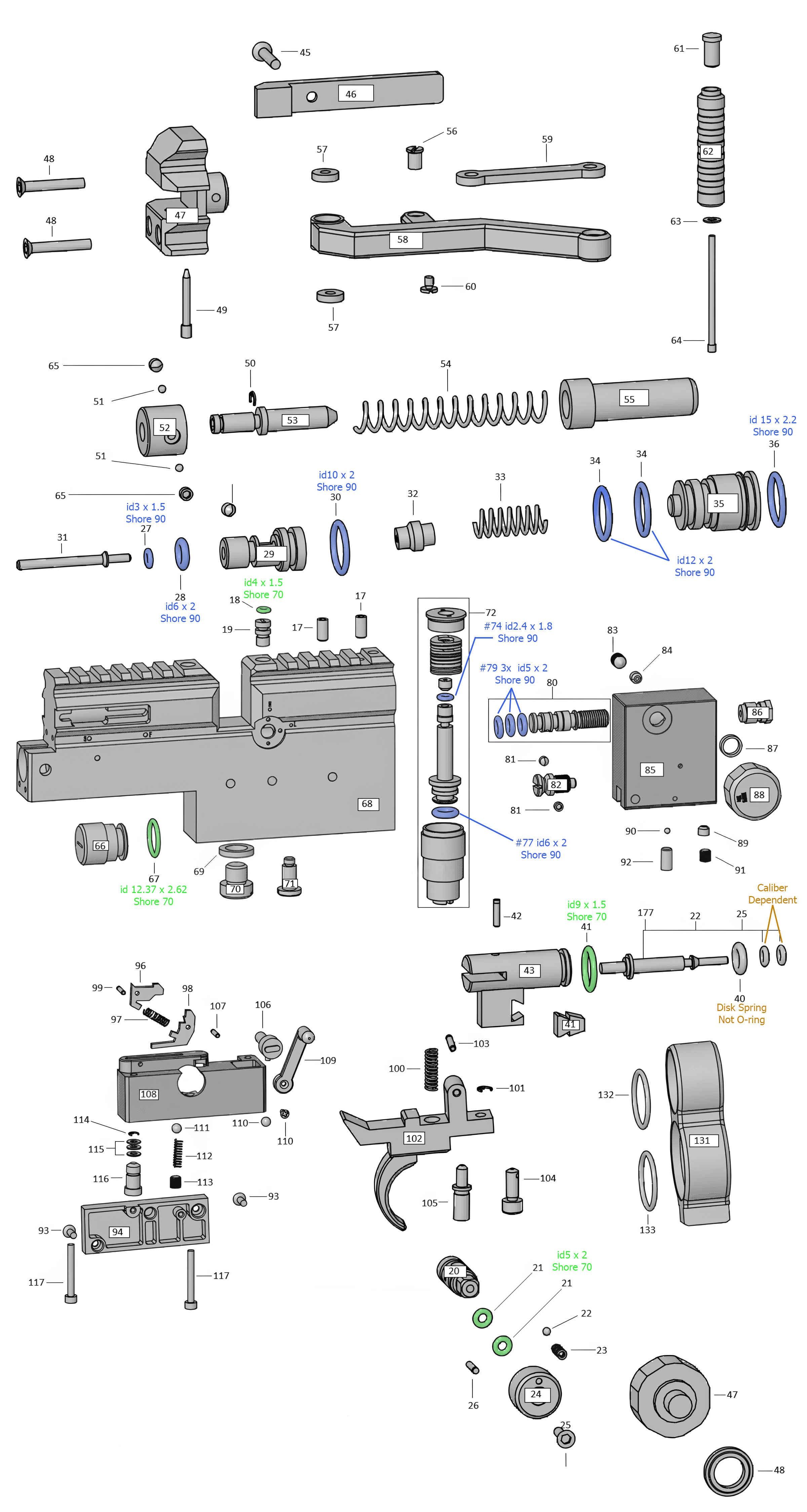

Just wondering if the Captain oring kit for the old style avenger would work with the avenge x? I can't find a complete kit anywhere. Thanks
Thanks for the info. I ordered the kit from Pyramid Air and one of the orings broke trying to get it on.To my knowledge Captain Oring hasn't yet gotten a set of O-rings for the Avenge-X. I do not believe the Avenger set will fully cover the internals of the Avenge-X as there was a fair amount of reconfiguring the design. PyramidAir does offer a complete set of O-rings for the Avenge-X but I found them to be much the same as those already failing in the gun: more plastic than rubber and already hardening to the point of being brittle. Attached you will find a file I found several weeks ago, wish I could remember who and where, dealing with the necessary O-rings for the Avenge-X. I have found it best to purchase O-rings from some of the specialty houses, gaining a few extras for breakage and future use along with a better quality product. Yeah, I get it. Looking for O-rings from various vendors can be a real pain - not to mention the shipping charges these days.
