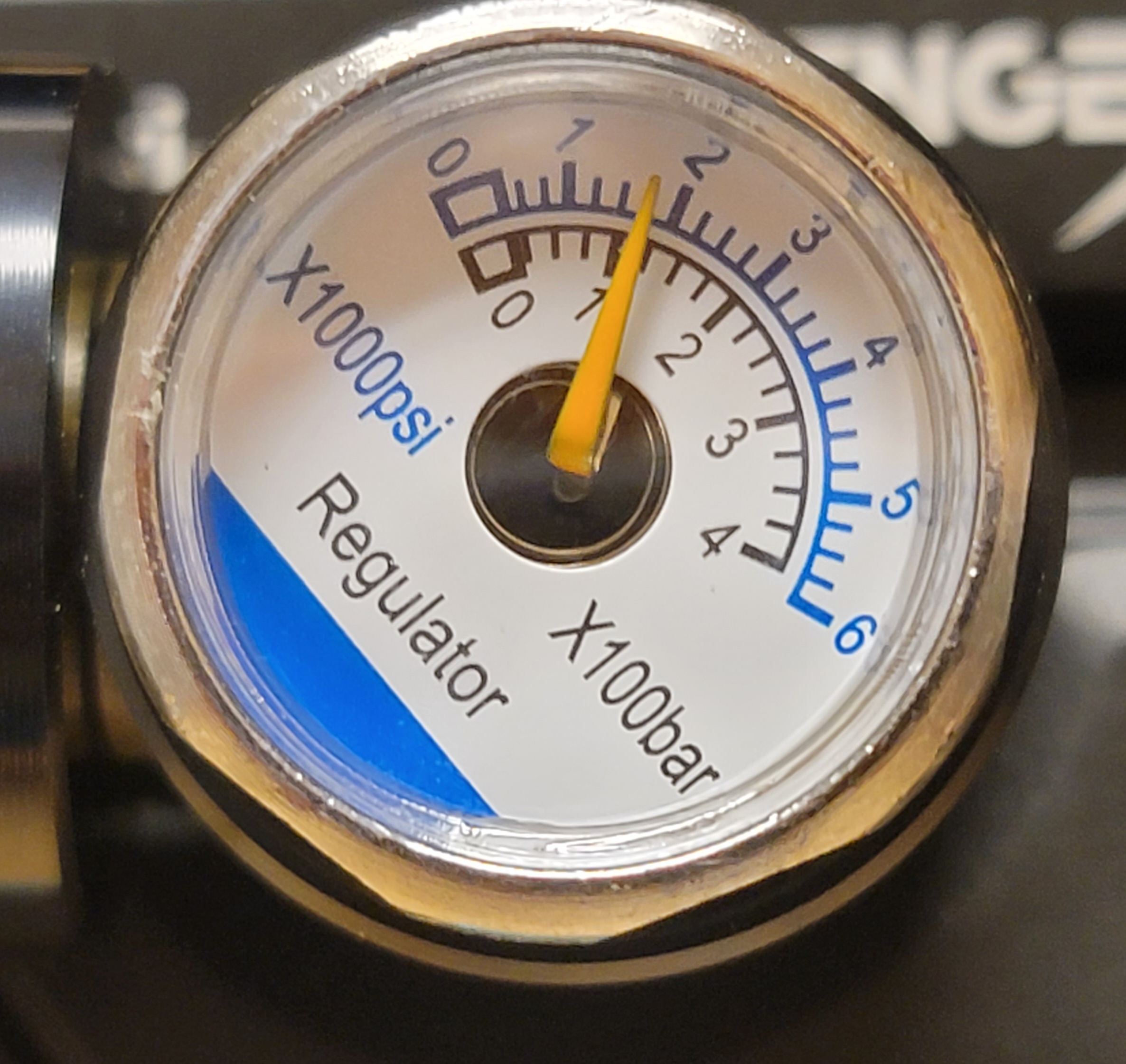

3. After mod I set the Reg for 1800 psi and adjusted HS (1.25) until I saw StdDev of 1.5 fps at best, 5 fps worst, with 3 fps being the avg over 20 groups of 5 rounds each. Pellet speed started at 850 fps with 0.25 HS, as I increased HS looking for a solid StdDev I ended up at HS of 1.25. This gave me an avg speed of 910.

2. I erroneously wrote 2000psi on the target cards. It really is about 1800.
