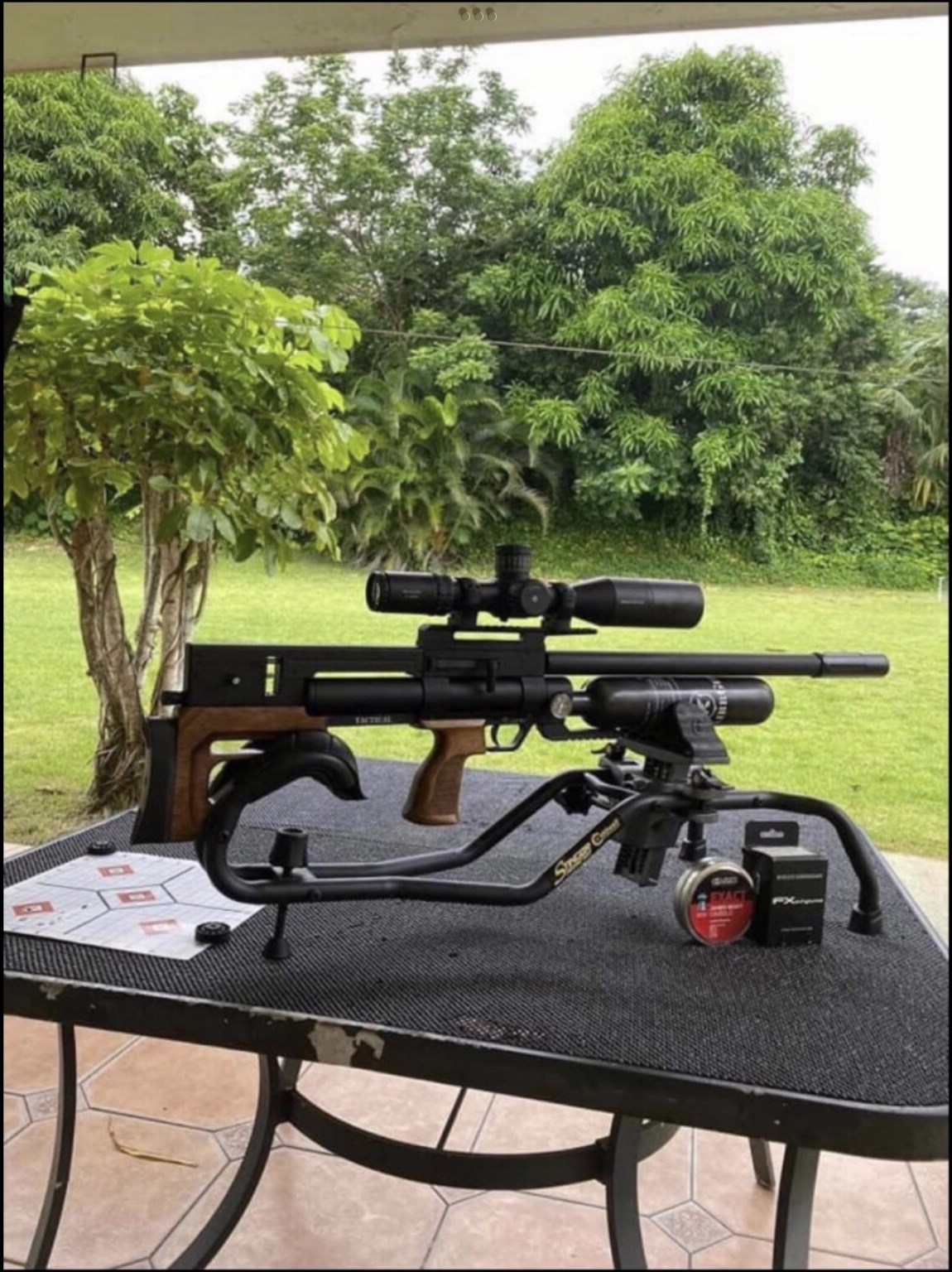

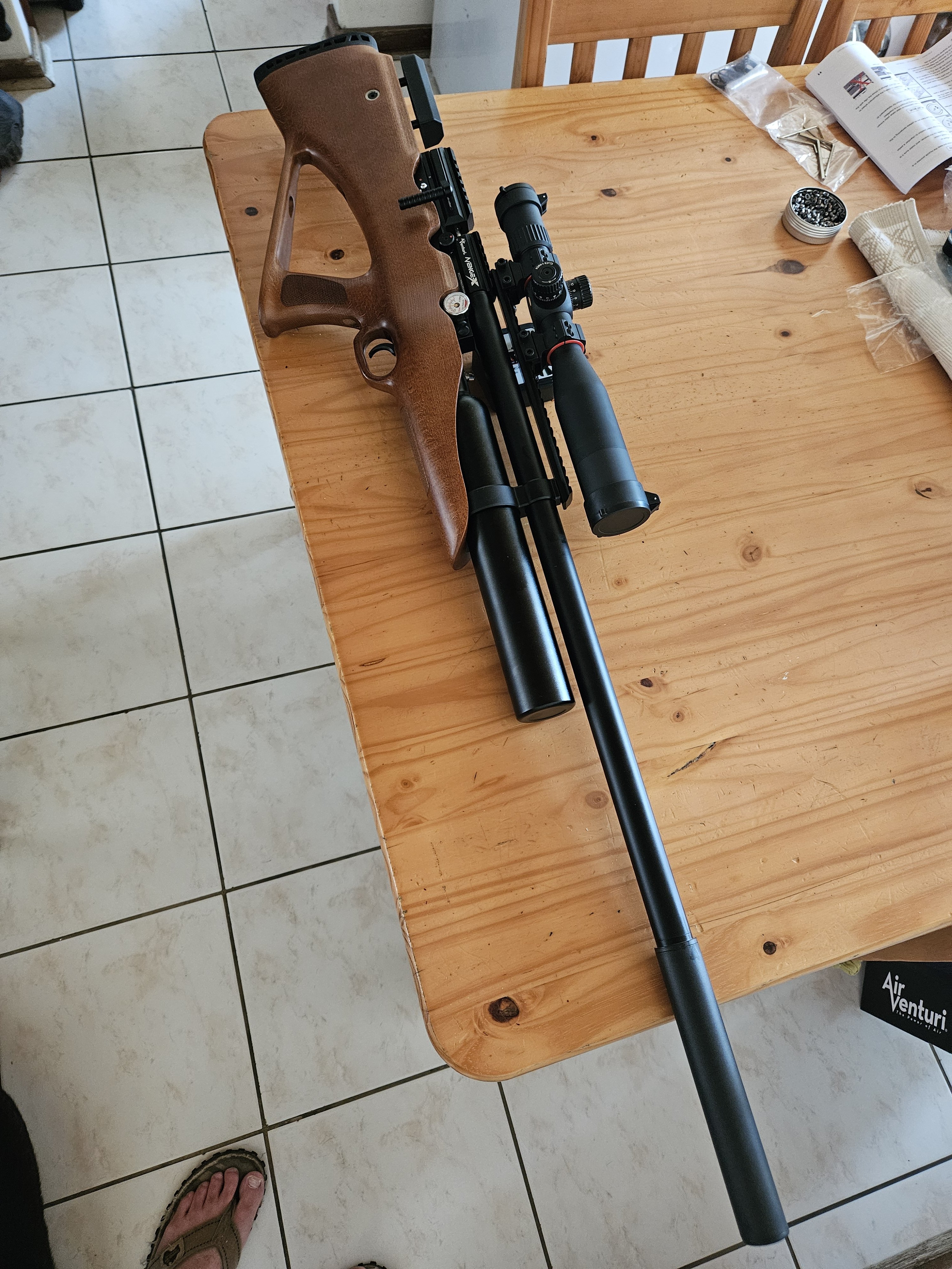

So dived into the pcp world , got myself the new avenge x bull pup with bottle. These are the South African version, put a dach silencer on. Now need to sit and tune. This forum has plenty info, will be shooting 18.13 grn pellets at first. Need to chrony. etc..

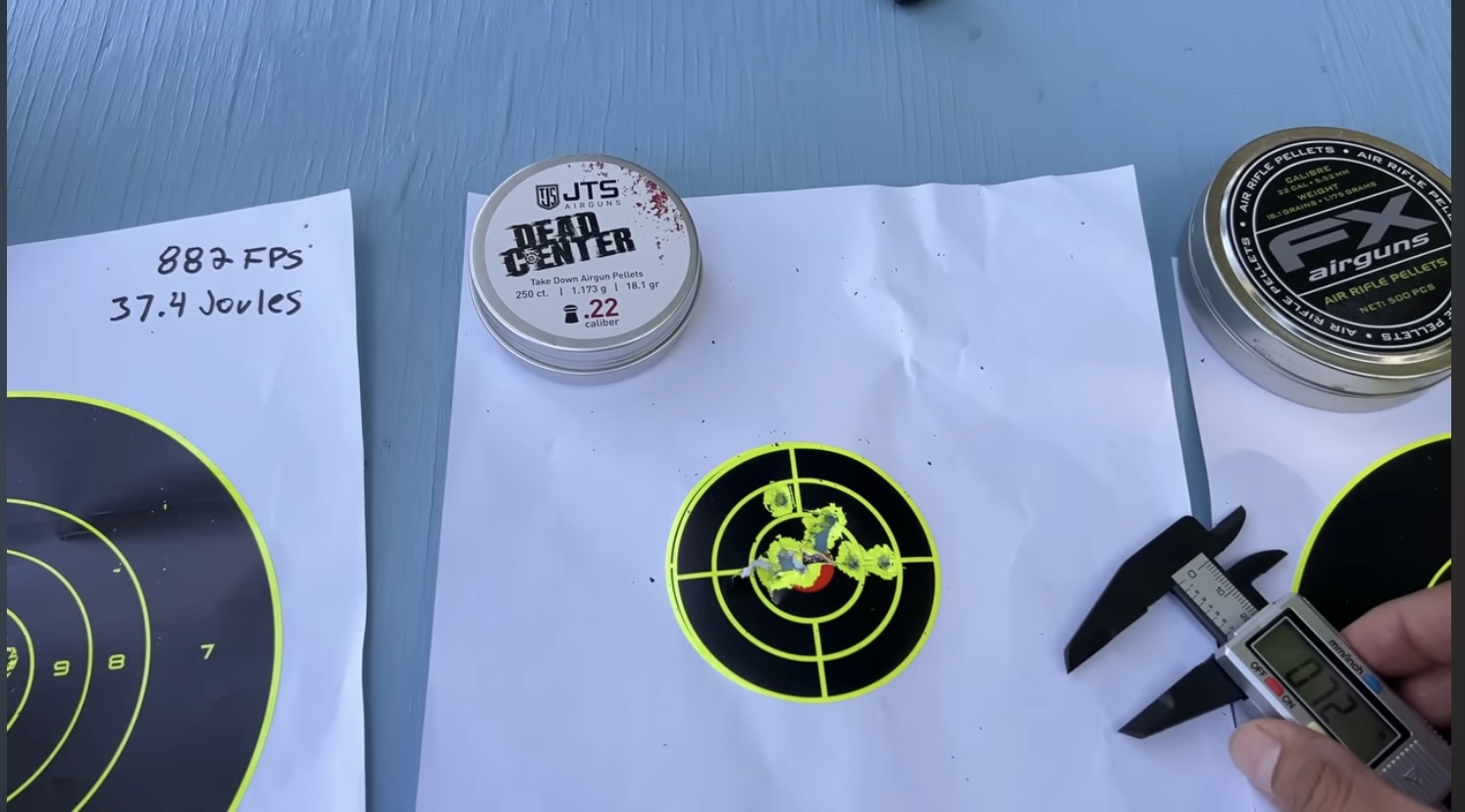

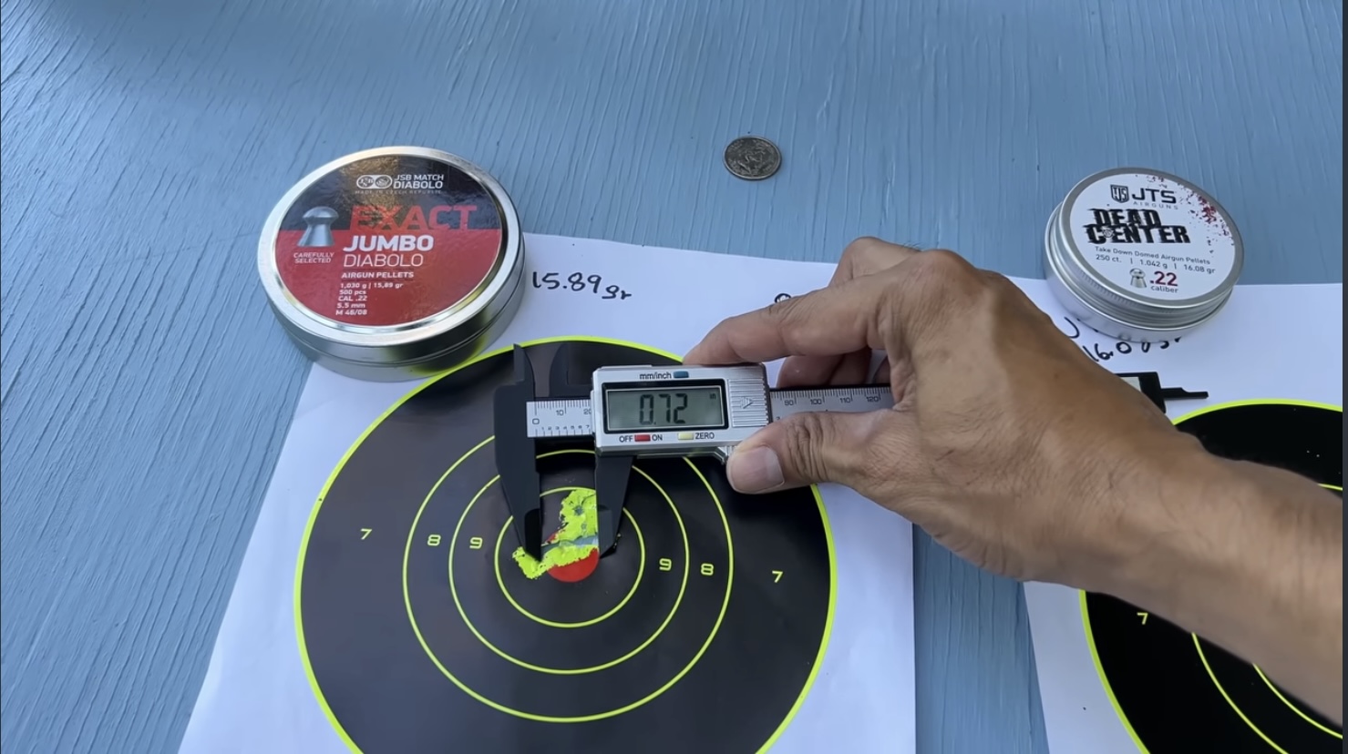

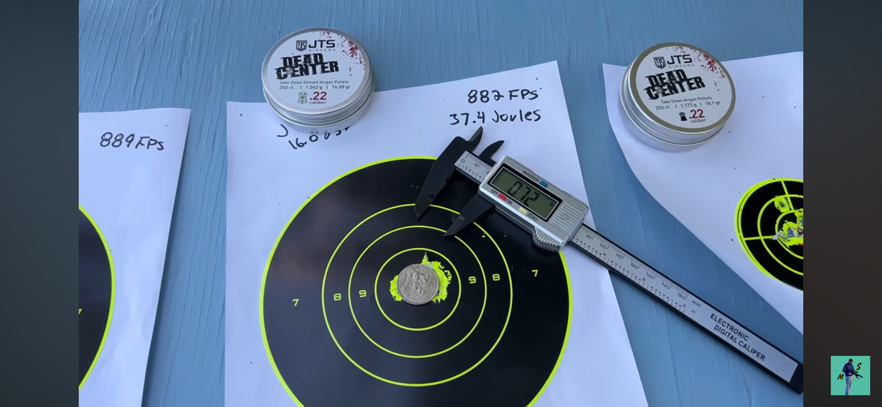

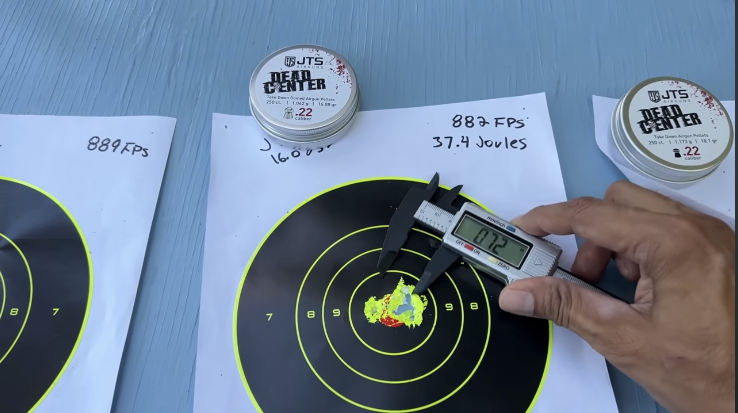

I have done a ton of testing with my Avenge-X .22 cal the pellets that the barrels of this particular airguns like the most are the JSB and air arms diábolo fields 18 grains. Also likes the JSB and JTS 16 grains as well. The JTS 18 grains that you’re planning to test in your Avenge-X bullpup are not the best, also because they are a very tight fit into the barrel they cause the side level to become very stiff and extremely difficult to cock. Which is way I do not recommend anyone to use them in any of their first gen Avengers or second gen Avenge-X neither, since in the long run they can damage the mechanism of the side level by subjecting them to this unnecessary torture.

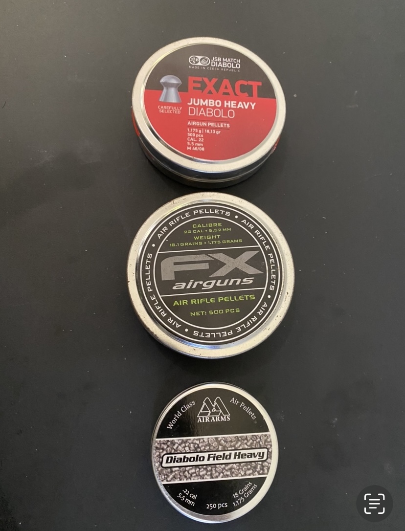

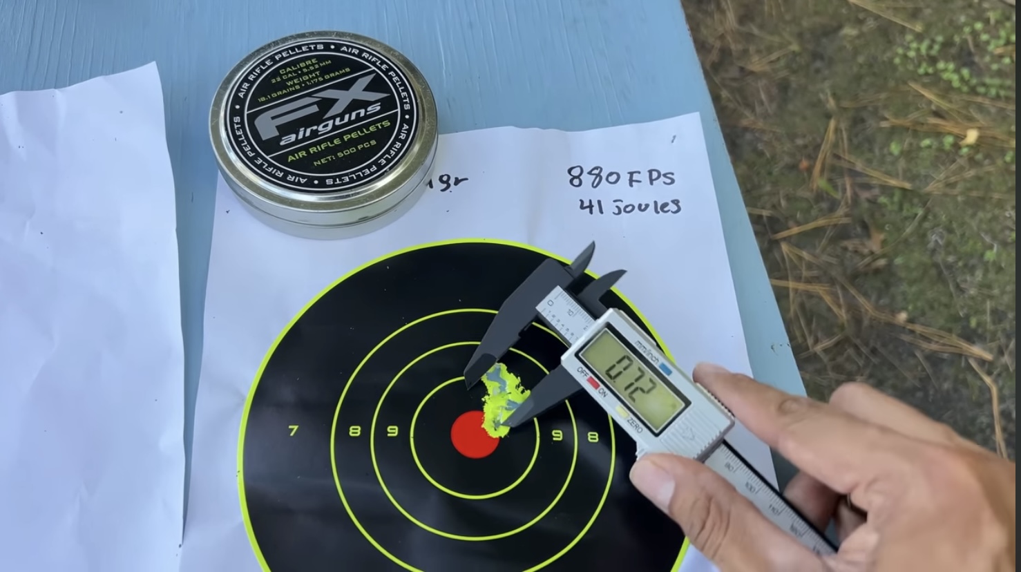

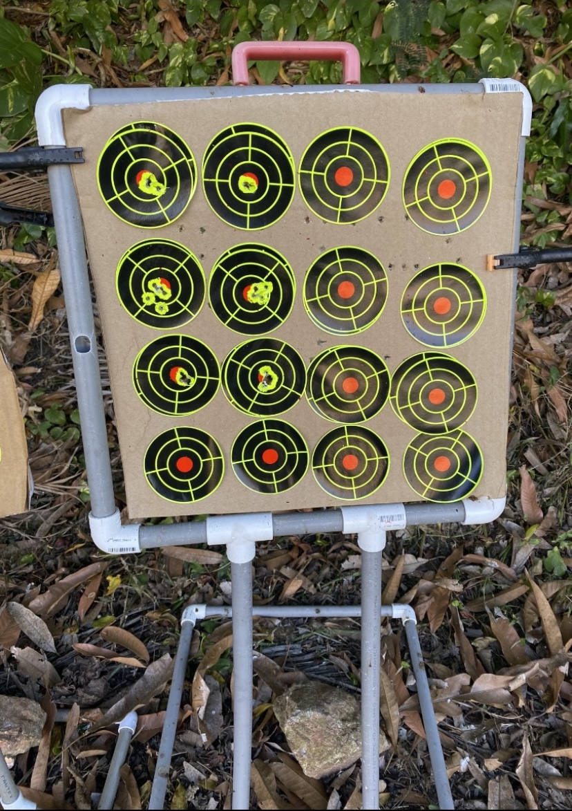

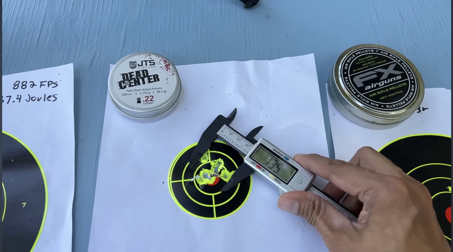

The target that have 16 buslleyes were shot by me at 35 yards from top to bottom the first two groups of 5 shots each were done with the JSB 18 grains, the second with the FX 18 grains and the third with the air arms diábolo fields 18 grains. As you can see our airguns like the most the JSB and the AA diábolo fields over the FX. I am just trying to save you a few $$$$$ in the long run 😉.

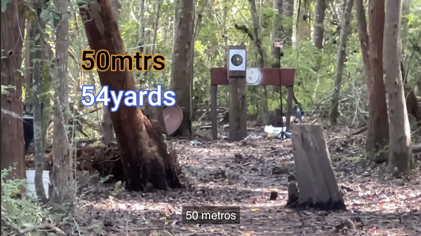

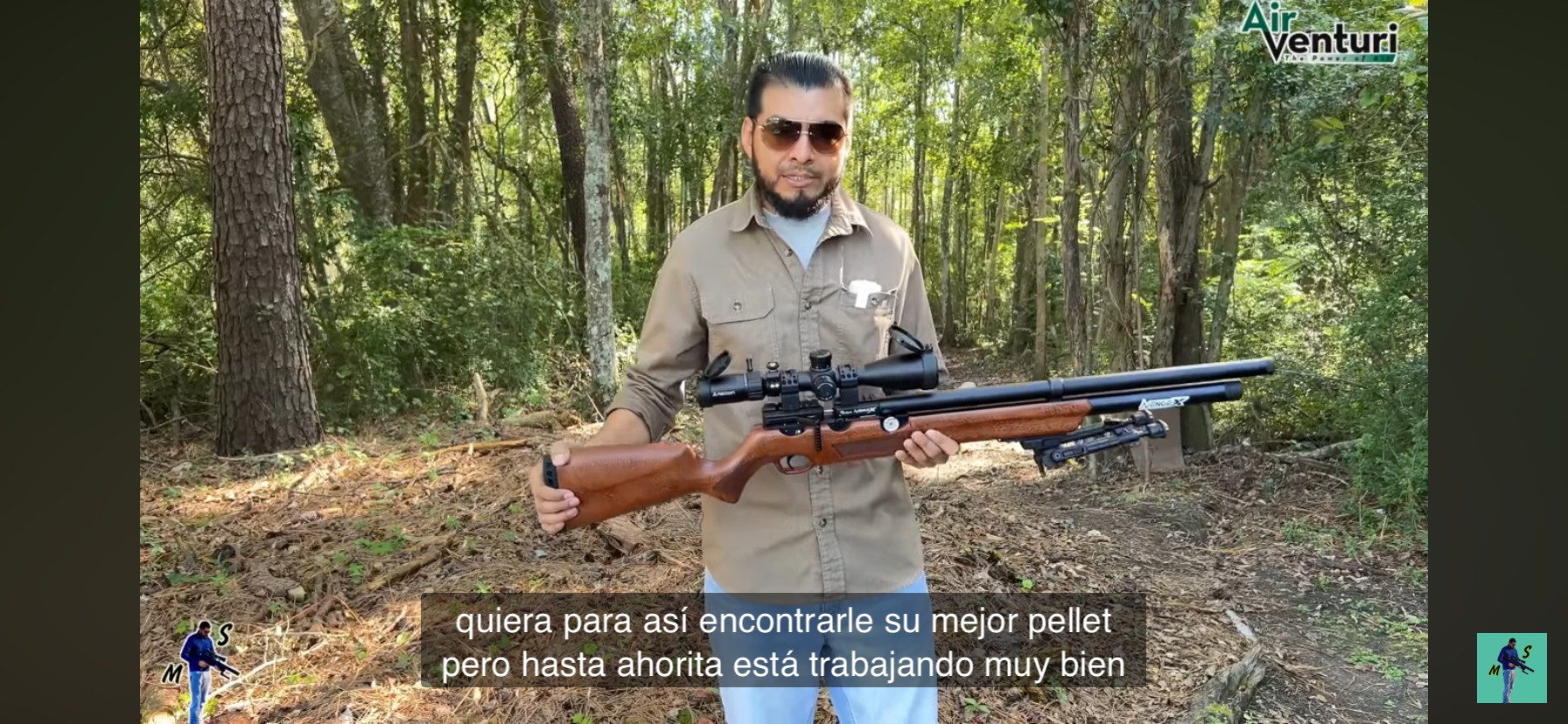

I took most of those screen shots from a video done by a very popular Hispanic guy who usually reviews all this airguns on his YouTube channel, his name is Michoacano Sandoval. I am bilingual thats why I also follow all this hispanic airguns reviewers as well.

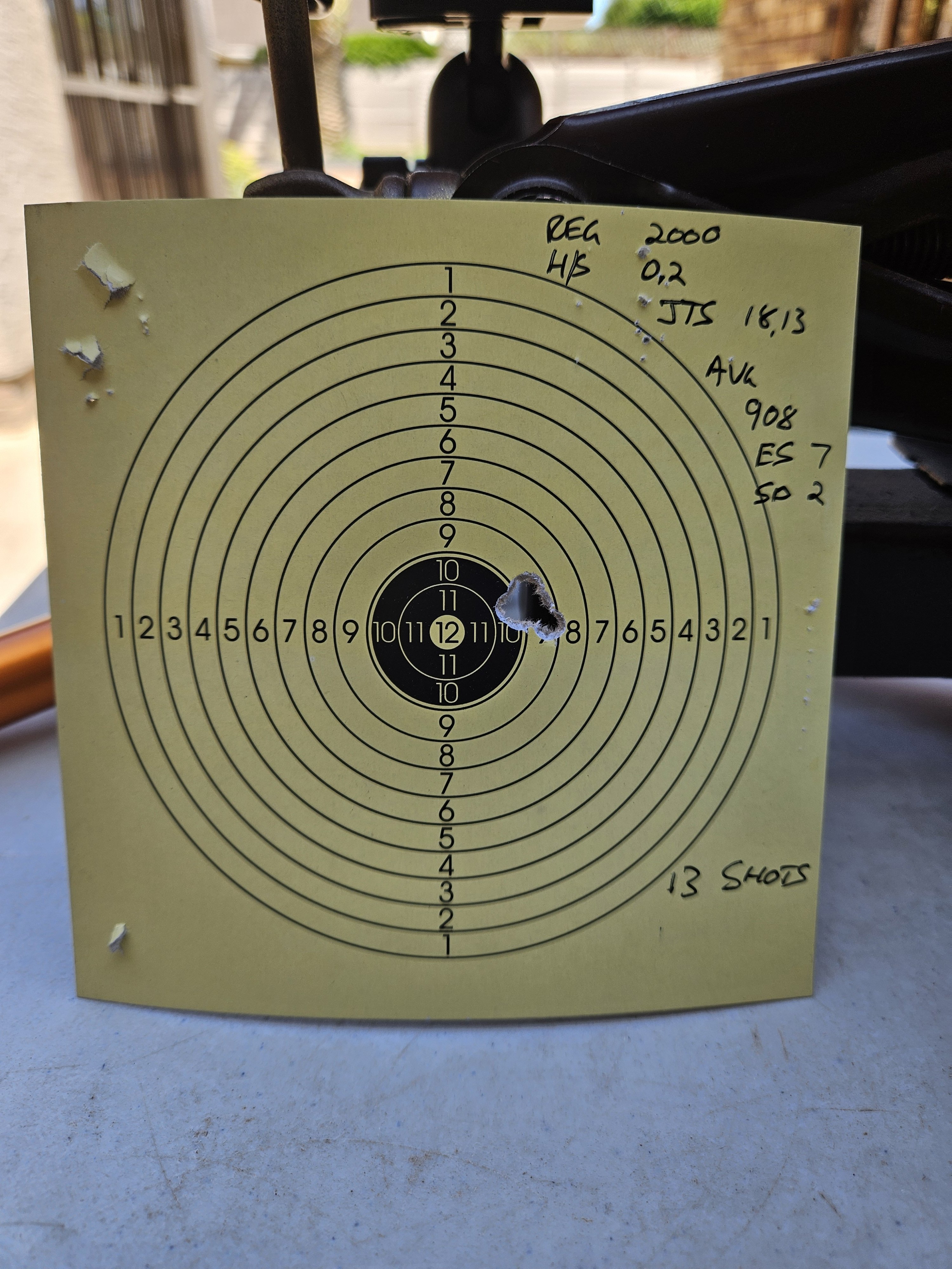

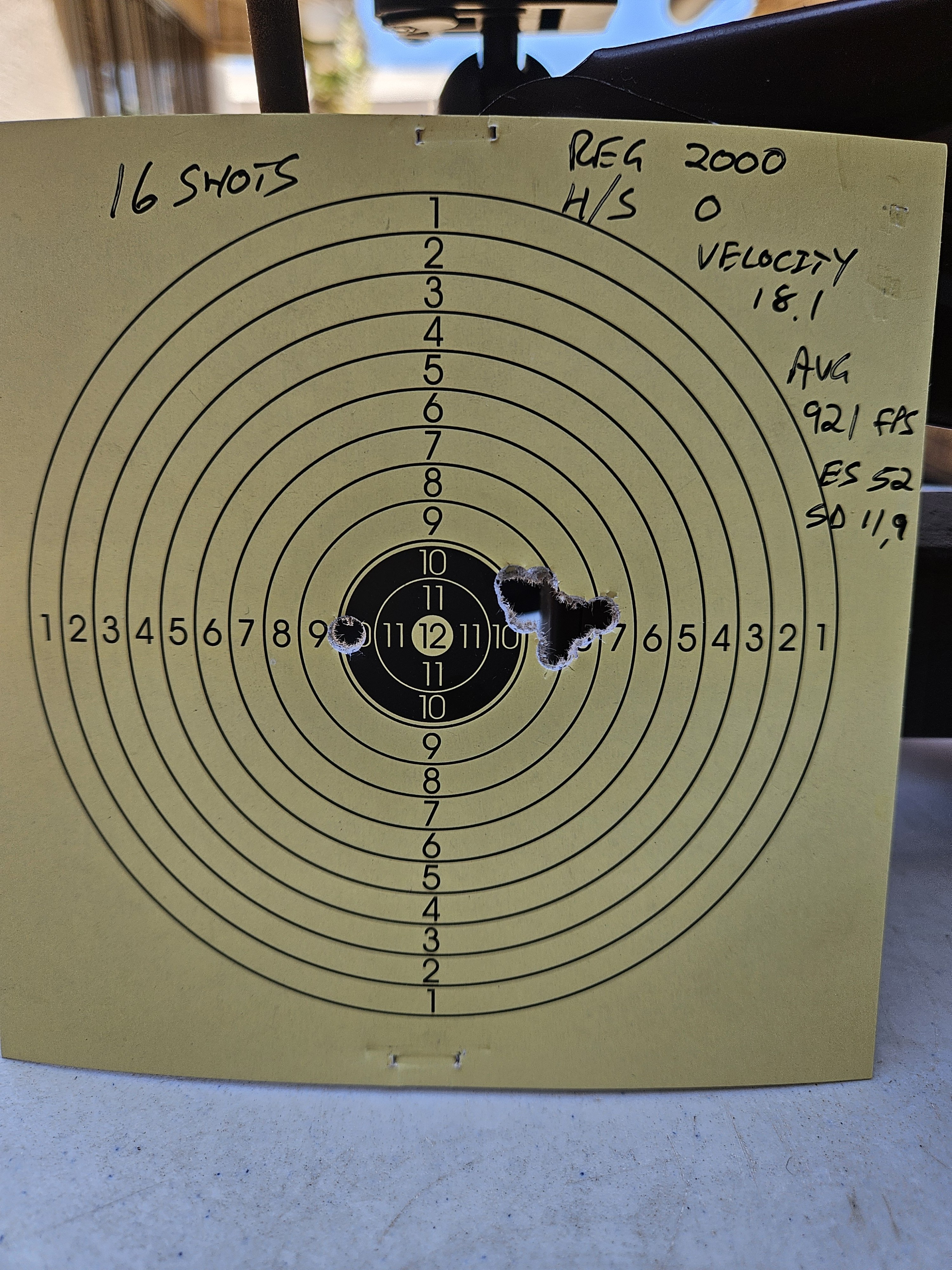

So started to chrony with the JTS 18.13 grain, with reg at 2000 and hs - 0 getting 908fps with a SD 2 and ES 7
Tried another pellet that I have velocity 18.13 grain. Goes in another smoother than the JTS and has and average fps of 921fps

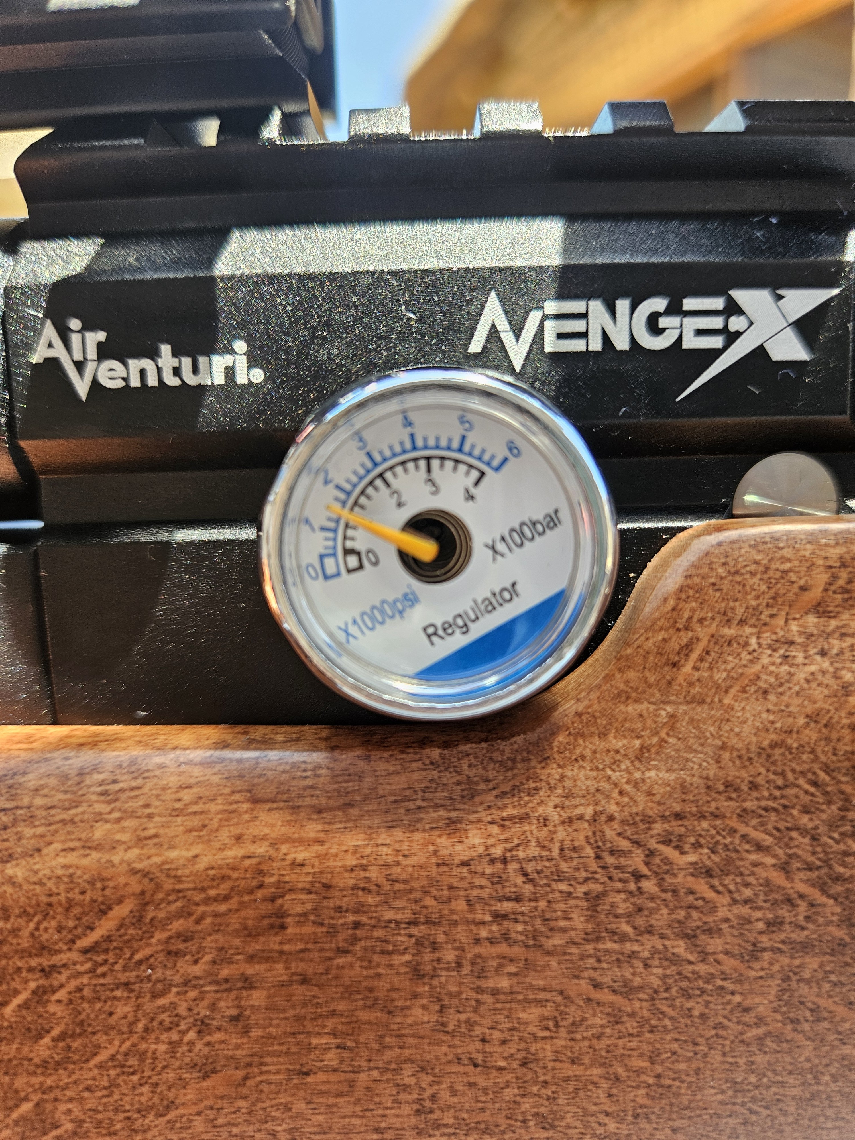

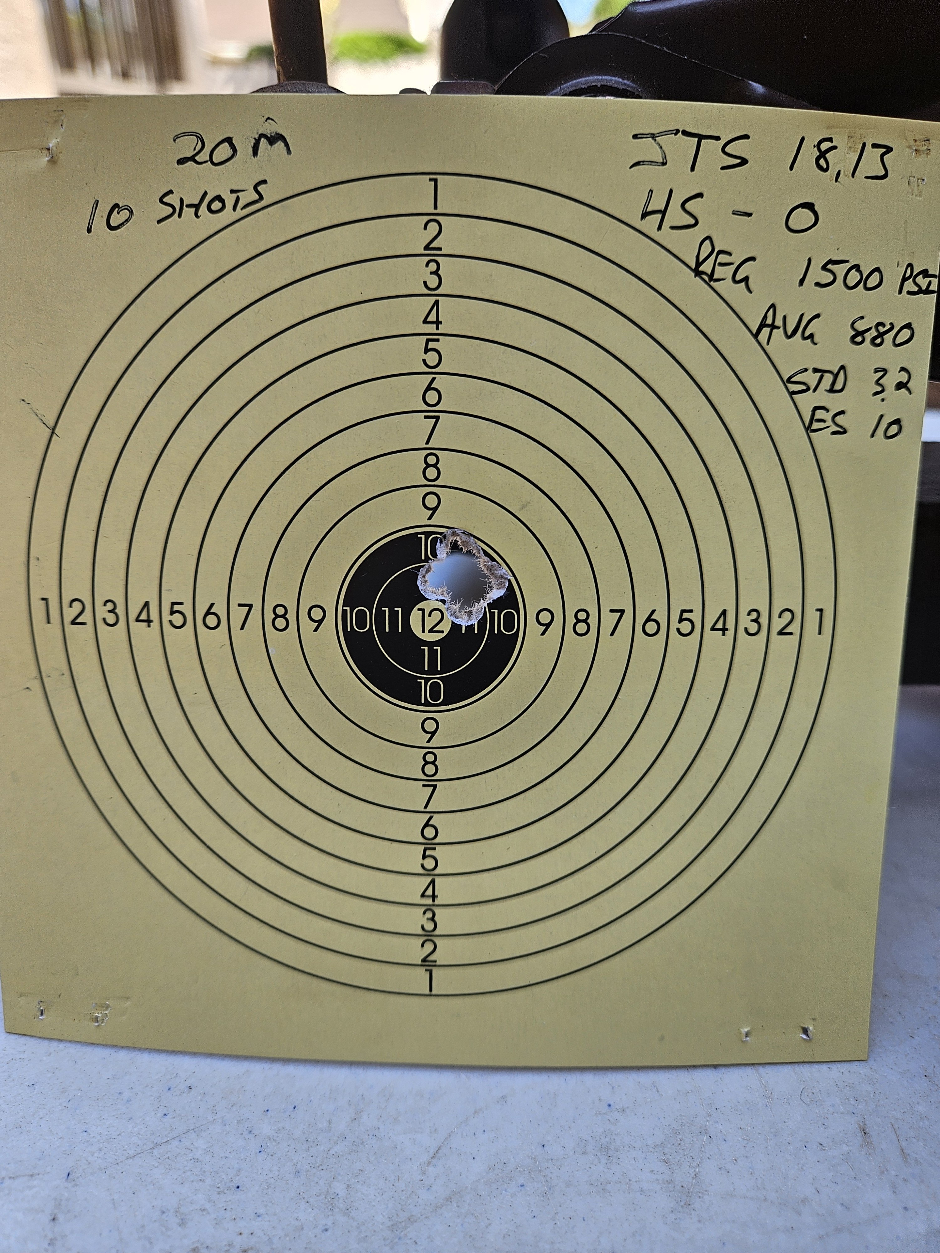

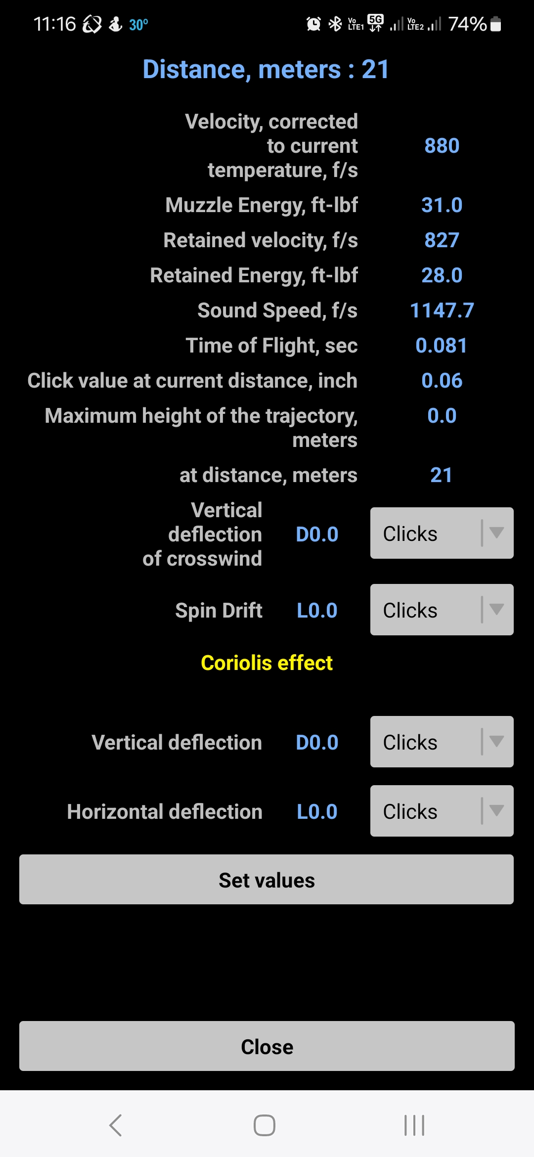

As I have zero HS (all out anticlockwise) decided to reset the reg. Followed the proper procedure and reset the reg which after fill came up to just over 1000 psi in my gun. Decided to set on 1500 psi and shot a 10 shot group of the JTS pellets with a fps average of 880, SD of 3.2 and an ES of 10
Will look at leaving it here and then play with the hammer spring to increase to check if the groups tighten, but so far I am extremely happy...
