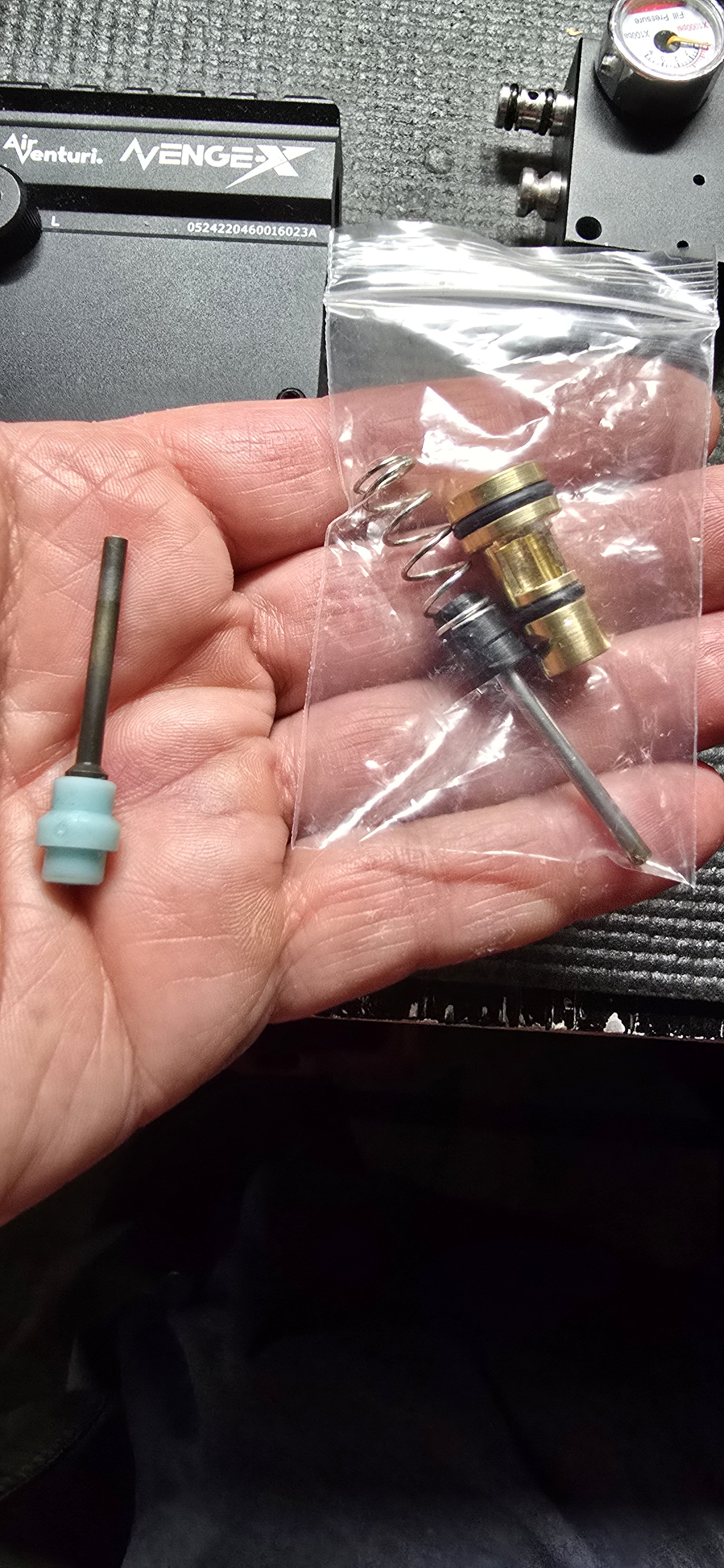

Can someone tell me where this goes in an Avenge-X .25. Ive looked at the exploded veiws and watched several videos and cant seem to find out. Ive had my rifle tore down fir about 3 months waiting on a part. Im ready to get back to shooting.

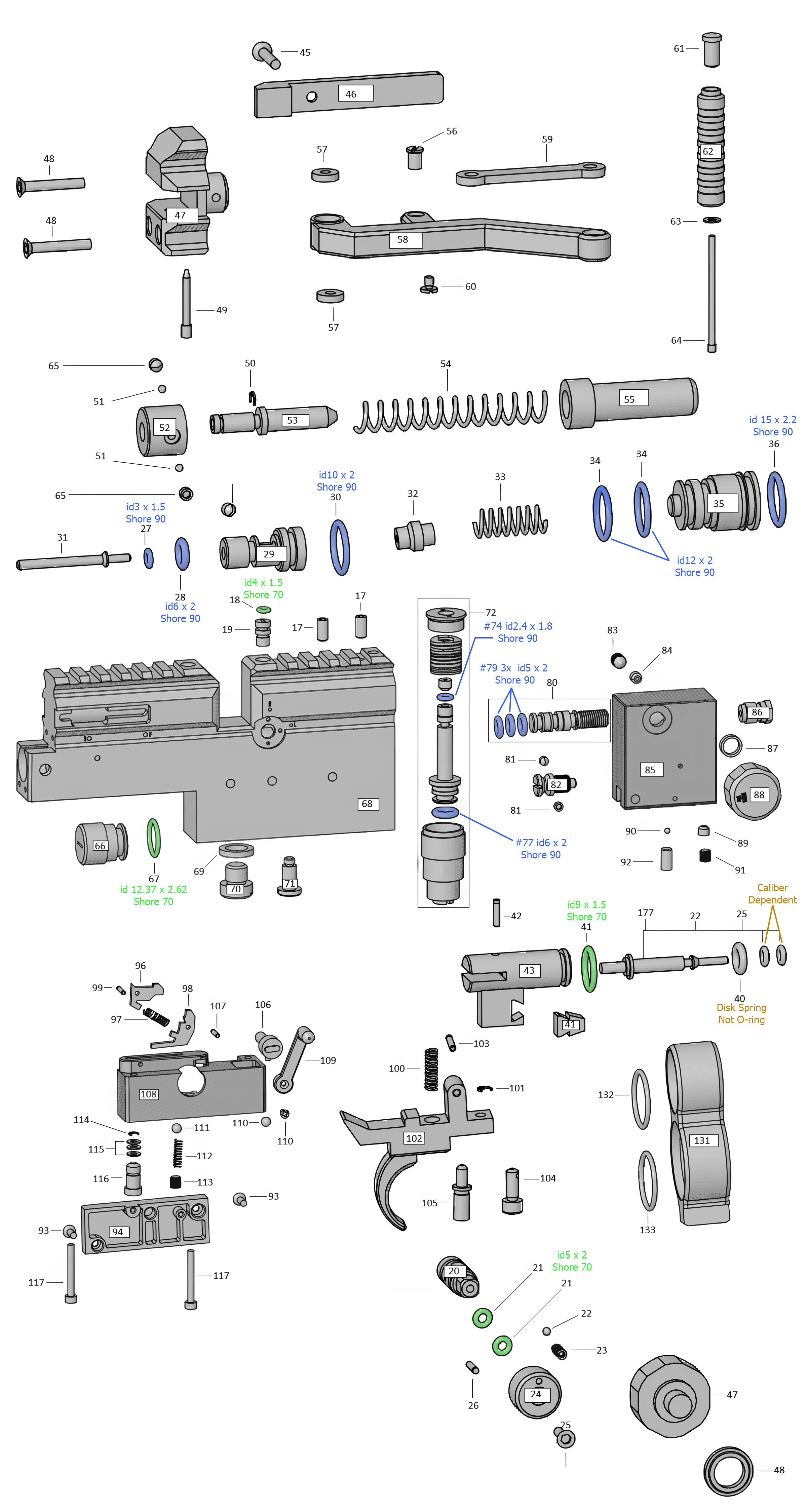

No its not that part. The plastic piece is smaller and the spring is smaller than the valve spring. I ordered a new brass valve set and that's why it's been tore down so long. Waiting on it. Thanks for the replyLooks like part 32 and 33. That is the poppet inside the valve. Iy should have a small hole and part number 31 goes into it.
This is my old puppet and the new valve set from alien airgunLooks like part 32 and 33. That is the poppet inside the valve. Iy should have a small hole and part number 31 goes into it.
