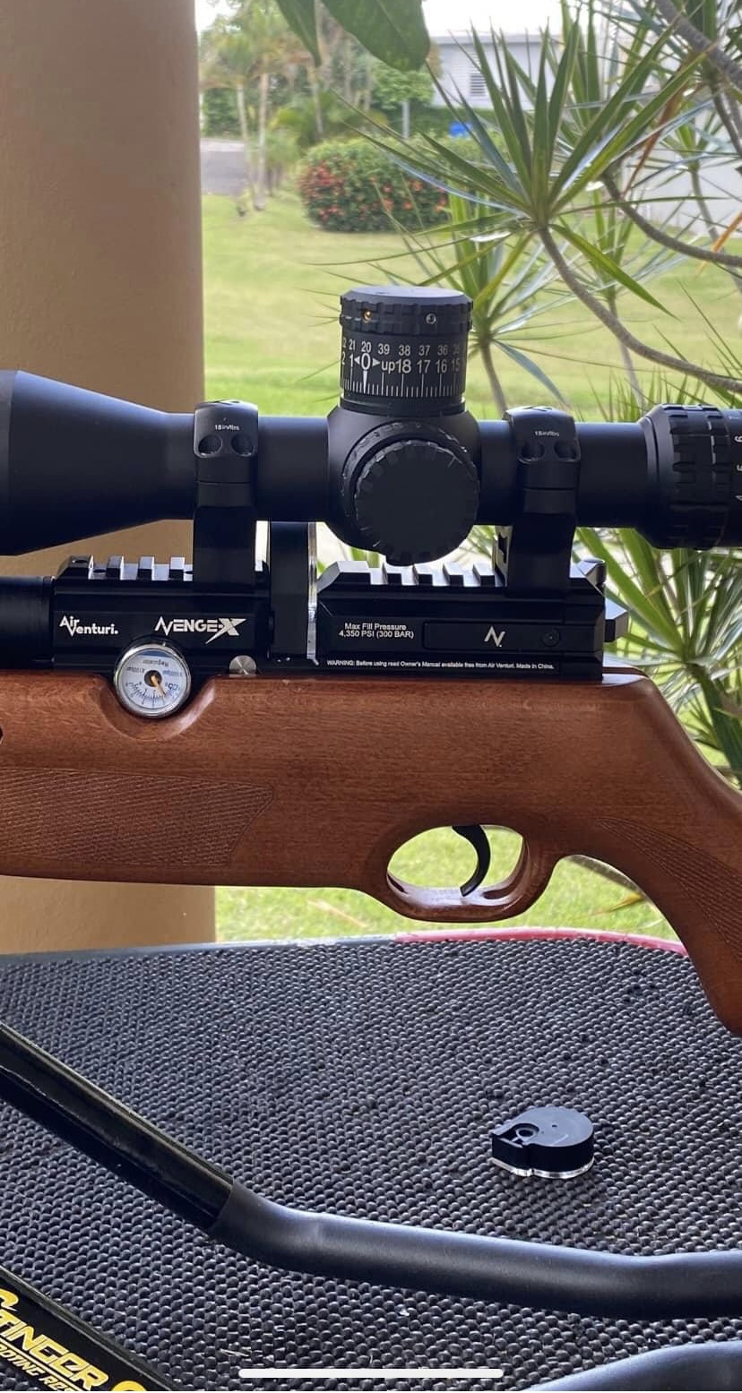

New to the group and my first post. I'm new to PCP but not new with shooting airguns so I do have a few questions on fine tuning my new Avenge X. Went with the Classic in .22, mounted a Talos BTR Gen 2 ,have a Donny FL RYU mounted as well and shooting JSB Heavy Diabolo 18.13gr. So out of the box stock does anyone know what the FPS is from factory? I did find one video from Nate at Airgun Channel doing a review that indicated his was around 950fps, just curious if others have found this to be true? It also sounds like the best accuracy and performance for this platform might be around 890fps, wondering if this is true?
I've got this one dialed in pretty good at 45yds but the frustrating part is that my POI seems to move on me from time to time, about 1-2" on windage. I reluctantly made corrections only to find 10 shots later it needs to go back to where it was. I've checked my scope and mount and yes they are tight. I'm curious if this could be caused by a high out of the box setting and maybe the hammer needs to be dialed down a bit. If so can this be done realistically without a chrono?

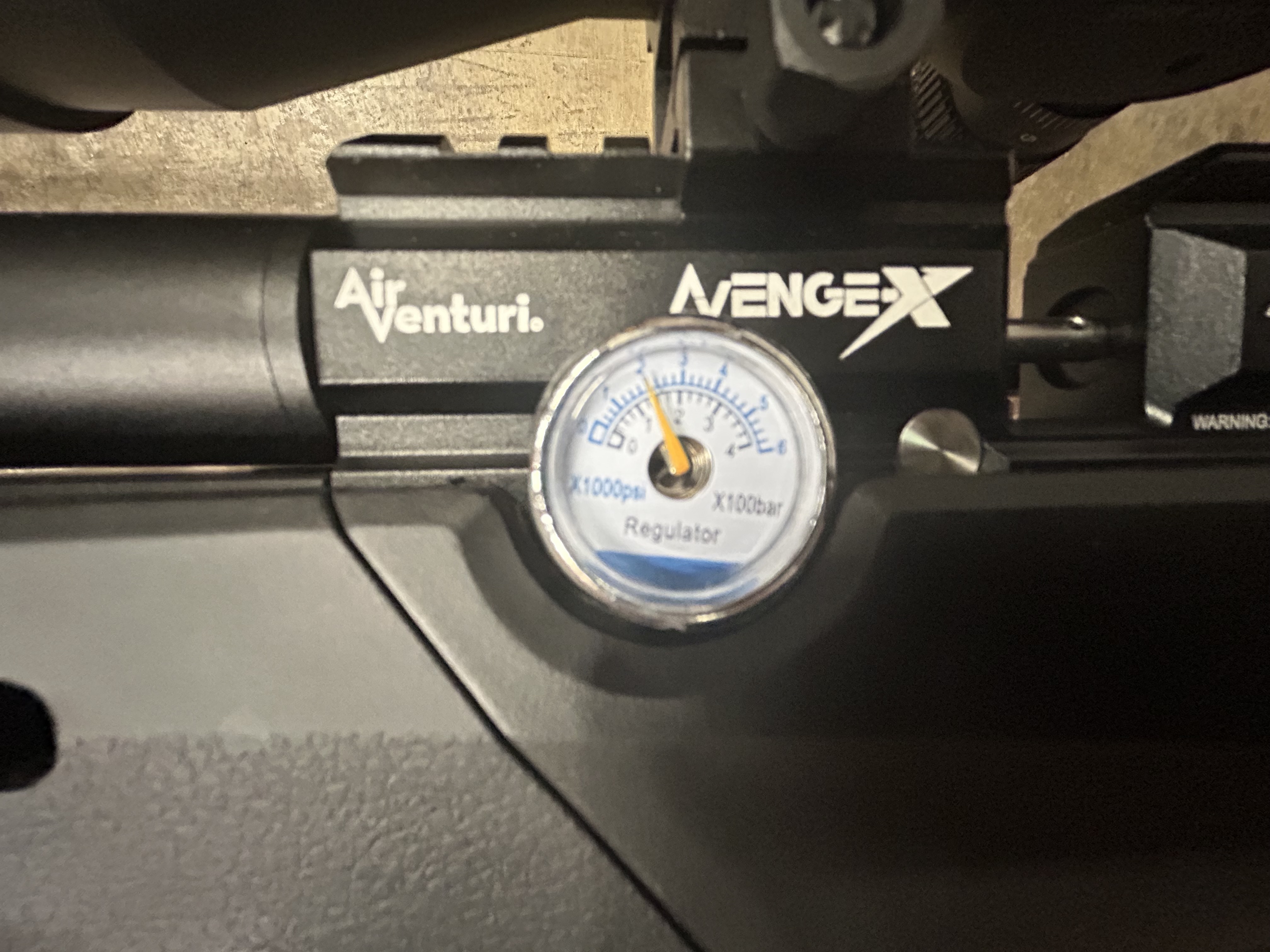

My regulator seems to hang out around 2000psi, does this sound about right? So far I'm just thru my first can of 500 pellets. Appreciate any help or advice on fine tuning this in.
My 22 Avenger X came from the factory at 2100psi give or take. With the hammer spring all the way out it is shooting JSB 18.13's at 900fps. Very very accurate at 50 and no movement at all. Clean the barrel good and allow time for the reg to break in. FYI, you are 40 minutes from my house. Wartburg.

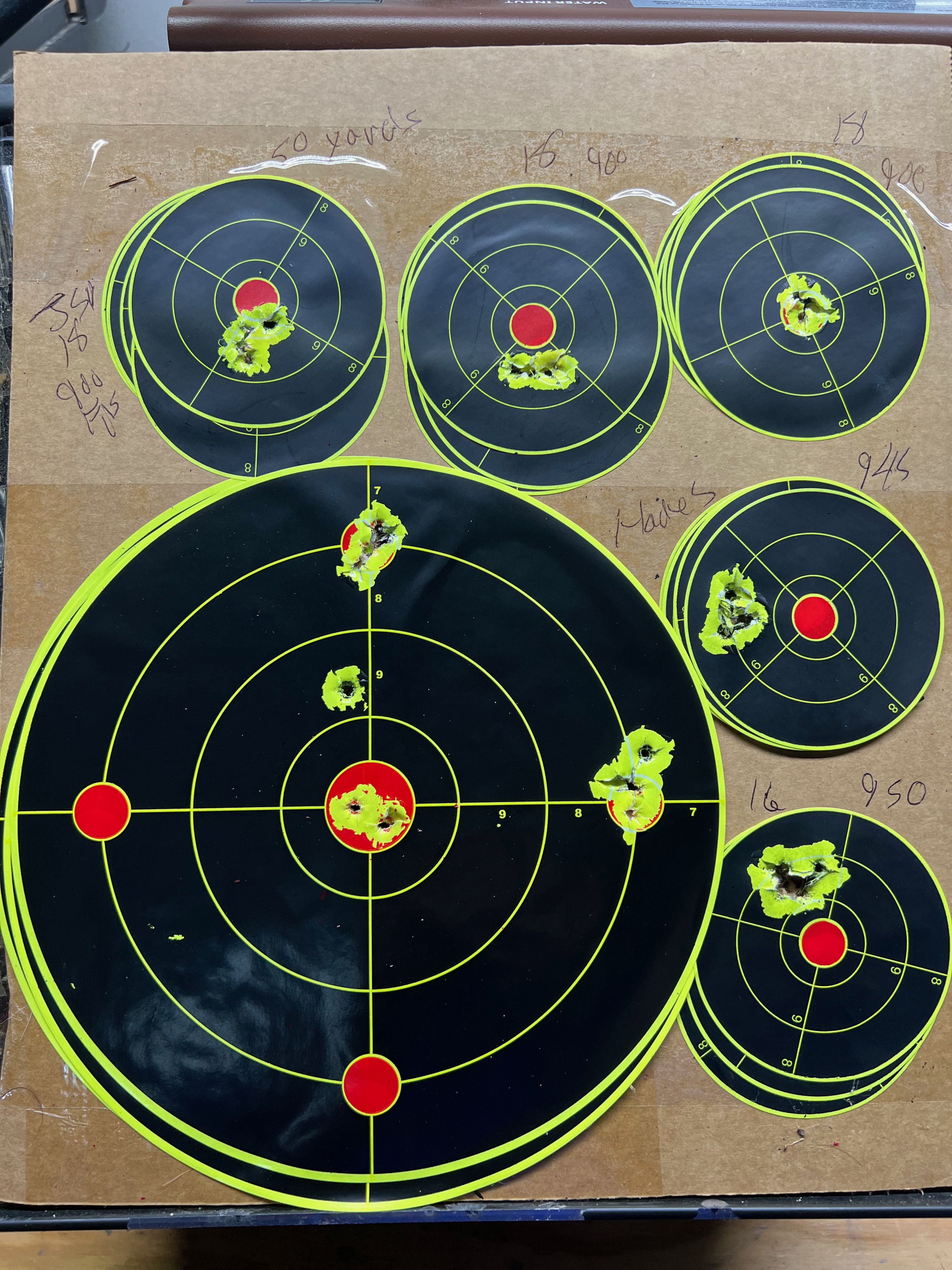

Your reg is a little lower than mine. Not sure where your hammer spring was set from the factor. I have a FX chronograph and really like mine. They came out with a newer version since I bought mine. Should be better. Never had any problems with mine. Below is the pic of where my reg is at until you get a crony. Also there is a pic of JSB 18.13's at 50 yards shooting right at 900fps at 2100psi. (Top 3 targets are JSB 18's) I live 4 miles from the old Brushy Prison.

Nice tight groups indeed! Yes I misread your first post and you went up and not down, guess I'm convinced that I'm high on fps just because the video has been the only source until now, but who knows I might actually be low. I will mark factory position of hammer and make a few turns up just to see what it does to the reg and my groups. Definitely going to invest in a chrono and now start researching that. By chance do you remember how many turns you made clockwise before it topped out on the hammer?

Yeah I would go counter clockwise on the hammer spring almost all the way to the end. You may be over 950fps already. In your case with the reg being just slightly lower it would put you around 880fps which is normally perfect for JSB 18's. I had Pyramyd Air do the 10 for 10 when I bought it just to make sure there were no problems before they mailed it. They may have adjusted the hammer spring. I'm not sure because they tested RWS Hobby 11.9 grains in their chronograph test for some reason at 1055fps.

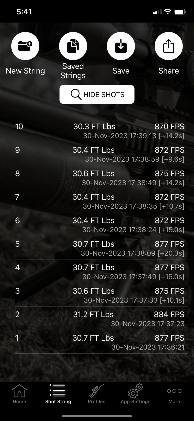

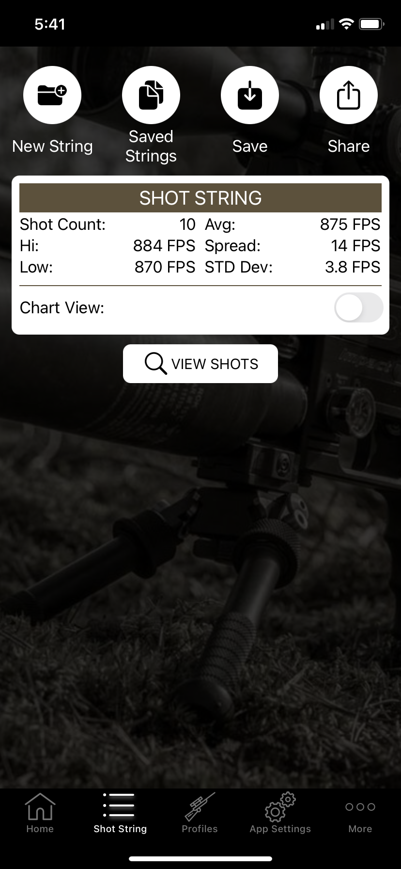

I have found the best tune to shot this 18.13 grains JSB pellets with my Avenge-X classic in .22 cal with his reg set to only 1800 psi with 0 turns to the h/s (all the way to the left). Remember that all this particular new avenge-X airguns for a unknown reason unlike the first gen ones after they are completely degassed they retain air in their plenum, so if a must to dry fired them a couple of times BEFORE you start to decrease their reg air pressure otherwise you will damage them.

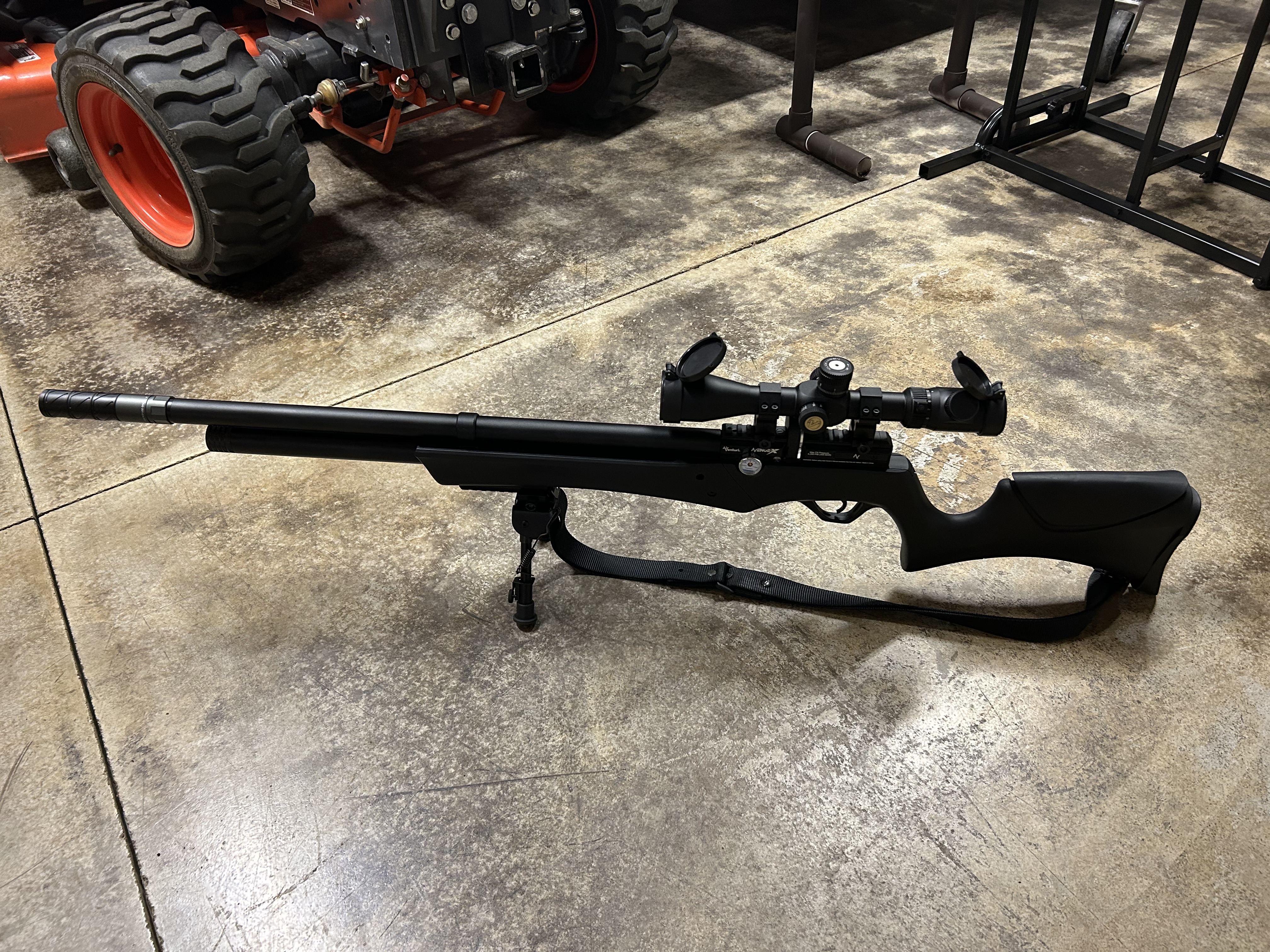

I hope nobody else have had the same issue I had with my Avenge-X in .22 cal. Because my Arken SH-4 FFP 4-16x50 scope comes with the larger 34mm tube size and I used with the Arken medium height size rings, the oem high capacity 16 shots mag that comes with this new X series rifles doesn’t fit in the breach. So for this reason I am shooting currently this rifle only with the smaller standard size mag along my others aftermarket Carm magazines. Btw this .22 cal avengers becomes a little more accurate when you used them with this mags vs the oem ones just a small tip…😉. But with my other avenge-X in the bigger .25 cal I didn’t had this same issue because I installed this same scope with the high height size rings.
