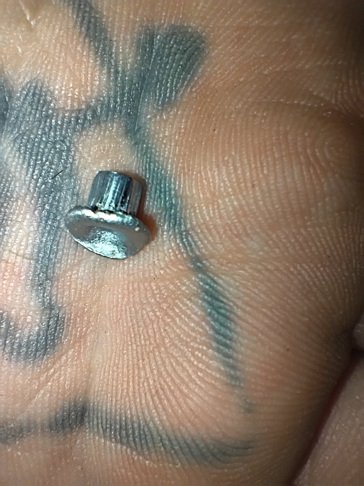

Ebay search "take aim airgun slugs" he offers 12gr-16gr and i have only tried the 16 to great effect, "varmintknockers" (13.5-16.5) Be sure to ask in the notes for .1771 also GriffinAirguns.com his .177 13-16gr flat base worked great for me in both my slug capable .177s.
