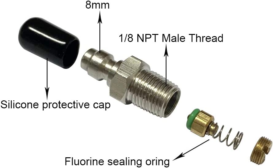

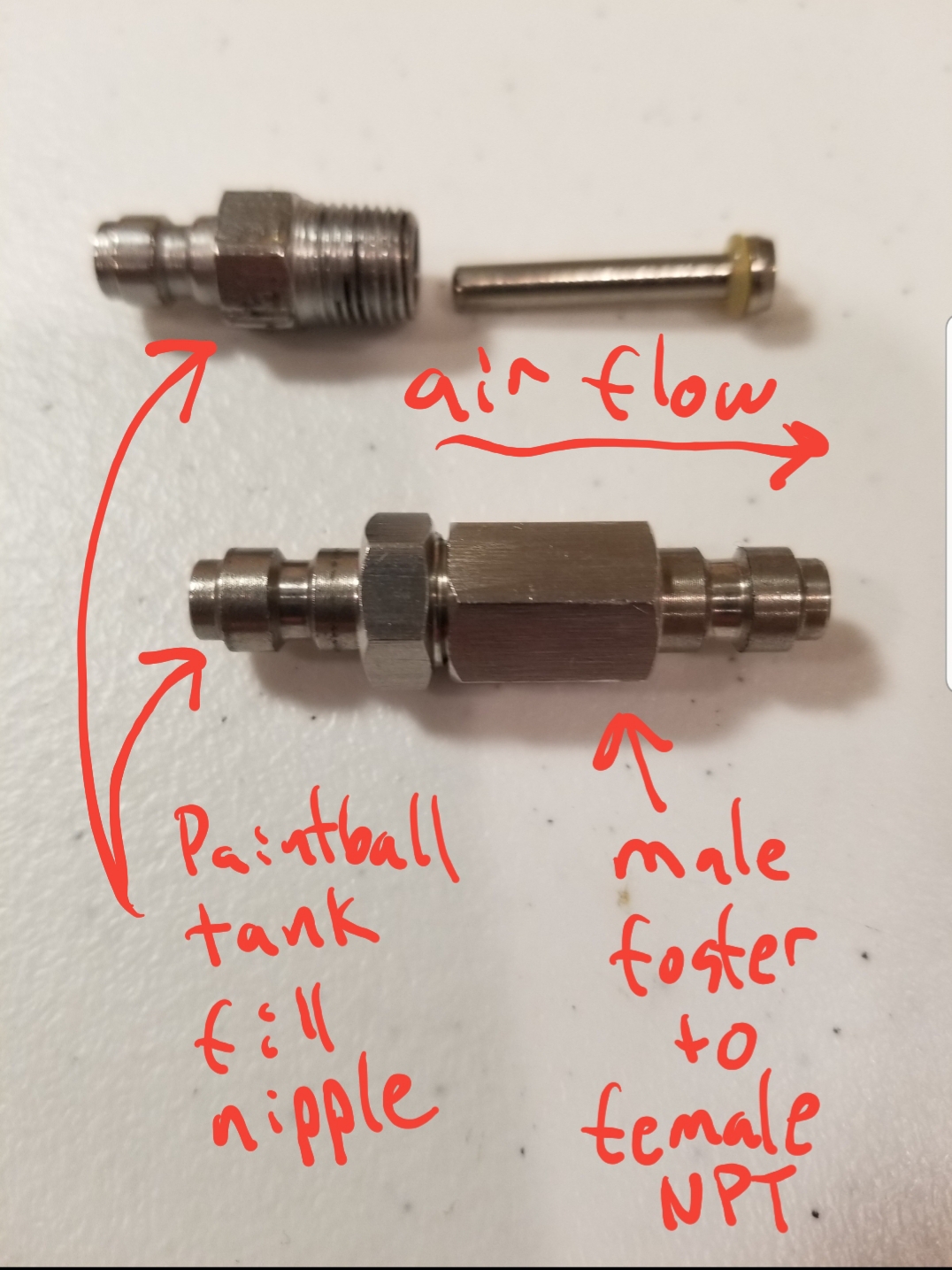

It seems to me that if the male foster fitting was replaced with a 1 way foster fitting this would achieve the objective

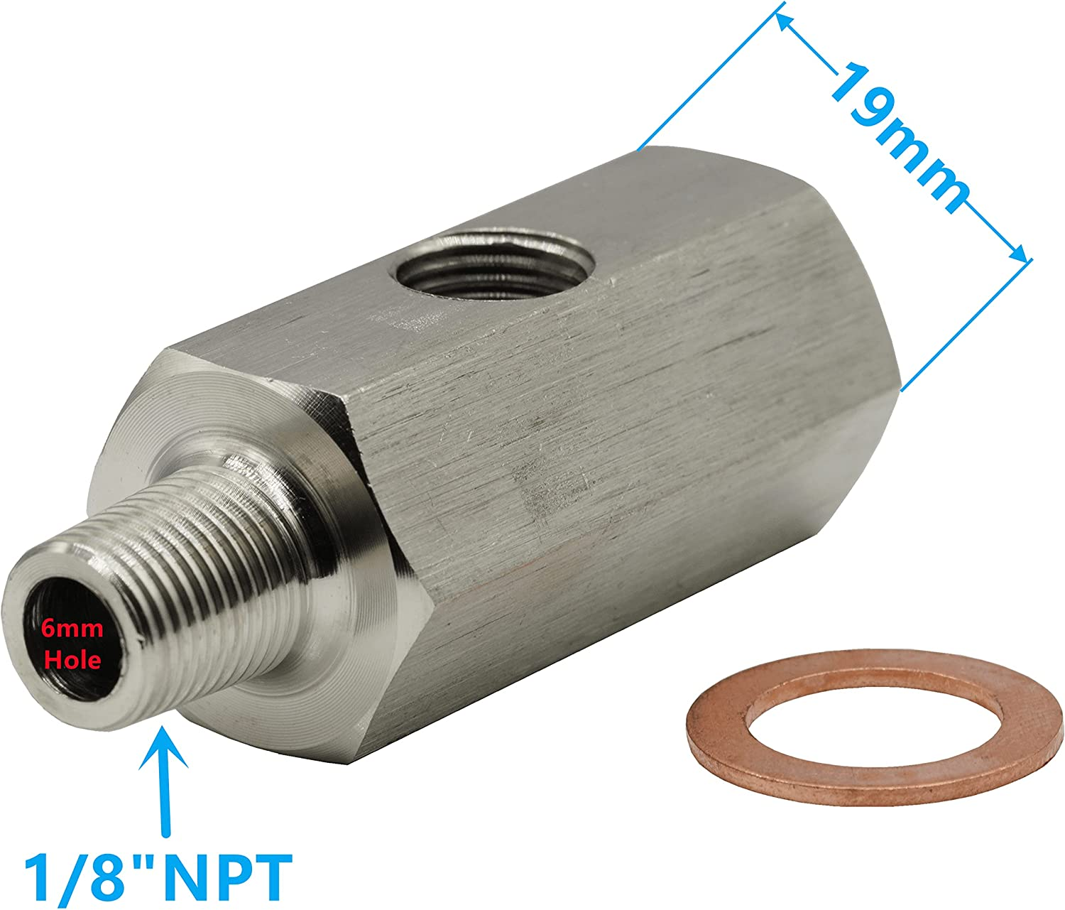

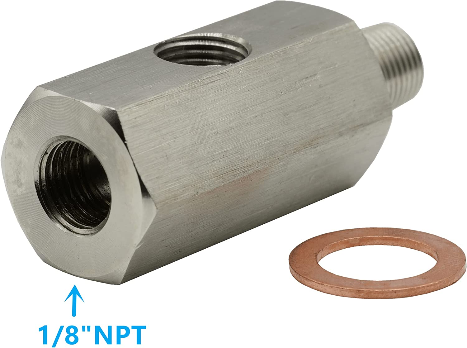

Next search is for the same thing with a threaded another hole for a pressure gauge
Excellent find! I have never seen a small unit like that with a bleed valve on it. I wonder if anyone here on AGN has one? I am curious as to how thick the walls are. If the walls are pretty thick, you could add a 1/8" NPT threaded hole fairly far away from the bleed valve I would think to add a gauge. Drill and tap it, then give it a coat of epoxy paint to seal off the bare aluminum.

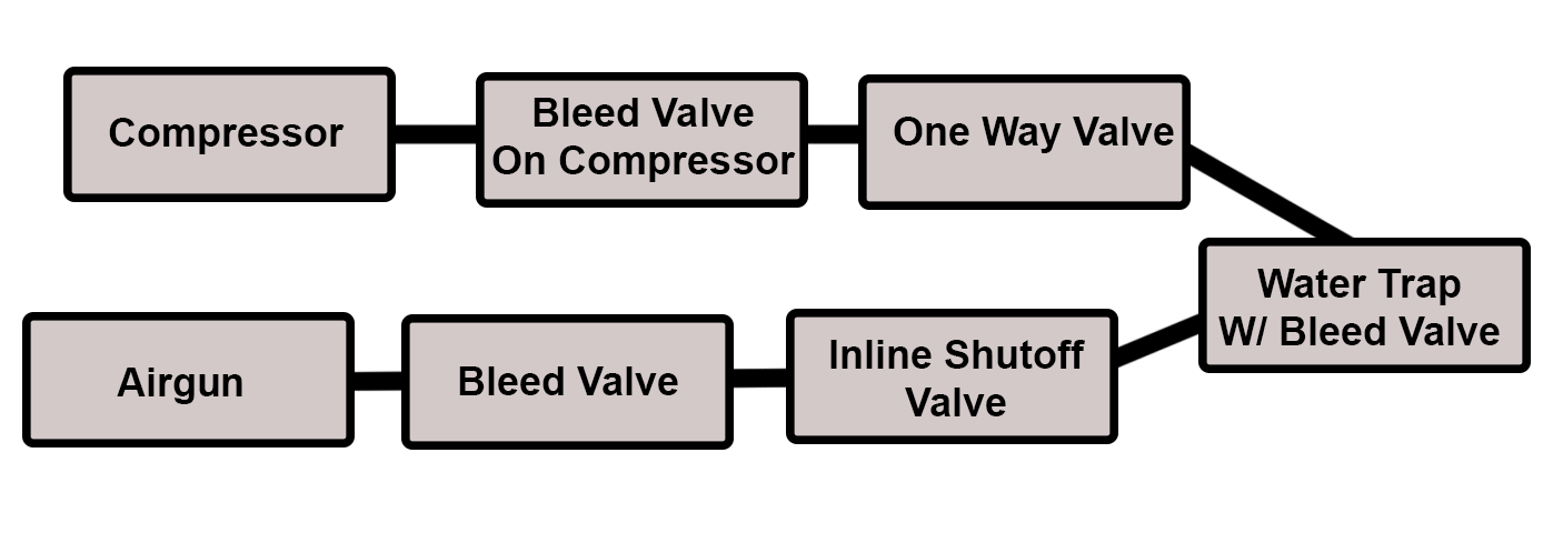

I am OK without a gauge but it would be nice to have one right next to the gun if I am filling guns. No need for a gauge when filling my tank, since it has two gauges already. Probably no need for this part either because the tank has its own bleed valve. I would be putting this item between my gun and the inline shutoff valve as shown in the image, followed by the large water trap so I can disconnect a filled gun, hook up another one, and restart the compressor with no load for the next gun, without losing the pressure in the large water trap.

Where does one find the check valve part? (Off to search now....)
Edit: Found this on Amazon for $9. As long as it is installed in the correct direction with an appropriate connecter on the threaded end to match up with your hoses, it should do the job, correct?
This is exactly what I plan to do, so that I don't have to dump the air in my large water trap every time I shut off the compressor so I can start it back up with no pressure in the line attached to the Yong Heng. It often takes a LOT longer to just fill the water trap to 250 BAR than it does to fill some guns from completely EMPTY to 250 BAR!
If I wanted to fill several guns in a row directly from the Yong Heng rather than my tank, having to bleed the entire system to hook up another gun is a huge waste of time. With these parts on the compressor side of the water trap my filling time will be cut by 50% to 90% with some of the smaller cylinder guns.
I like this idea. After reworking some hose and fill configurations I now see a use for a check valve on my SCBA tank tethering setup. Today I put a male foster fitting on my DIN300 fitting coming out of my scba tank. I don’t like the idea of someone opening the tank valve and causing HPA to rush out of my fill whip.

I have this filter. It has a check valve. Put color changing dessicant beads in it and a little cotton filter, to make sure what I'm pumping is dry air.
