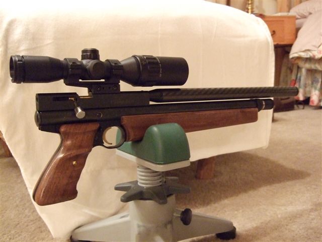

David Slades ristol miss rifle stock:
Legal 15" rig that dropped right into a rifle stock when desired. Zero shift in anything and spot on at all FT ranges.

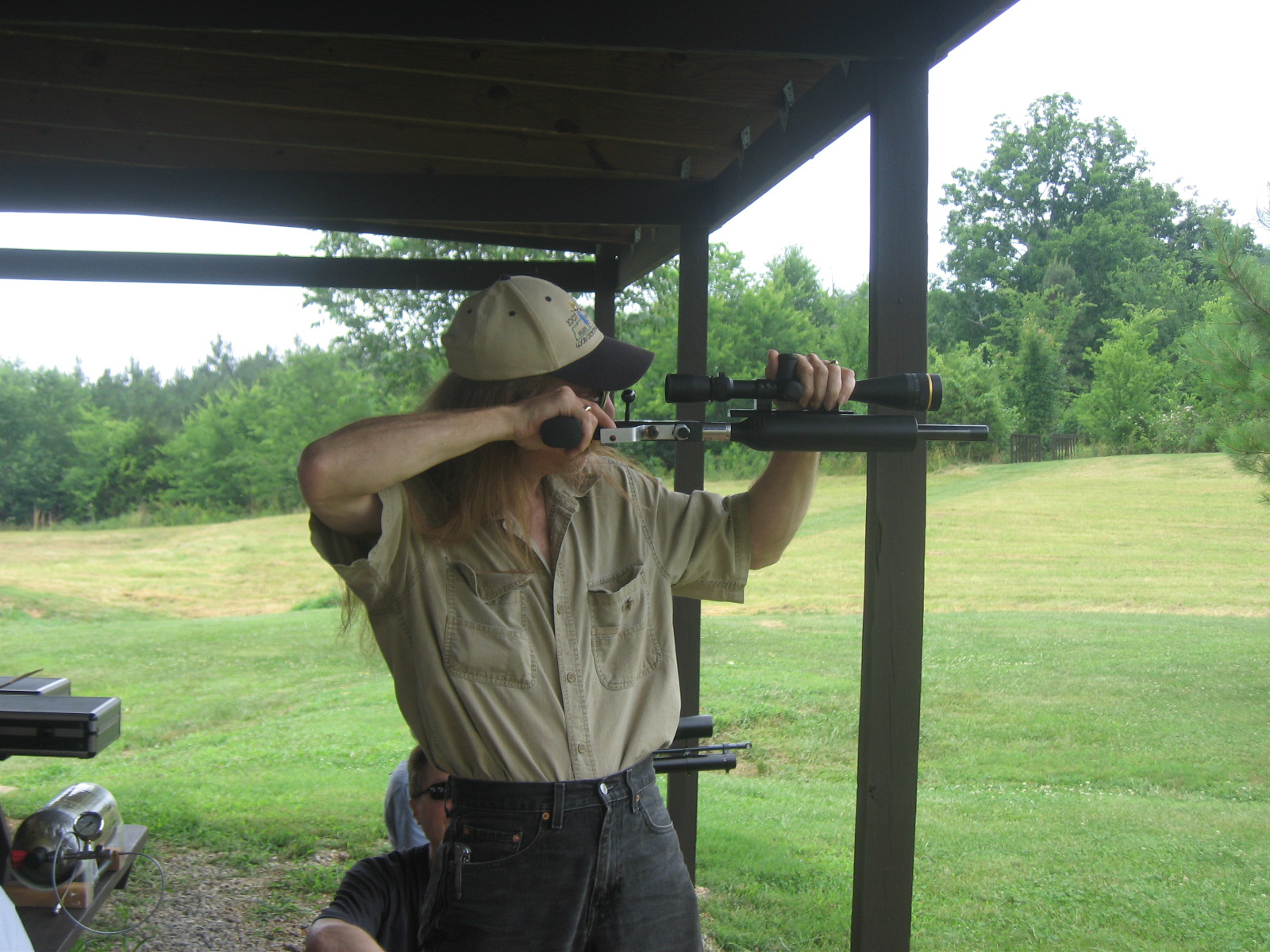

One issue with with using a pistol on forced lanes:
(that is Jim from MI pistol I was trying. He took 1st place at the TN State with it)

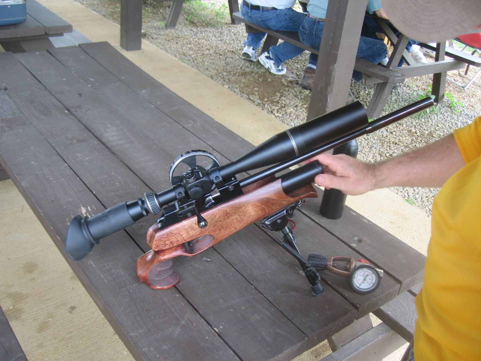

SteveV's 2260 - a Mike T. build would do it all and again and be a ristol or pifle
And that way back when, so many more choices now.
