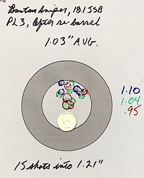

The .22 Sniper XR I bought brand-new wasn't accurate. A bore-camera revealed cavities in several places in the rifling. Warranty barrel replacement solved the problem. Hundred-yard target after rebarrel-

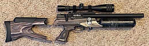

I've since converted the rifle into a pistol/carbine convertible. No accuracy was lost in the conversion-
