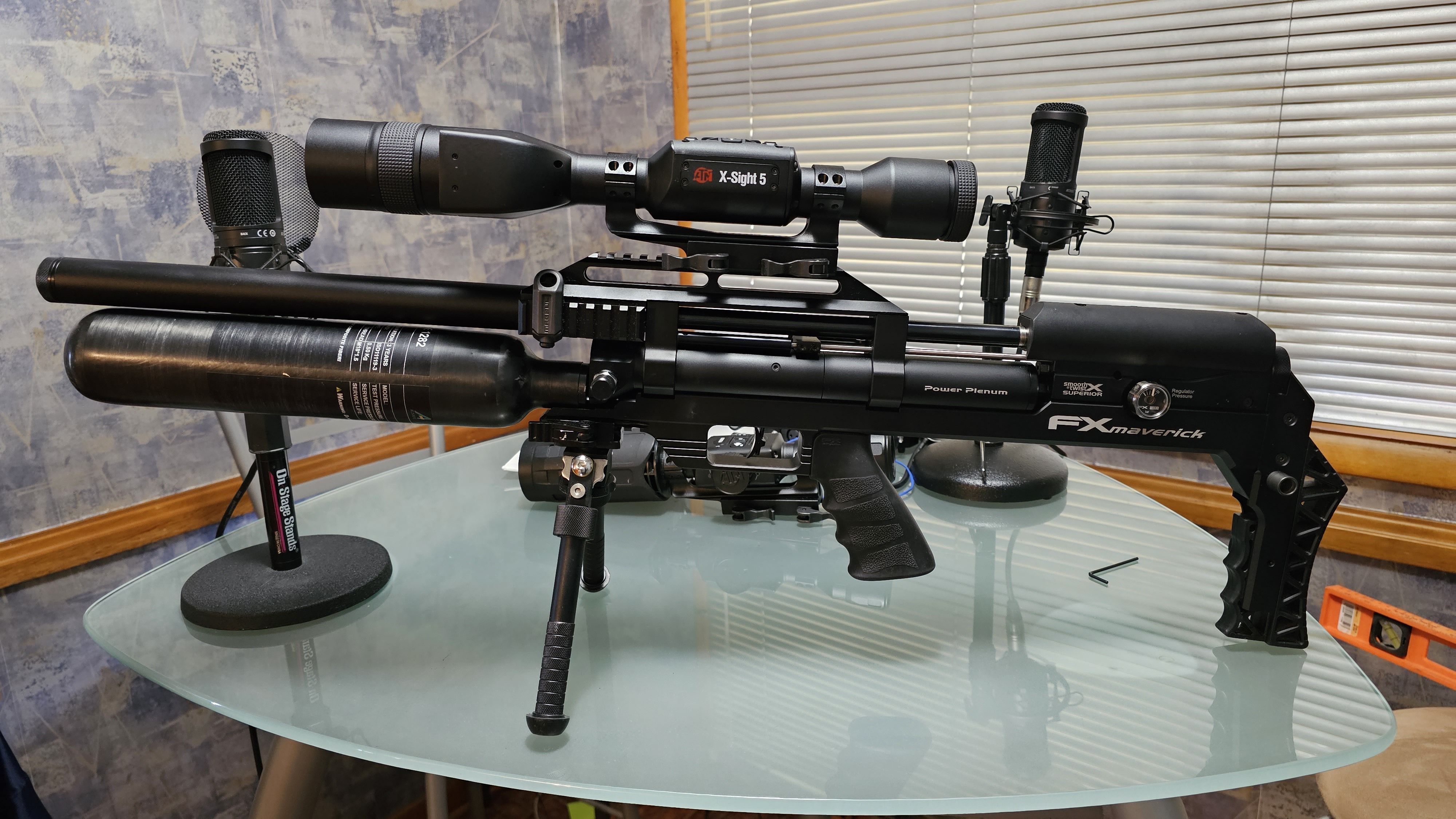

My scope also arrived today.
I feel that the visual quality is an improvement, although not a jaw dropping improvement. Being a city slicker, I got to wait until tomorrow to get to the range to Zero the scope.
I'll spend some time playing with it and creating a new reticle as I eagerly wait to get to the range in the morning.

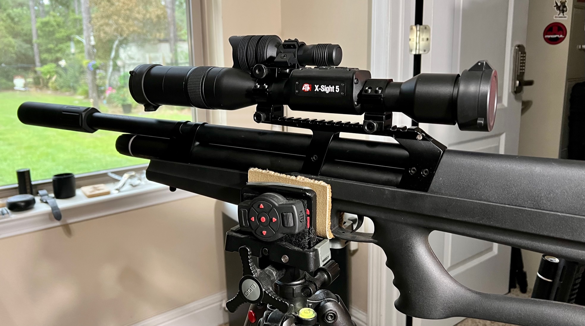

X-Sight 5 #3 arrived today. Thus far, it's the best one yet, but it still has issues. Audio still isn't working when recording at 4K and 1440Pand the RAV still will not calibrate so no way to get it to work with a PCP, which means no access to one of the main reasons I wanted this scope and that's the ability to record at 240 FPS!
The Firmware is the same version as the last one, but the resolution on screen is better than the last one. I'm going to play with this one for a week or so before I decide if I'll send it back for a refund. During that time, I hope they will release a firmware update and the ATN Connect 5 App.
Here are three video I recorded with the most recent scope. Same conditions as the last 3 videos, 37 yards at 10X in all three resolutions. The scope is mounted on my .22 cal Huben k1.
This is recorded at 1440p at 120 FPS. No audio was recorded.
This is recorded at 2K at 60 FPS. As before, this is the only resolution audio was recorded.
This is recorded at 4K at 30 FPS. This is the best recording yet!
The better screen resolution on this scope helps focus better so these videos are a bit crisper and clearer than those I previously recorded with the last scope. It's slowly getting better, but IMHO it's not yet ready for public release!
