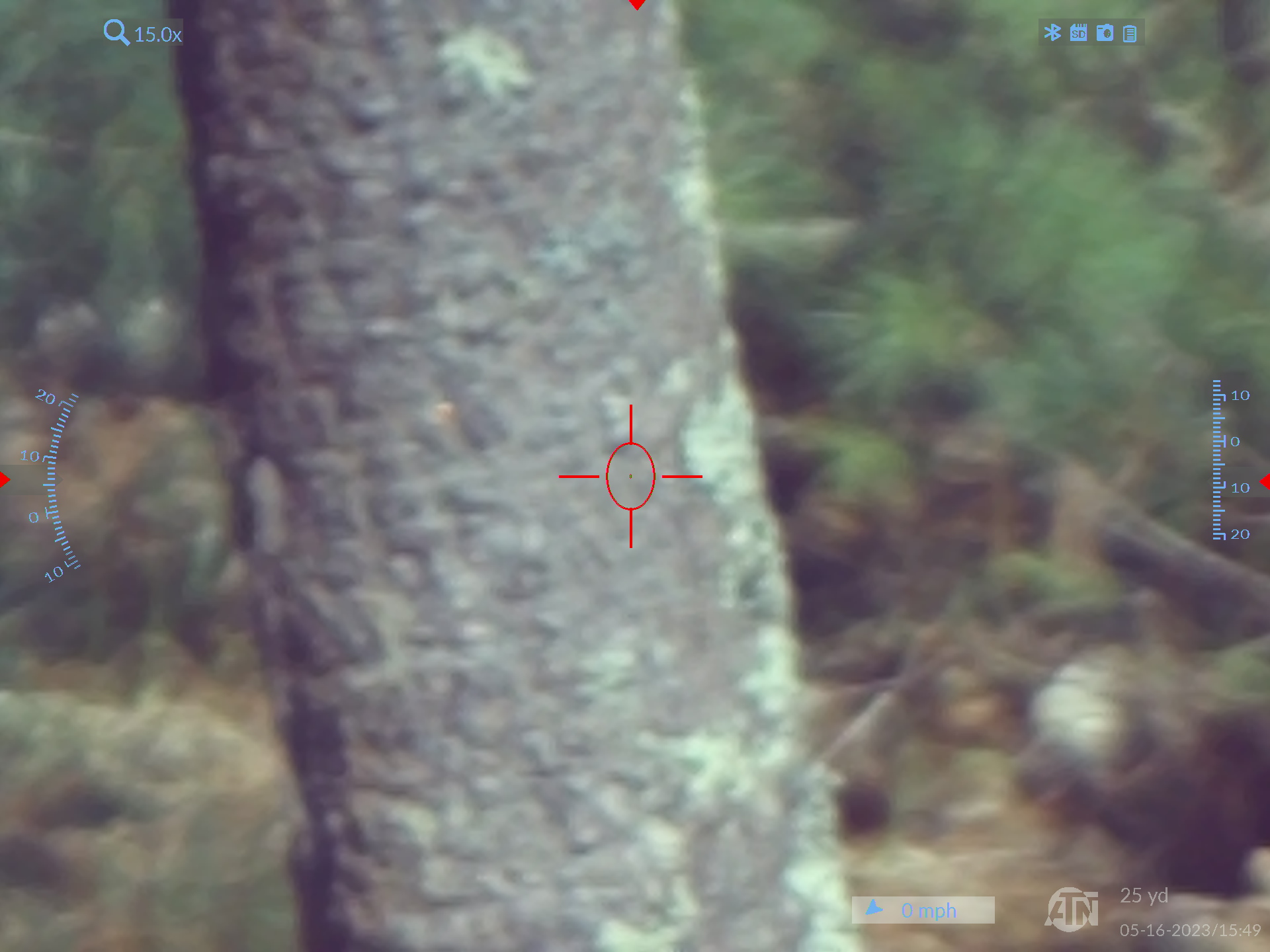

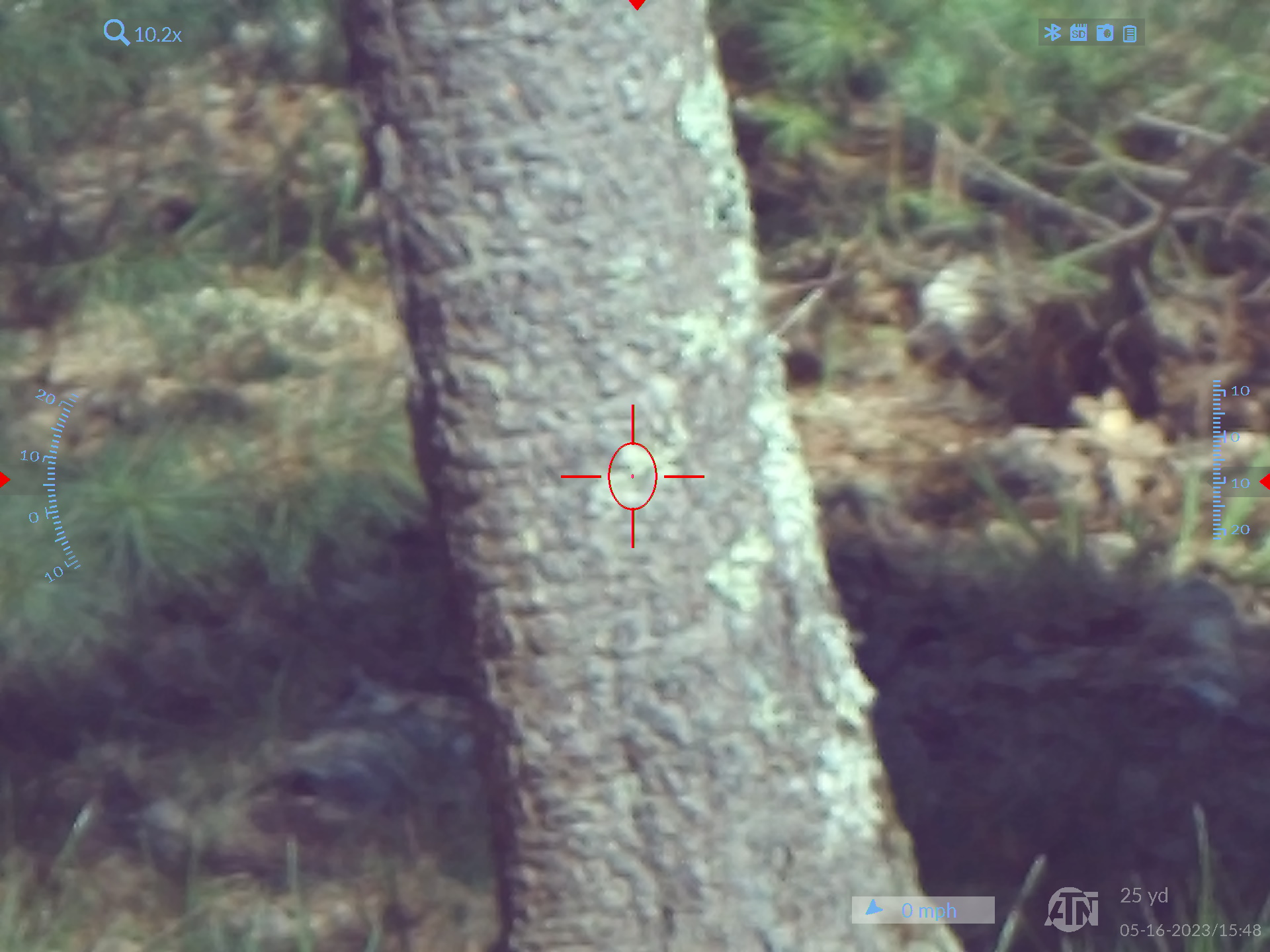

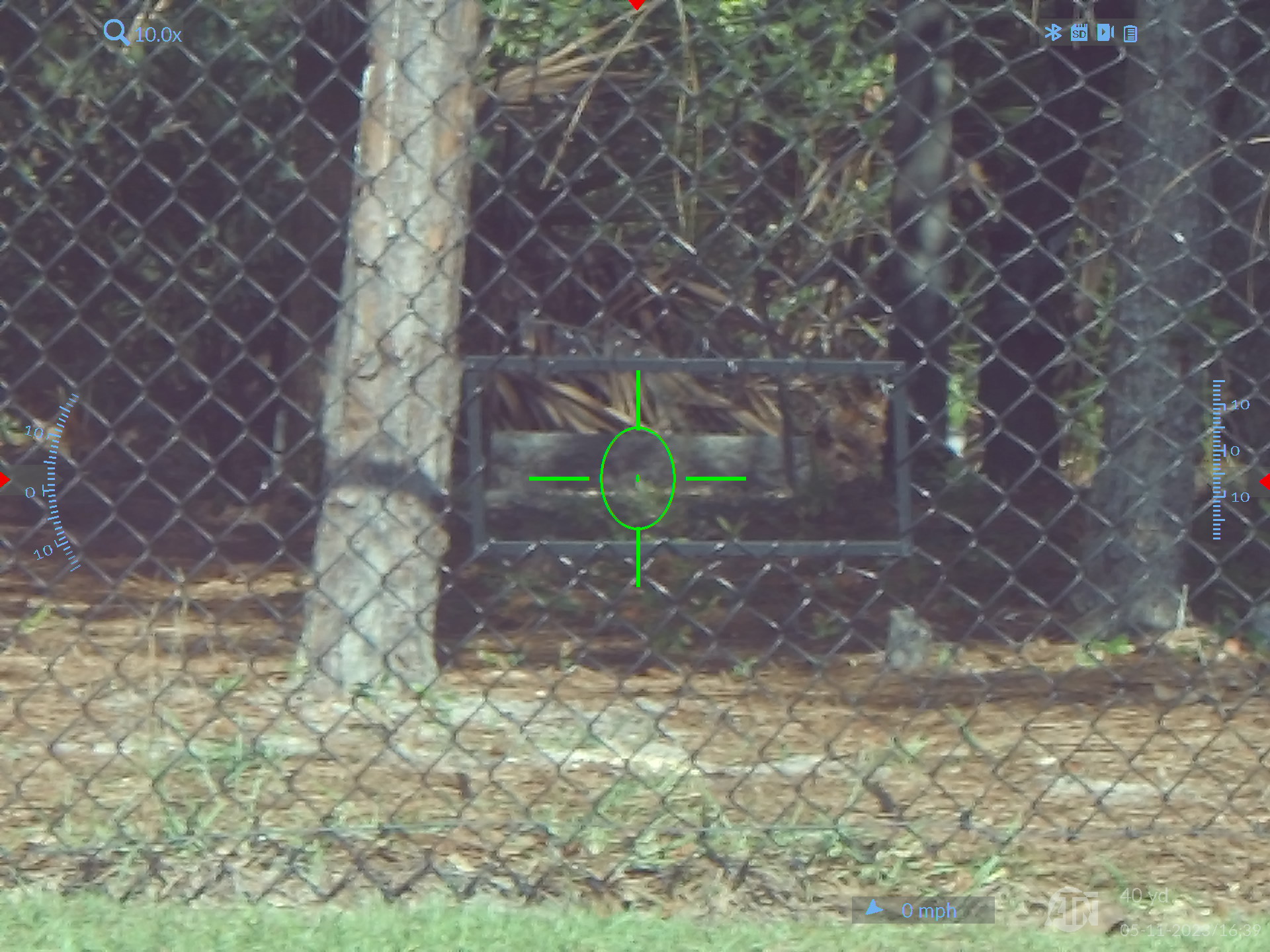

Here is a picture @10x. I deleted the movie as it did not convert correctly. I'll try again. I will do some NV work tonight with pictures and video. The picture below is as focused as I could get it.
What I think we are seeing here is the anti-aliasing filter/algorithm to try and smooth out the pixelation of the digital zoom. Remember, anything other than base magnification on the ATN scopes is digital zoom. I think they are trying to improve the zoom quality so it looked better than the 4K Pro. It's a mixed bag of course, smooth/soft or pixelated/digitized.

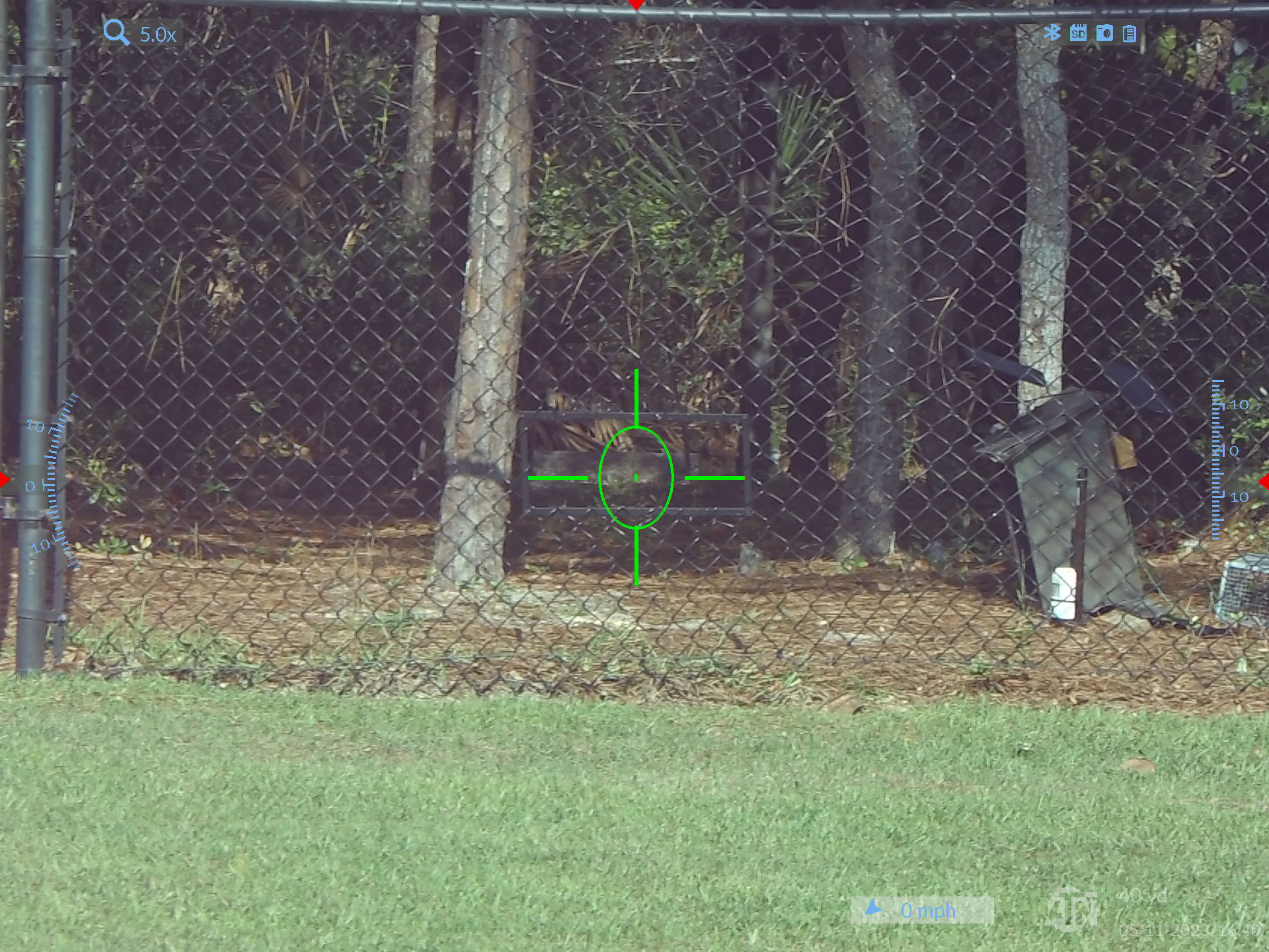

Mine focused a little better, but now much. Here are 2 pictures I took:
This is at 10X
This is 5X. The fence is 37 yards away, the concrete bait station the reticle is supposed to be focused on is 50 yards away.
Images look pretty sharp, have you tried a small aperture for the objective lens? Usually it sharpen the image up very nicely and reduce focus sensitivity.
Yes, I had an old lens cap and drilled a hole in it like I did for the 4K Pro, but it didn't really help much. I'm still waiting to get a shipping notification for the replacement.

Bummer! Maybe a smaller peep hole? Given this supposedly a bigger and more ensuring sensor it might need less light.

The impression I got was the Gen 5 needed more light! The Gen 4 has a 50mm optic, the Gen 5 I believe is only 40mm or maybe 44mm, I don't have it anymore to measure it, but it looked smaller than the 4K Pro. There is no mention of the optic size of either on the websight. When I drilled the cap (same diameter hole I use on my 4K Pro) it was considerably darker, even after I brightened the screen to 5.
