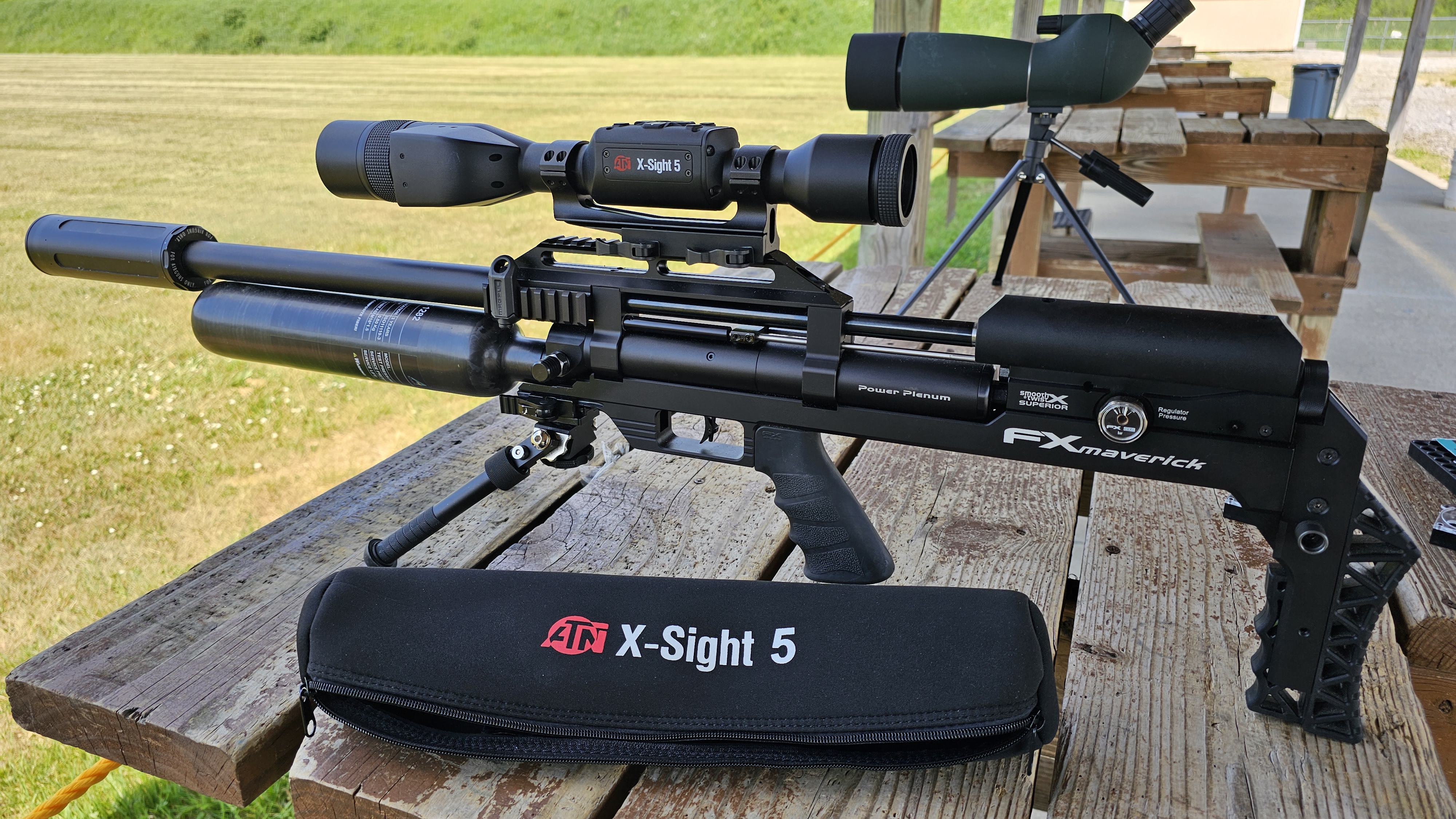

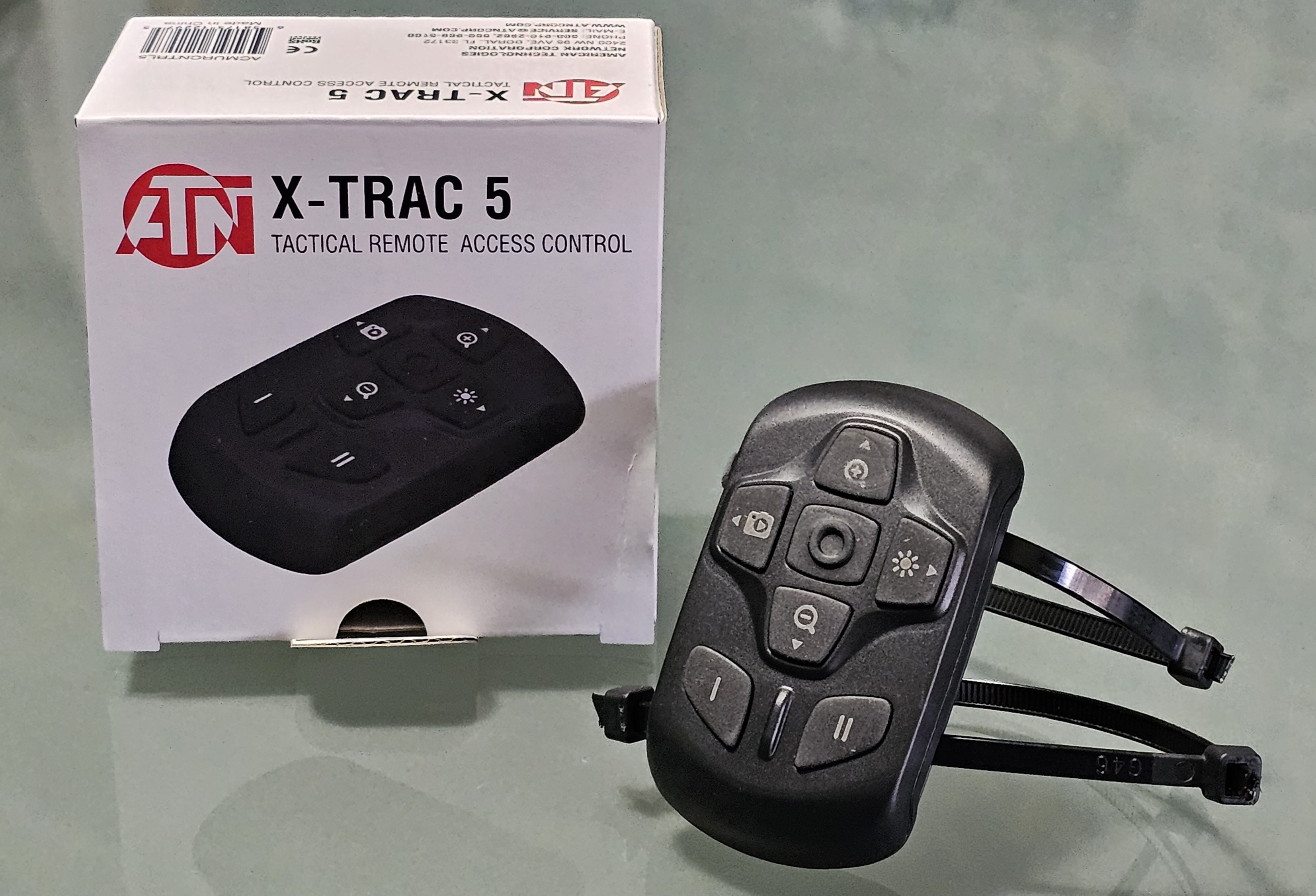

After receiving my scope back from ATN, it came loaded with Firmware Version 5.1.04.476. This has solved most all of my issues with the scope, and I have put the scope on the Maverick for the rest of the 2023 hunting season! I have even purchased the new X-Trac 5 remote control to run my scope from my hunting grip.😃😃😃
