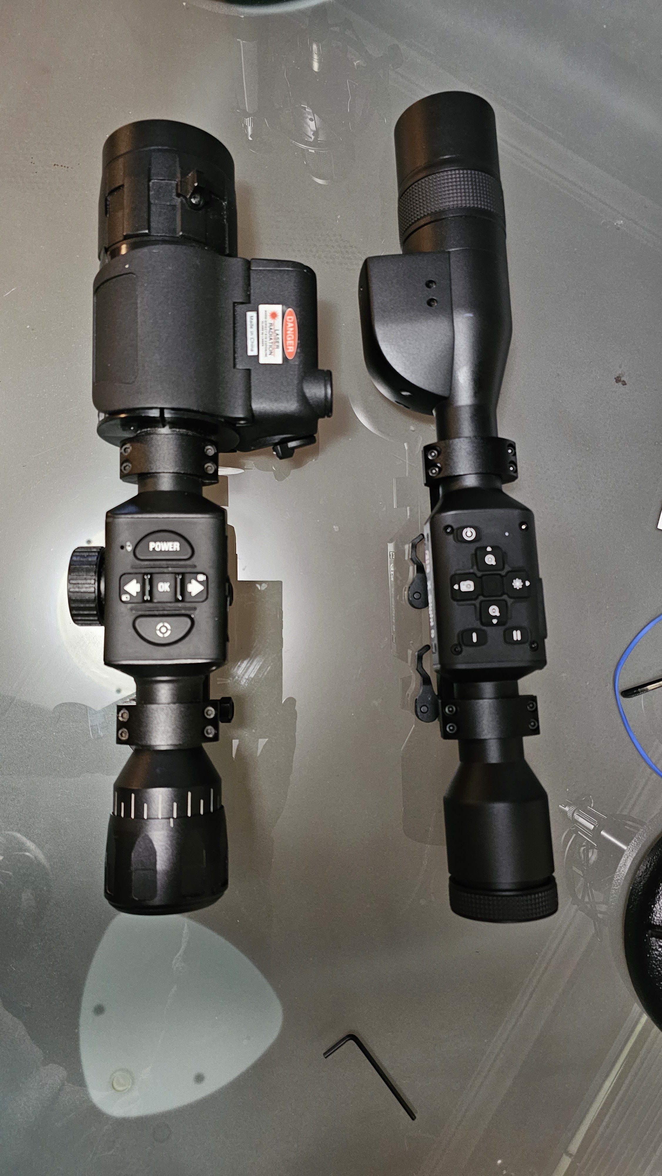

They did a significant size and weight savings compared to the X-SIGHT 4K Pro with ABL. The numbers on paper are minor, but very significant when you swap from one scope to another.
