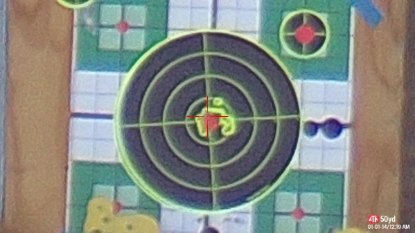

So I found the digital zoom just too grainy for my taste. Glass quality is meh. At 20-35 yards it's fine but at 50 it's unacceptable. My previous scope on my air rifle was an Leapers UTG Accushot Premium Scope 30mm 6-24x 56mm 1/8 MOA Adjustments Side Focus Zero Lock 36 Color Illuminated Mil-Dot Reticle with Max Strength Rings Matte
So here is the picture at 50 yards with a 20 shot group if I recall (2 mags) from my .22 Vulcan Tactical shooting JSB 18gr diabolos.
I am using the highest magnification with the extended setting in the advanced menu, about 50x.
(ignore the time stamp, it resetted while I was trying to edit my profile in the menu and I didn't notice. This was yesterday.)

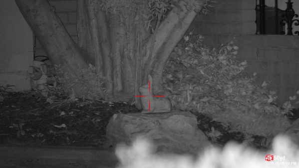

The night vision is also pretty decent. The included 3 scope rings are a very nice touch but the included ir light while bright enough for 30 yards should have included a rechargeable battery.
In short, if your shooting under 35 yards and need nightvision, this is great but past that ymmv.

I agree with him, the zero setting is awesome, but use a sled to make your life easier. I used the sled for the first shot and after moving the target back attempted to rezero using the Bipod. When you attempt to use the dial or buttons the image moves as expected and it might take a while to get the cross hairs aligned correctly. Yes, I found out later I could zero at X distance and use the rangefinder. DUH.
Now to the important parts to me. A scope should be clear and bright - FIRST. I'm not sure if it's one of three things, but I think it's the combination. One - Optics, Two-Sensor, and Three- Display. The display is bright and will need to be adjusted lower for night shooting, it will kill your night vision in short order. Day shooting, the image displayed is grainy, the 16X zoom didn't feel like it was a 16X magnification. I don't have any Optical Targets to test with so an honest review will have be left to others. There is not an lens in front of the sensor, so I believe the magnification is all digital.
I love the "stuff" if comes with, angle, range, tilt, compass, etc. etc. etc. but it should be a real scope first and then add the silly things like wifi, GPS, etc. etc.
I'm not sure at this point wither I will keep it or ship it back. The $600.00 price tag has me leaning a particular direction. My inexpensive Athlon 3-16 would make a better day scope so it may go back on. I may keep this just for video or night shooting, unless someone has a better answer.

I’ve had none of the issues you faced, but I also work with digital cameras quite a bit, so I know what will work and what won’t. It’s a digital scope, so expecting it to be like glass is setting yourself up for disappointment. With that said though, that video quality is terrible... so I get why your intitial thouhts are what they are...
some suggestions:
1) put the sun shade on. This is really a digital camera... reducing the amount of light will help sharpen things up. This is step / option 1. Option 2 is to get a cap and drill a small hole in the center. I don’t like this, as IMO you’re just putting a band aide on a faulty scope.
2) ditch the included IR and get a higher powered one... you’ll see the individual hair on a racoon at 80 yards. All night vision depends on IR.
3) call ATN support and have them help you with the setup/settings. What your showing on video is pretty bad... so I get why you think it’s junk. That’s not what it should look like at all. There is either something you missed within the settings, or that scope is a lemon. Calling them and walking through it will allow the support team to either help you fix it, or they will see it’s broken, and will start the process of an exchange.
Oh wait... I see another major issue. You have the extended zoom enabled. Turn that off. I’m not even sure why they offer that... it will make things so grainy.
to save yourself time... I’d just call them and walk through each settings screen with them. They will tell you what to enable, diable, etc... but in the meantime, turn off the extended zoom

Good Call, I'll call them on Monday. I was just on the ATN website and the videos they show are definitely much clearer than what I was seeing. If it can be corrected, I'll keep it.
Smitty
Thanks, I realize that the extended zoom setting would result in very low quality video but he it's there so I had to try it.
