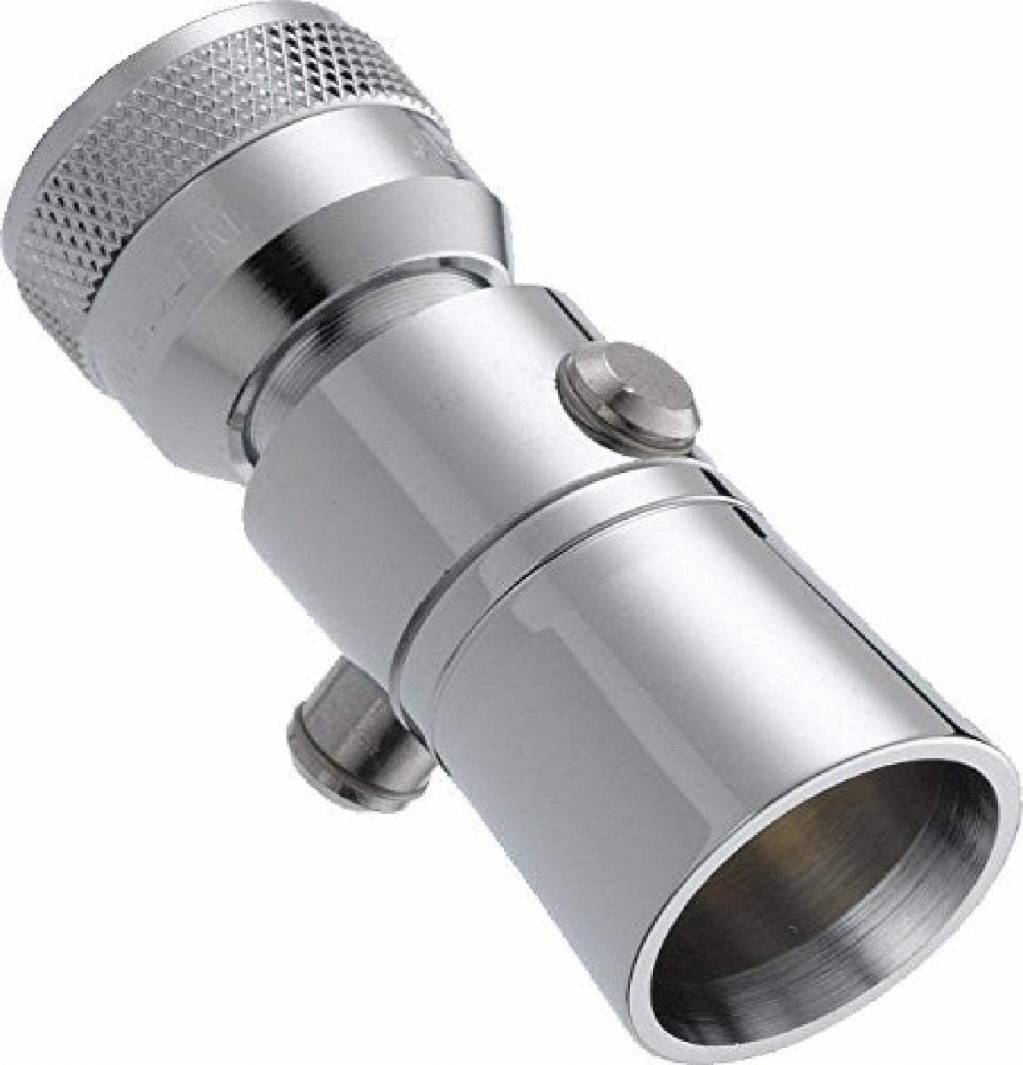

Now buy one of these shower heads (I suppose the version of this without the toggle shut off switch would be cheaper). These are the same shower heads we had in the barracks in navy boot camp in 1975. You should be able to buy them at Lowes or Home Depot or maybe even Walmart.
I happened to have two of these laying around in my garage that were both about 20 years old and no longer used.
So now you just take out the rubber part that the ball of this pivoting shower head is sealing against. CRAM this rubber part into where the concave washer used to be. It will take lots of cramming with your finger nails from all sides to get it to stay in there and to see that the same amount of rubber is sticking out evenly all around. Now just put the main bolt down through the rubber all the way to where the tension knob screws onto it and screw on the tension knob. Done!
