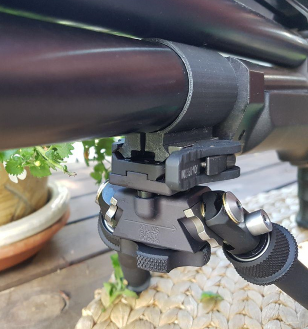

I mounted it to my Wildcat .25 using AGN member Mark_Walt's Picatinny to airtube mount. I found the mount from THIS THREAD.
-I googled at first for good mount candidates from the image search, but found most of them to be inadequate. I ended here to our forum by the mere chance that he sells it here!
-It mounts well, the QD works wonders with it.
-The plastic mount gives a little away when applying weight towards the bipod. I do not feel it would crack any soon though.
-It slides on the tube when tilting the gun, but this could be sorted by tightening the clamp screw. I probably will be spraying a soft layer of rubber compound to the inner side. (*I already did this with an almost empty can, spreading the stuff with my finger. Just a half tea-spoon was enough and it is now holding much better.*)
-If it ever breaks, I will want one done in aluminium.

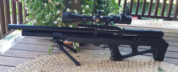

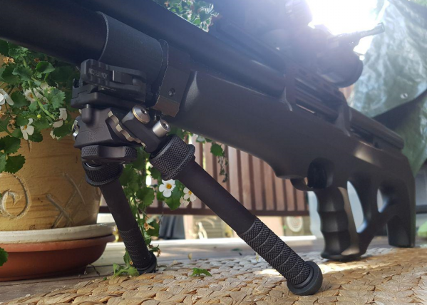

Pictures:
-Yes it is mounted backwards, I was not feeling like I had much patience at that moment..
-Yes the mount for Harris bipod is still attached. Taking it off soon, after measuring the height difference. The results are out in the post of mine below.
I AM SORRY FOR THE FLOWERS, I edited off as much as I could.
