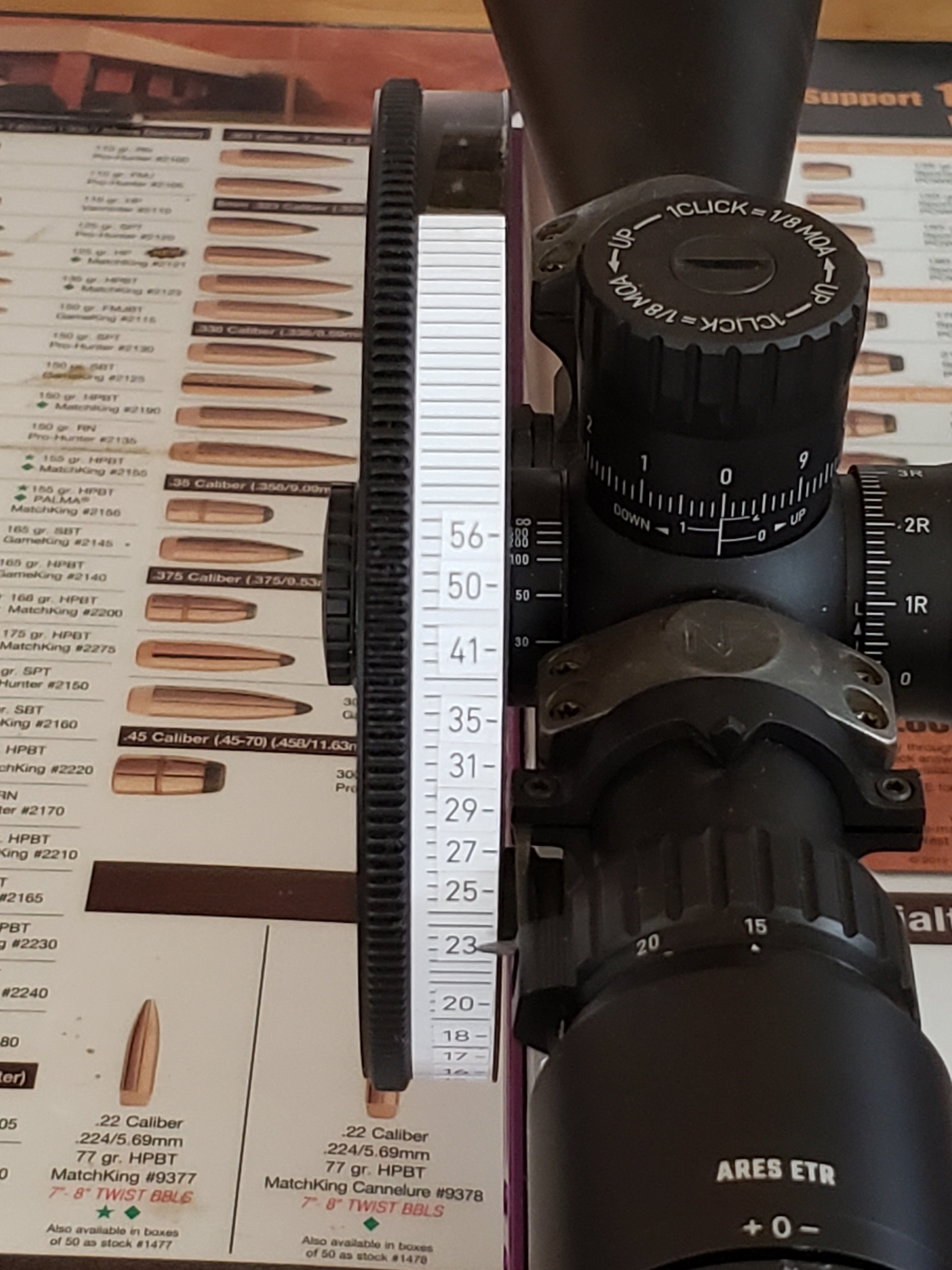

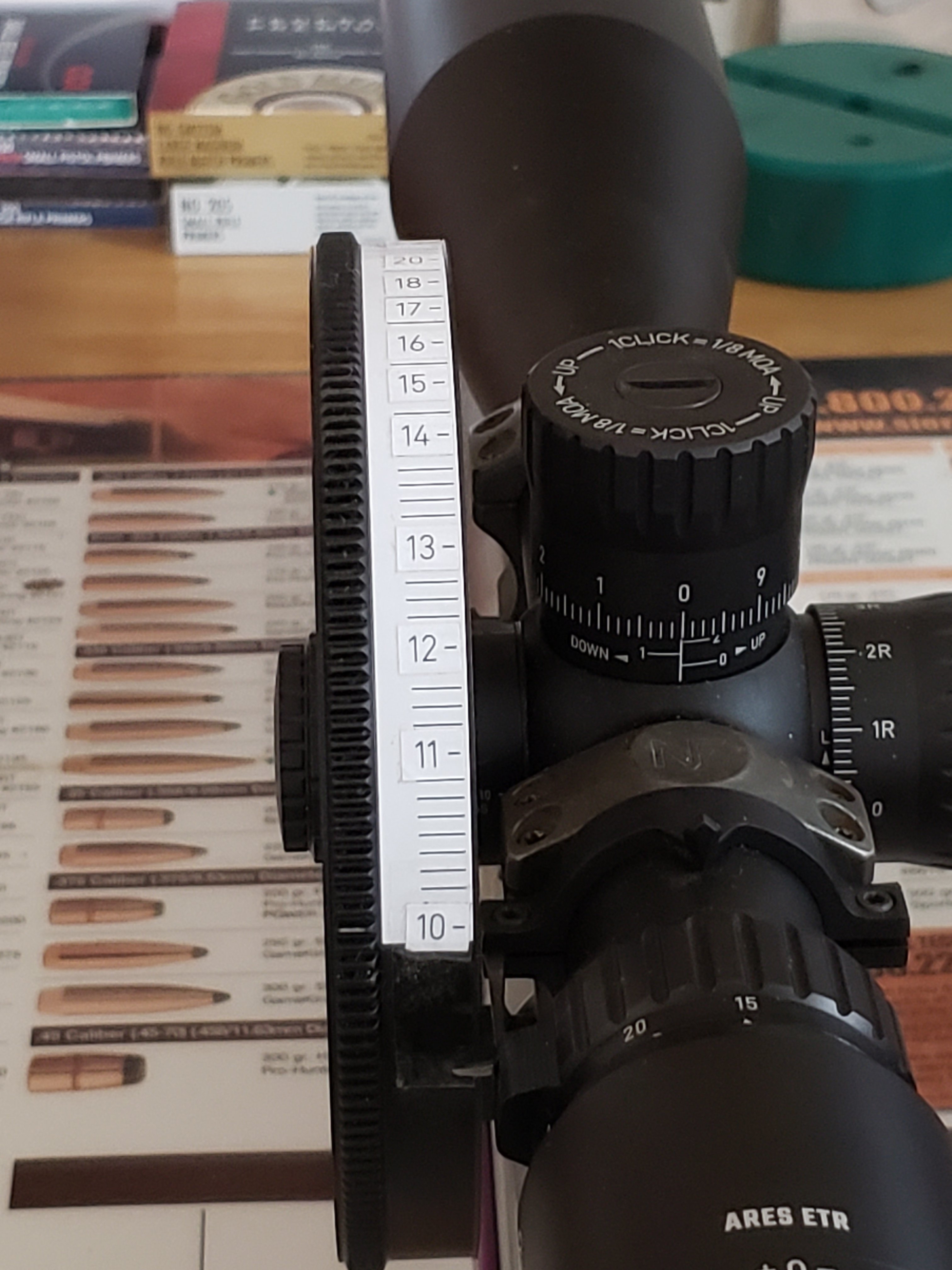

Good write-up. My key questions in the search for a great hunter division FT scope are:
- Does it focus to 10 yards?
- How many degrees of focus knob rotation between 40 and 55 yards ranging? How many degrees between 10 and 55 yards ranging?
- How finely can it differentiate yardages between 40 and 55 yards, e.g., can it repeatedly determine 52 vs 55 yards?
- How much does the rangefinding change as scope temperature changes?
I forgot so tomorrow I'll check how much rotation there is between 40 and 55Y.
Reactions: RScott
I should have mentioned that because FT hunter division limits setting scope magnification to 16x, it is best to use 16x when checking 10 yard focus and the ability to distinguish yardages in the 50-55 range. Thanks for all your data collection and reporting.
Looks close to 17 degrees from 40Y to 55Y. Or getting approx .3" from the 40Y mark to the 50Y mark on the Fly wheel.
It also seems the same distances between my marks when using 15x or at least are very close. I haven't started using 15x much yet for ranging because I'm still trying ranging at 60x.
Sure is a nice clear scope though! I like it a lot.
Got the dope down perfectly now as confirmed from 10Y in 1 yard increments to 25Y and in 5Y increments from there to 55y.

I don't think a scope exists that'll range every half a foot from 50-55, at any magnification or for any price.
And if someone is aware of such a beast, please share with us.
Ive personally spent time looking through the gold standard of price/performance in field target (Sightron SIII) and it wouldn't determine 1/2foot increments from 50 to 55. At least not with my eyes. And I own a Falcon X50, another in the $800-1200 range. It's exceptional, but 50, 52.5, and 55 are about the best it can do, again, with my eyes, and that's only at full 50x. Full understanding that there are Marches and Kahles 4-5x more $$$.....but even then, I've looked through a Kahles and it couldn't do the 1/2foot increments from 50-55.
And I think Steve was talking ranging capabilities at 15x here.

A scope with 56mm objective lens and 60x magnification AND over 1000 dolalr price tag should range every half a foot at 50-55 yards. Rather disappointing, I was hoping to see a more price friendly FT scope and this doesn’t look like it.
I'll go edit my post above, #49, because I was using 15x at the time.
Yes at 60x it is ranges between 50y and 55y very very well.
That being said I don't have any other scopes of 50x or higher magnification to compare it to.

I'll go edit my post above, #49, because I was using 15x at the time. Yes at 60x it is ranges between 50y and 55y very very well.
Ah good to know. Accurate ranging between 50-55 yes with 16x is definitely demanding and very few scopes out there can do that well.
