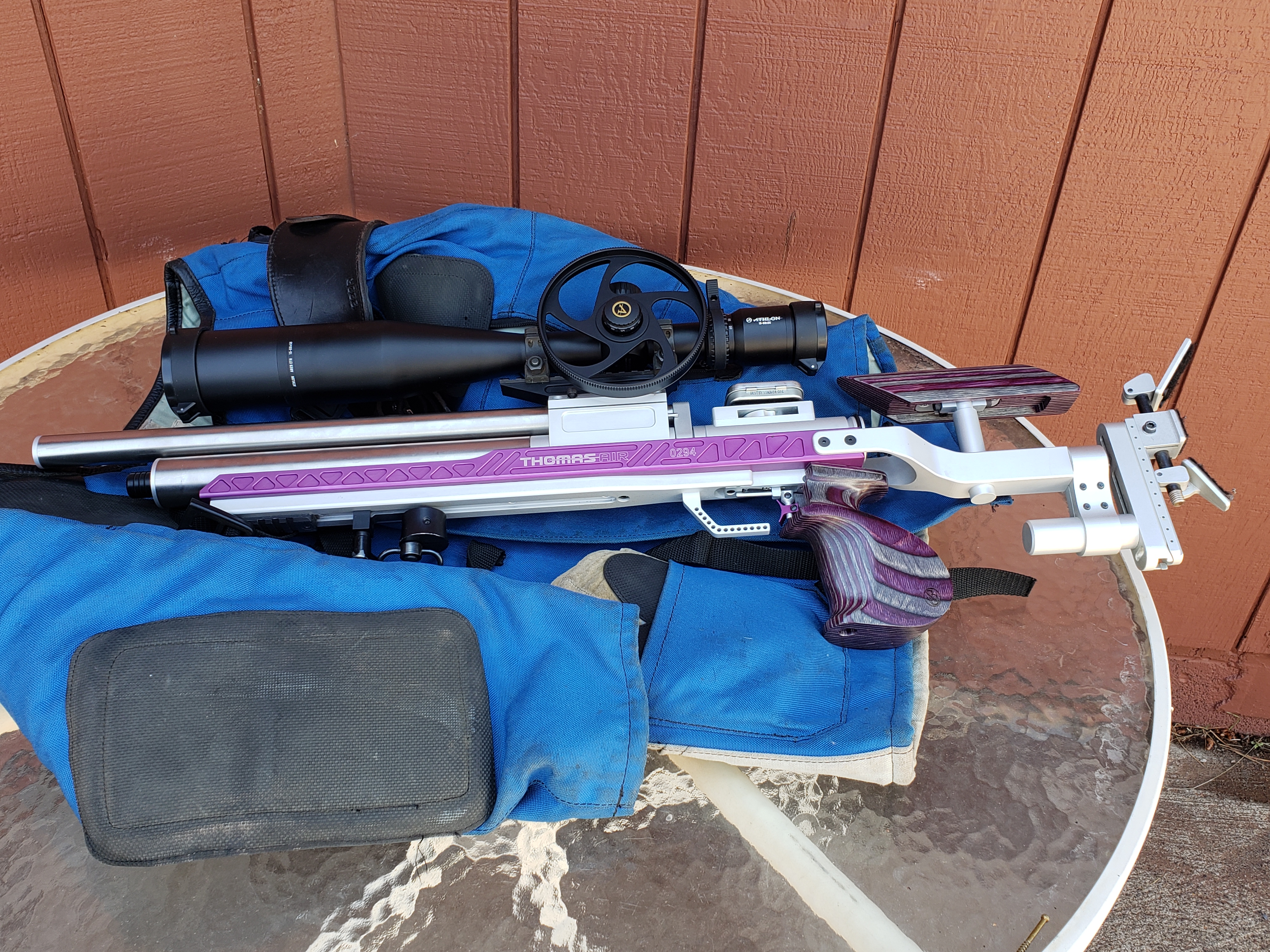

A quick photo.

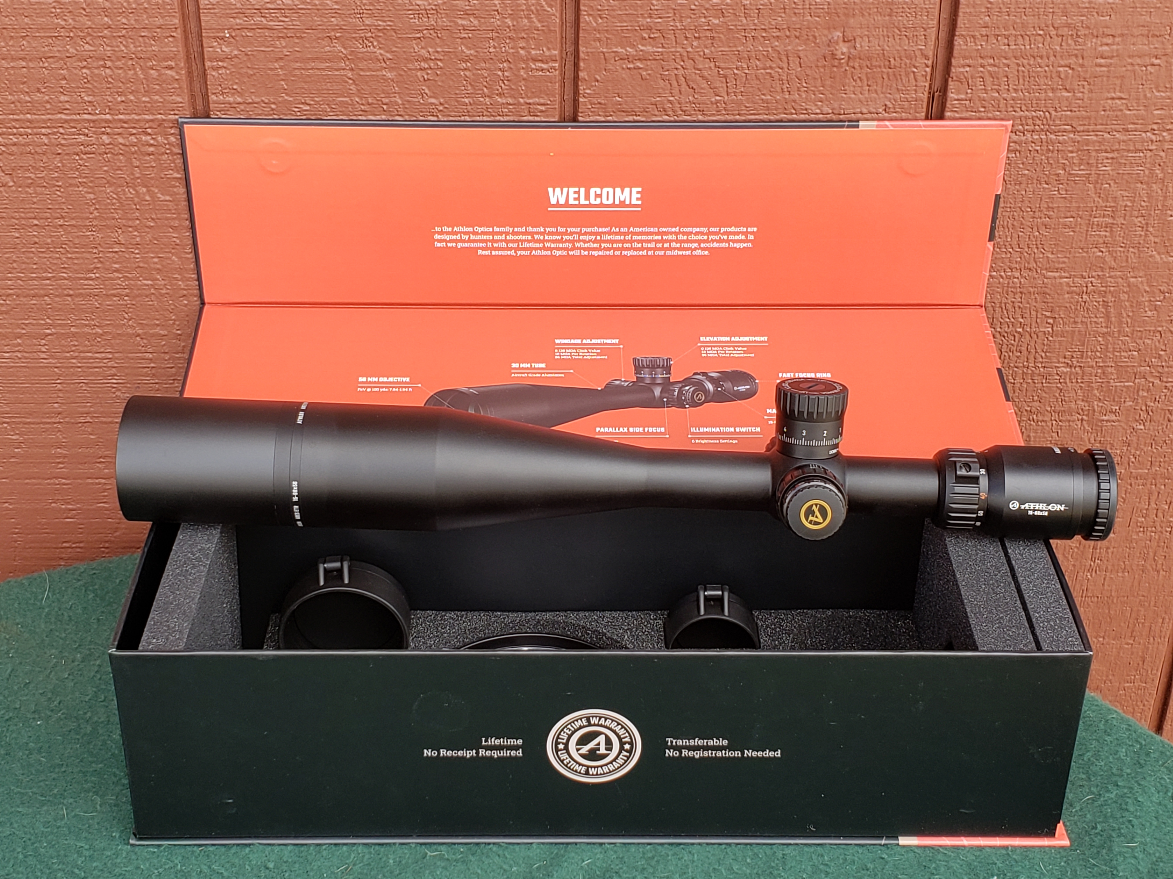

So, which model is that - the Ares ETR BTR? I can't quite make out the text on the objective.
I ordered one of each, arriving Wednesday. I am going to compare the Aries to the Sightron 10-50x60 SV and the Heras SPR to the Ares BTR to see if the HD version is worth the extra $$.
It's the ETR.

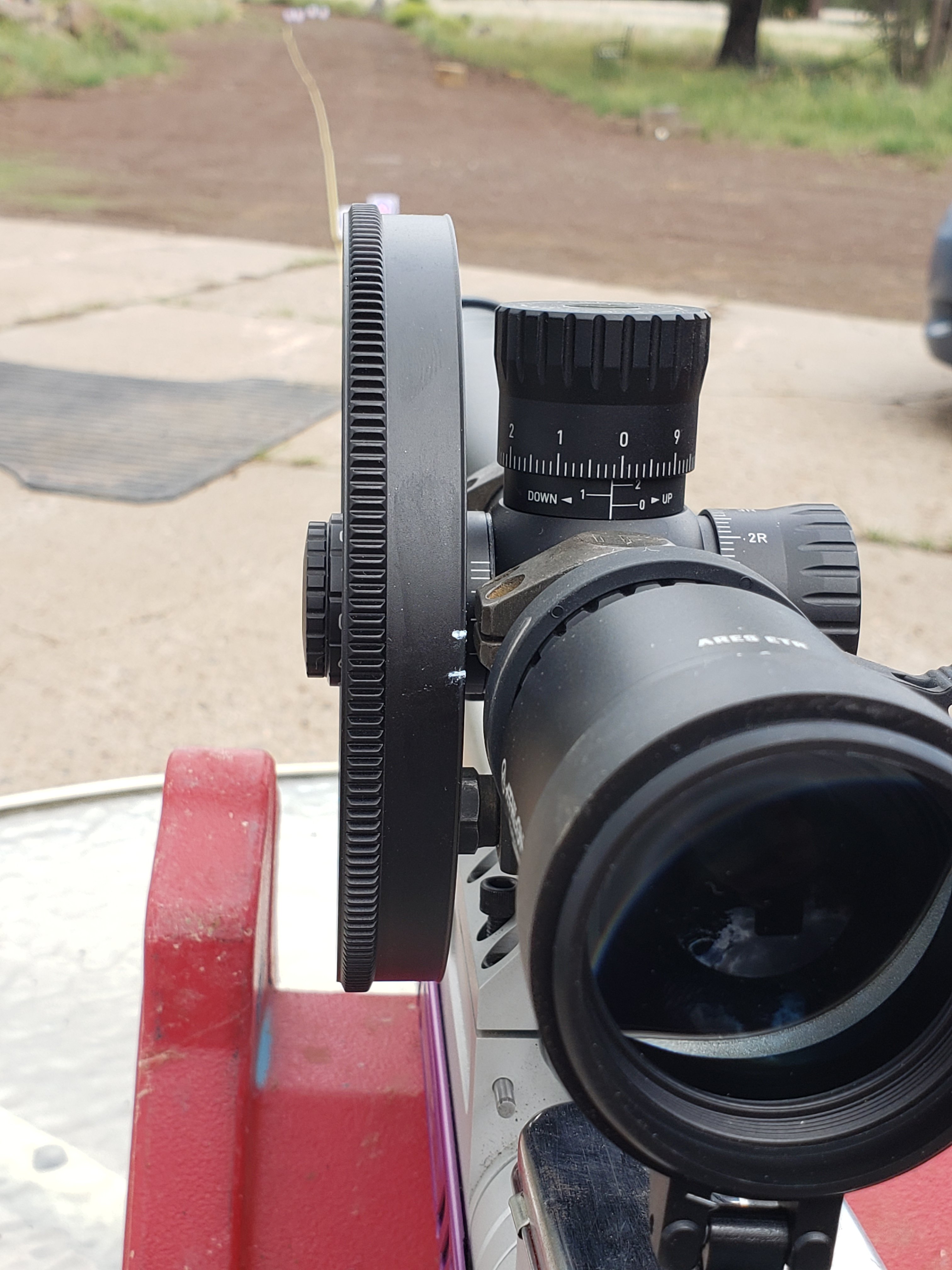

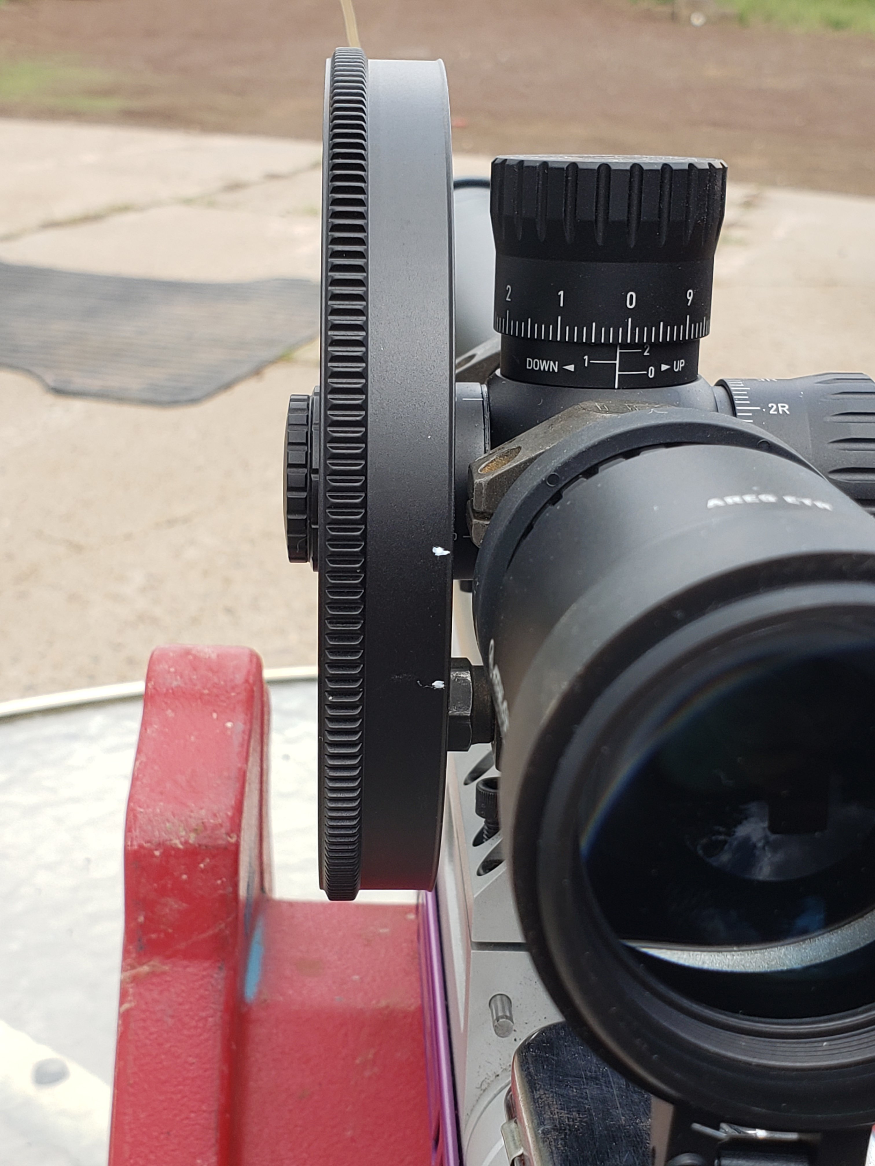

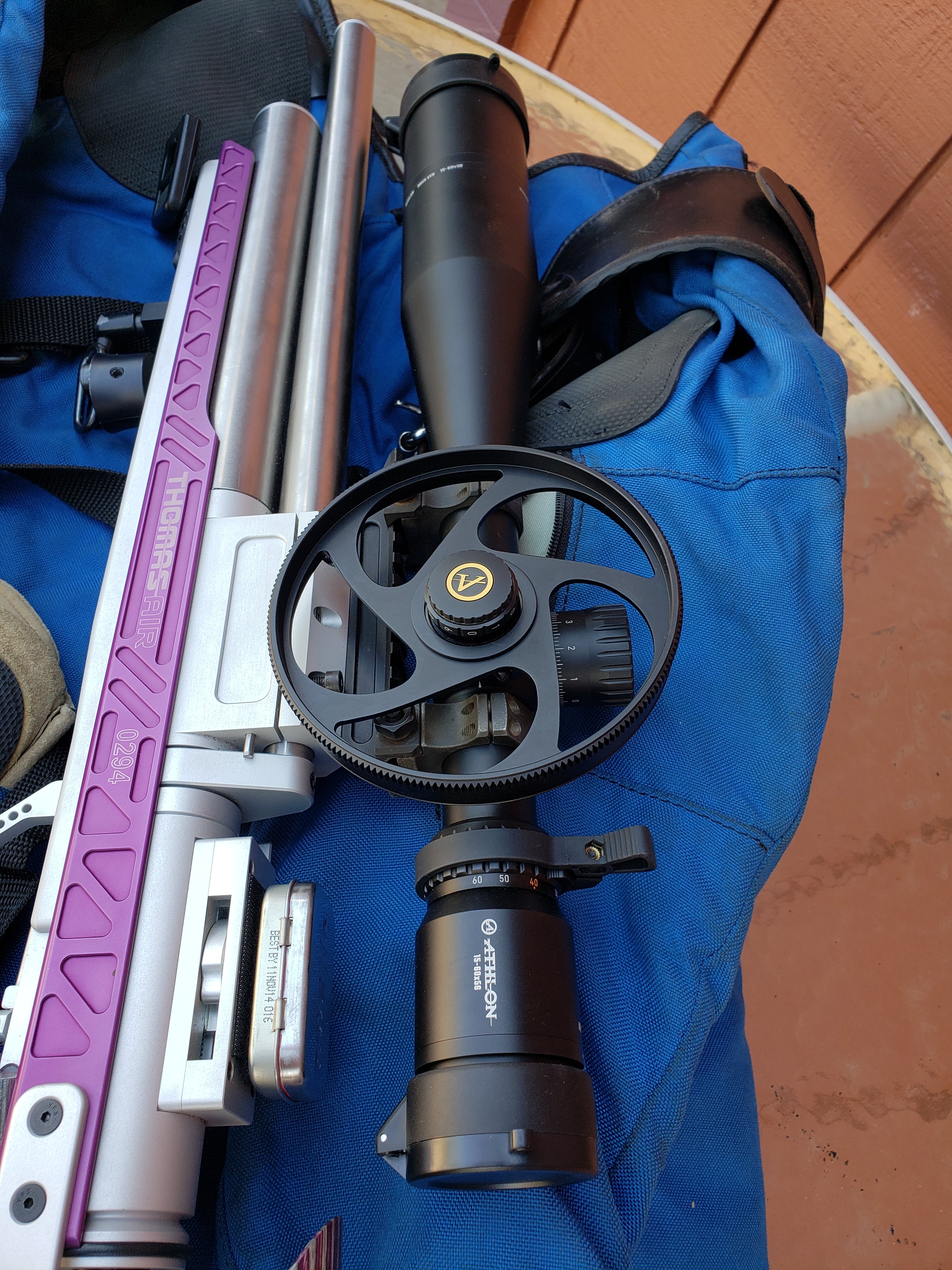

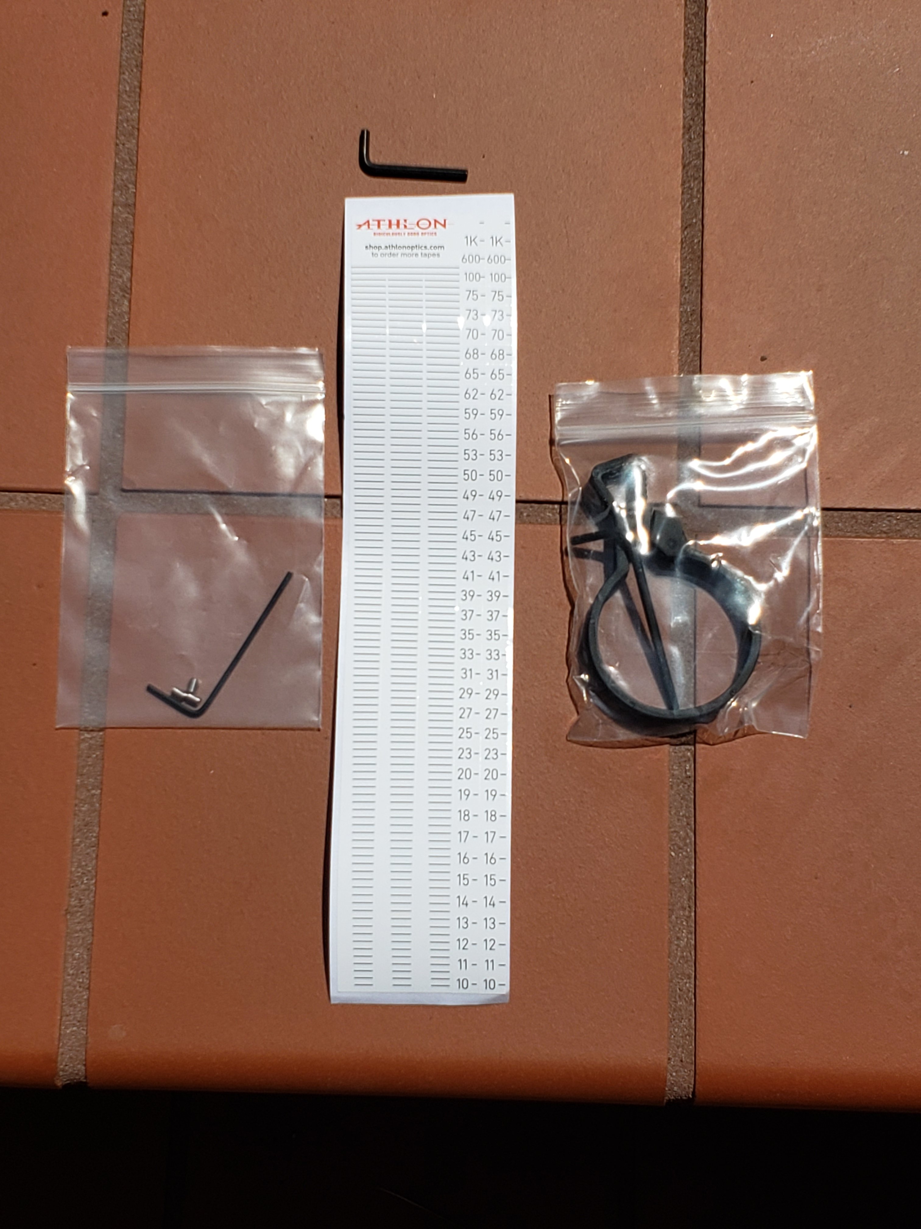

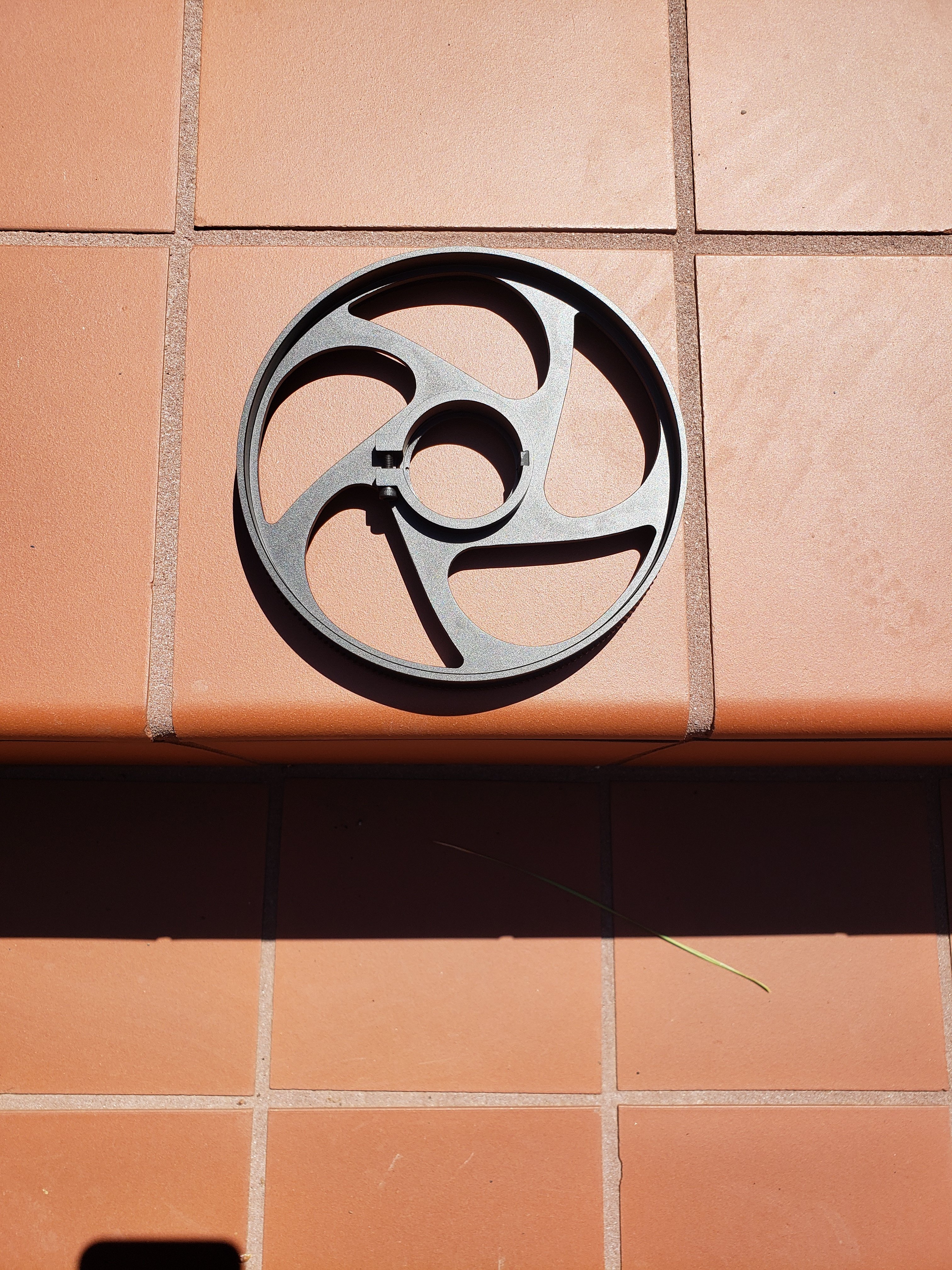

When I went to attach the large side wheel on the scope I found that there is a female recess in it that corresponds to a male protrusion on the focus knob on the scope. It was thoughtful of Athlon to include the short hex wrench which helps a lot because it fits in the slots of the side wheel to tighten the collar of the side wheel around the side focus knob of the scope. Tightened up there is no slop, lash, or anything but a well done interface and great feeling "action" which I feel is the perfect amount of rotational tension!
Caps fit and work well.
The throw lever works fine although the lever on it does start to intrude of the view of where the range markings on the side wheel will be at lower magnifications. Once I start working on ranging distances I'll know more and can comment on it.
The throw lever is made of polymer but seems sturdy enough.
Its worth mentioning that the hex screw does screw into a metal nut which appears encapsulated?? in the polymer which I feel a lot better about vs the screw just fastening into only polymer.
The sunshade threads fit the threads in the scope well. I could feel the quality compared to other scopes from other companies in the past when I felt like the threads interface was loose and wanted to start stripping and or felt like there was gritty sand in the threads.
Right now I'm thinking to myself - why bother talking about any of the controls on this scope?! There's nothing negative to mention. It's the opposite because everything about this scope is fantastic feeling!
I suppose I'll give some applause to the turrets which are simply wonderful. Everything lines up perfect, the feel is great, the ZS is a hard stop, what's not to love?! Those that have had ETR's know what I mean.
AND I like the super simple zero stop system in these Athlon scopes.

The 5.170" Fly wheel/range wheel has around 185 degrees of total rotation.
The distance between the wider white marks from 10 to 11Y is .730".
From 50Y to 55Y the distance between those two white lines is .25"

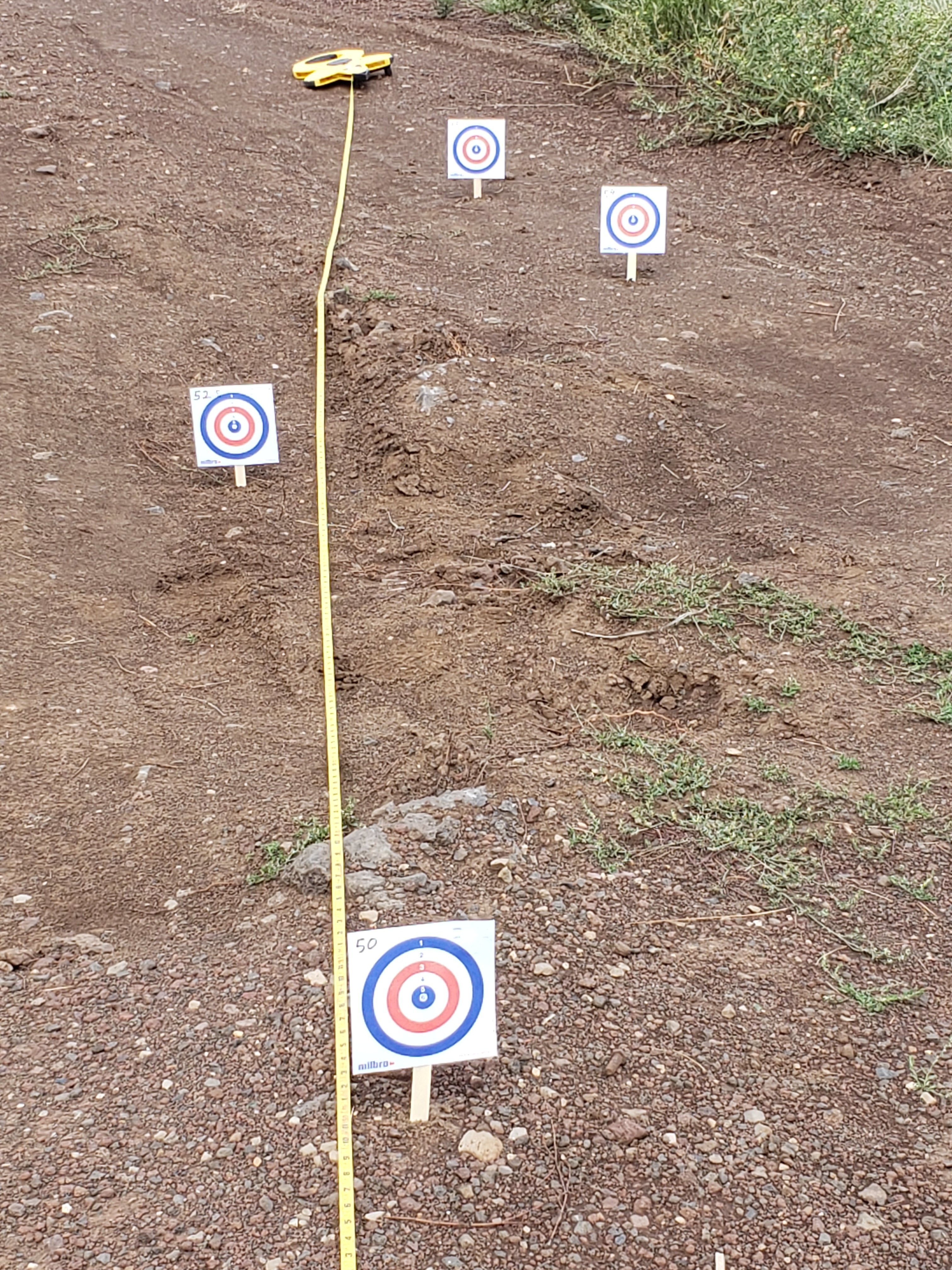

I used 60x to do my ranging today and I put the targets at 50Y, 52.5Y, 54Y, and 55Y.
I could tell the difference from 54Y and 55Y, not much but some.
50Y and 55Y was very obviously out of focus from each other
From 52.5Y to either 50Y or 55Y I could see the difference in focus splitting the difference on the marks.
