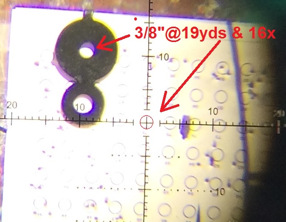

I think the Midas TAC would be a good Hunter Division scope. But I also think the Helos is a good Hunter Division scope. The Helos reticle is just the right thickness relative to the KZ. The Midas is probably the same. I just don't understand when people say that a reticle is too course/thick for field target. I have never found that to be the case (especially in Hunter Division). Here is a picture through an Athlon Helos at 16x. Phone camera was hand held so not steady or well centered:
That is the worst case scenario (3/8" at 19yds). The 3/8" kz spans about 2moa at 19yds. The cross-hair does not obscure any significant portion of the kz. A finer reticle will not help me position the cross-hair any more precisely. So I don't think that a finer reticle would help at all.
