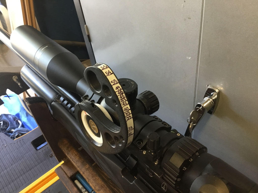

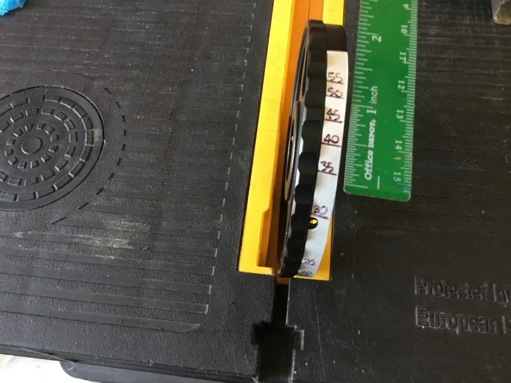

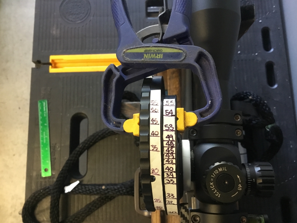

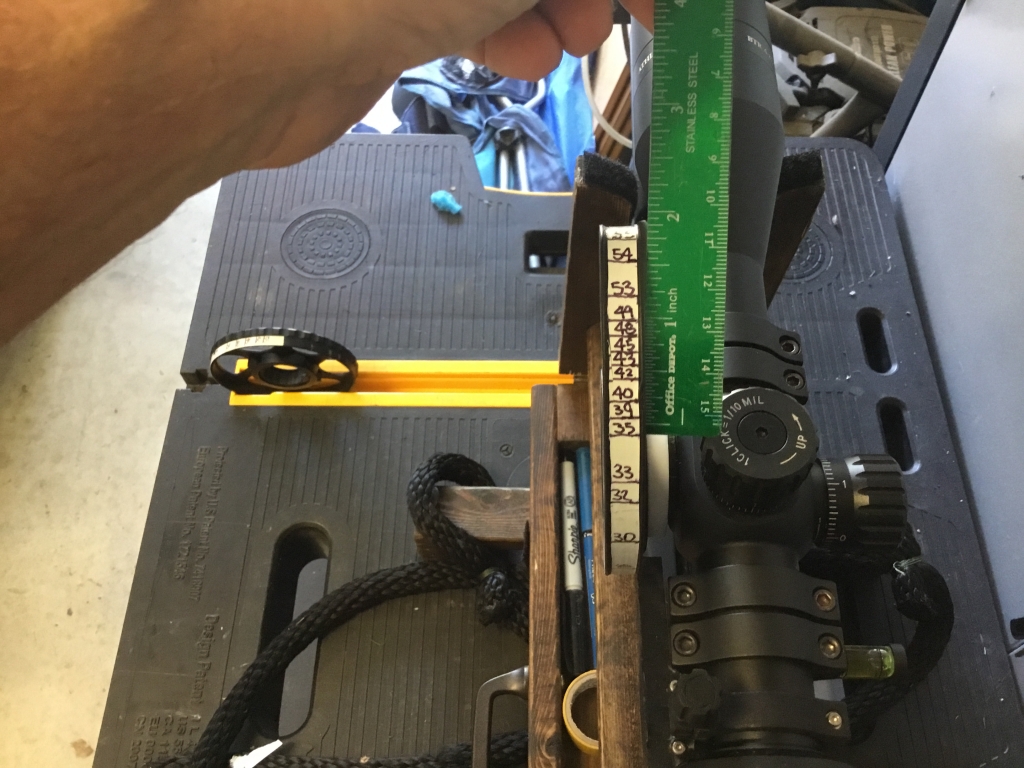

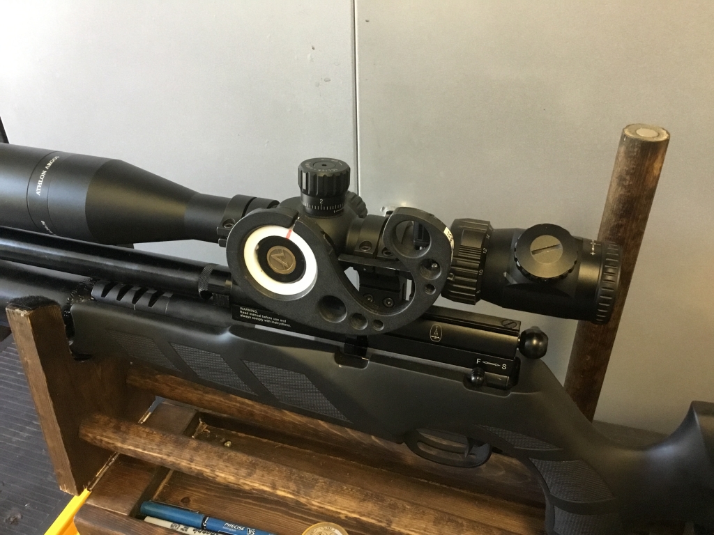

I have been using the Argos 6-24 FFP mounted on my BSA R10 FT gun for almost a year now. I have included pictures of a UTG scope wheel with distance marking, a Maestro GAPacity comma wheel https://www.maestro-design.co.uk/product/gapacity-sidewheel-2/ and a side by side comparison of the two tapes.

Question: is a 4” wheel adequate?
Answer: yes but a larger wheel will give you more incremental ranges.

hope this helps in some way. I’m sure Centercut will be a greater wealth of information on the scope and it’s capabilities. I’ll be testing out the Maestro coma this coming weekend in Grandbury Texas at the Republican of Texas GP and hopeful it will help sharpen my skills. Hope to see you in Baton Rouge
