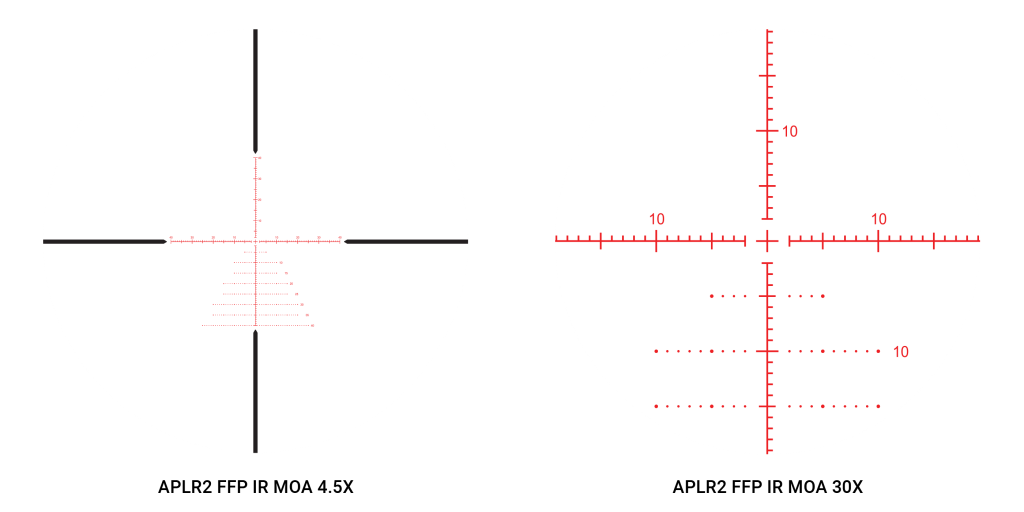

What aspects of the reticle are you not liking?
#1 The APLR2, APLR3, APLR4, APLR5 reticles all have the horizontal MOA marks and numbers running out to 40. I liked that. The newer APLR6 only goes out to 30. That’s my main complaint.
My thinking is that if I have to aim that far out for wind I'd be dialing the solution for it. Normally I wouldn't go shooting in those conditions because it's very unpleasant by that point.
You are making an incorrect assumption that I think I need the greater numbers for wind hold off.
That is not the case.
The same reasoning applied to the moa marks in the reticle on the horizontal. It's easy to see where 5, 10, 15, etc, of moa holdoff is in the reticle but without those marks the reticle appears cleaner.
But I certainly understand a persons preferences and that we all see this differently! Thanks for the input. If the APRL6 doesn't sell well this year Athlon will likely cancel it. That's the way it goes, aye.
In the APLR6 I like how the 1 moa marks get slightly larger within 5 moa then repeats that pattern which helps at a glance to see whether you are at, say 2 vs 3 moa. It gives a more district visual.
As well as the numbers crossing over from one side to the other side of the tree making odd or even number holds quickly discernable. Many times I've heldover using the wrong line with them being on the same side of the tree which has been extremely annoying to me!
My bud likes the APLR4 moa the best but I only use mil so my preference is the APRS6.

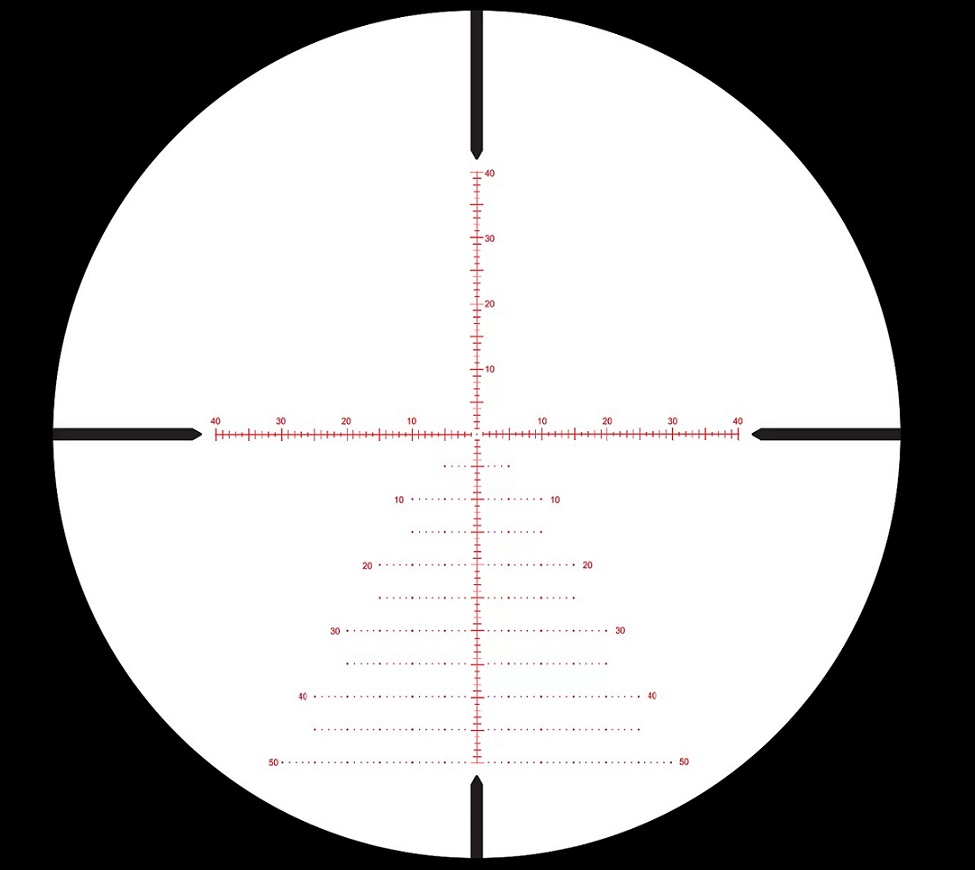

So we are clear, I'm not talking about wind holdoff.
For target size vs target distance situations, the +/- 40 MOA reticles gives you a 33% broader limit than the +/- 30 MOA reticle.
1) Imagine a smaller target sitting on a vehicle at 300-400yds but you need to estimate the distance precisely in order to make the shot (and you know that the vehicle wheelbase is 130").
2) Imagine a Gamo field target at 10 or 11 yards and you want to verify the distance to hit the 3/8" KZ (and you know that the faceplate is 7.2" wide or you see it sitting on a 7.625" wide cinder block).
3) Imagine paper targets on 36" wide moveable backstops and you want to see if the distances measure exactly of 40, 60, 77, and 100 meters for sight in verification.
The +/- 30 MOA comes up somewhat lacking in those three examples, but the +/- 40 MOA is just right. In my normal use, instances 2) and 3) come up often enough that I would miss the +/- 40 MOA reticle.
I say that the extra 10 MOA per side can be useful and save time while using the range finding reticle, so why eliminate those extra marks?
"...The same reasoning applied to the moa marks in the reticle on the horizontal. It's easy to see where 5, 10, 15, etc, of moa holdoff is in the reticle but without those marks the reticle appears cleaner...."
Cleaner? - I don't care about that. If someone wants a clean reticle, a simple dot, crosshair or duplex reticle is cleanest. I prefer numbers that are easy to read with speed and precision. The extra numbers can facilitate that. I missed a shot today because the scope (not an Athlon) I was using had no numbers and I mixed up the 5 moa holdover stadia with the 7 moa. That would not happen if there were numbers on at least the 10 MOA line. I was OK with the numbers on one side (APLR2). Not so sure yet about some on the left and some on the right as on the APLR6. Time will tell. I think I'd prefer that they were on both sides, rather than alternating sides.
"...But I certainly understand a persons preferences and that we all see this differently! Thanks for the input. If the APRL6 doesn't sell well this year Athlon will likely cancel it. That's the way it goes, aye...."
The gen2 Helos is so much better than the gen1 Helos, that it will probably sell better even in spite of that MOA reticle. The reticle is not bad, but could be better. Because the gen2 APLR2 Argos has the +/- 40 MOA, I'm still thinking of going with that Argos for any new FT guns. If the Helos gen2 had the +/- 40 MOA, I would probably stick with it for everything. Now it's a tougher choice.
"...In the APLR6 I like how the 1 moa marks get slightly larger within 5 moa then repeats that pattern which helps at a glance to see whether you are at, say 2 vs 3 moa. It gives a more district visual...."
I think I like that new feature.
"...As well as the numbers crossing over from one side to the other side of the tree making odd or even number holds quickly discernible. Many times I've heldover using the wrong line with them being on the same side of the tree which has been extremely annoying to me!..."
I'd prefer to have them on both sides.
"...My bud likes the APLR4 moa the best but I only use mil so my preference is the APRS6...."
I like it too. One reason that I like the Midas Tac 6-24x50, but it appears to be slightly thinner (a little too thin in my opinion), especially at 16x with no reticle illumination. The thing I like about it is the 0.2 MOA center dot instead of the 2.0 MOA center cross.
Ideally, I'd like to see the +/- 40 MOA horizontal stadia marks (as is present on the APLR2, APL3, APLR4, and APLR5). And the thicker reticle (as is present on the APLR2, APLR3, APLR6). The center dot (as is present on the APLR4 & APLR5). And maybe the 1 MOA marks that get slightly wider (as is present on the APLR6). Maybe have an APLR8 reticle combining the best of all of them?
That said, the Athlon APLR? MOA series of reticles is already the best FFP MOA reticles available (in my opinion), but they could be even a little better.

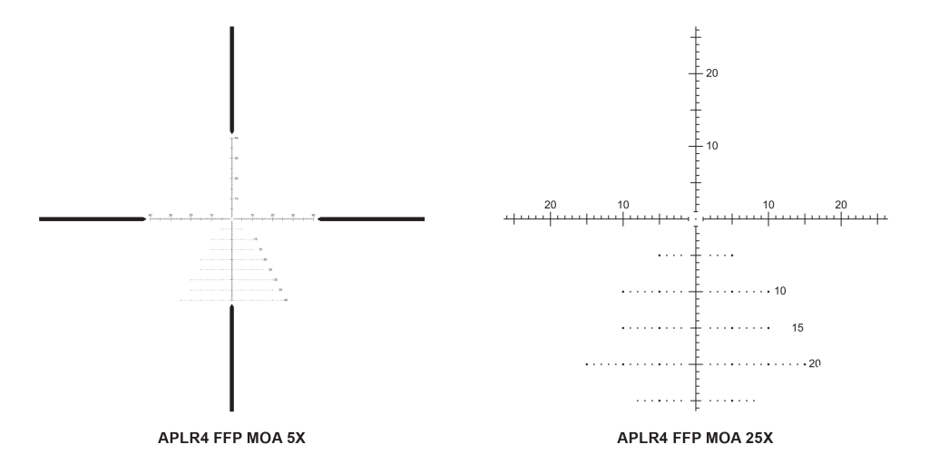

For new FT guns, it's between the Argos APLR2, Helos APLR6, and Midas Tac APLR4.
The Midas Tac has nice/better glass (at least compared to my gen1 Helos), but when comparing at 16x, the gen1 Helos has a lot wider focus ranging area when moving between 45 and 55 yards. I would have to compare the Helos gen1/Argos gen2 focus ranging against the gen2 Helos before making any decisions about using the Helos gen2 in FT. Right now my gen2 Helos is going on my 50-100yd benchrest/EFT gun. Range finding via the scope is not so important on that gun.

Aha! I see that I am preaching to the choir here! :) I recently acquired a new Midas TAC 5-25x56 APLR4 FFP MOA scope out of curiosity and am just blown away by this scope! It retails for $849.99 and I swear it is every bit as good as the ETR's except it does not have an illuminated reticle. But for $250 less than an ETR there are a whole lot of guys that can live without the illumination! I have been using it for the last couple weeks to put it to the test before I review it and I am super impressed with it so far.
https://athlonoptics.com/product/midas-tac-5-25x56-aplr4-ffp-moa/
That Midas Tac looks nice (according to the specs). The Midas Tac 6-24x50 is the only one that I have had my hands on to compare. Unlike the 5-25x56, the smaller one focuses down to 10yds. It also has nice glass and just a little more costly than the Helos. The Helos 6-24x56 has a 34mm tube and a 56mm objective. It's the first Athlon with either of those features that also focuses down to 10yds. That makes it a particularly interesting scope for Hunter Division FT shooters (especially if it focus range finds at least as well as the gen1 Helos).
Yes the Midas TAC 6-24x50 with 30mm tube does focus all the way down to 10 yards and it has the APLR4 reticle so there is a lot to like for a mere $669.99! Here is a link for those that might want to check it out: https://athlonoptics.com/product/midas-tac-6-24x50-aplr4-ffp-moa-scope/
