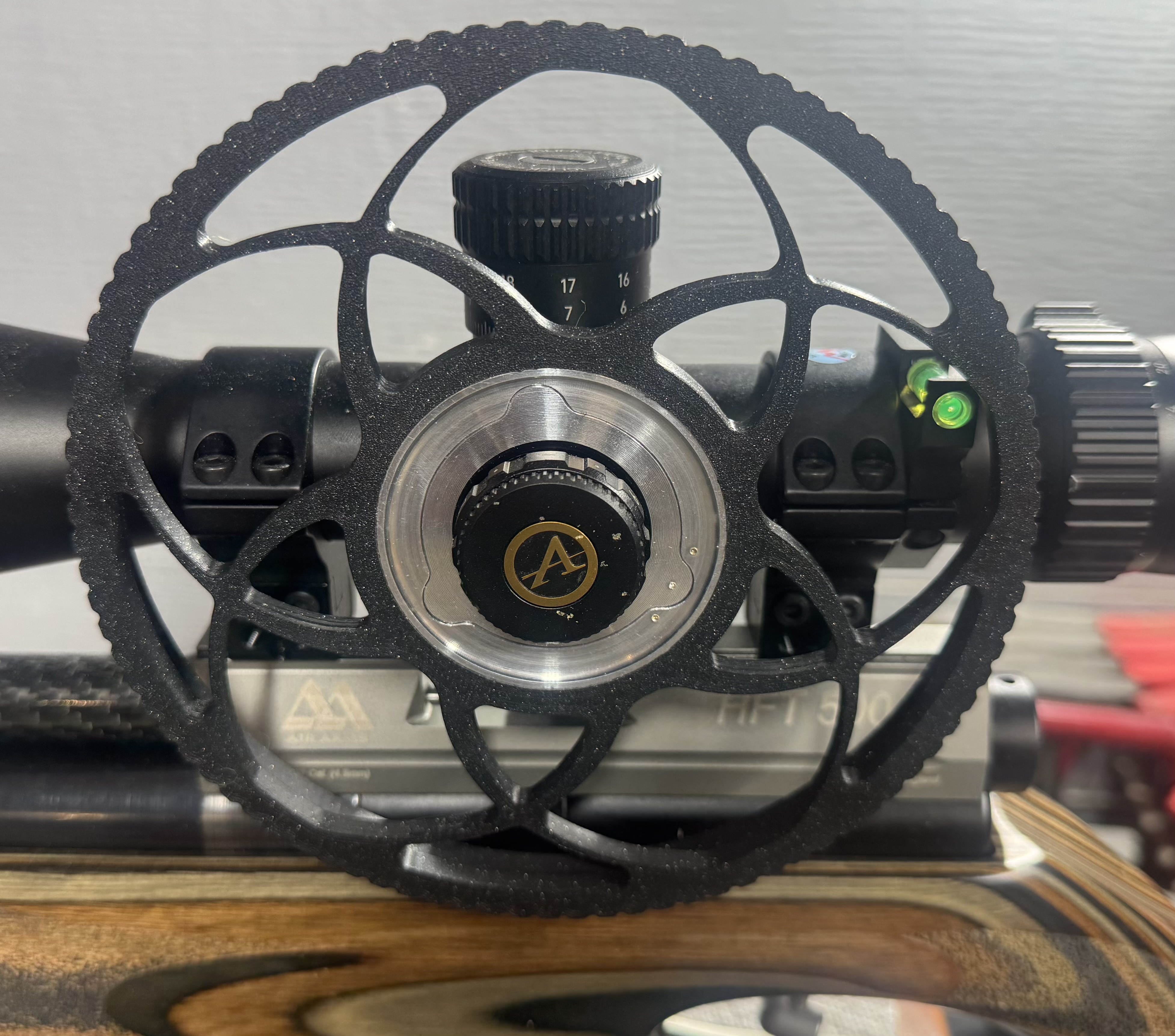

As some have mentioned above the 4-20 and the 6-24x56 are in my opinion very good scopes. Im no scope expert but i use a 4-20 for field target and find it focuses a tiny bit better than a 6-24. I a currently using the 6-24 for high power ft and an ares 4-30 for benchrest. Like all 3
I agree
