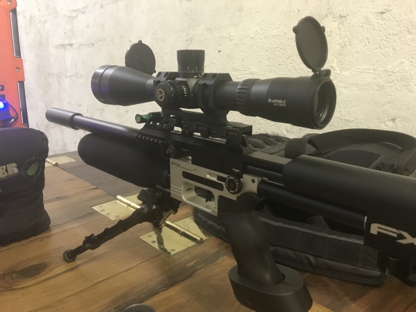

When I got my new Impact X .25 I compared these three scopes and since I was coming from a Hawke Sidewinder on my Streamline I assumed I would like the Sidewinder FFP but the clarity was not good on the one that I got and the reticle was way too thick and busy at high power. It was not a good fit for me to my surprise.
I had heard good things about Athlon so I tried the Helos BTR and the Ares BTR. I thought the Helos might be a better match as I was concerned about the 25 yd Paralax lower limit on the Ares but mine is actually good down to 20-21 yd range and the slightly blurry image at 12-15 isnt that bad. If I am honest with myself I never shoot that close range anyway.
The turrets on my Ares were the newer versions and the glass is great. I love the reticle and the scope was perfect for me. I got a good deal on OP so the Ares is the keeper. I highly recommend the Athlon Ares if you are in the market for a good FFP scope with great glass.
