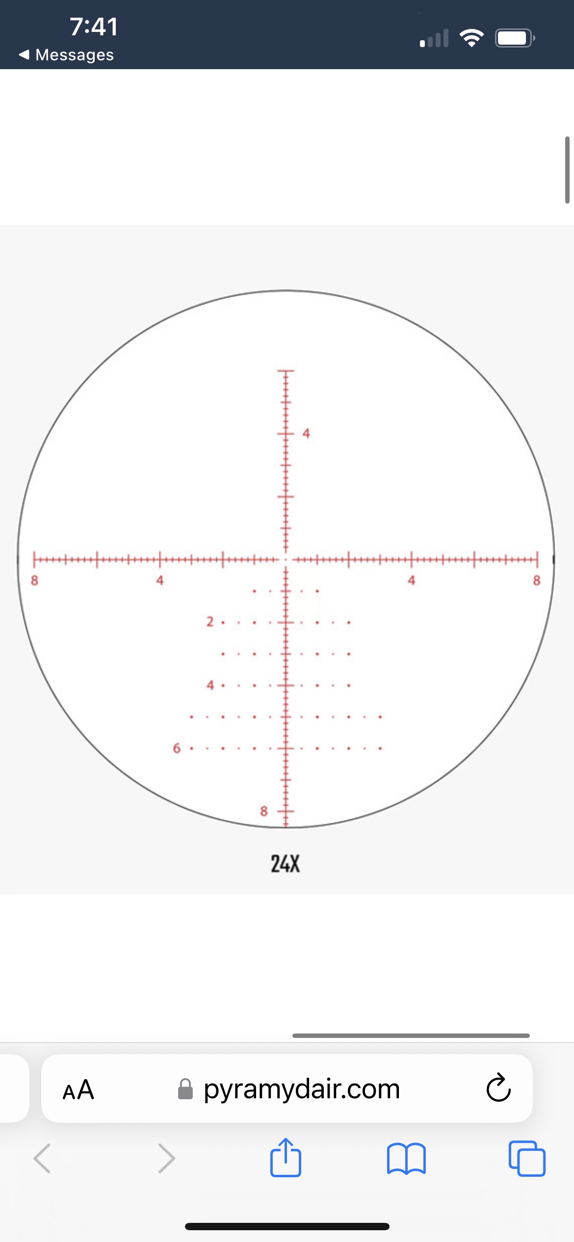

I am interested in the 2.5-12 Heras. Is the reticle easy to see for aging eyes. As an example I don’t think the Midas is easy to see for me. But I am wanting to inquire about the Heras
