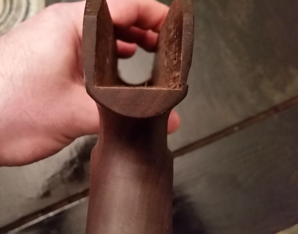

No, the stock is still poorly cut with one side wider than the other. They are all like that. The only way to correct it would be for Ataman to remake the stocks for every one they shipped (after correcting whatever fault caused the issue).
The areas where this one is better than the last are: the quality of the wood, it has less visible wood filler (although there is still some), there are no visible splinters hanging off it and I can't see any chunks of wood bitten out like the last one.
To be honest, a lot of wood stocks on air rifles are poorly cut with uneven thickness from one side to the other. The reason why it's particularly problematic for this gun is that it was already designed with very thin side walls for the stock and 90 degree cuts for the inletting. With the cut being uneven, the right side is paper thin right next to the 90 degree cut which makes it the most delicate stock on earth. You could snap the right side wall off with your little finger and very little effort.
The last one I sent back arrived already cracked at the point of weakness. I think if Ataman wants to start repairing it's rep in America, it should fedex out replacement stocks to everyone who bought the walnut versions before there is too many in circulation to be viable.

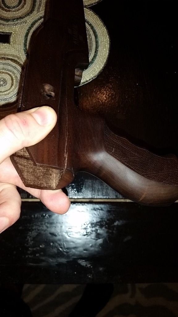

This is a pic of the stock for the last one I sent back:
[color=rgba(0, 0, 0, 0.701961)][/color]
Where the crack is happens to be the part where the wood is noticeably thinner than the other side.
The last pic above shows it with the camera flash so you can see where crack is creeping down the side of the stock. I am lucky that it arrived like that because if it happened at a later date, there is nowhere to buy a replacement stock. You can also see the wood filler on the grip in that last photo. Yuck....
