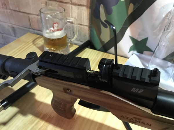

All m2 had that screw
to remove screw u needs first to remove barrel then remove screw on rail next to magazine and exactly under this screw u had screw in transfer port
1541714317_17464480235be4b18d65a664.77440397_E611CFD7-50EF-4B53-893E-B7EB1F38ECC6.jpeg
