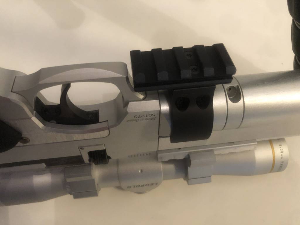

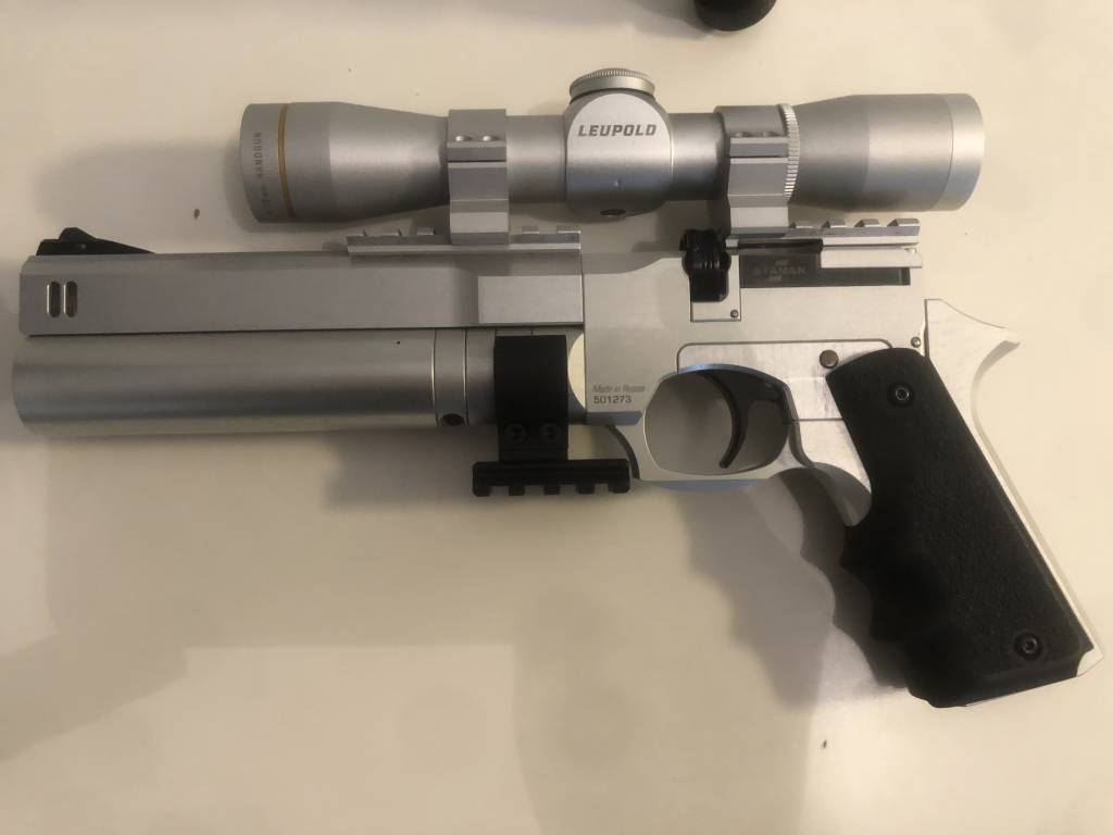

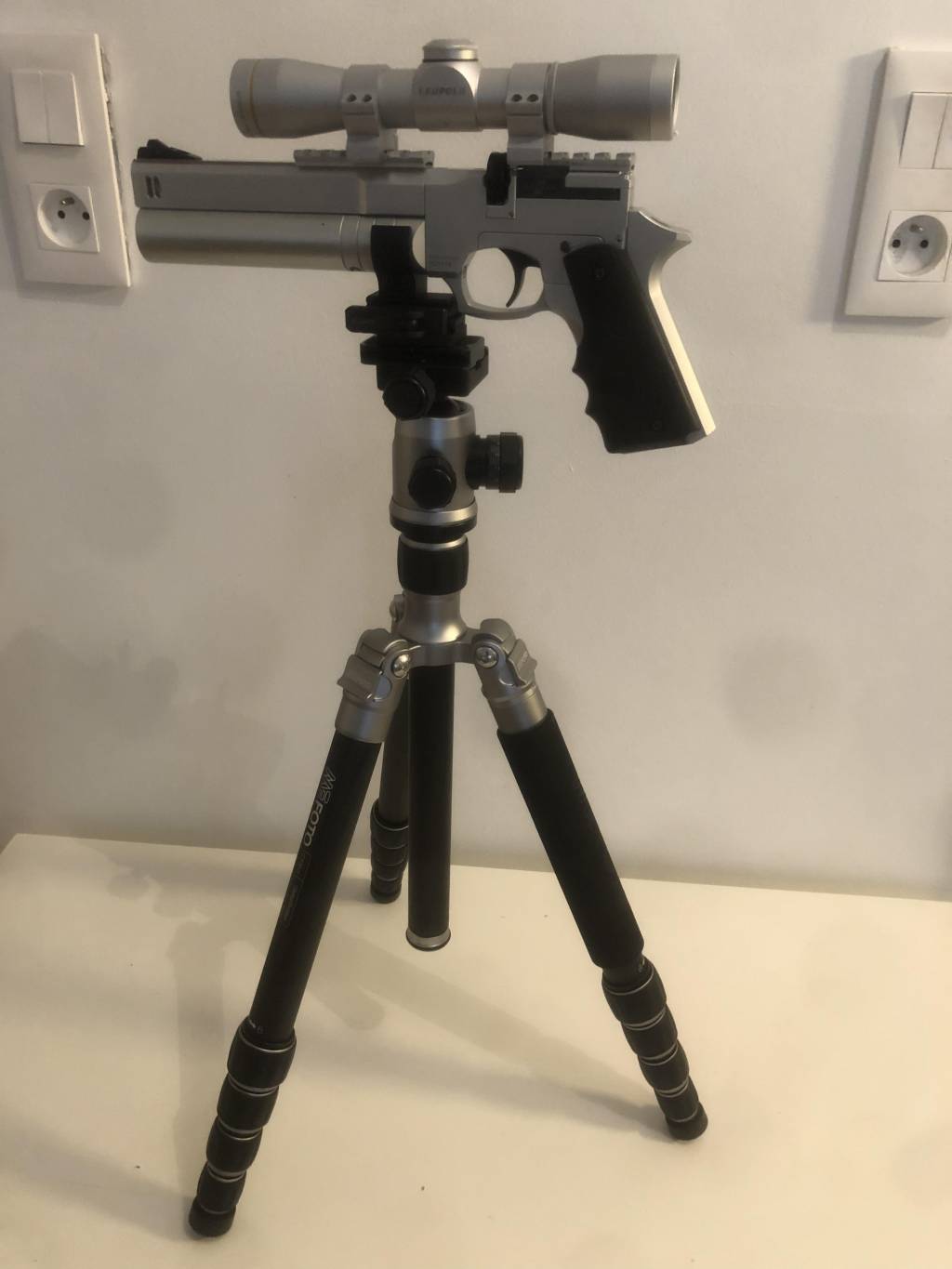

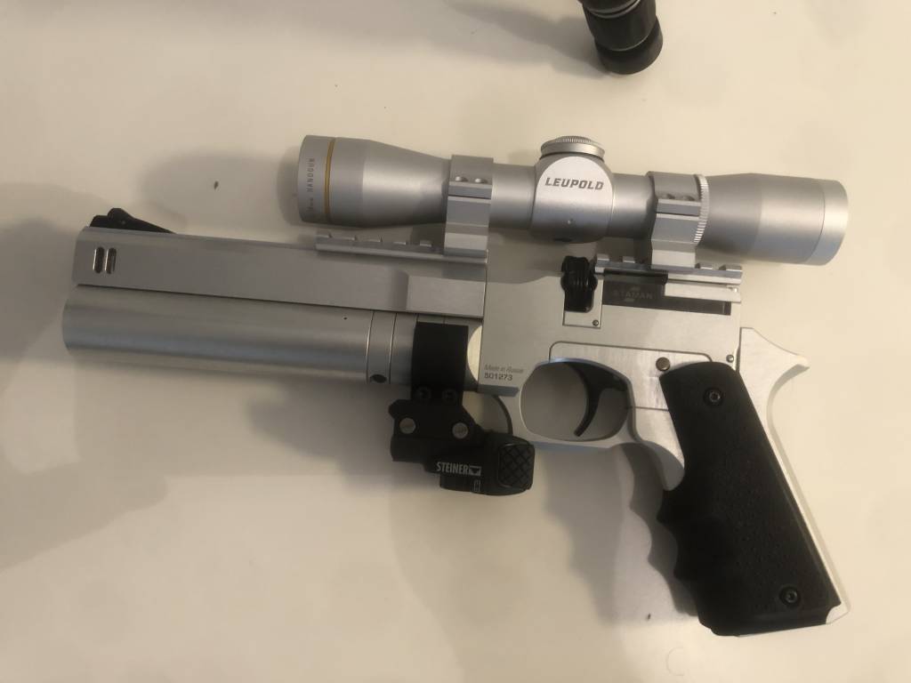

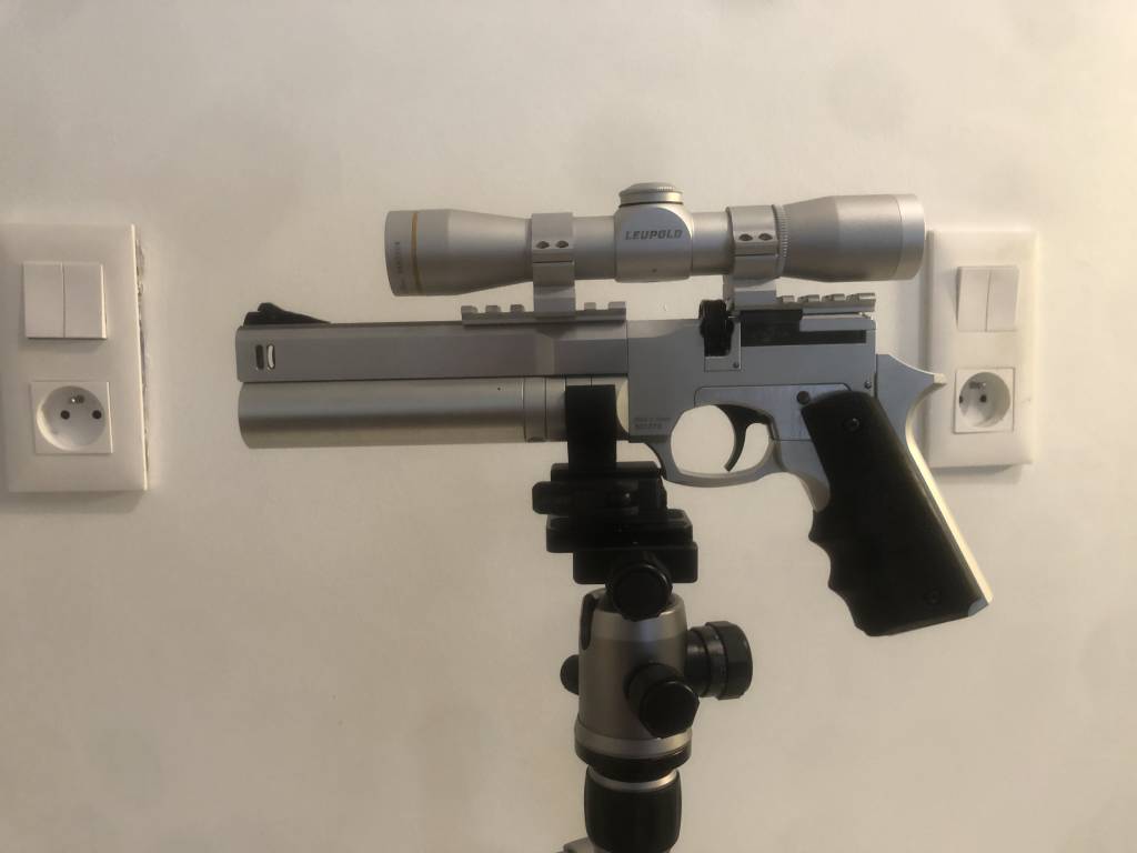

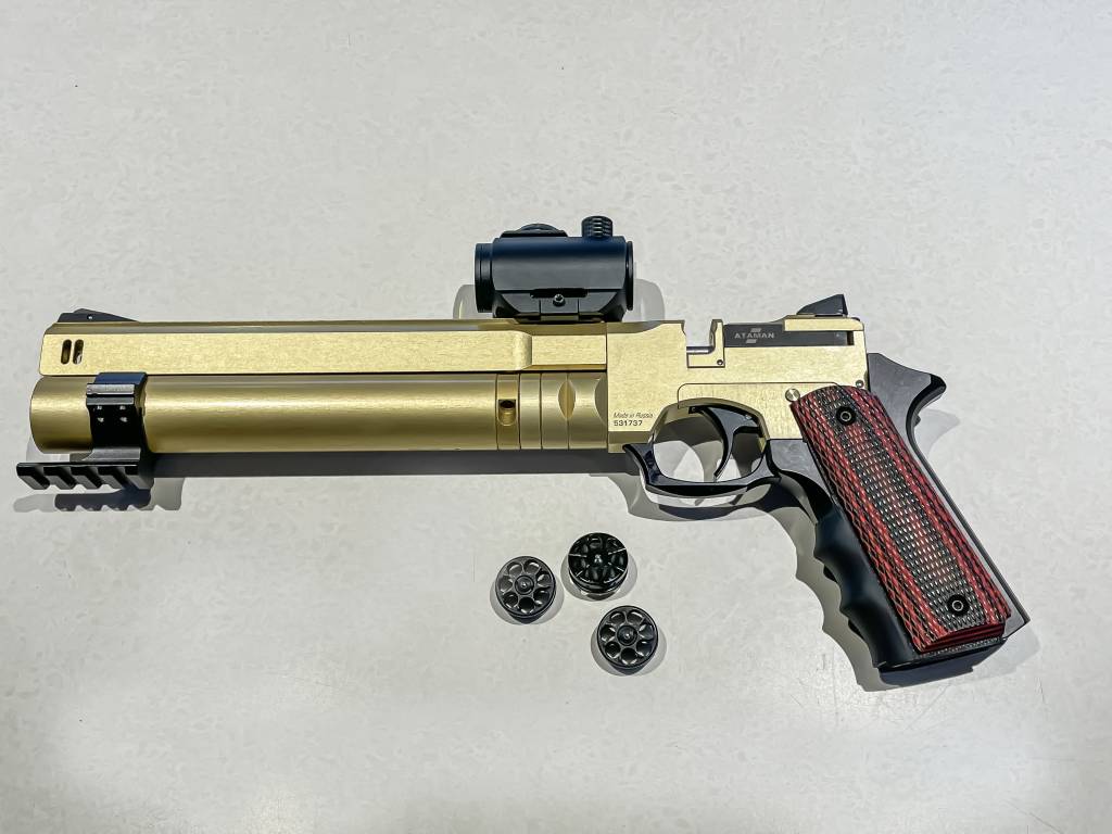

Hi,
I’ve found a picatinny tank mount for my Ataman gun to fix it on a tripod. I was searching for it for a while and try the huggett or the saber but both were too large. This one (innomount) fit perfectly.

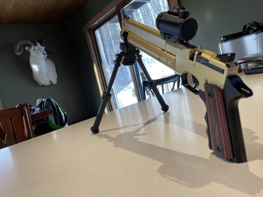

I made something similar out of a 30mm rail ring from Amazon. I cut a section out of the middle of it so you just tighten the two side pieces and it clamps on tight. I put some black aircraft tape on the inside of it so it doesn't mar the air tube in any way and it works pretty slick. I can use it at the front for a bipod, or move it to the rear for a tripod mount. I also have a weapon light I can attach to it for some night pesting.
Here is a link to the one I used
https://www.amazon.com/gp/product/B00GH5G78G/ref=ppx_yo_dt_b_asin_title_o03_s00?ie=UTF8&psc=1
