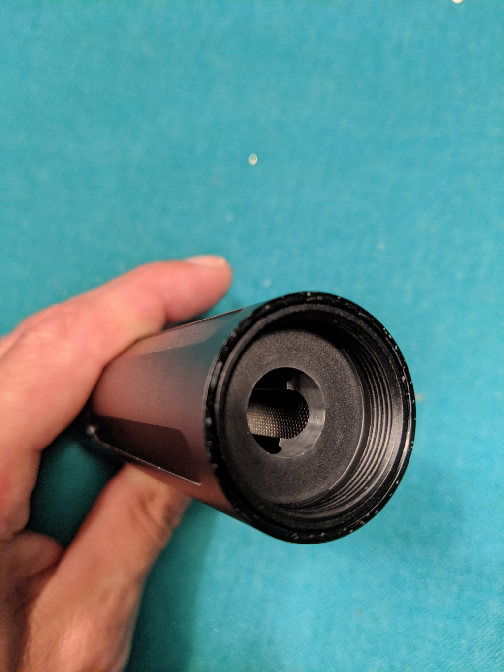

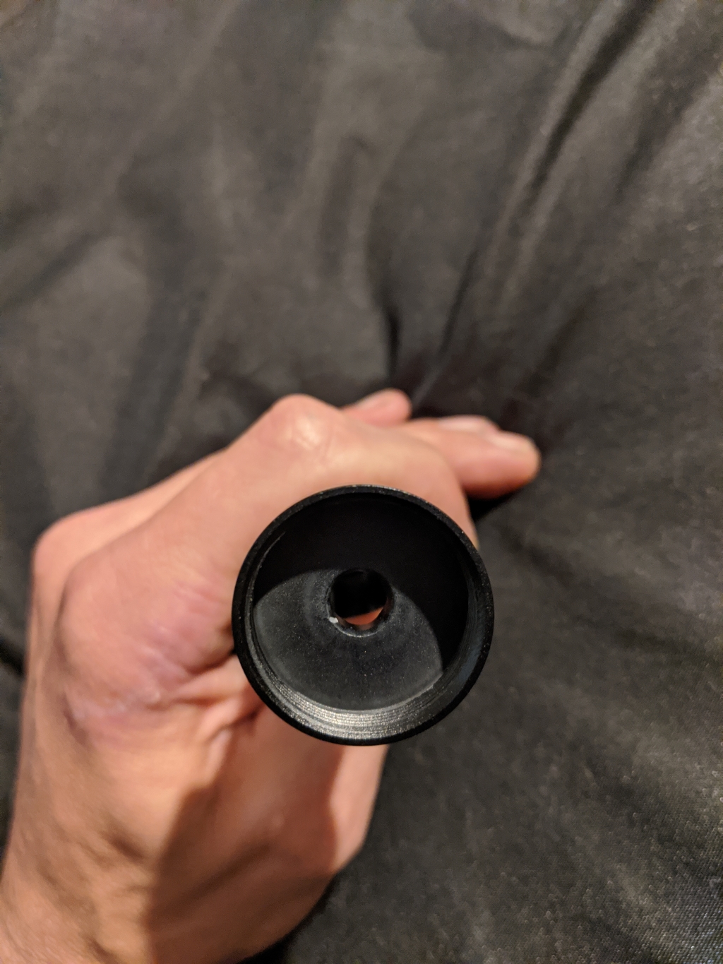

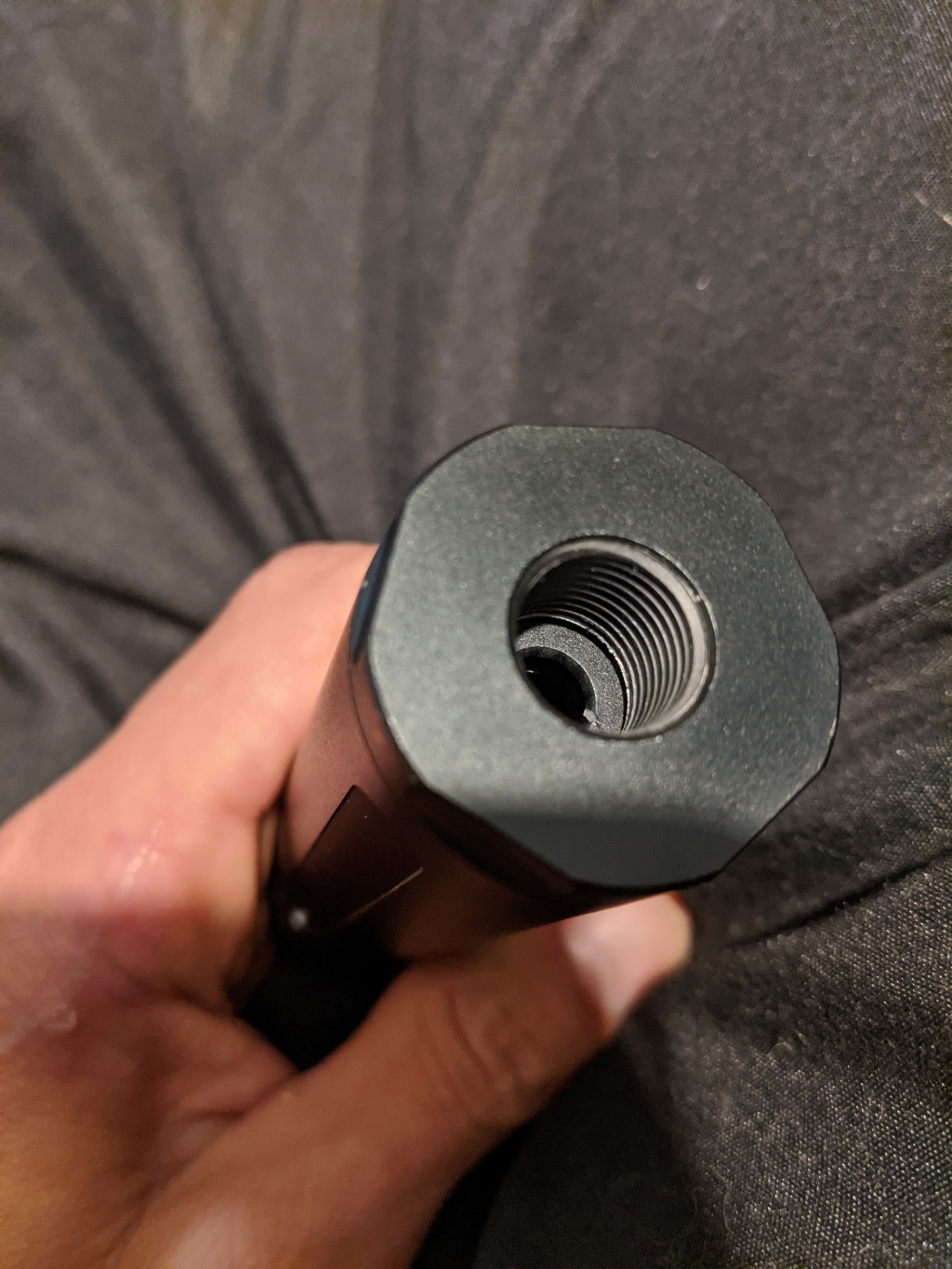

I have a Tanto and had accuracy issues. .22 cal mod on a .22 cal. The issue isn't from clipping, its from the design of the moderator with the flat back end cap installed. The first "baffle" is very closely spaced from the muzzle and the air that it strips off has nowhere to go. This caused issues for me. I can say this was the issue, because after boring out the first baffle the issue was totally gone.
None of my other mods have this issue, and none are made this way. A lot of guys love the DonnyFL stuff but mine isn't great. The thread tolerances are very loose and sloppy on the barrel and the fit of the parts isn't great. Obviously I'm the minority since other people love them, but I have to wonder if that's just due to easy availability? Either way, that's my two cents worth.
The fix:

I fully agree with your post. I wasn't bashing Donny's product, you are right it can happen with any brand. However it would be nice if things like the "air trap" situation were considered in the design process. I'd imagine most guys are putting them on shrouded guns anyway so it would be a non-issue there most likely. None of my other mods have a setup like that, but that's not saying much as I have no idea who made them! LOL BUT, none of them are disassemble-able either so that needs considered. But again, most people seem to either not mind or not have any issues. It's all good and it worked out fine.

Well I have no idea. I haven't seen one in person. But if it makes a little more airspace between the muzzle and first baffle, it might.
