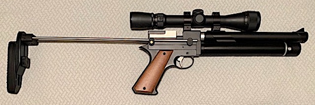

I bought the Ataman modular carbine chasis stock for mine. I would highly recommend it

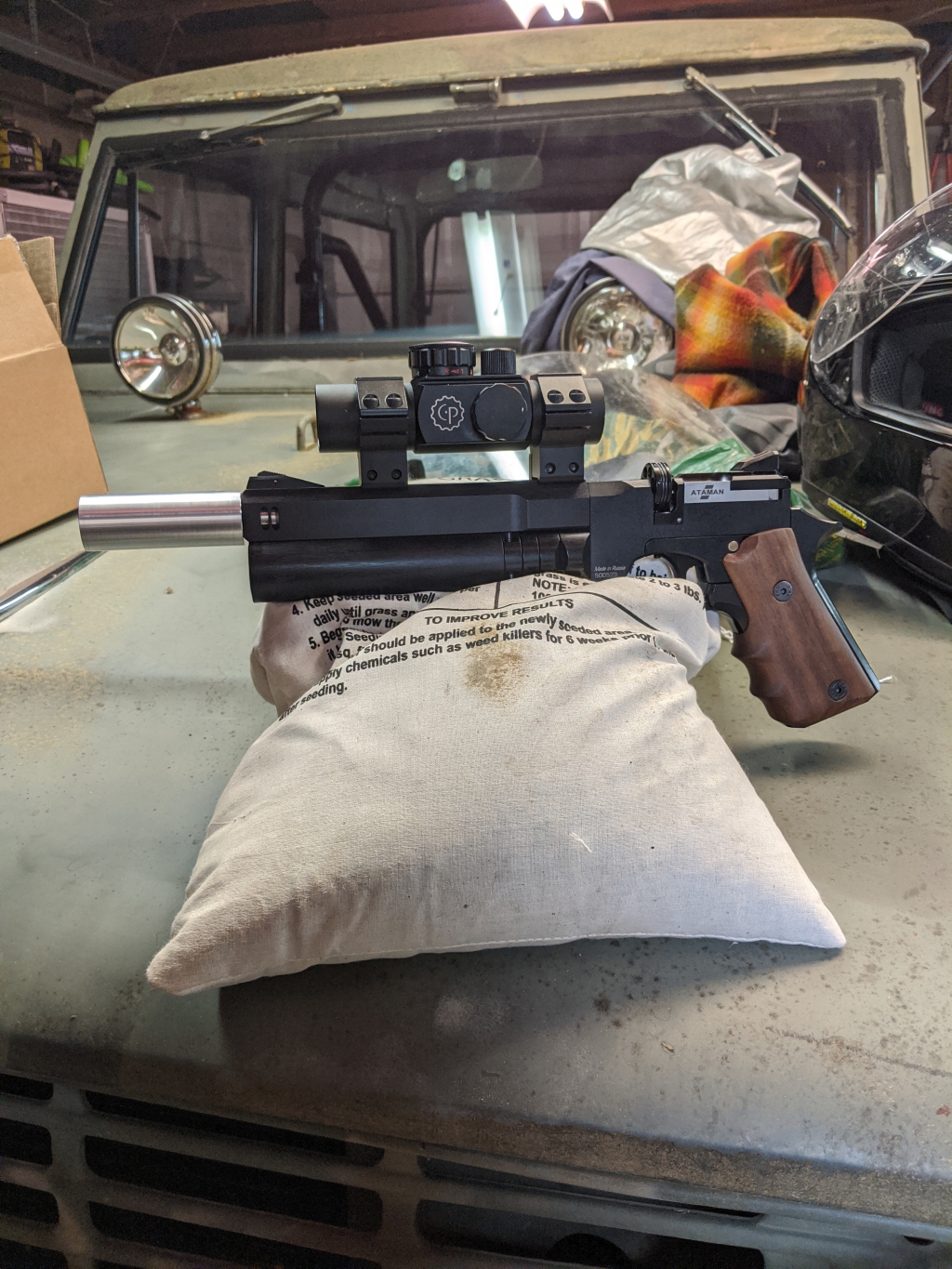

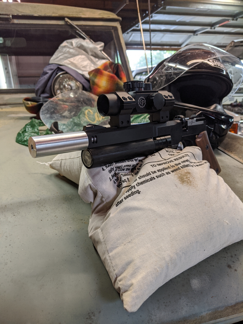

Couple days ago I found some scrap and turned out a tiny little moderator for it. Really does a pretty good job at this power level for as small as it is. Weighs virtually nothing. I need to crank the power just to see if it makes much difference there.

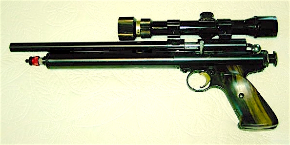

Nice early Bronco shooting rest you have there @thumper! I have a couple of them as well, in what appears to be the same condition from what little I can see of it.
@thumper

...the optic on the Broncho Buster is very much like the Millet scope I used on a P1...the P1 eventually kilt it...now it has a $29 Optima 30mm scope on it...that scope's red dot is small enough...
...but now it does not fit in the holster I have for it, so I had to buy a new gun...(grin)

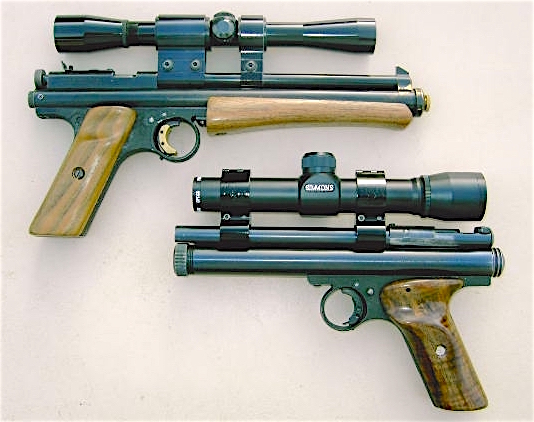

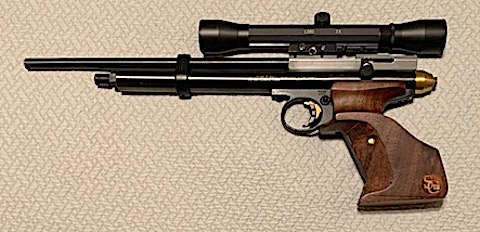

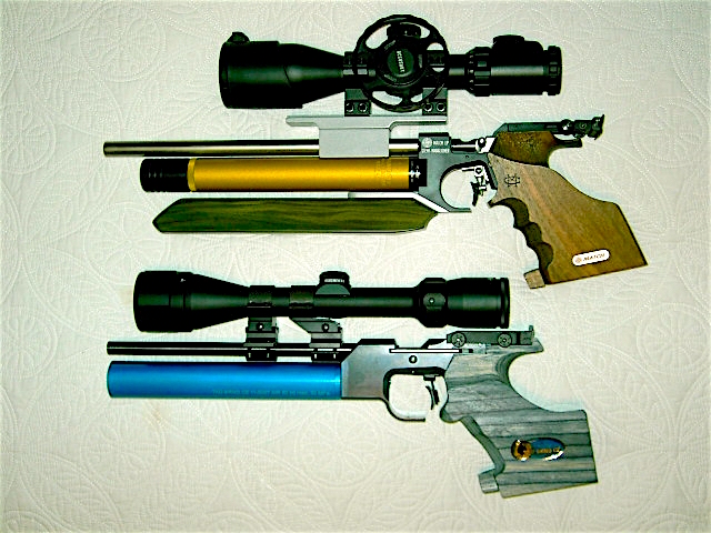

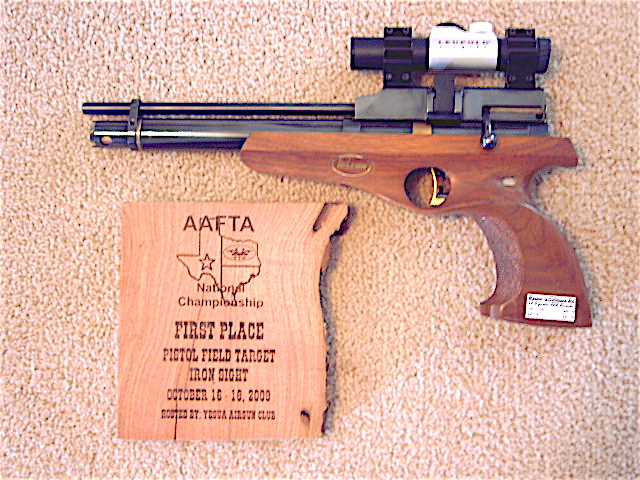

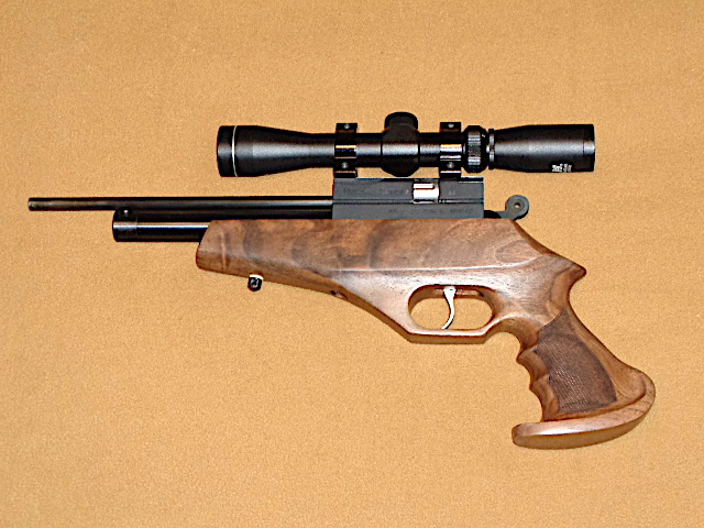

Nice rig!
Too bad so many of you have to compromise OA length with muzzle devices, just to be able to shoot your guns.
Living on my own 40 acres has me spoiled to hearing exactly what I'm getting, and enjoying shorter, less cumbersome rigs. Like these-
Yeah... I sure feel bad for you guys. But if it makes you feel any better, it took me a lifetime to realize my dream. A long lifetime. Consequently, I don't take it for granted.
You can read more about it, assuming you have a strong constitution-
https://www.airgunnation.com/topic/wts-custom-classic-and-otherwise-awesome-air-pistols-book/
I'm similar, I live on 36 acres and never use a moderator. There's no one here to disturb. Nice collection of pistols!!
