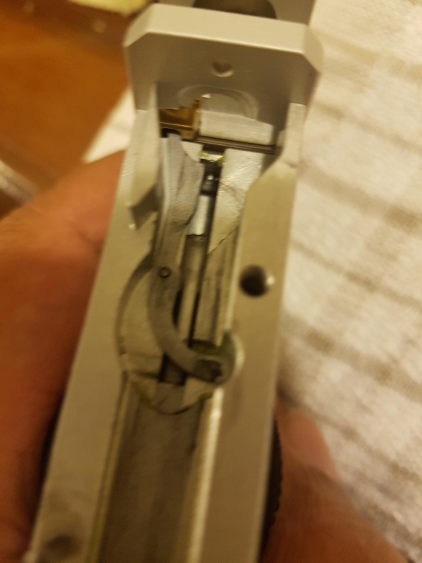

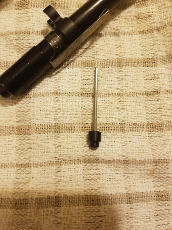

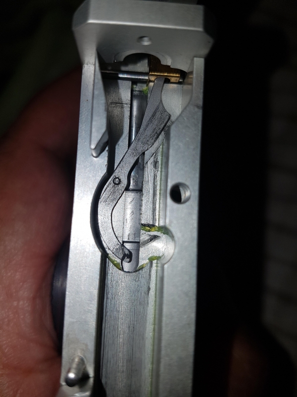

Still no luck, polish3d it up a bit but the the stem still sticks. It seems not a 100 percent straight. Shall try and set it straight. And check.
Got in touch with a gentleman, Mr. Rustum, from Ataman. He is also suggesting that I get the valve moving smoothly. He says to use a drill 1.5 to 1.6 mm in the hole.
Don't have that size in hand, Shall get it tomorrow and follow his advice. He was kind enough to make a video for me and emailed me. My appreciation for Ataman went up many fold by his dealing and attitude. 2 thumbs up!
Personally I would only drill the valve as a last ditch effort. Any reason Mr Rustum did not offer to send you a new stem? If yours is bent that seems it would be the best solution.
I have even said that i shall pay for it, inclusive of DHL charges
And his reply? Is he sending you a new one? If not I would NOT be thinking too highly of the brand.

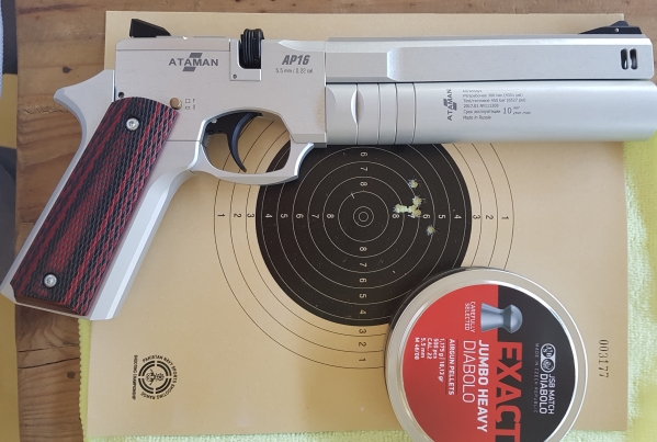

Resolved !![]()
Finally everything is in working order.
Shall try at the range Saturday.
Thanks a million to Mr. Rustam Nadyrov from Ataman for all his help

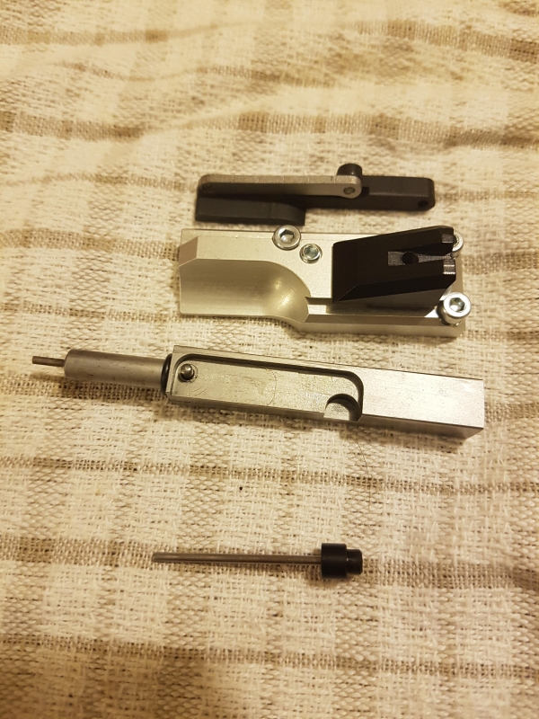

umair bhai, no, it was none of the problems you mentioned.
someone had fired the pistol with no air thus damaging the hole the valve stem passes through.
