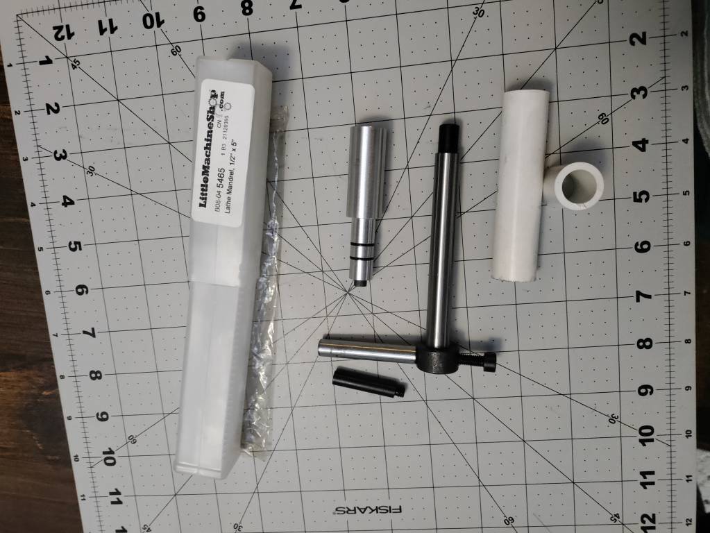

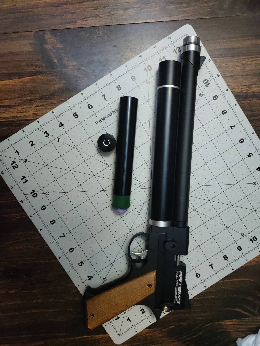

thanks Hawkeye check it out. Wes got me this nice piece in 22 caliber. Then I got to work fitting a hair curler and felt LDC. you can tell that machine work is like falling down the rabbit's hole. To make an adapter I had to make a longer handle for my lathe dog, an o-ring mandrel, and some spacers to press the part onto a mandrel. I am waiting on a set of baffles for the shroud, but this little project turned out well enough I may just cut the shroud down about 3 in to shorten up the overall length of the pistol and skip the baffles.
