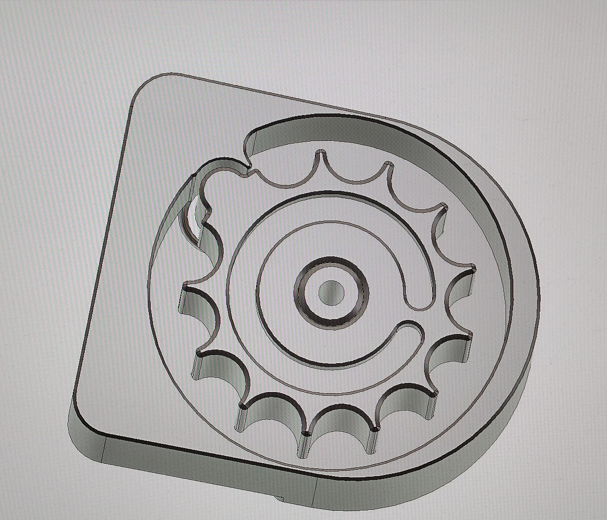

Awesome, glad your Pup has made it, hopefully the mag work will go smoothly. A mag holder sounds interesting, do you have a sketch you could share?
Nothing designed in CAD yet, the concept is in my head. There is enough space to fit a few more more mags, depending on orientation. I am going go make one for mine after the mags are done.

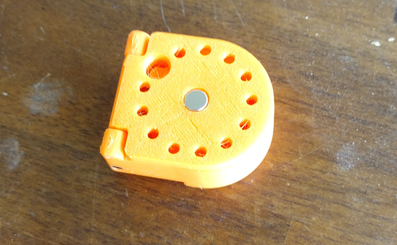

Here's what I have designed so far. This is a 12 shot mag on 22. While the Pinty shares some things in common with the P35, the slot for the mag without modification to the plastic cover has less space to work with.
It looks good. 3 more shots per mag. When will they be available.

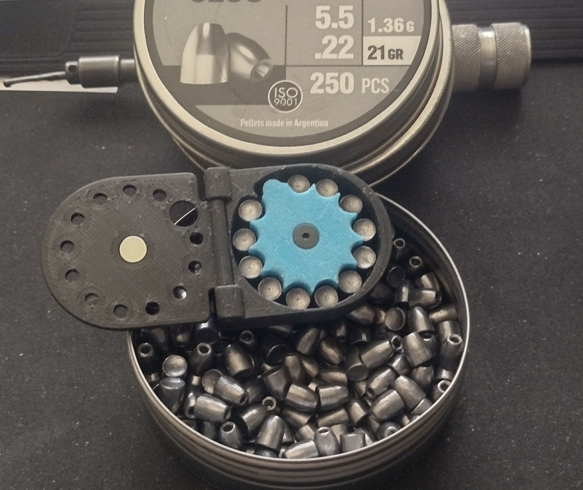

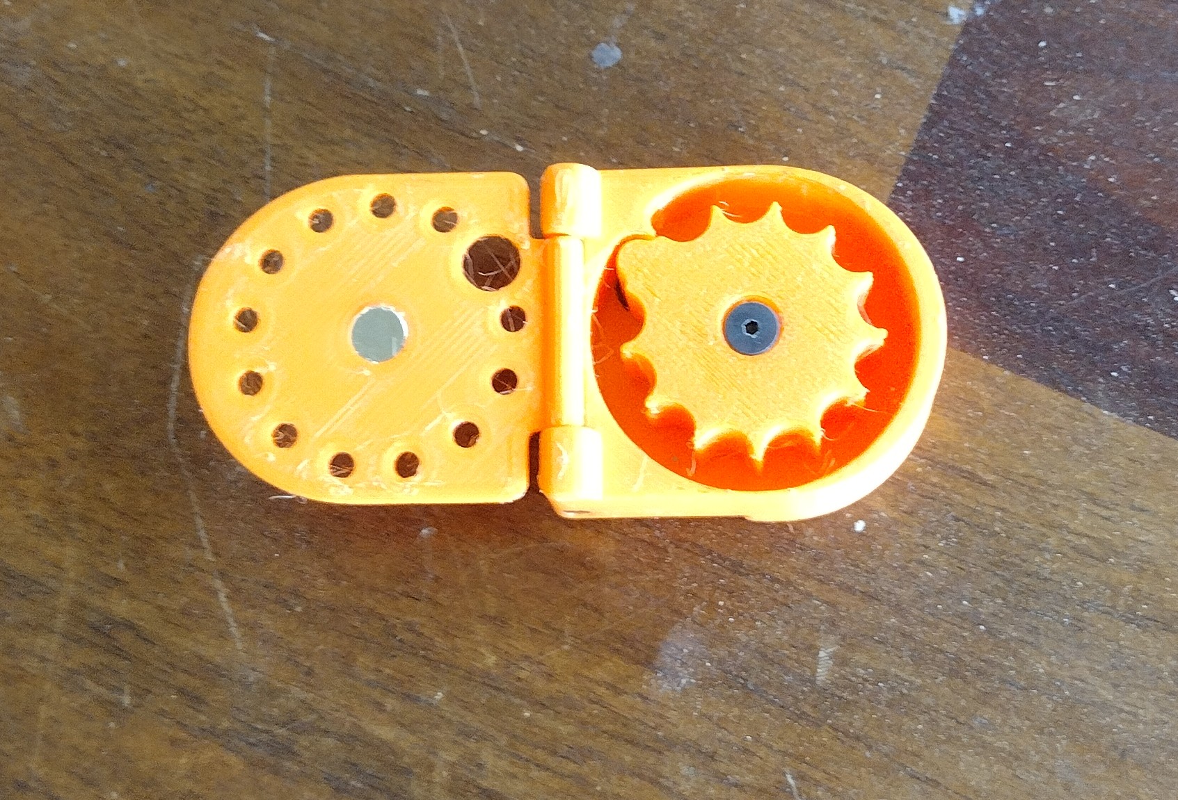

I am targeting the launch day by the 2nd week of April. I am going to change the design of the cover with a hinge and magnet rather than twisting the top to load. This a will make loading easier and add robustness for 3d printed mags.
