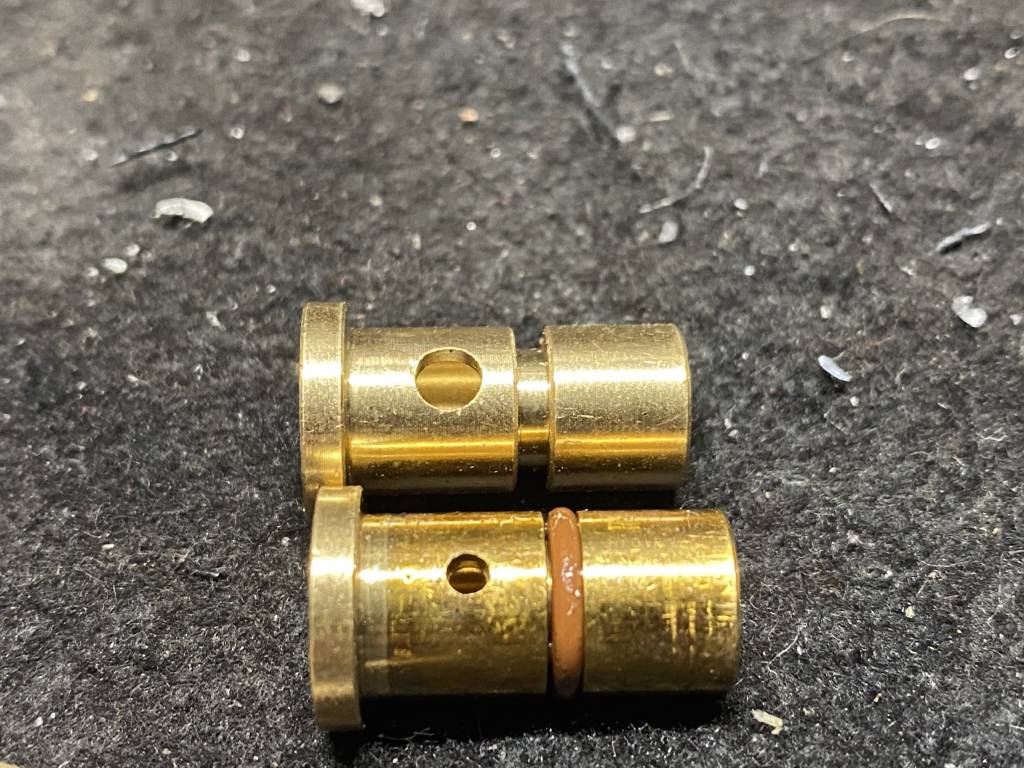

Canadian 1.8mm port vs. 3.5mm port. Factory plenum, no additional modifications or polishing, with the 3.5mm port and reg at 1700 psi (117 bar) could push 18.13 gr at 580 fps for 50 shots.
A larger free flowing plenum with 3.5mm porting would be impressive
Thane, any ideas why my .22 only gets 20 shots at around 580? I shoot from 250 bar to 90 bar. Mine was tuned by Veradium Air. This week I added the Huma reg but not much changed. Thanks!! Bryan
Bryan,
Thats a low count and low velocity. May have a leaking oring at barrel thimble, sticky poppet, blockage, air cushion in front of hammer... too many things to guess. Needs to be opened up and checked.
For comparison with 4mm plenum port and valve port, reg set at 140 bar (similar to Veradium modifications) PP750 .22 with 18.13 gr was doing 35 shots at 660FPS for 17FPE.

Thanks Thane. I can set my 750 to shoot into the 700s and I still only get 20 shots but fewer on reg. I set the reg to 90-95 bar thinking if I bring down the power I'd get more shots but it's still only 20 but 18 are on reg with a 7 spread. I was thinking maybe my HS was too heavy.
