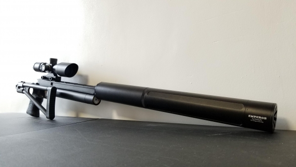

You want to see the most ridiculously suppressed PP700S-A of all time?
Sure, here ya go . . Gotcha covered! Hahahahaha
I grabbed the RONIN / EMPEROR V3 *EXTENDER* as a joke,
because small bullpups and this pistol look hilarious w/ that combo!
In the end, 'hopefully', it'll actually work on my Kral Nemesis .25 cal.
Anyways . . .
I've been skimming through your previous posts on here since last time..
Awesome stuff, and as always, thanks for sharing!
Sam -
PS: For anyone wondering...
Yes, I actually did shoot the PP700 w/ the extended suppressor configuration..
What did it sound like? Hmm.. Try to imagine a pin drop in the vacuum of space..
Yeah, pretty much like that would sound like. Plus slight ping of the action..
Hmm.. Now to find a way to quiet that ping down.. 🤣
