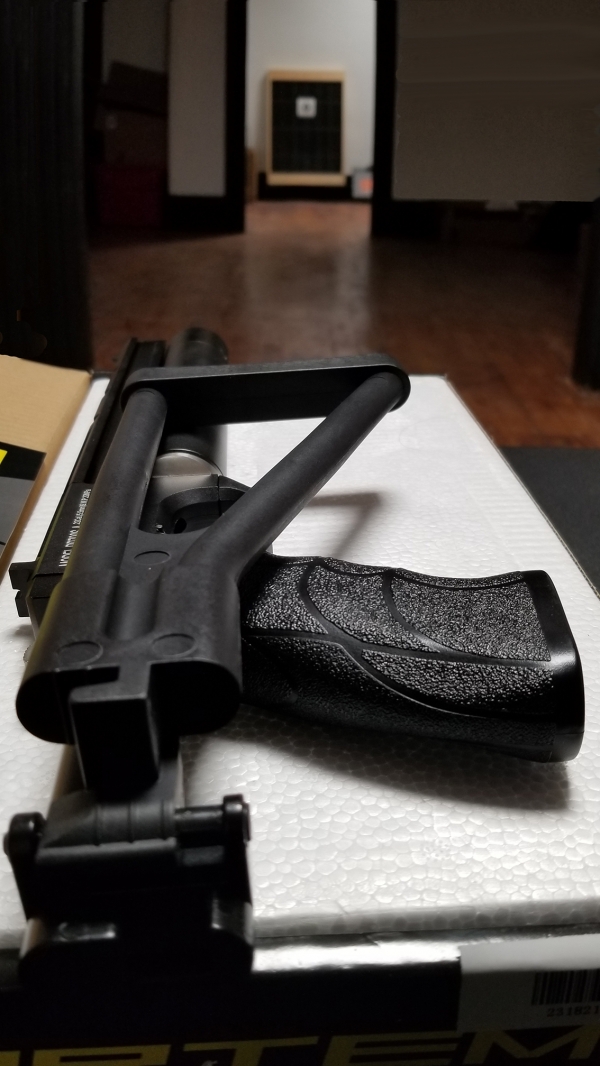

And speaking of stocks, I might as well let you guys know what I ran into..
I went to throw the folding-stock on, annnd... Nope...
Whoever drilled/tapped the two mounting holes on the mounts
drilled them too far towards the rear.. when the stock is in place,
if you look through the holes in the grips, it is obvious..
And there's no way of getting things to line up. [I adjusted/angled it a bit]
So, it looks like I'll be stockless until' I can find a grinder..
I'll have to shave 1-2 mm off from both of the mounting plates,
and that should bring the plates - and holes - in closer towards the gun..
*Sigh*

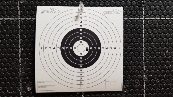

Here's my first 6 shots from 15ft. [The 1/2 way point at my 10m range]
I shot 1 -4 with my right hand only [I'm left handed]
Aiming for Center, 1 was wayyy off.
2 was much closer. 3 was super close.
4 veered off a bit too far to the left again.
For shot 5, I used my left arm as a brace – Elbow out..
Rested the barrel on my elbow, and – Sooo close!
For shot 6, I was aiming at the lower dot..
I used the same type of bracing / hold, and again.. So close!
This Pistol Is So Much Fun!!

Try loosening the screw that holds the grip (M4 hex). While loose, try attaching the stock...then snug the grip screw.
Of course use your discretion. Mine lacked perhaps 1mm from going on but it’s quite solid when I did it like that. It may be that a little interference is intentional so the forward part of the attachment tines butt up against the valve body. That ensures the stock does not rotate up and down which would be quite annoying.

Thanks for the suggestion! That is actually a Very Good idea, and I'm glad to hear that it worked in your case!
I will definitely give that method a try! I can see where loosening the M4 grip bolt would allow for a bit more play,
and that might just be all I'm needing also..
You used a few specific names/terms, so that helps me explain things a bit better too..
When I initially slotted the stock brackets into the back of the pistol grip, they did butt tightly against the valve body.
*I just needed it to go a 'little bit further'... haha Yes, I can see how that would lock the stock in place much better
to lessen the chance of any upward/downward movement/rotation.
I'll report back as soon as I get to give that a whirl..
Thank you again!

nervoustrig, You rock! This suggestion and installation process / trick seems to have worked for me too!
I couldn't sleep, so, I gave it a try, and while awkward, the stock is on now, and the pistol has been fired as a 'rifle'. haha

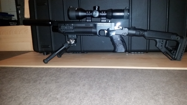

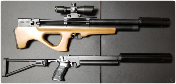

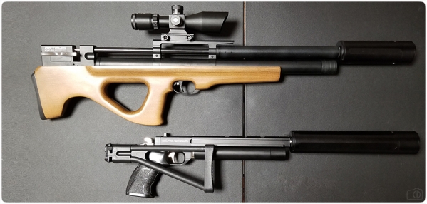

@dirtydovi, could/would you post a pic of the pistol from the side with the stock extended and folded? Thanks, am strongly considering this rig as my next purchase.
L.Leon, You ask and you shall receive!

The stock is really starting to grow on me now.. I think I like it..

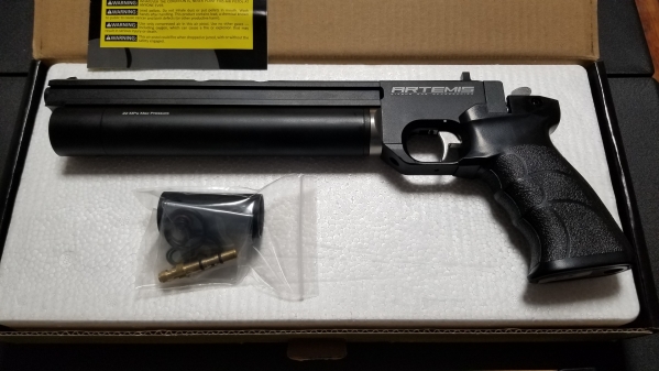

Here is a follow-up to my dilemma with this pistol. I received an email that the repair of the first gun was ready for pick up. When I got there the owner apologized and said that the regulator was still leaking after receiving the gun back from the distributor. In fact, not only was the regulator still leaking, the bad pressure gauge was not replaced either. Like I said the owner apologized and gave me a replacement new in the box pistol. I just now tested the new pistol. The first thing I did was try to fill it. It was sitting at 150 bar when I started. According to the gun gauge. I slowly opened the bottle valve and watched the pressure creep up. I was watching both the gauge on the fill whip and the gauge in the pistol. Slowly the pressure started to rise, but when the gun gauge pressure reached 180 bar, the regulator in the gun started to leak. I compared the gun gauge with the fill whip gauge and the whip gauge was reading 190 bar. I stopped filling and shot a 20 shot string. The gun gauge was now reading 100 bar. The gun shot well holding a 1.5" group at 15 meters with the factory open sights. I was not using my crony, so I'm not certain of the speed, but having measured the first gun at 600 fps, this gun might actually have been a bit faster. I am impressed with the power for sure and it performed consistently. I then attempted to refill the gun. This time when the gun gauge reached 180 bar the regulator started leaking again and this time it continued leaking until it stopped at 160 bar indicated on the gun. The gun is now parked on my work bench where it will sit for a day and I will check it again.
I am impressed with the gun's performance, but this factory regulator has been a big problem for me. The gun is rated at a max fill pressure of 22 mpa and both guns appear to be unable to reach that pressure. Further, if you try to increase the gun tank pressure beyond the leak point, I suspect you will blow out the regulator seal, which is what I think happened on the first gun as well. Please, all you other owners of these pistols, are you having these issues or it just me?
