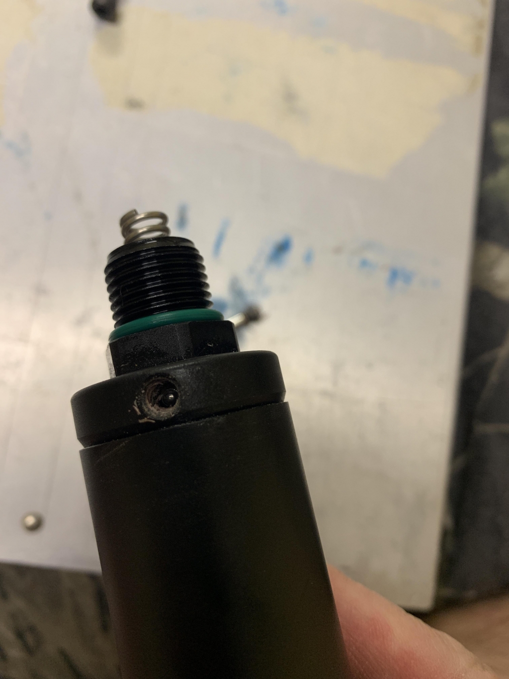

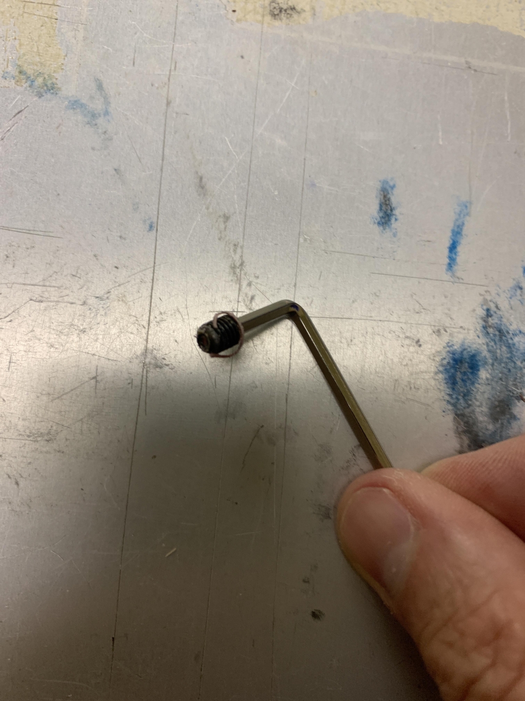

It can get stuck in there. Try a magnet and a needle to free it up. Now once you put it back together it won’t stick. SPA guns have all kinds of gunk in them.
