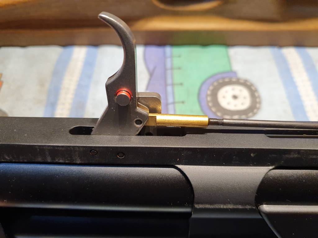

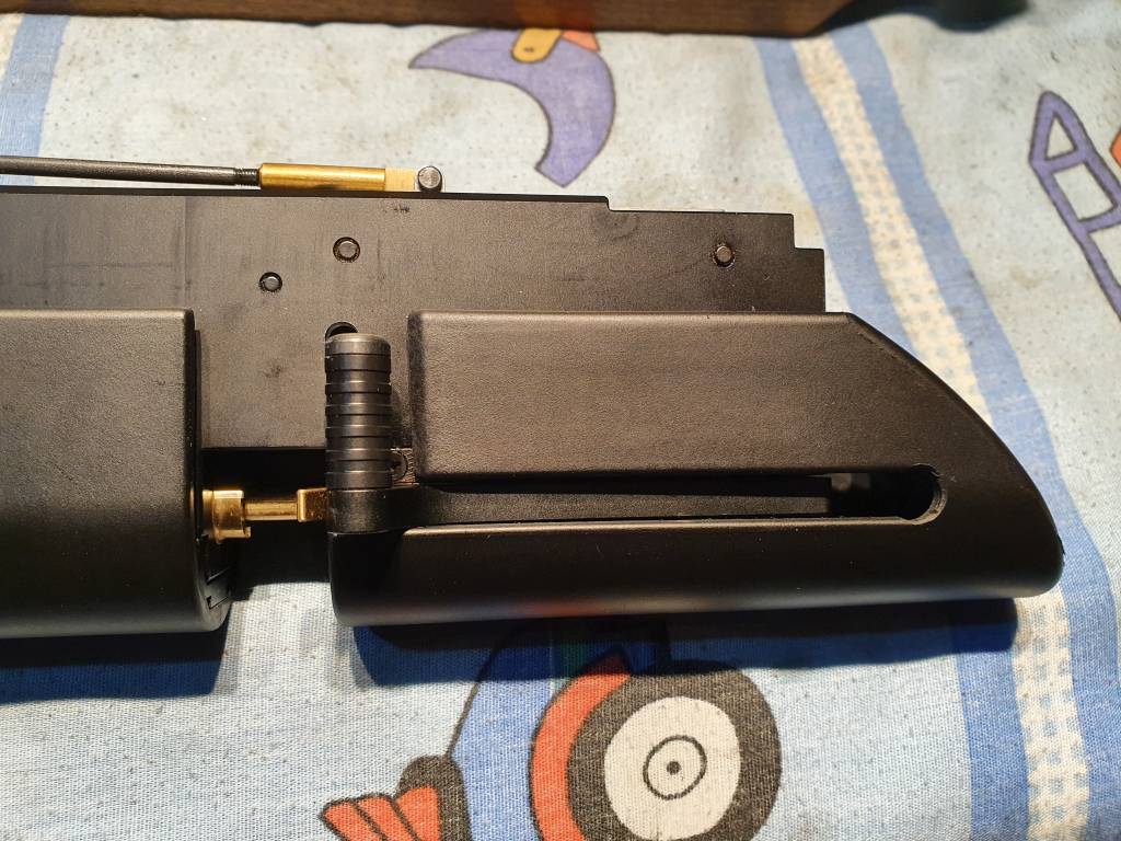

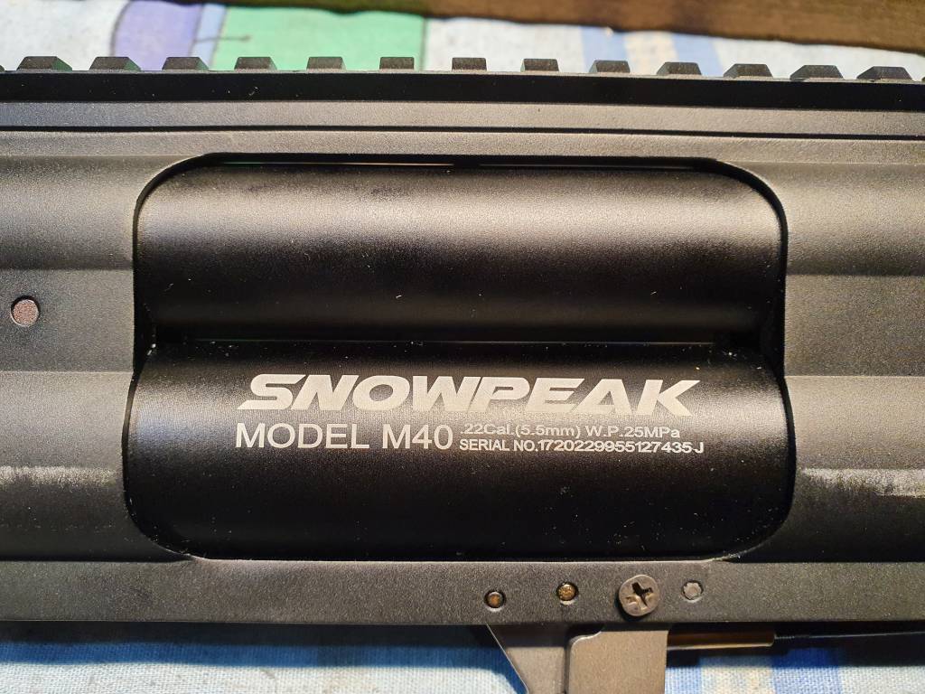

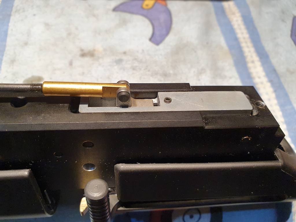

I have an M40 on my bench at the moment which is not functioning as it should (semi auto) it looks as if the auto cocking mechanism is air powered, but it is coming against too much resistance to allow it to function. The Chinglish booklet that comes with it does state it will not function around / below 100 bar (actually it says 10mpa) I have tried the rifle a very still levels it is still not working the linkages under the trigger seem to be far more substantial than previous offerings : let's hope the insides are also better. About to take it apart now...
