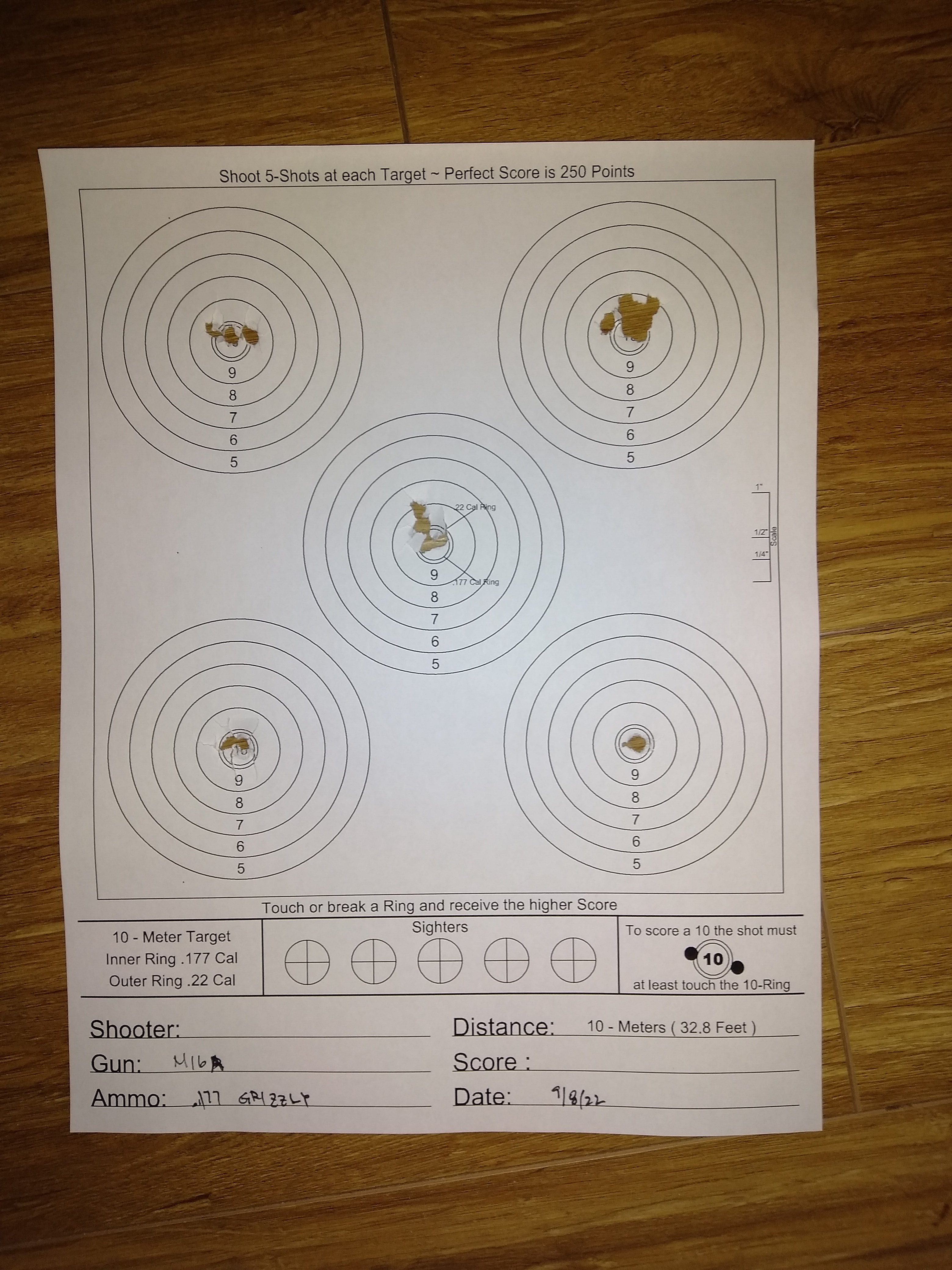

Dont know how to score this, just got my M16A, cleaned the barrel, quick zero on a scope and shot this without warm up, resting on a tripod and squat position at 10 meter, started from top right going to the left
The SPA/Artemis/Snowpeak pcp's almost all responds well to experiment with different length and sizes of the hammerspring, most of mines where to long and waisted air, and also the regulator need some adjustment, on my 177 M16a that i use as a 25m target gun and still experiment with i can get more than 400 jsb 8.44gr or 7,33gr within reg, with a lower speed ofcourse, (around 570-580fps) but at just 25m you don't need 1000 fps...
