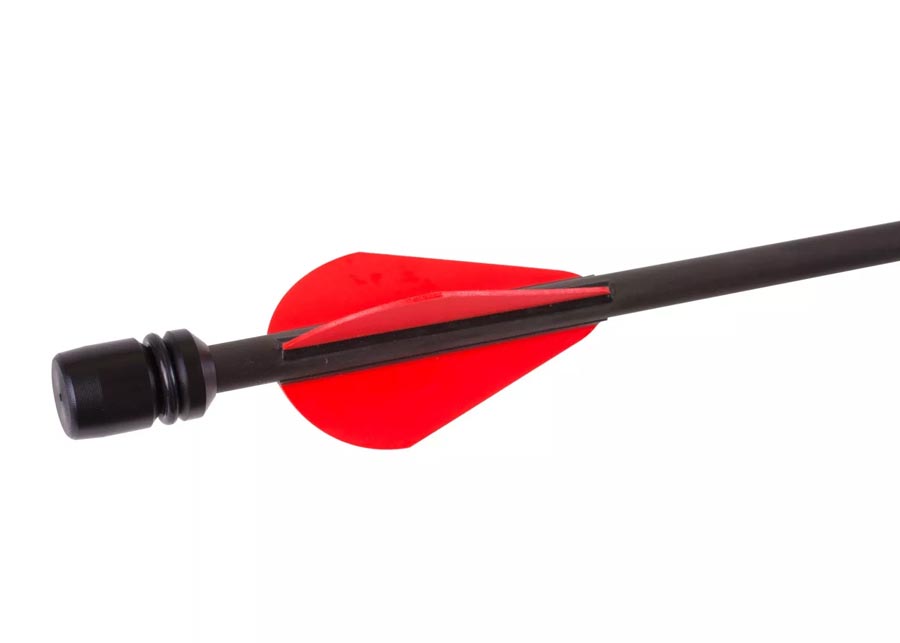

The arroe has to be cut so the nock is right in front of the valve and the guide rests on the crown ( like in the pictures on my thread )
The inline system increases power with weight of projectile so yes shooting arrows will consume much more air then pellets
Very accurate with the JSB pellets but I never shoot for distance I'm a close quarter hunter.
Sure however not sure if im following what you are saying
these are the airbolts, after what i have researched

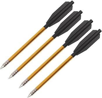

and these are the arrows i shoot in my crossbow, they dont even have nocks (they are 6mm diameter and around 12inch long) will they work fine or do i have to replace the backend?

No the crossbow arrows will not work, you need the rear nock to seal the barrel like a bullet/pellet and impart rotation to the arrow and you need the front aluminum guide to rest on the crown to make the arrow shoot straight

No, no I did not make my own I just cut down the AirBolts to match the barrels 20" for the rifle and 14.5" for the carbine, not hard at all just follow the process on my thread.
