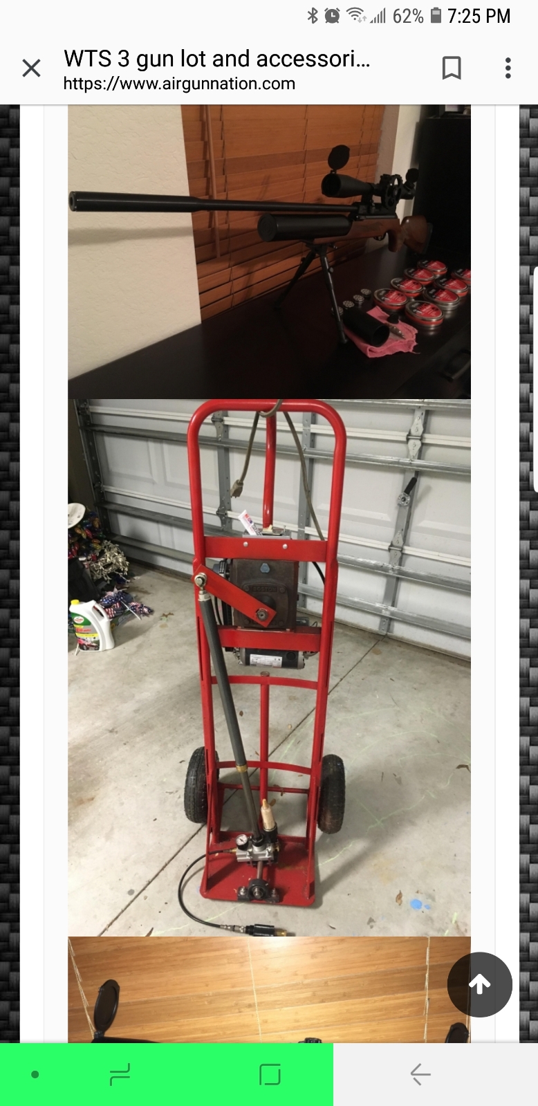

Or make one of these!

The red pump shown is good for short duration. The water cooled versions are good for longer duration.
