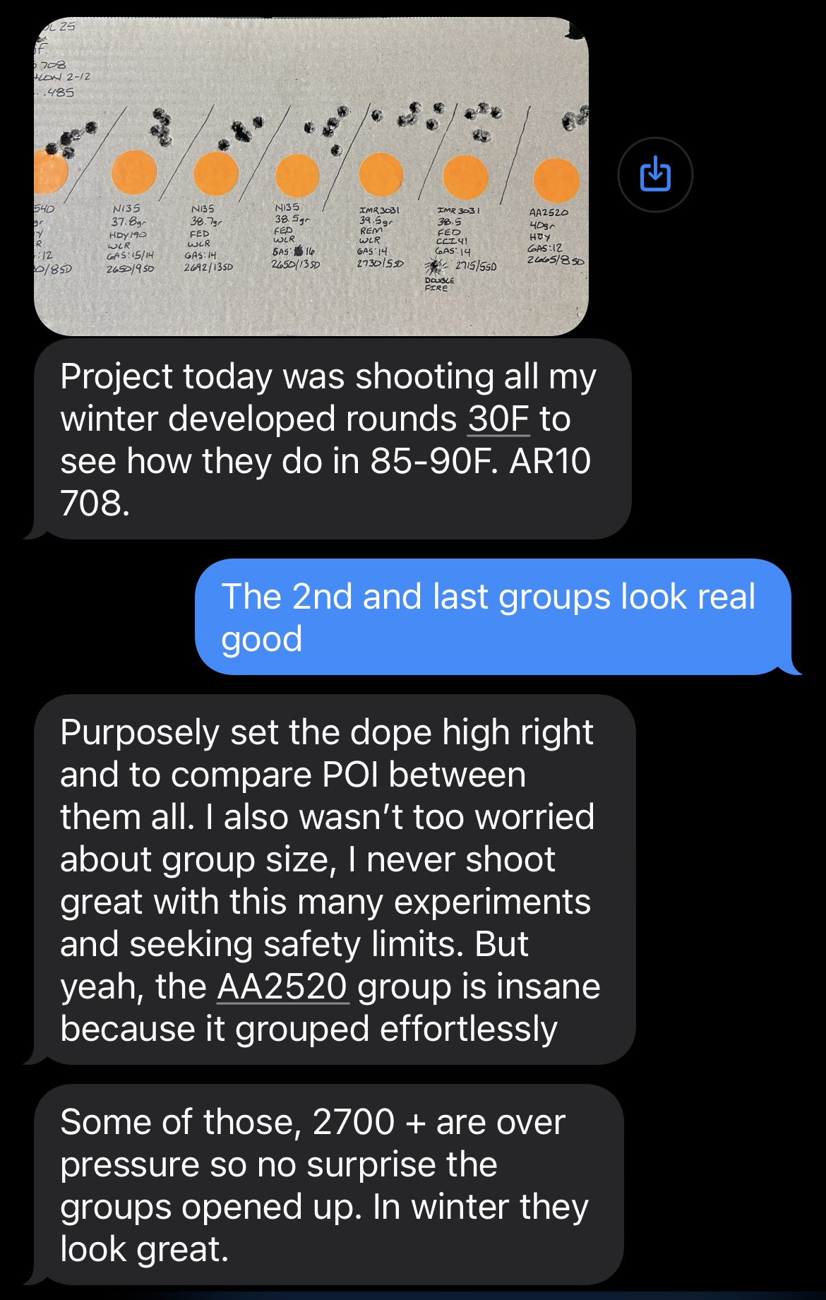

And finally I’m including a screenshot from a friend who is also on these forums. Bro is a very serious shooter and was telling me about testing his winter specific loads…
