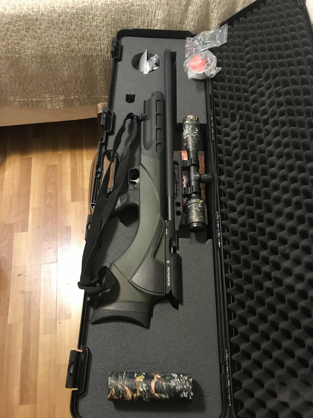

I'm trying a new Evanix Raptor in 30 right now just picked it up last night ran 4 mags through it, it's unregulated averaged 821fps over 27 shots with JSB 44.75 at 20 yards a ragged dime size hole was running out of day light so had to stop the price is suppose to be $950 with 2 mags and has a foster fill on the end of the air tank. Will update as I have time to continue testing doesn't look like the weather is going to be good for the next couple days though. Rick Eustler has a short video on it and did I tell you it has a wood stock it's a bullpup also.
Nice semi-auto for $950, is it used?
