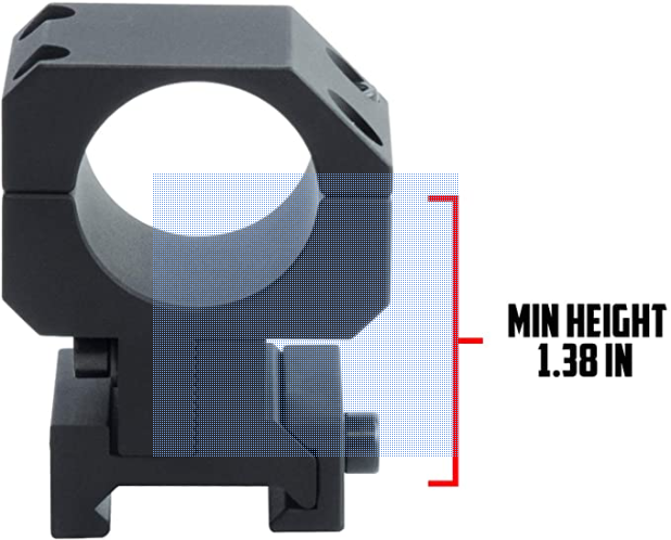

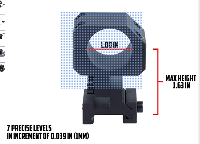

Adjustable scope rings don't change the fact that you still need the correct scope ring height. Scope objective size, magazine clearance and proper positioning of cheek weld play a factor on what scope ring height you will need. Adjustable scope rings like the FX No Limit Rings are adjustable for elevation and windage so you don't have to max out the elevation in your turrets especially if you're shooting "long range" or getting your initial zero with a scope that has a high Height Over Bore.
Adjustable scope rings are also used once your scope is optically centered and you can make fine adjustments through the turrets after. FX should just add a 20 MOA or 5° scope rail like other airgun manufacturers are doing but then they would lose sales on their FX No Limit Rings lol but that's another topic. Sorry for the derail.
As mentioned above, Sportsmatch, Eagle Vision, Burris and FX are the only ones I know of. I'm not sure if you mentioned if it's for a PCP or springer. If it's a springer, I know Leapers/UTG and others sell the one piece adjustable scope base.

So if that's the case why aren't there low medium and high adjustable rings? You would be adjusting the rings to the desired height no?
